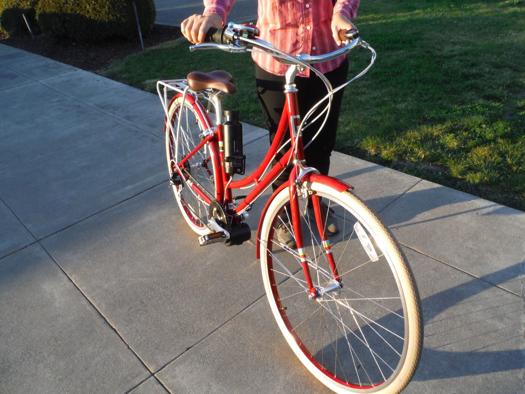

The person in a Zen Garden quantifying how many blossoms are on the cherry tree, does not get it. I made a Zen Garden electric bike today for a young woman from Japan. The tech is invisible. Just as it should be. Less is more.
View attachment 113707View attachment 113708
