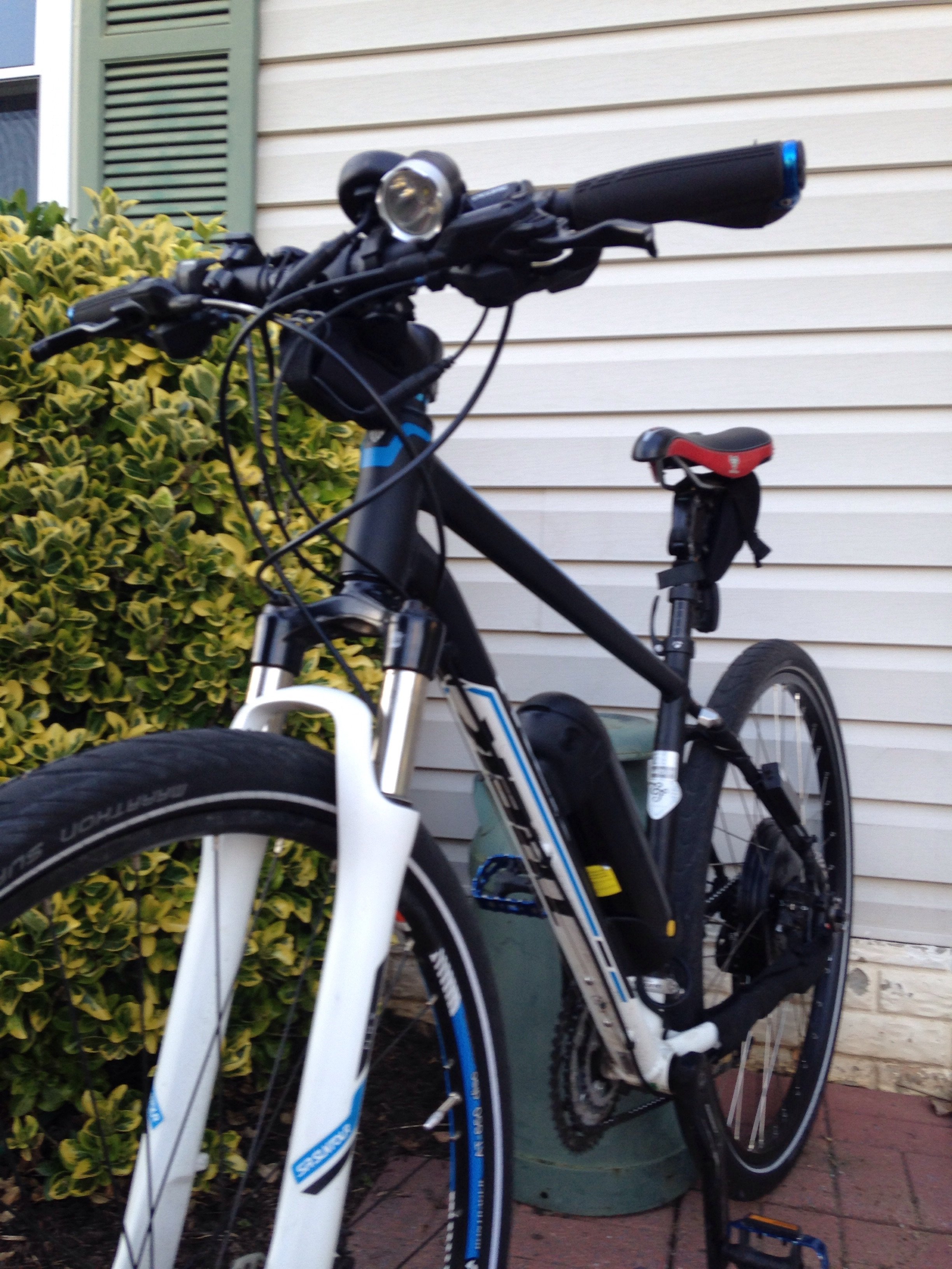

First look at my new Falco build.
Really cool to see your new build Bike_On. You were one of the reasons I bought my Falco system. I actually looked at getting that exact Trek DS that you picked out for my second build. My Binachi hard tail is exactly that, hard on the tail. Does the rear suspension help much?
image.jpg image.jpg Thanks BarlyB,
The ISO zone and thud buster helps to smooth out the ride where the road has a few bumps. They are not good for jumping off curbs or off road.
Edit update: I AM noticing a smoother ride. Between the two part suspension, it does help. My rear can still get tired - it's out of shape! I get annoyed with the battery rattle over bumps. I have added closed cell foam to dampen the plastic noise. A heavy rear hub does NOT like a hard hit in the rear. Nothing good happens when a rear hub hits a bump at high speeds.!
More pic to follow.
I have been playing with the parameters to get the right feel. I got a NEW wheel from Falco. It was $150 to lace it up. The awesome thing about Falco and I assume ST2 Stromers is the confidence that one can adjust the power delivery to be exactly what you want and you are not stuck with a mismatched system.
Of course this is still a ddhub, so adjust expectations accordingly.

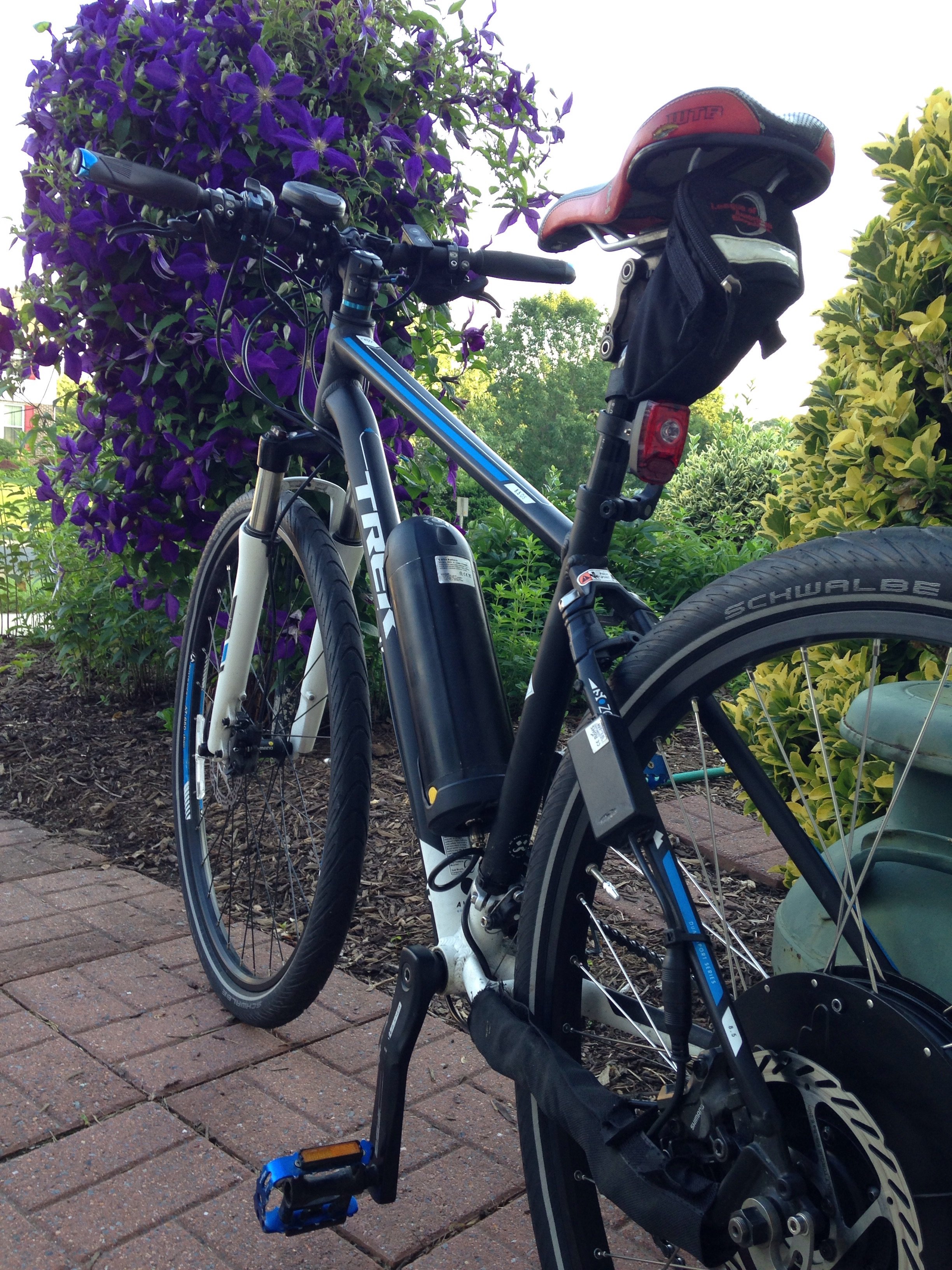

More pics of a Falco 500w hub on Trek ds8.5.

I'm really liking the new firmware update I got a couple of weeks ago. I've pretty much left it stock. Not sure if it's the same one as you have though. It basically leaves the motor "ON" after you hit about 25 mph similar to a cadence sensor. It's all but eliminated high speed surging on the Torque Sensor. I should point out that I upgraded to the 48V battery at the same time, so it's hard to discern where all the improvements came from. I imagine a combo of both.

Note on suspension. Ok, the Trek DS 8.5 is a fast and light multi use bike. That said, I can tell it is not up to par for a 20+ commuting ebike. Whether 36V or a faster 48V system, the speed and weight is demanding better components. The mechanical Suntour forks are BARELY good enough to provide a stable, smooth ride. The thudbuster and Gary Fisher ISO zone are BARELY enough rear suspension at 25-30mph, but they help and it is quite noticeable compared to my previous aluminum/carbon fork road bike build.
Conclusion: For dd hubs and high speed 48V systems, go with high quality FOX or Rockshock forks. No need to skimp. Go with a study frame. Rear suspension? Yes, it you don't mind the extra weight. Now you are talking a full mtn conversion that has small chain rings! A steel framed bike and thudbuster is another consideration. Thus, the ST2, Spec Turbo, Focus bikes come to mind as examples of there the customer will go for high speed, ddhub designs.
