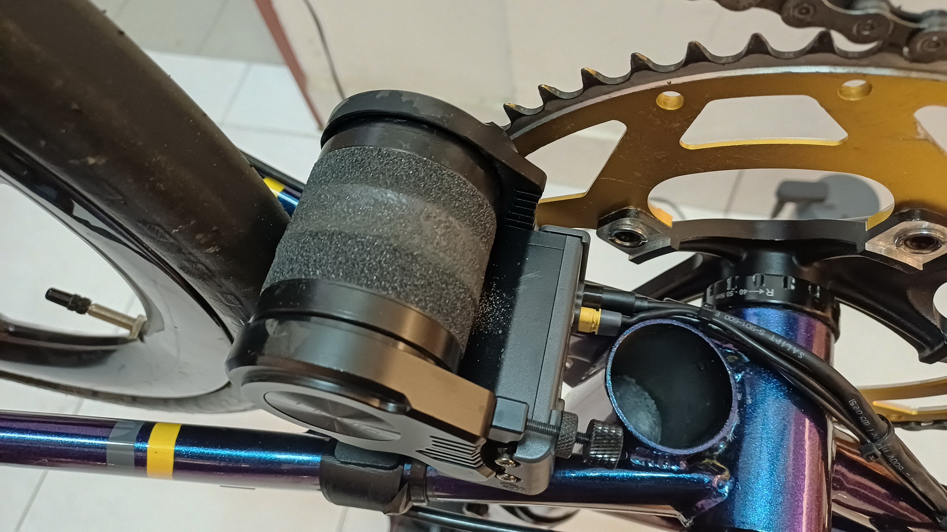

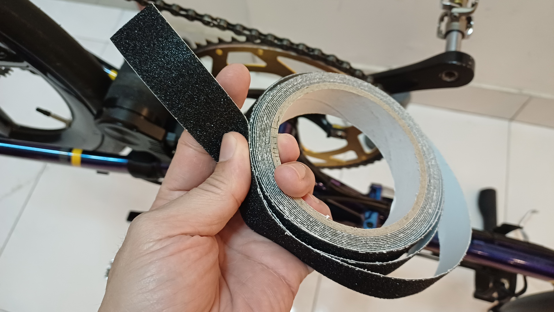

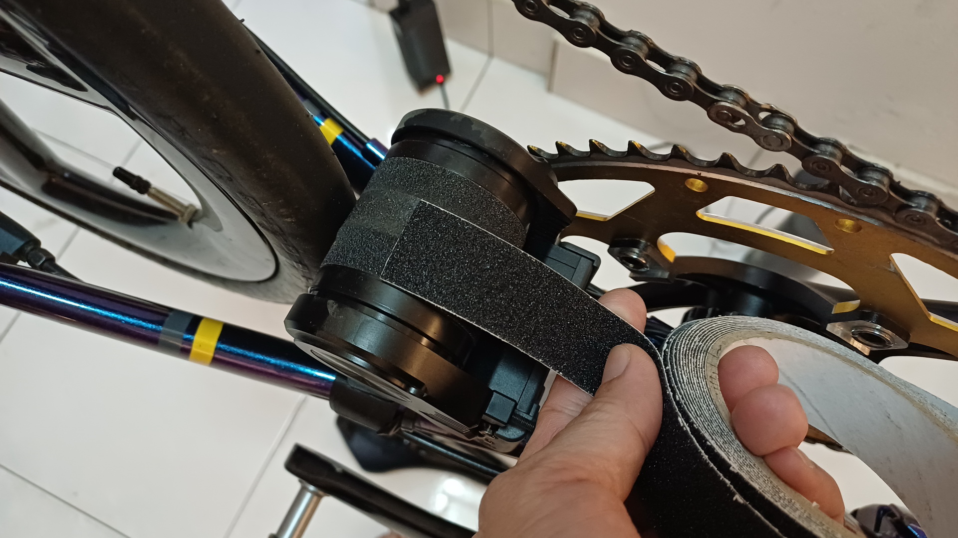

How wide is the tape you used?
The tape i use is about 2.5cm width fit nicely for 320W Pro but on 400W i just overlap side by side. Attached picture how i overlap the 3M friction floor tape width by 2x when wrapping on the friction roller of 400W.
When you stick the tape, you do it on top of the original or do you remove the original?

Yes i do tape it on top overlapping each other on the center of the friction roller which is good for extra thickness and durability.

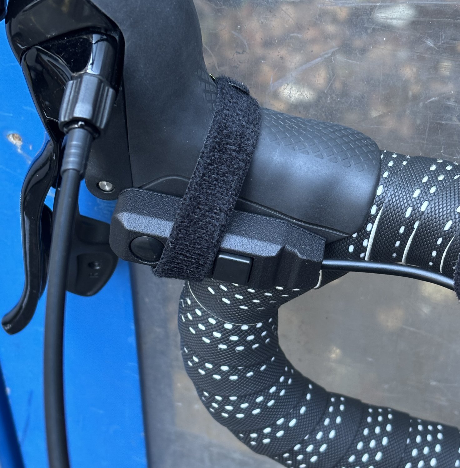

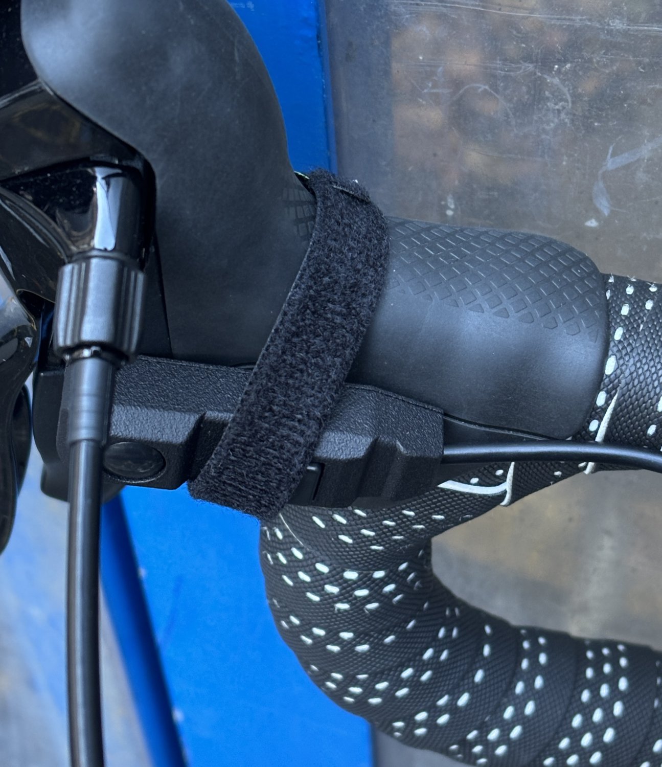

My 2 biggest complains are not having the light on the controller, I never know in which mode I’m in. And that sometimes it does not get I am breaking and it looks I am fighting the motor to stop.
To operate the button a simple velcro has turned to be really effective, I got a velcro between the two buttons of the controller. When I want to press I push the controller with my thumb sliding it under the Velcro so it is kept pressed. When I want to stop I slide it back (images attached). Simple and effective.
Good to hear you enjoyed the Mute version, i have to agree Qiroll should put the LED indicator status on the controller so we could see visually see and know which modes we're riding in. Sometimes i accidentally press the regen brake/mode button and didn't realized it slowed down on fast highway road.

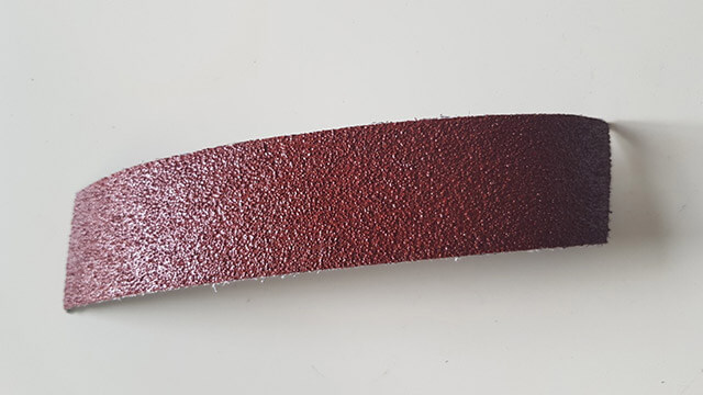

I used this method for almost one year, but in my experience it was not durable enough. A much more durable option is to use belt-sander sandpaper and strong double-sided tape. My first layer feels barely used after 200 km. I got this idea from a blog about the Add-E (German version of QiRoll) they used it to fix their original layer which is build to last up to 10.000km. :)

Do you have a link from the German forum to see which sandpaper grade to take ?
I used 60 grit sanding belts on both my mute and pro versions. Virtually no wear on the sanding belts themselves but they do wear the tire some and you have to make sure they are pressed on the tire firmly enough to prevent slipping otherwise it can damage the tire. Post #218 shows what I used but I've since used a different glue with success.
unfortunately not but the person tested gridsizes between 60 an 130 and they all worked good. I´m right now using 60 too... Maybe it is better to go with 60 ish when it is wet or dirty and in summer 120 ish to reduce tyre wear.
I had chosen 60 grit mostly because it looked same/very similar to what Gboost uses for their friction drive.
