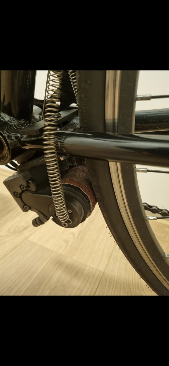

Primary "other issue" = couldn't replicate my earlier success keeping the motor engaged with the tire. Applying boost caused the motor to spin freely, burning the grit off the carpet grip tape while starting to sand the tire's surface smooth. While reviewing this thread for info on wiring switches, stumbled across reports of others encountering similar and solving it by using belt sander tape for the tire interface. That seems to work well for me, though it sure would've been nice to discover this earlier and have a lot more testing in before our imminent tour! I'll make a handful of replacement tapes to bring with.

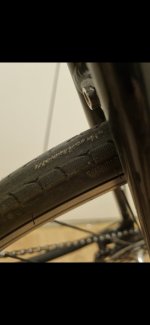

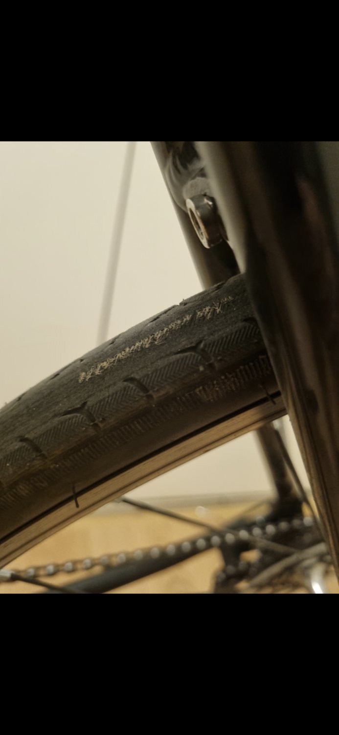

Speaking of sanding the tyres smooth, I've been using the belt sander and with my spring contraption to provide constant pressure. I've noticed today that there is a bald patch on my rear tyre that will probably need replacing very soon. Perhaps I will need to go back to the floor grip tape which is much less aggressive.

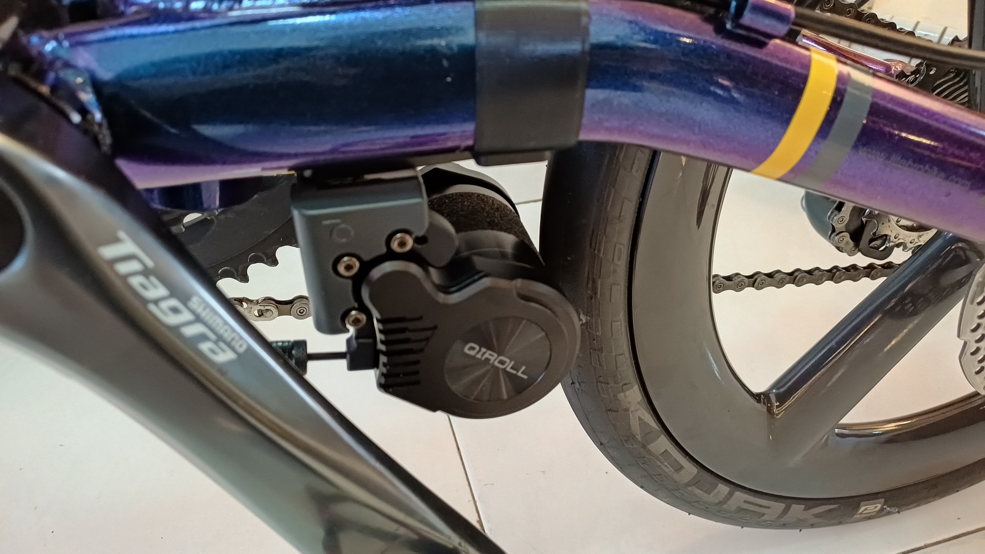

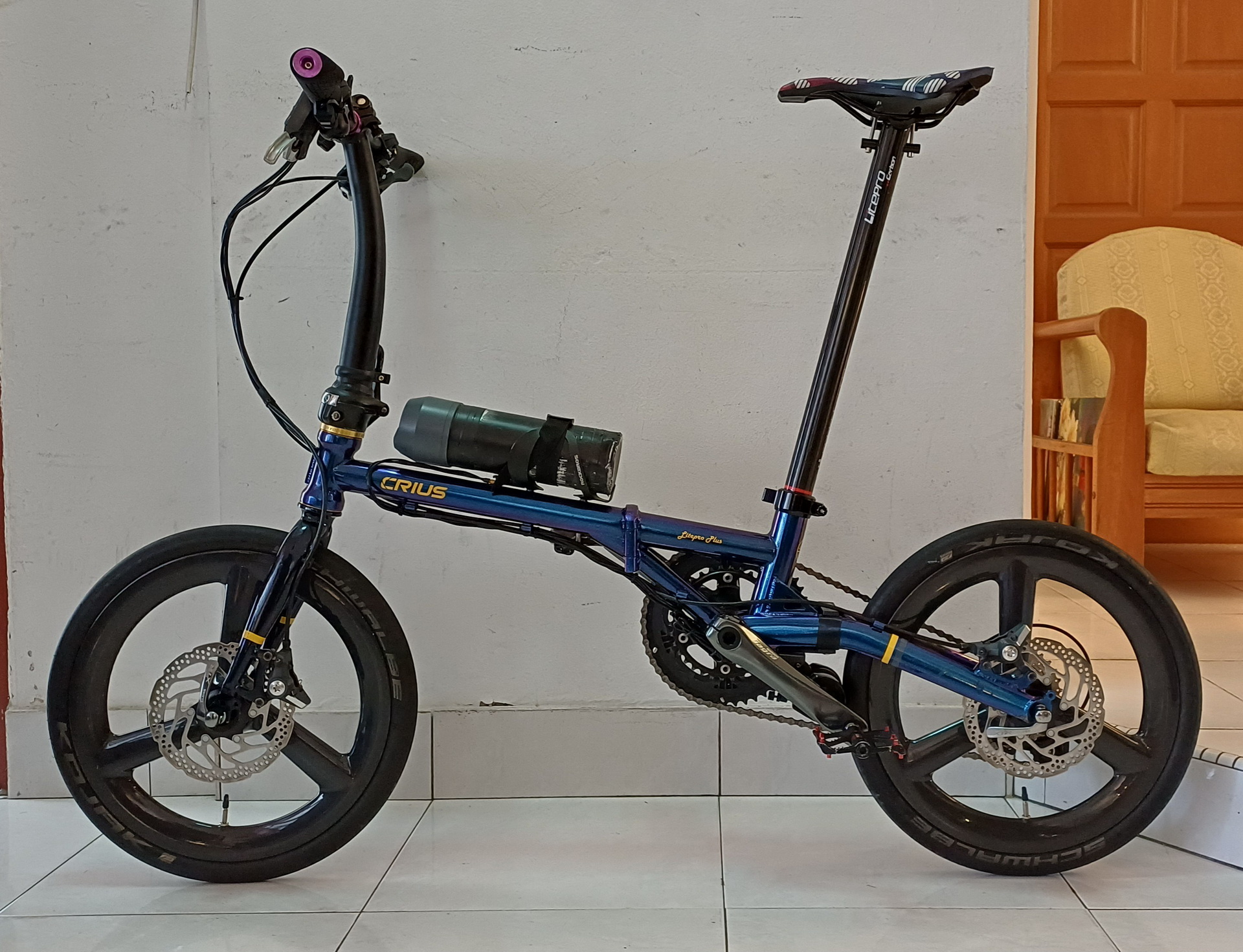

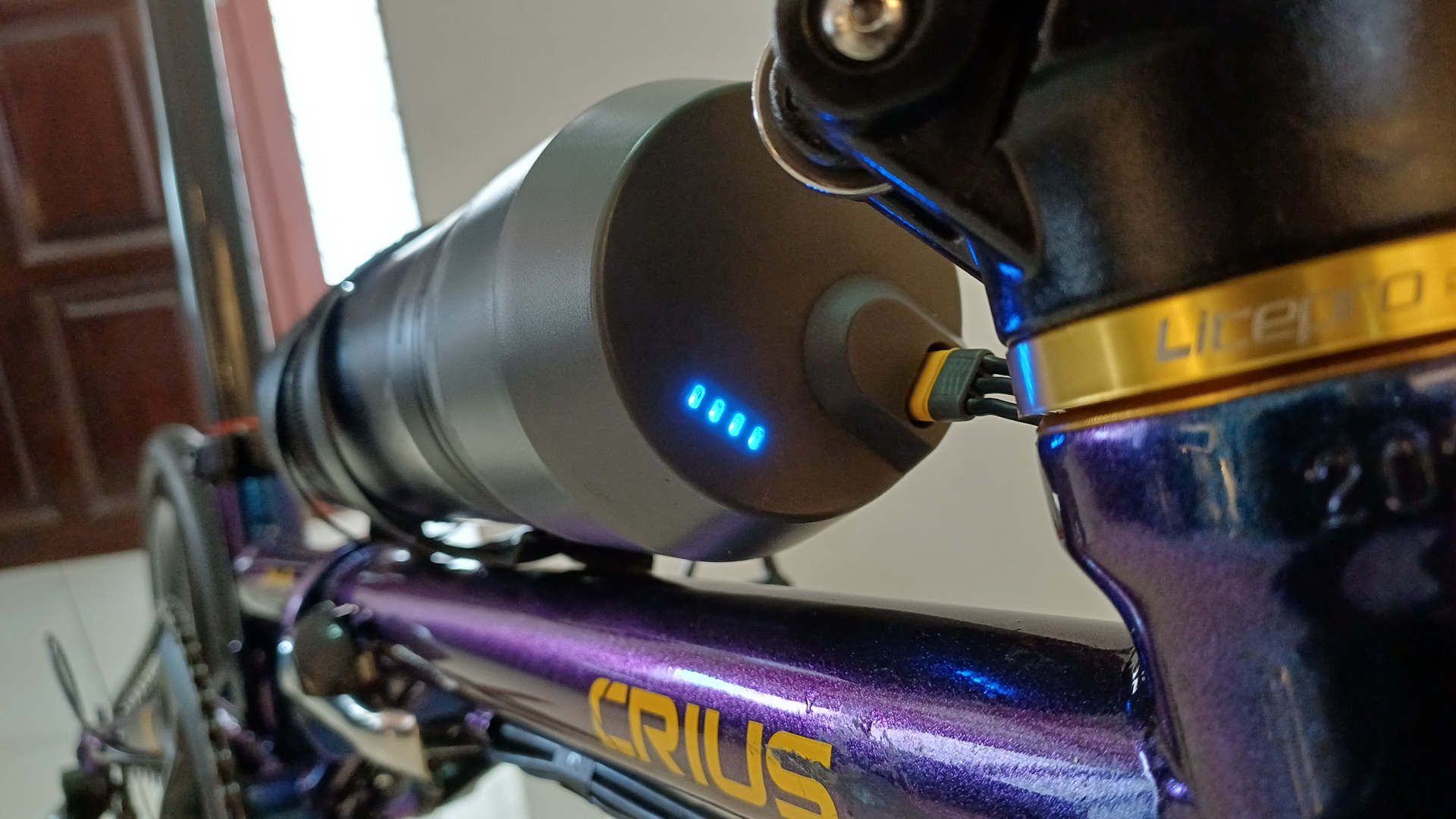

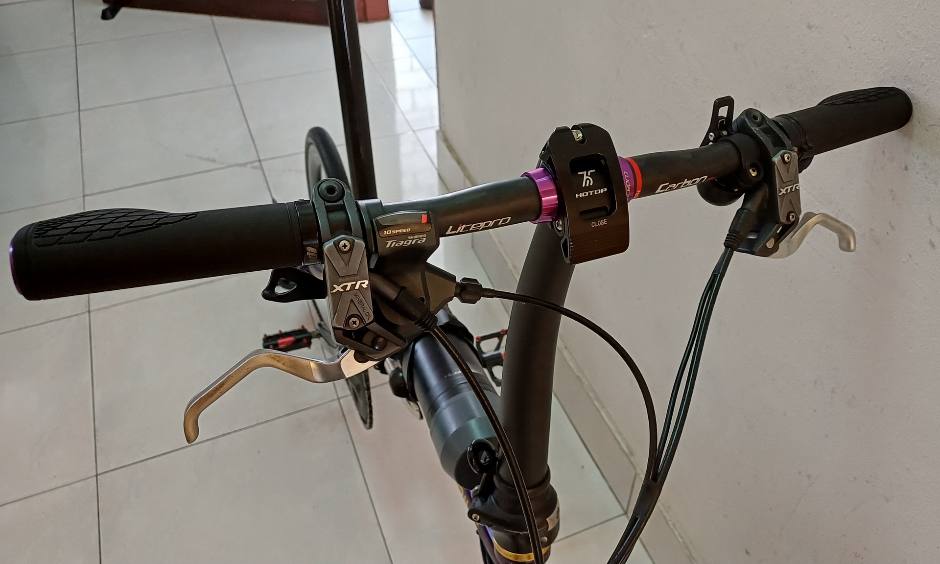

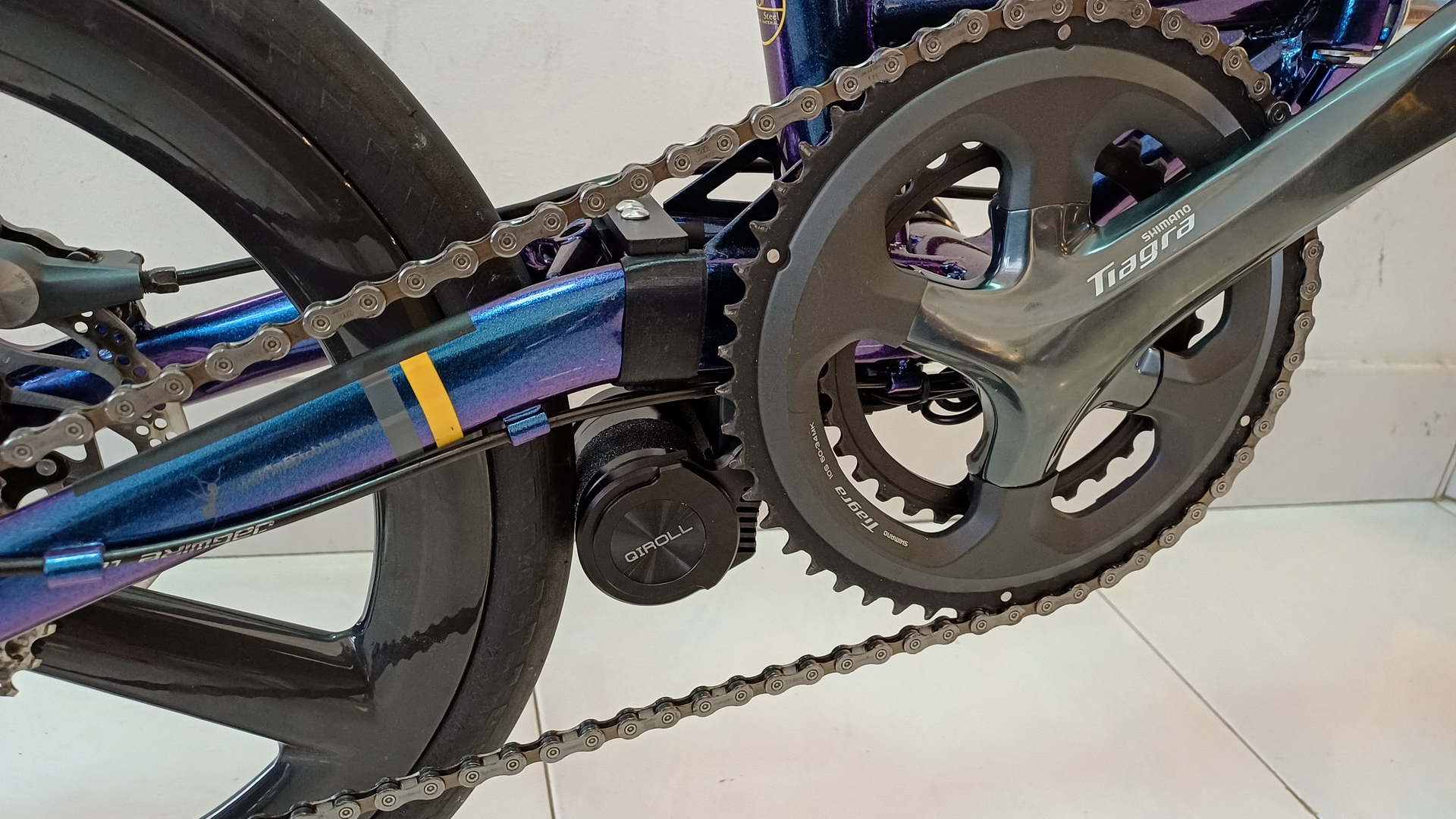

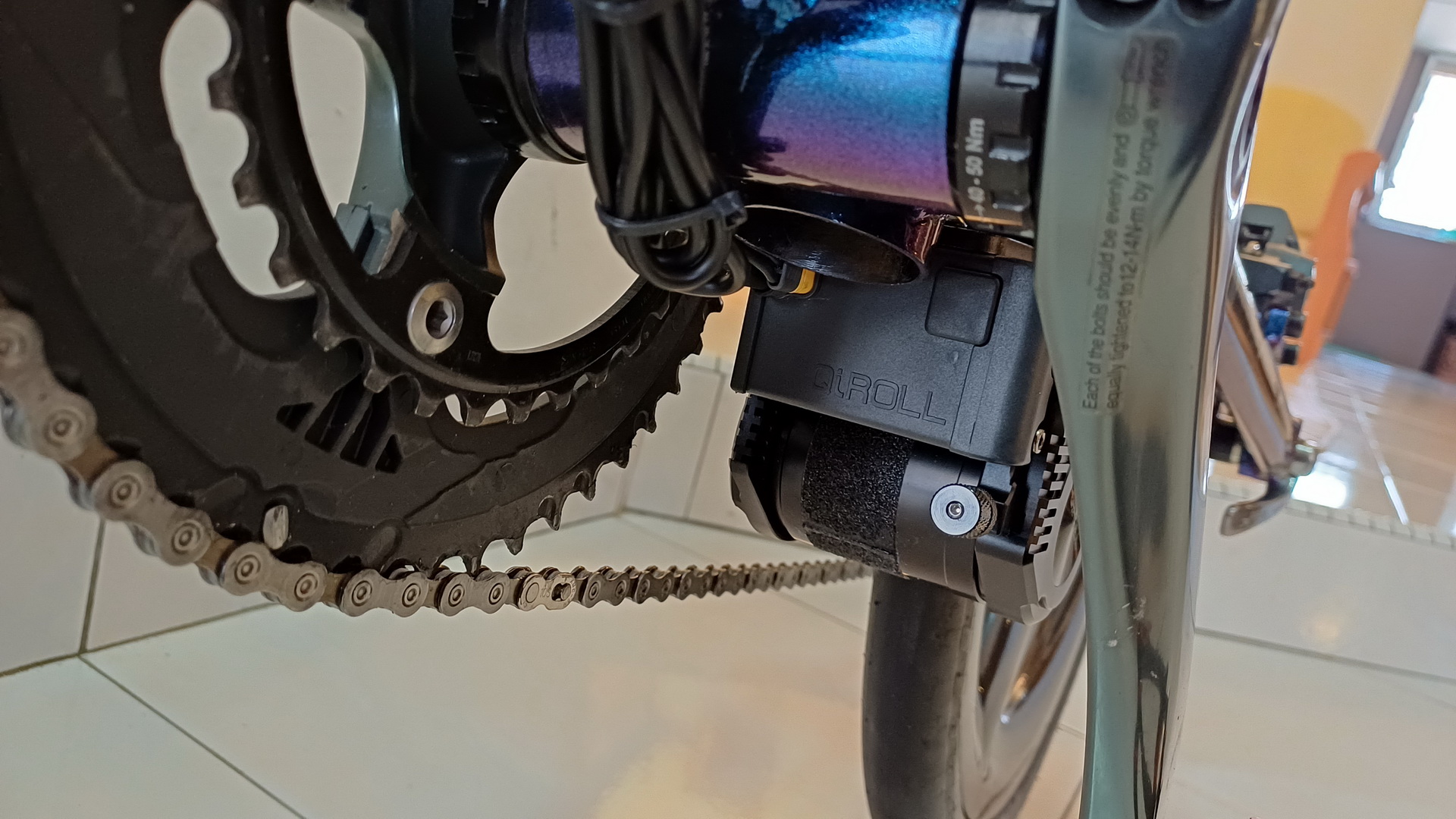

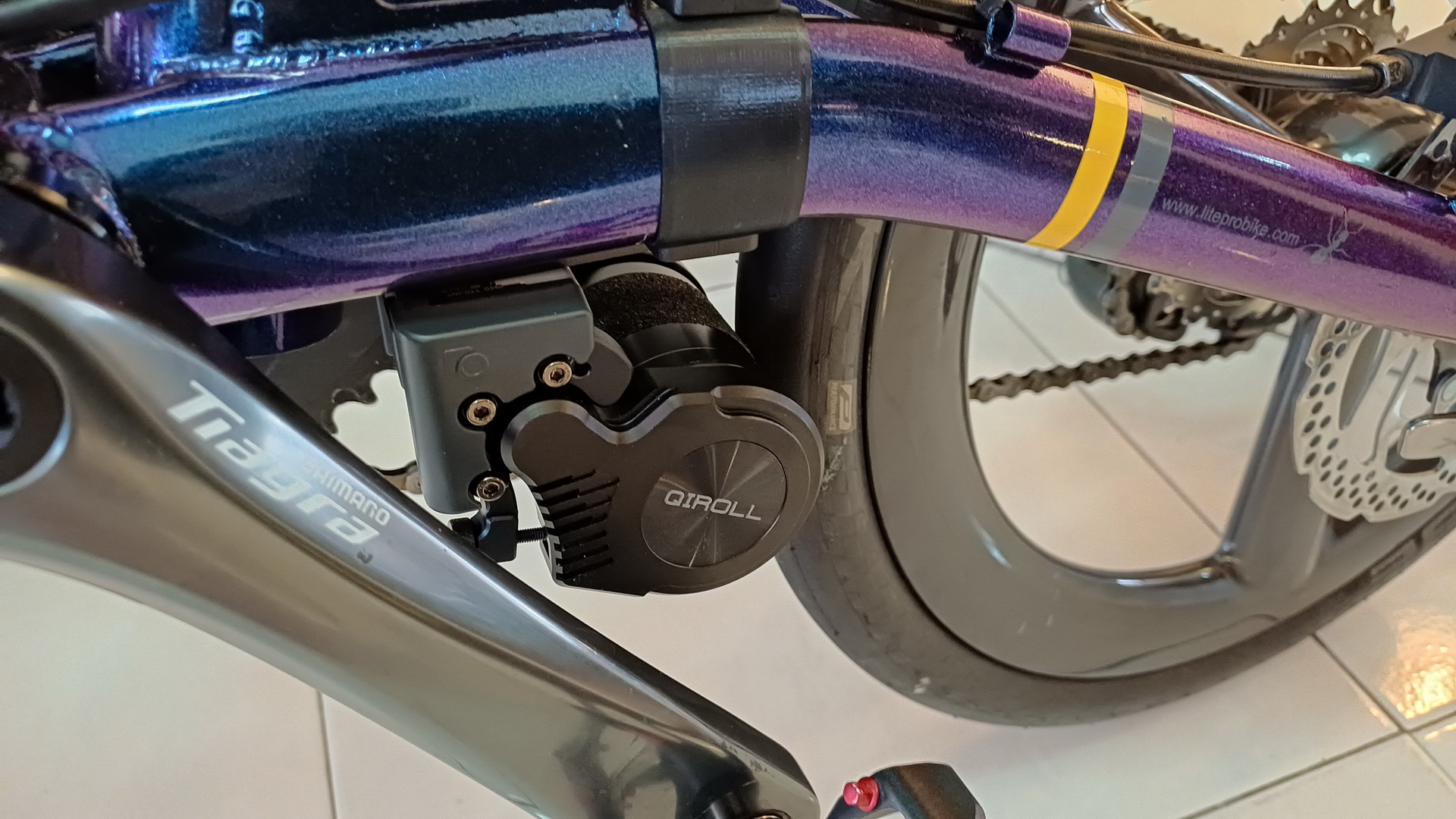

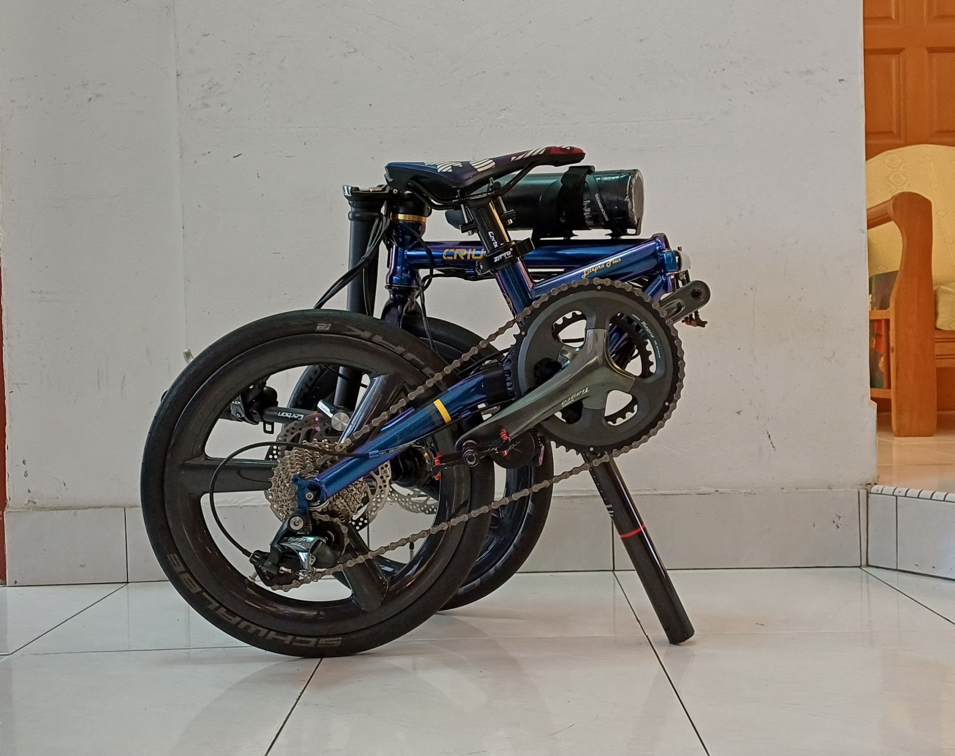

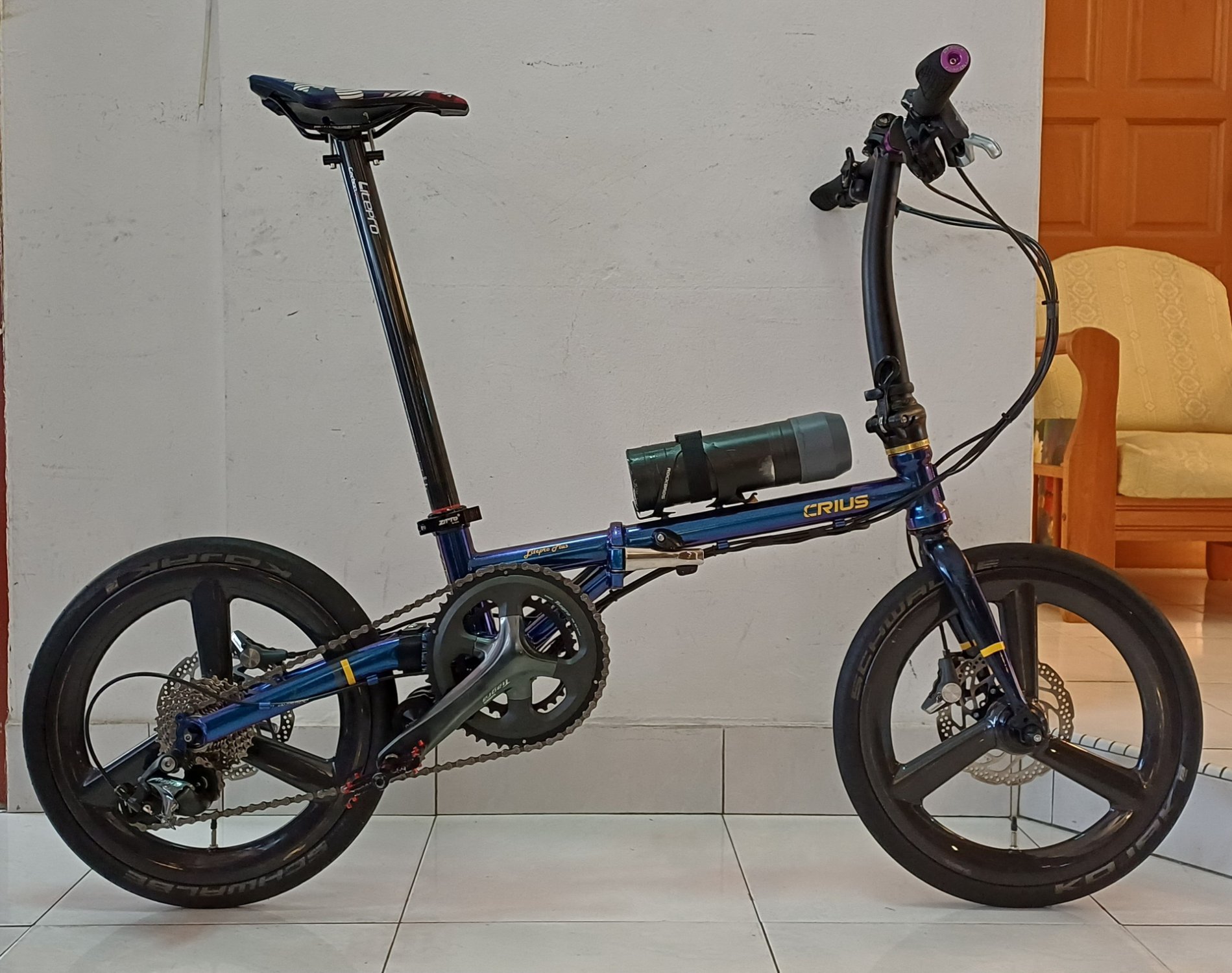

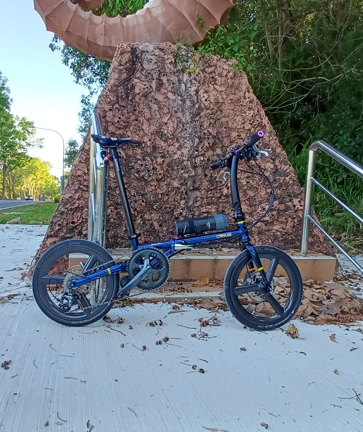

QIROLL Prototype 400W+ finally installed.
Hey guys, sorry for long absent, finally i got a bought a small 16" inch folding bike to test out Qiroll's prototype 400W+ unit. Due to its size 400W+ could not be install on my road bike or any short rear frame wheel base. So this 16" wheel folding frame have longer arm to fit between the wheel and bottom bracket. The unit looks big but upon testing by riding around the neighborhood it does have torque power. I haven't ride up the hill yet but later hopefully this evening. Happy with my clean stealthy build. Will post my finding about its performance soon. Btw video of 400W+ in action is on my twitter post here: https://x.com/SupermotoXL/status/1946818025052836317
TEST RIDE #1: QIROLL Prototype 400W+
Note to Qiroll product developer; Here's my latest finding when testing your prototype 400W+ unit.
  • Weird knocking sound: 1st day test ride was ok when riding first 2km on flat road. However on 2nd day after i climbed a total of 4 km of hill climb with gradient of 15% slope angle (Still have to but a bit of 50% effort to pedal) the unit started to have this "knocking" sound every time i trigger the throttle button. Sound like a hammer knocking my bike frame. I didn't see anything loose on the motor mount and the clutch roller is still tight. Something inside the motor is acting up.
  • Battery consumption: By pressing full throttle on the button (Sport mode/RED LED); 4km of hill climb with gradient of 15% slope angle (with 50% effort to pedal) + 3km of flat road riding (no pedaling) = Consumed/drained 2x bar on my battery.
  • Re-gen braking not working: When pressing the "Circle/round button" it didn't slow down or stop the motor. But the Sport (Red LED) to Eco (Blue LED) modes works.
  • 400W+ vs old PRO impression: I don't feel much difference in term of speed maybe probably because i'm on 16 inch bike but the pickup/acceleration especially going up the hill can be felt as it it perform better than 320W PRO. The 400W+ roller unit slips a lot during acceleration probably due to having more torque than 320W PRO so i have to put the clutch more contact pressure to the tire surface.
I'll try to make test video when i have time for it, right now i have to do more adjustment to my bike ready for long distance city ride soon.

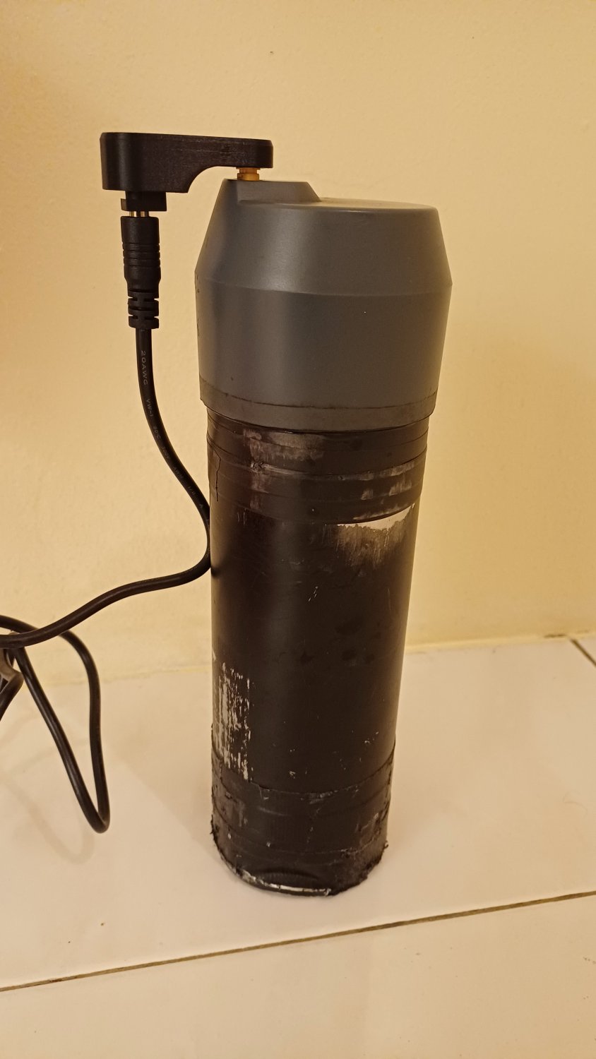

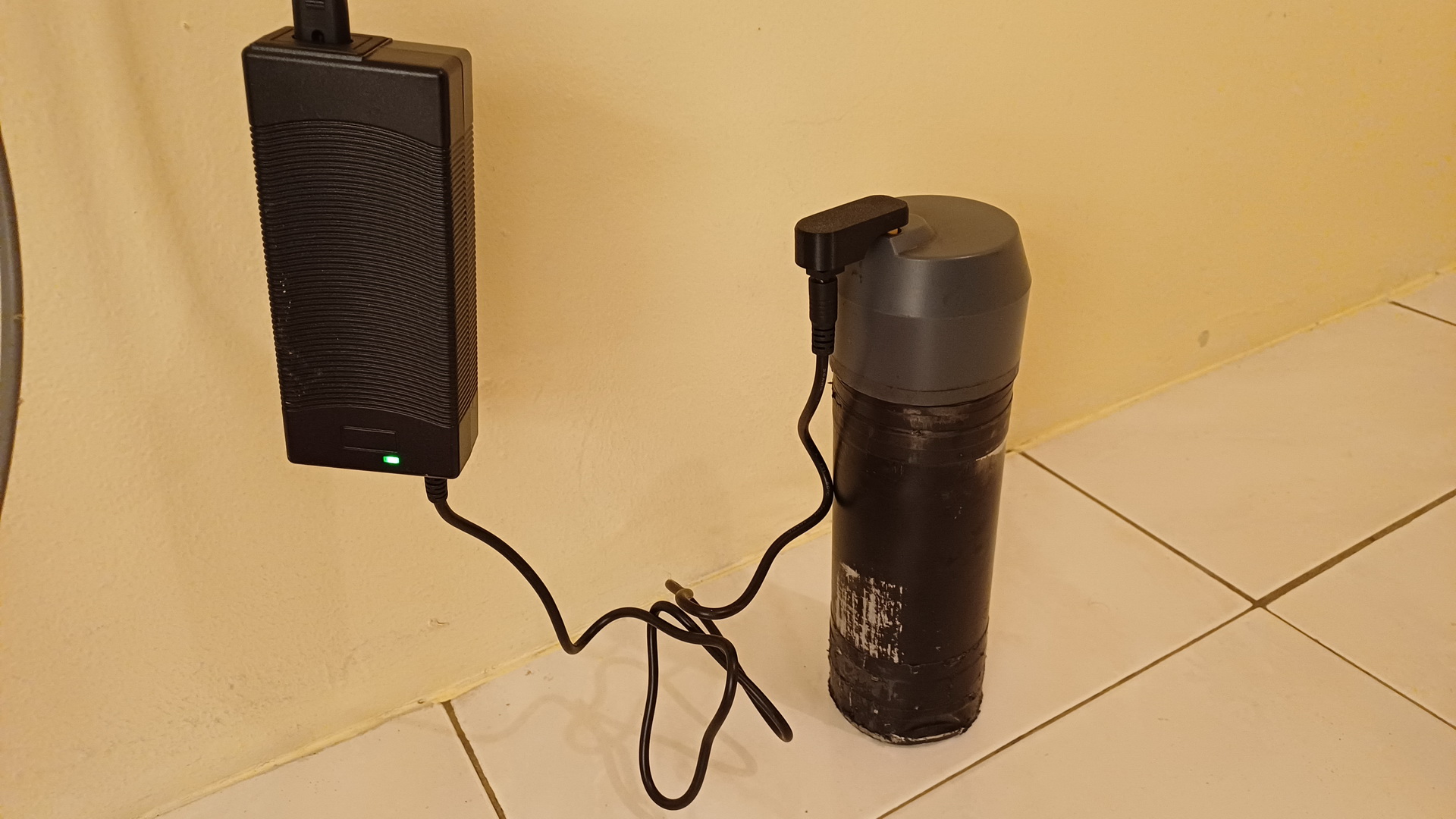

H70 battery problem.
Has anyone encounter this problem?
Today in the evening during cycling commute towards home from my office; half way on the road the Qiroll unit stop working. I saw my battery showing 2 solid bar blue LED light lit indicating i still have some power left in the battery pack but it won't throttle the unit. So i decided to unplug the battery connector and reconnect back hoping to reset everything, but now the battery blue LED light does not lit any light at all. That 2 bar light was gone!. I've check everything; the wire connection but nothing helps. So i unclutch the Qiroll and pedal manually back home....the hills are painfull!!
Reaching home after plug that H70 battery on other bike with Qiroll unit confirm it was drained or something. However it was quite odd because if it drained it should have show a steady decline through linear decrease of full 4 bar LED blue light level bar indicator until it started to blink dimly on the last bar. I suspect one of the Li-on battery cell is not "balanced" during charging or one of the battery cell failed or having lower voltage than other Li-on cell or BMS issues causing a quick drop of voltage.
When i charge back it took half hour (30 minutes) to show green light on the charging adapter indicating it done charging and LED showing full 4 bars of blue LED light lit rather than 3 hours usual charging time.
So here are my questions:
  • Has anyone encounter similar problem dropping power without warning (from 50% to 0% immediately) after re-plugin the battery plug?
  • Has anyone try or able to open the H70 battery canister? How to open it? ...i need to check if the Li-on battery cell is working or if BMS (Battery Management System) board was working or not?
Let me know if anyone manage to open the Qiroll battery canister and show how to.
Thanks in advance if anyone have solution to this issue. Much appreciate any help.
* Will email this issue to Qiroll support soon,

I was going to warn you to keep a close eye on the battery when charging it to see if it was heating up. If it got warm/hot anywhere that’d probably indicate cell unbalanced and could’ve been an indication of damage to a cell. It sounds like your battery’s BMS might’ve gone on the blink. Does your battery show charge level when it’s being charged? And, if so, while you were charging it, did it start at 1 bar or 0?
I don’t know anything about the QI battery itself. Good luck when you hear from the factory. It’s certainly possible that just charging it up all the way balanced it, but I would’ve been concerned about heat.
Anyway, I hope it all works out, @3dxl ! Keep us posted about what QI tells you to do. Is it in a warranty period?
I think Blueberry posted about having opened up a Qiroll battery, you might send him a message about details if he doesn't respond to this thread. I suspect that the plastic cap may be glued onto the aluminum tube which may have to be destroyed in order to open it up. Keep us posted.

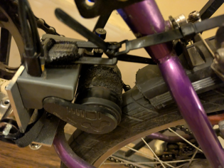

On another front I've found that my old used Pro works surprisingly well with the 24v battery from my mute model. I have several Ryobi 18v 4ah power tool batteries that I want to wire 2 in series and see how that works for the Pro.
Adding supplementary pull from the rear seemed like far & away the simplest thing to try, so I tried it. First I bolted a short bit of stretchy strap + buckle to the motor assembly:
And when I'd finally added enough pressure for the motor to retain grip in boost mode, it was with a daisy-chained pair of reusable zip ties, hooked through a slot in a steel adapter which holds the rear fender:
Adding pull from the rear turned out to be viable, but not with even "extra strong" releasable zip ties: the issue isn't the strength of the zip tie itself, it's the limited grip from its little nylon teeth, which eventually loosen up. Early in our Toronto -> Ottawa -> Montreal trip I picked up a steel coil spring and it's a far better solution, anchored to the rear rack to provide tension.
Other issues had us riding without the motor for most of the trip, including that a gash in the rear tire's sidewall (perhaps repeated bouts of belt-sanding during trials with sandpaper + inadequate zip-tie tensioning weakened the tire and contributed?) necessitated replacing the tire, and I only found a knobby 20" mountain bike tire in the local shops. Not a tragedy considering how flat most of the ride was.
Back home, returning to carpet grp tape in this setup seems promising. Only issue from today's test ride is that the tape self-ejected after 5 miles- seems like a very solvable problem. I wonder if having too much pressure against the tire could've been part of today's issue - the roller wheel was hotter than I expected when I stopped and checked after hearing the tape bail out. Anyone have insight on how much pressure is ideal, beyond "enough so that it doesn't slip against the tire?"
  • When charging the H70 battery once it was new last time and now an old battery there's no sign of heating up.
  • Qiroll battery when charging there's no charge level indicator showing up. Those "leveled" indicator (4 bar LED level) only works when battery is hooked up with Qiroll unit on bike. Only the charger display one green light on the charger adapter to show the charging indicator when its done. RED LED = Charging, GREEN LED = Charging completed/trickle charging.
  • I don't know much about their battery warranty period. I did email them yesterday night, hopefully they reply back soon.
Thanks for the info, i'll try to contact/pm Blueberry later. Btw how do you connect to alternative battery to Qiroll unit that have 3 terminal plug ends? Does Bafang/Hailong battery pack 48V works on Qiroll?
You only have to use two (+ & -) of the three terminals when using a standard non-proprietary battery. The third terminal isn't required. I think blueberry first posted this information also. I've run my Mute version with both 48v and 36v batteries and a buck converter that can drop voltage up to 60v down to 24v. BTW I've also used a 5v buck converter so the Qiroll or other batteries can be used as a battery bank to charge devices such as phone.
Hey! Yeah you can get the cap off the H70 without destroying it, though it’s rather tedious. I applied heat from a hair dryer and repeatedly slid a thin knife in the gap until enough of the adhesive was weakened to pull off the cap.
Obviously the battery will end up with scratches and you might want to reassemble with extra adhesive of your own at the end, but it should work. Be mindful not to short the exposed terminals and solder joints inside…
Hi Blueberry, Thanks for showing up with tips.
At first i thought it was a screw in type of cap like water bottle or jar. Glad you shared about the info that it was lock on adhesive glue.
Question: Was the content inside tight fit with wires dangling about? Fear if i slid a thin blade between the gap it might touch the board or wires and ended up shorting the circuit. Hearing that you mentioned "the battery will end up with scratches" hinted that it was a tight fit inside and thin blade will swing nearby.

I don't have any need to disassemble a QIroll battery but if I did I'd try using a cheap feeler gauge (smallest of the blades stiff enough to insert between the cap and can) along with careful use of a heat gun (or hair dryer). I'd try to not twist the cap avoiding breaking wires/connections.
