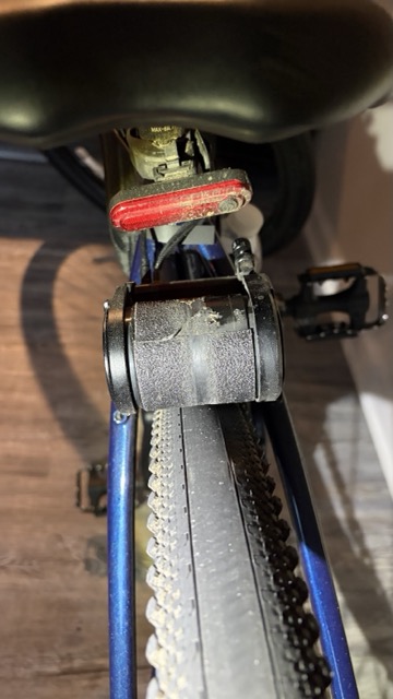

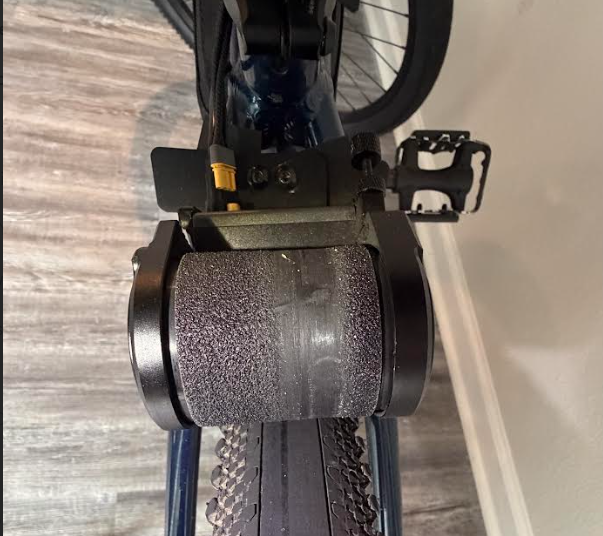

Just got mine today. First impressions are its does what I need to do. However the grip tape i got disintegrated mid ride, is it because I used a low quality one or too much pressure?
I forgot to take pics give more details as I was outside
3 km ride with friction tape, half way through i smelled burning or "melting" but thought it was from barbecue from a street parade (it was a coincidence), around 2.5km in i felt that boost was no longer boosting. Upon arriving I checked to see that grip tape was no longer there, with the black paint on the roller being completely worn off. I had applied the friction tape as 1 layer as I wasn't sure how much to apply and side by side.
So Im not sure if its just a bad tape that I got or a bad installation by me
(Also forgive me: I just learned and started my biking journey last month so this is basically my first "mod" to my bike)
Update: The tape no longer shoots out like a bullet, most likely because of the roller originally not being tight enough however im not sure if the roller is overtightened on the tire itself causing unnecessary wear. Is there a good way to check if its tight enough while prevent the tape ejection?
Are you using Qiroll grip tape? Ditch it. Because even if you clutch it right it does not provide full 1:1 ratio power. Somewhere along the ride i can feel it wasted/leaked out 30% of the roller through slippage.
No, im using the 3m safety walk kind, however when my location it wouldnt arrive fast enough so I bought a cheaper one, but its kept rejecting till yesterday, however i feel like I have the roller pushed down too hard as the screw clutch is almost too tight to turn anymore (about 90% tightened) if that makes sense
I think roller too tight. Here quick tip how to get it right depends (on type of riding you want: full boost or pedal).
If want full boost while pedaling + non slip in the rain (my way) here's my setup:
1. Tighten the clutch, then turn ON the battery. Wait until the LED light turn "RED" behind the Qiroll roller unit.
2. Lift up the wheel and use your hand to spin the back wheel. Observer if the wheel can gradually rotate from slow to fast once the Qiroll start activated.
> If it too slow to pickup then speed loosen up the clutch a bit. Tight clutch will cause the roller to overheat and melt the friction tape glue then causes it to detached from roller.
> If it accelerate too fast from the start then it means the clutch is too loose and will wear off the friction tape and will slipped in the wet. Tighten it a bit.
3. Adjust it until you find the sweet spot.
Try it.
Update: followed your asvice and im definitely getting more range/tape. I also switched to 3M's tape for more adhesive power. However on the very last leg home on a uphill, I guess the torque on the boost aswell as my pedaling caused the friction tape to rub smooth, will probably tighten a little more tomorrow. In terms of ejecting tapes, I have not had a single issue in that regard since, even when constantly boosting(the first time I used it it was only pedal with slight boost on stop and gos.)
Tips going up hill to avoid killing the friction tape > Use easy gear, slow down don't force pedaling more than what Qiroll can pull but try pedal sync to Qiroll speed. If both roller and tire rotate it sync and equal torque/force even in wet condition it won't worn the friction tape. Mine survive 4~5 month without need to change.

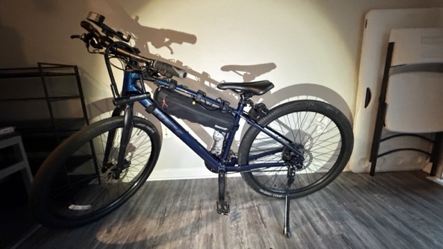

I am new to this forum, I was wondering. My bike is trek dual sport 2. weight: 180lbs/ 80kg. Motor: QR-Pro-max. 3M floor grip tape. I was wondering is this normal at first or it happen later on? rough surface part kind gone (grip tape still there) under 1km when I testing the moped mode/ peddal assist mode (pedal assist work so much better/ lighter peddling). Thank you

I have a trex fx3 and had this issue too originally. I had mine resolved by tightening the manual clutch a little more. Im still experiencing some rubbing off after 25km/14miles of use. I think because of my weight (10lbs heavier than you) having 2 layers isn't thick enough where even with my clutch almost fully down, the torque isn't enough to help push me especially on the uphill, im thinking about applying a third layer soon and testing out. Not worried about the heat because its getting colder. Will get back once I try it out
I only apply like 1 layer, I guess I have to apply more
It indicated slipping = means the clutch is not tight enough. Mine still use 1x layer and lasts me few months.

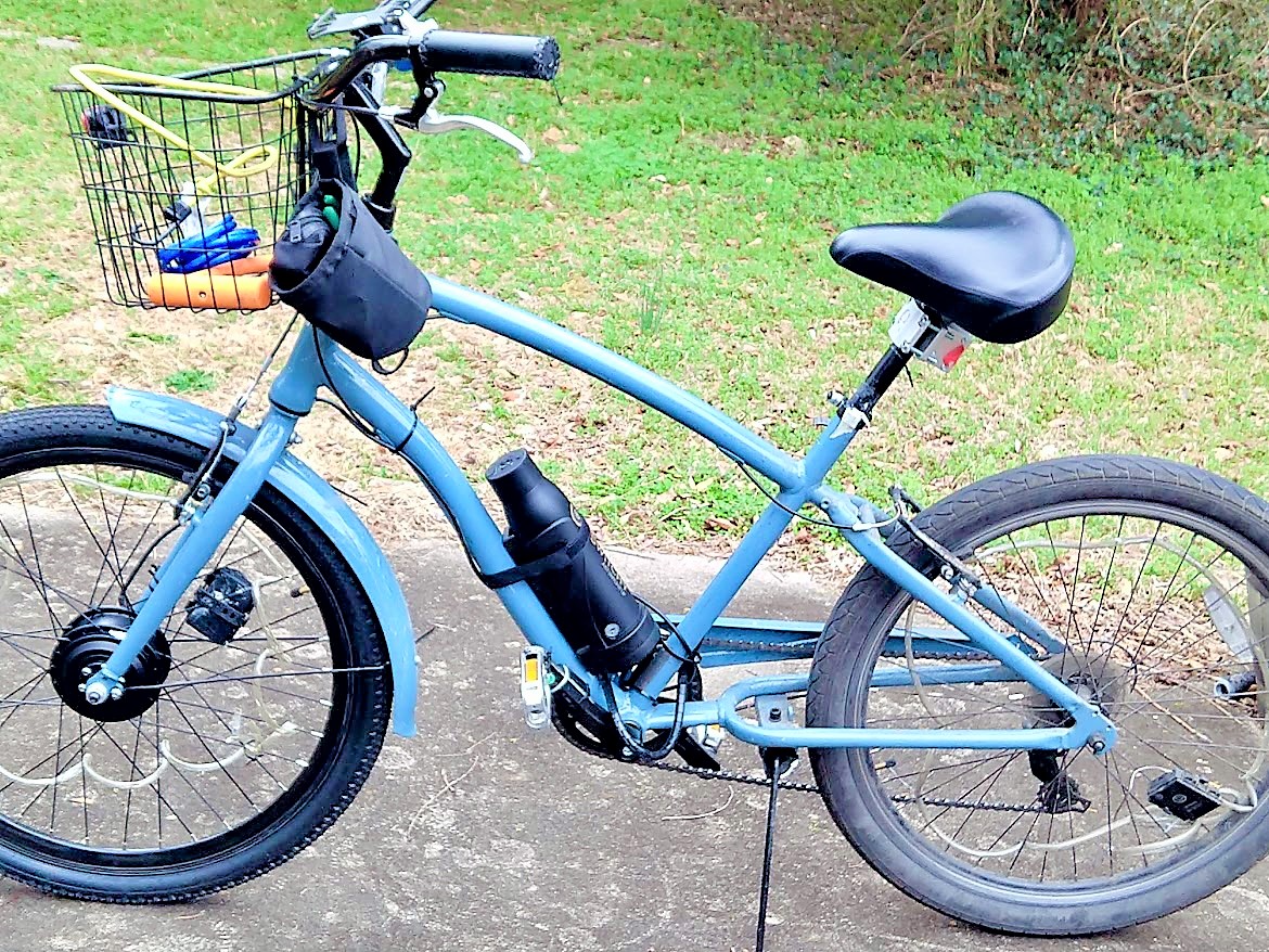

(By a bicyclist with a common man's (not an engineer's or bicycle tech's) POV regarding bicycles and motors used to assist bicycling. In other words: Press button - how fast can it go and for how long, and will it take me up that damn hill without too much effort on my part.)
I was looking for a motor for my 20" folding bicycle which I customized with cruiser handlebars and a more comfortable seat. The bicycle seat and handlebars can be removed easily with quick releases and this makes it relatively lightweight and easy to fit into the tiny trunk of my Honda Civic with the trunk lid closed.
So when I went looking for a bicycle motor, I wanted something that would be small, lightweight and easily transportable, yet powerful enough to help me get up that occasional hill or long stretches of incline on my rides around town and outlying scenic areas filled with over 100 miles of bicycle trails, parks, lake, mountains. Oh yes, did I mention, I wanted a kit I could quickly, easily, self-install without an engineering degree or bicycle shop tech expertise.
Previously on my other bicycle - a semi-recumbent - I had installed a front drive 250watt motor. The motor and battery added an addition 8-9 pounds to the bicycle. I didn't want that much weight on my smaller folding bicycle. What I found the most appealing were the friction drive motors. But the biggest complaints about these friction drive motors were:

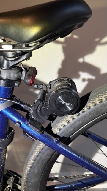

INSTALLATION
The motor can be mounted in 2 ways to drive the rear tire. One is at the seat stays or at the chain stays where many kickstands are mounted. Since I have rear fenders the seat stay mounting method would not work. Also, because my kickstand was located at the chain stay, I had to remove it and attach a rear chain stay kickstand which actually looks better than the original that came with the bike.
Chain stay mount.
The kit comes with a several sets of various sizes and screws and allen wrench tools to do the installation. Mounting the booster motor at the correct angle for the roller contacting the tire at the chain stays should be such that the distance from the front of the booster to the tire surface is approximately 2 1/2" which also happens to be the length of the allen wrench that you use to secure the bolts through the mounting plates. Then it's simply a matter of using the other smaller allen wrench to adjust the C ring so that it is about 1/8"-3/8" away from the tire with the rotating nut loosened all the way back and the end that touches the roller should be right up against the roller. You should also make sure that the center of the roller is not askew and is contacting the middle of the tire flat on and not at an angle. After you tighten the 3 nuts, the booster motor and roller should be in the proper angle and position.
To use the motor you need to tighten up the rotating knob such that the roller is touching the tire. You'll discover the right amount of pressure for the best result. I usually turn the knob till the tire makes contact with the tire and then give it another 1/2 - 1 full turn more. It will vary on how much wobble your tire has I suppose. The trick is to get the tire in contact with the roller such that one full revolution of the tire has as much constant contact between tire and roller. You don't want too much pressure or too little as that can cause skipping or undue tire wear.
Battery and throttle connected to motor.
Your almost through. All you have to do is connect the throttle cable and battery cable to the motor and put the battery in your water bottle holder. Finish up by neatly ziptying all the cables and you're ready to test drive.
Battery in water bottle holder.
