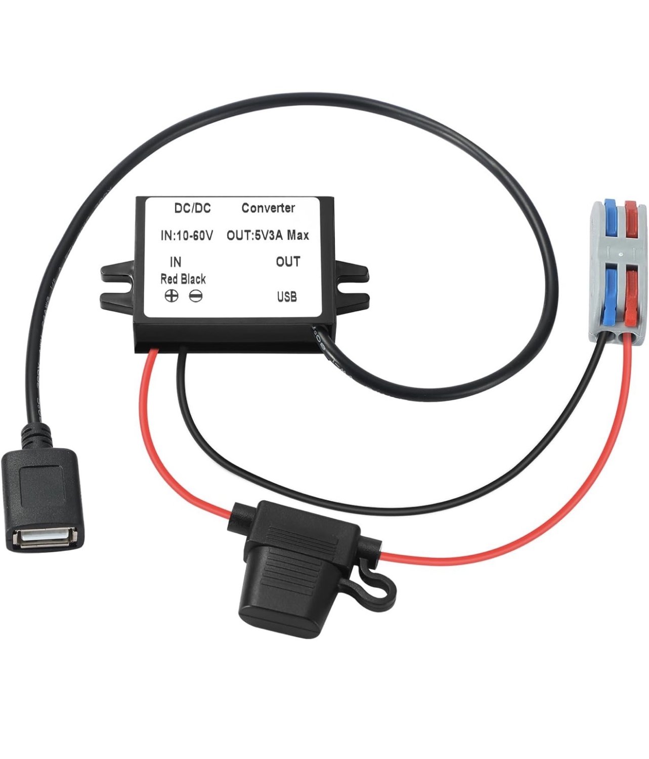

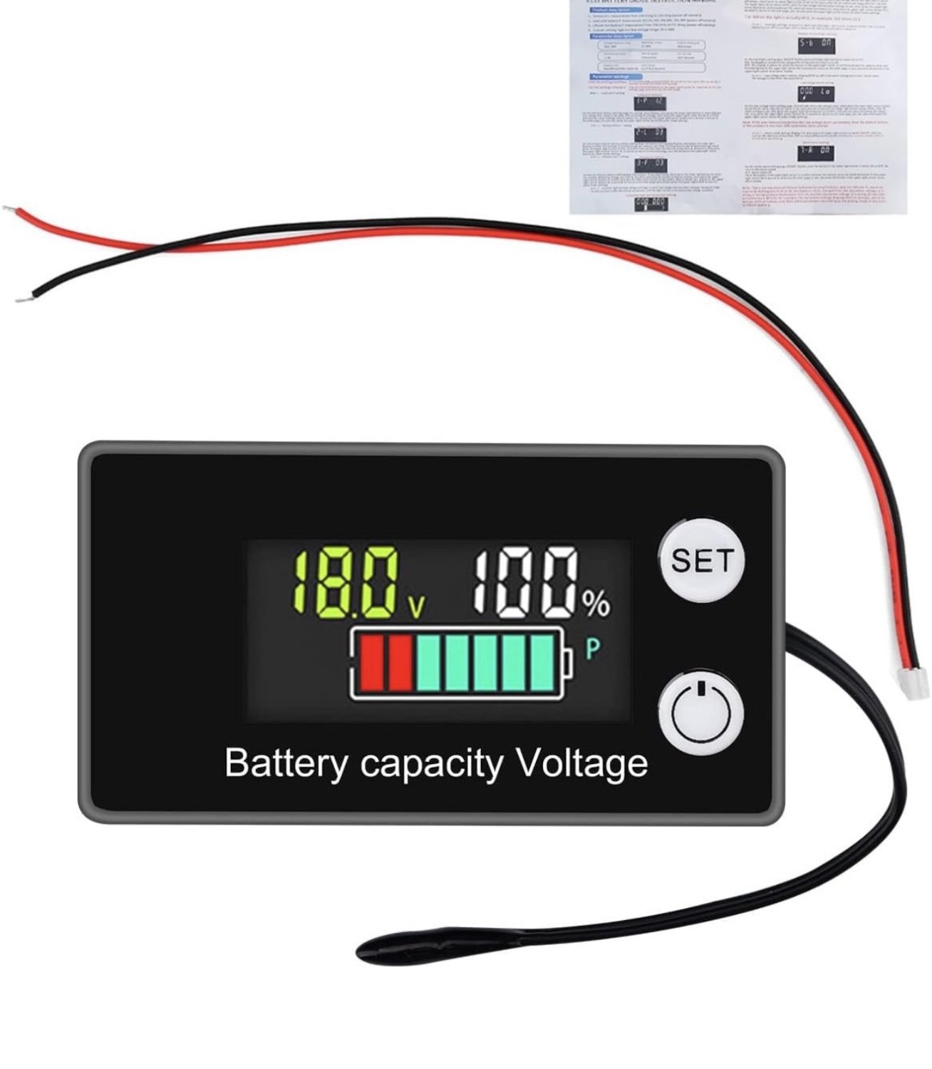

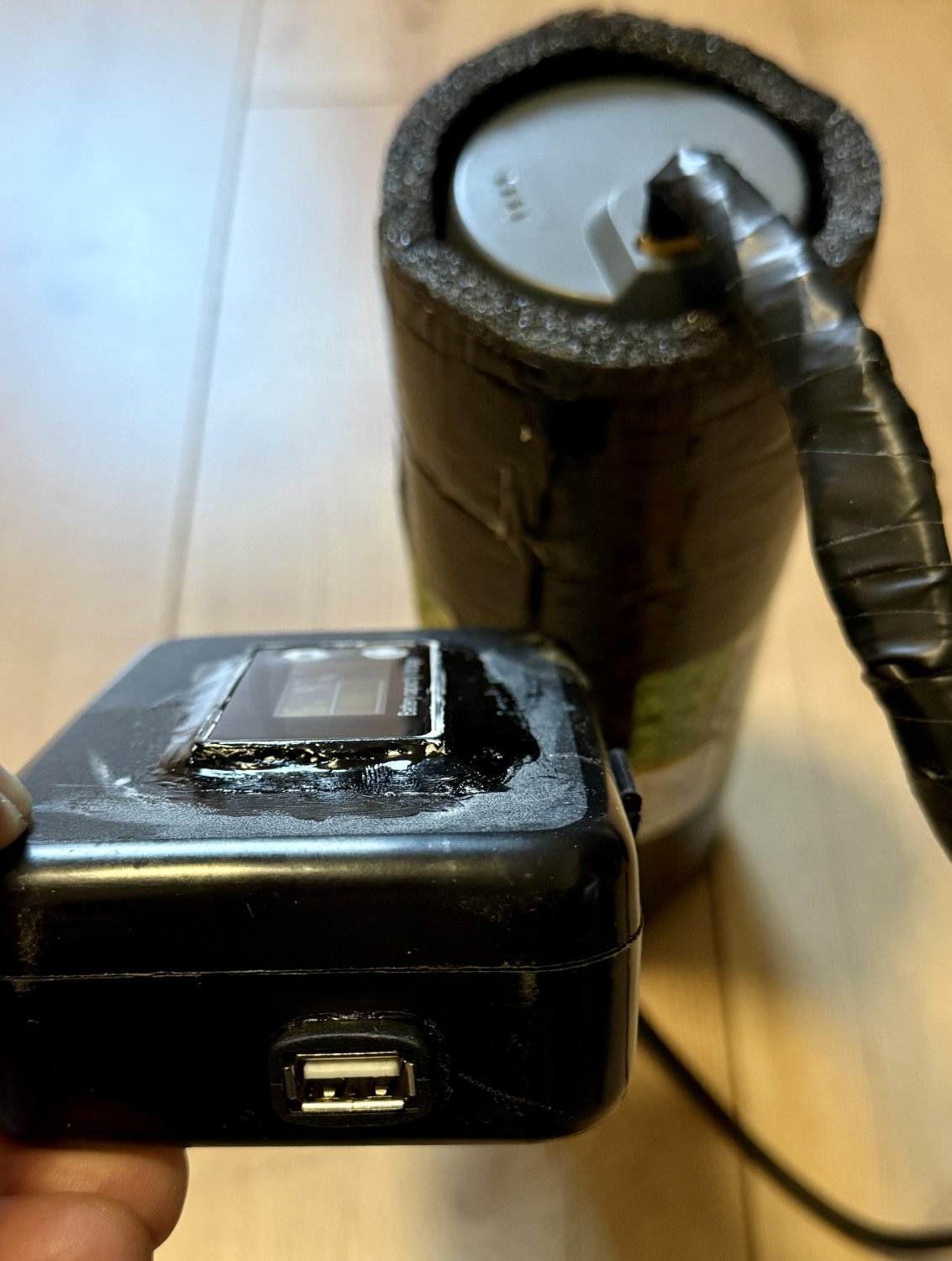

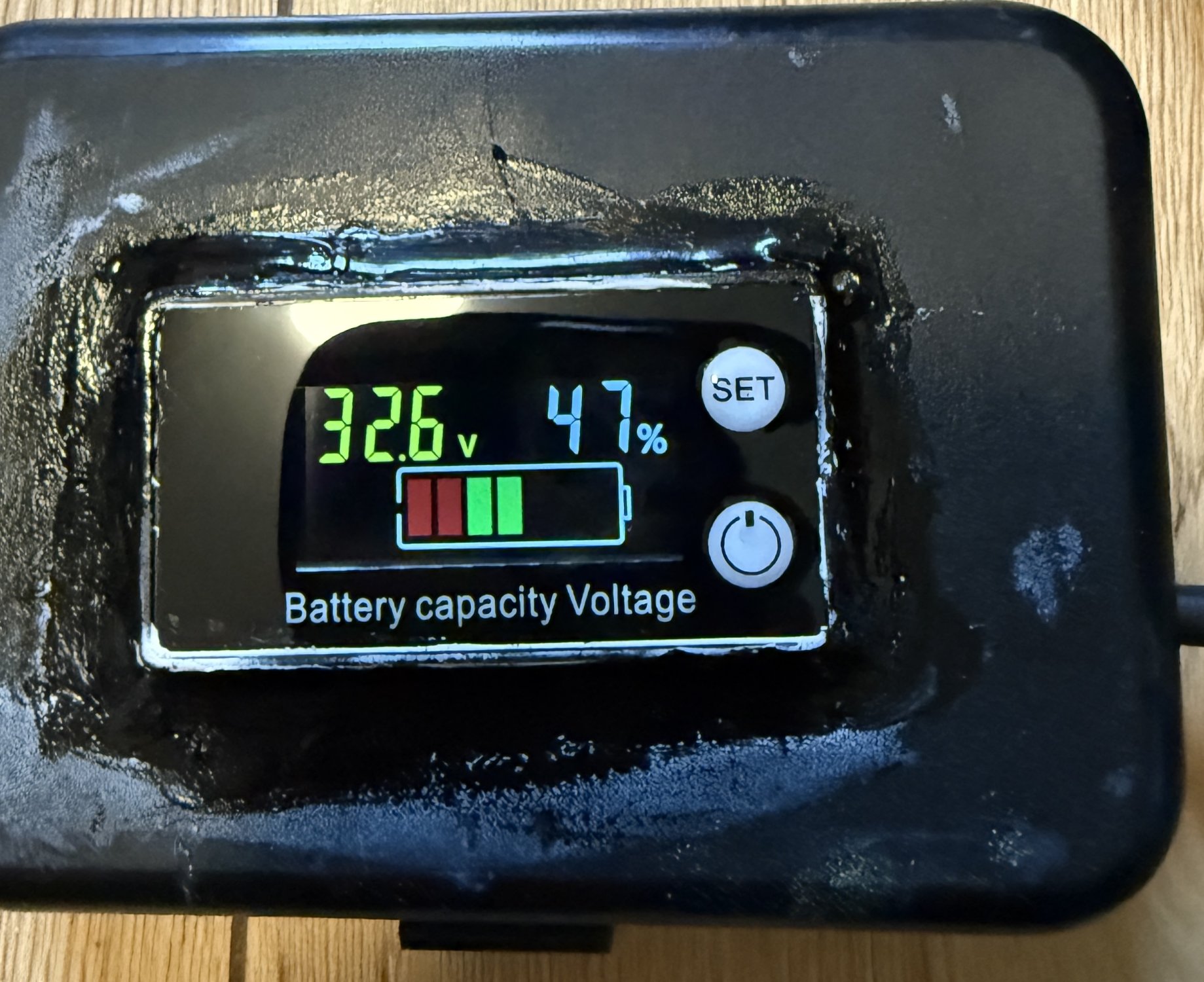

Maybe interesting for some people , I am not using my to much and I don t want the battery to die so I make a small box with an usb port so Incan charge mobil or other device when I go camping

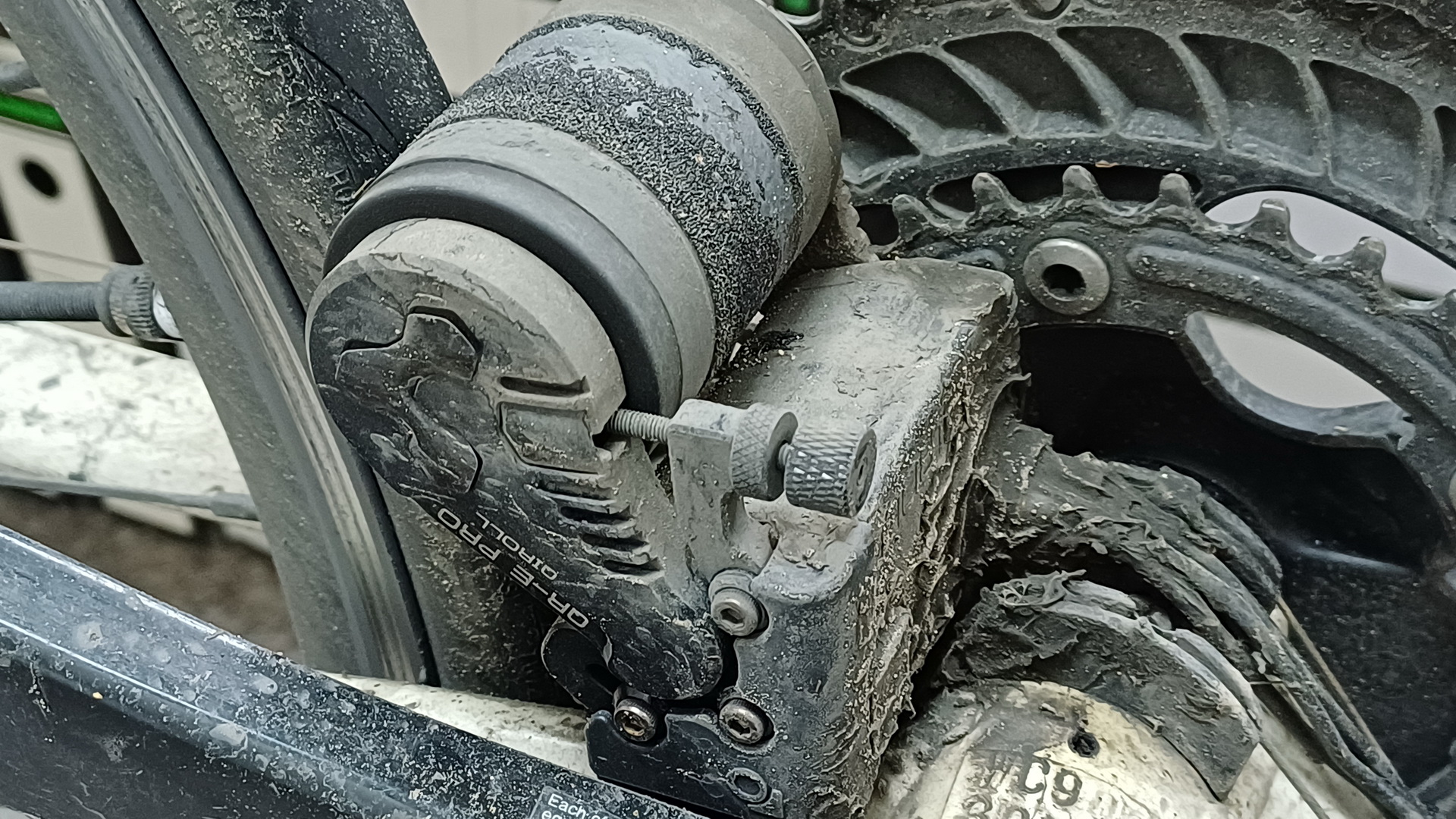

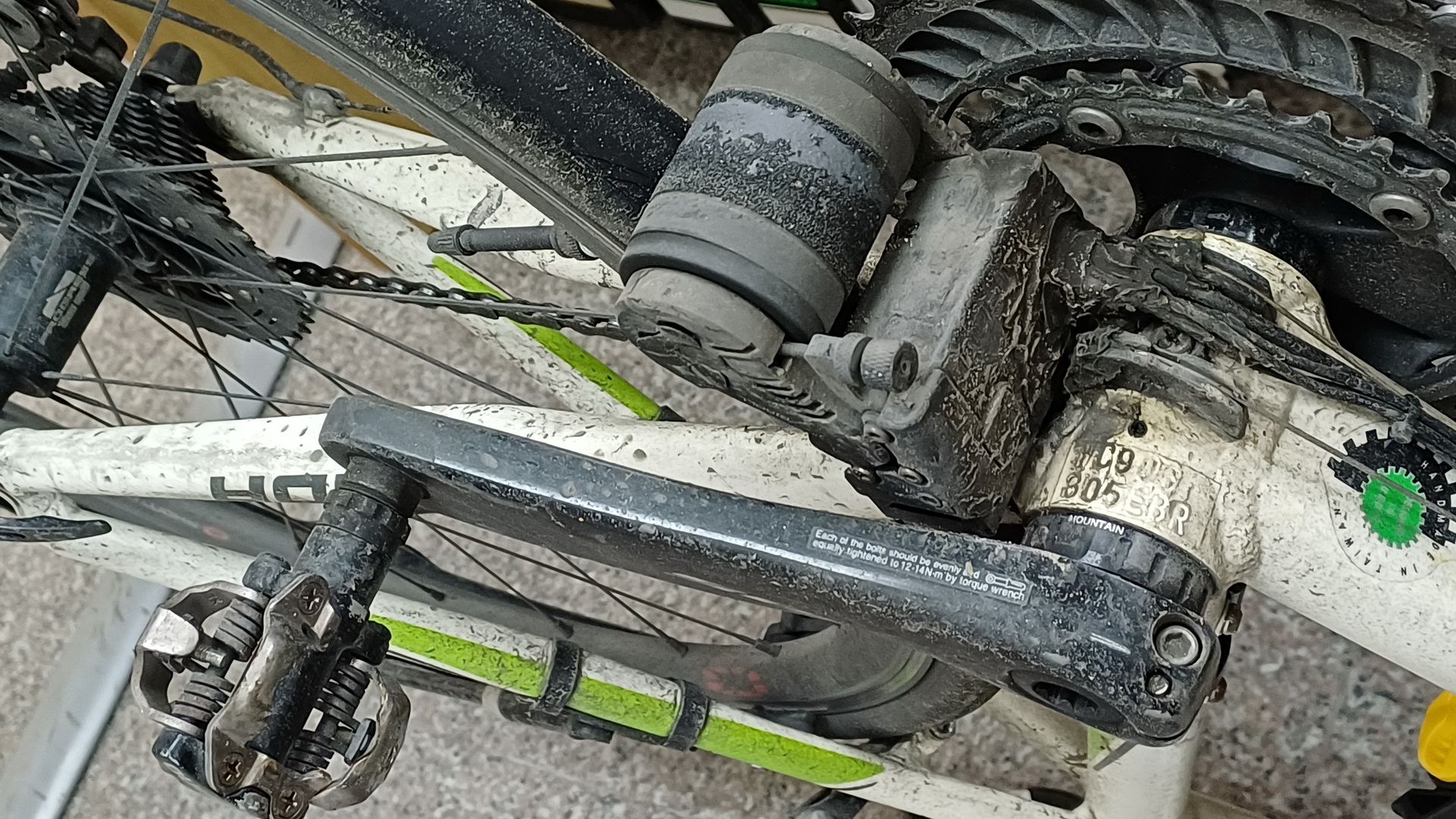

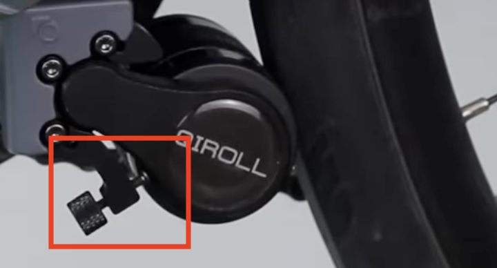

Hi everyone! I'm running a Qiroll motor on my Strida LT. Specifically, I'm using the QR-E PRO-MAX model.
The stock setup uses a fixed screw to set the gap, but as my friction tape wears down and my tire pressure drops slightly, a gap starts to form. This leads to slipping and power loss.
Since I'm on a Strida with standard tires (I can't pump them up as high as road tires), this happens more often than I'd like. I'm tired of manually adjusting that screw every few rides. Does anyone have a better way to keep the motor tight against the tire automatically? Thanks for any advice!

I didn't know they still made friction drive motors. Isn't it tensioned by a spring? I would recommend going to a mid-drive or hub drive motor kit instead.
I used a spring loaded door hinge, the kind that you can adjust tension. The ones with a strong spring worked best but there can be fitment issues due to the length of the hinge so it depends on the mounting location and clearances for your specific bike.
Thanks for the suggestion! I actually considered buying a new e-bike, but I really wanted to try modding this classic Strida LT first. I only need a little boost for starting from a stop, hitting hills, or fighting headwinds in the city. It’s more about giving an old bike a second life than having a high-power machine!"
"I've actually seen your thread and the photos you shared! It’s a genius way to maintain constant downforce. I’m definitely going to give the spring-loaded door hinge a try. Thanks for sharing such a clever solution!"
Post up pictures when you get around to it. This thread has a lot of potentially helpful information on a number of aspects for Qiroll users.
I've used a few different types of spring door hinges, they all worked for my applications. They tended to be made of stainless steel which can be a challenge to drill mounting holes. I found carbide bits and oil helped (along with patience).

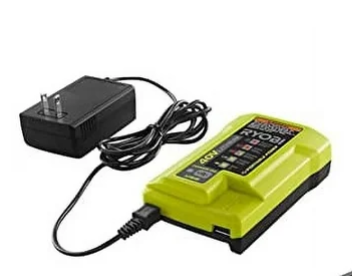

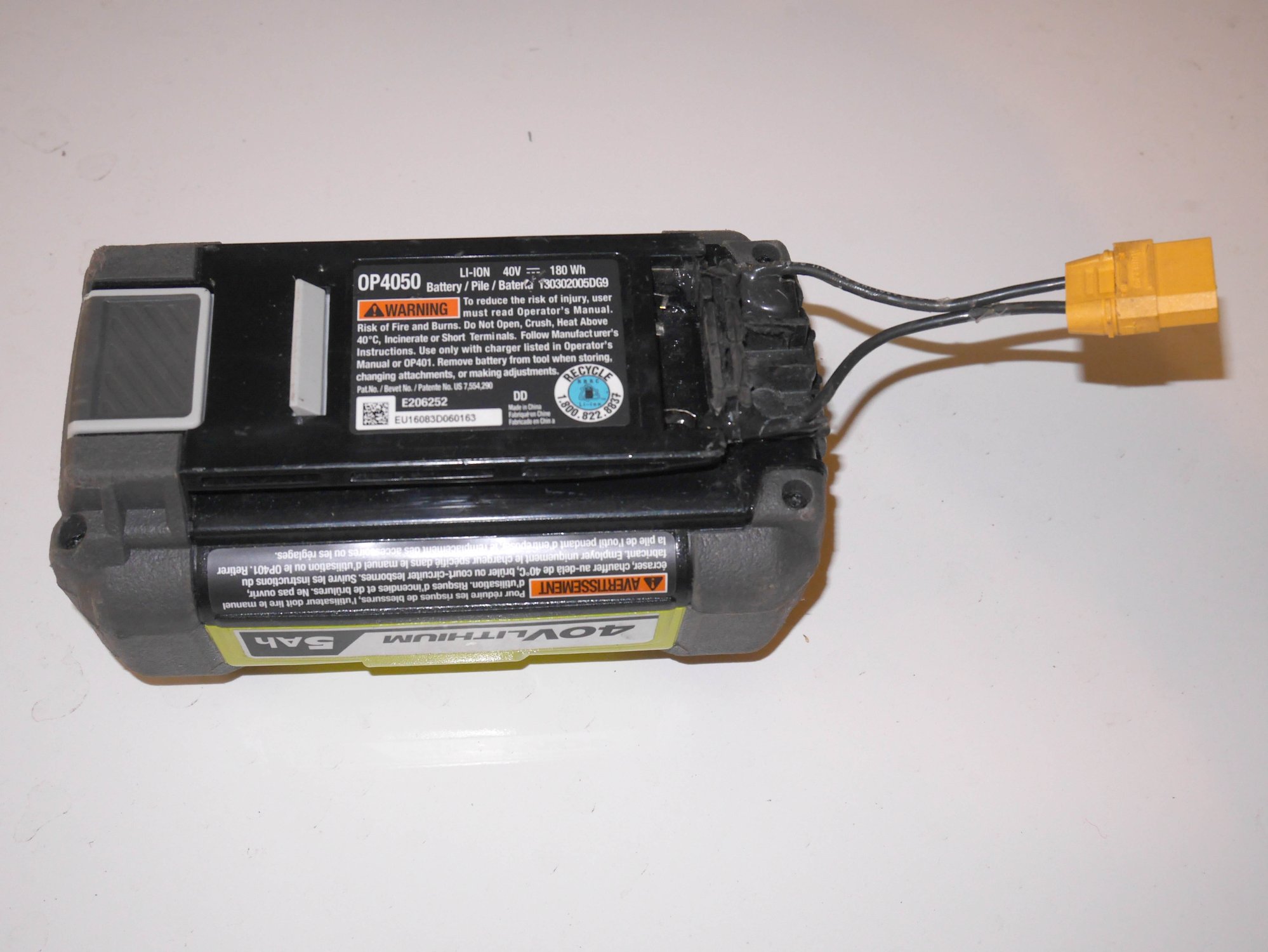

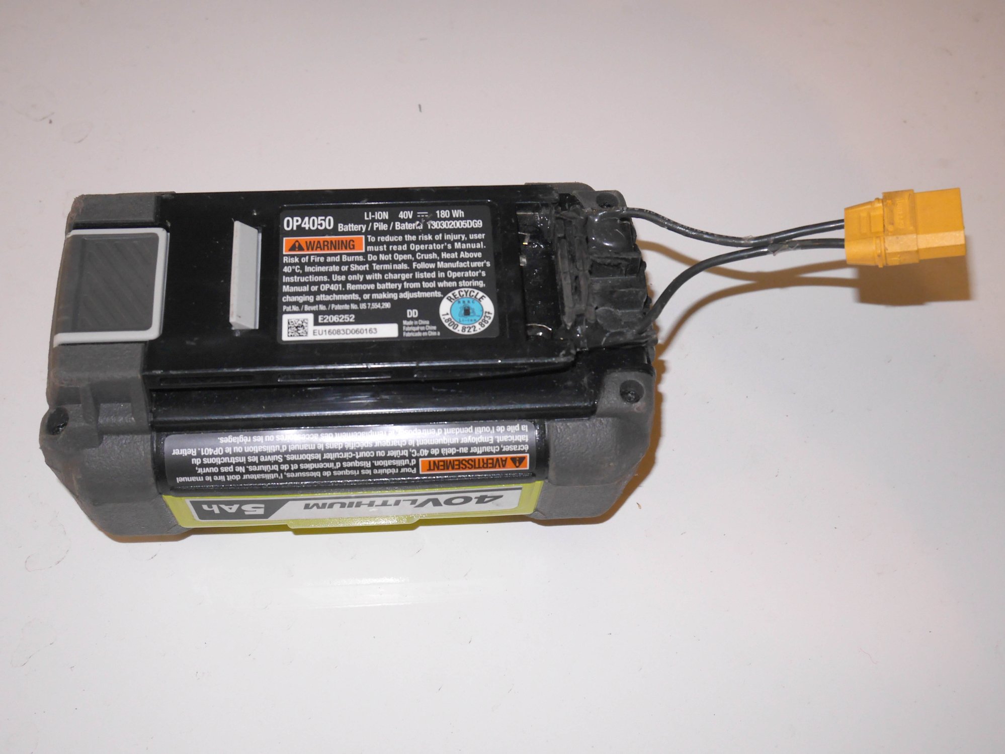

The Ryobi 40V tool batteries are actually 10S and I have used mine to run my ebikes. . I had to make an electrical clip ro connect it to my bikes. Hobbyists will sell you a better 3D printed part. Genuine Ryobu batteries are welll made. Some are small enough at 120WH to meet some airline regulations for carry-on, but I believe most lithium should be banned from airplanes. However, you should be able to buy one in the destination country.

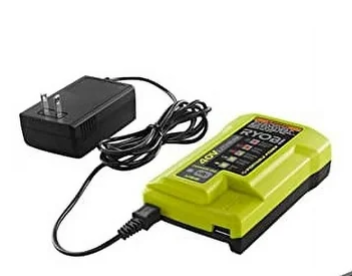

Recently, I was at an Ryobi discount outlet store and they were selling these chargers for $5 USD. Even if it didn't work, the unit could be rewired as a battery cradle. Of course, I bought it to use as a charger,I don't have to run my ebikes on these batteries these days, but I did 8 years ago.

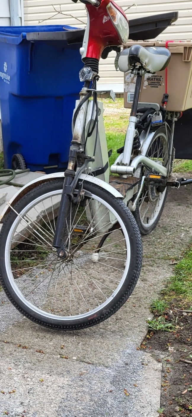

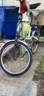

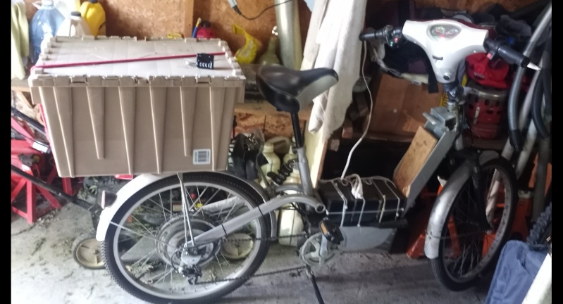

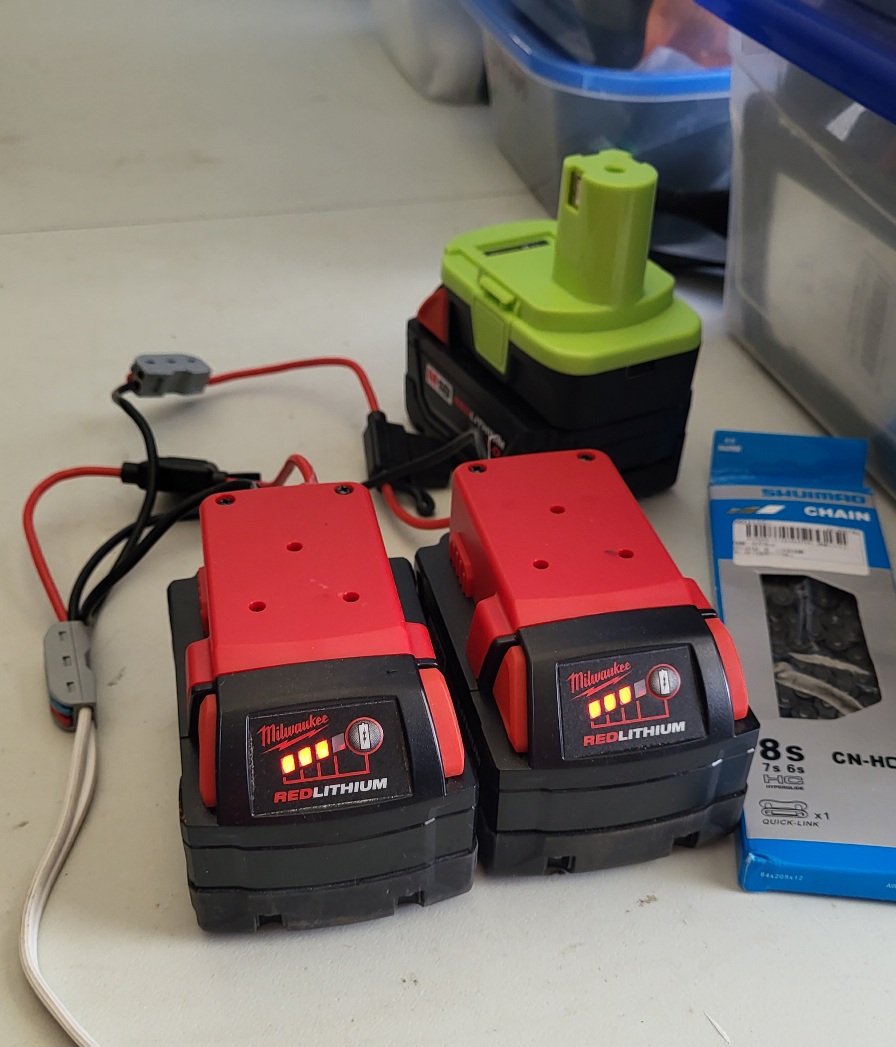

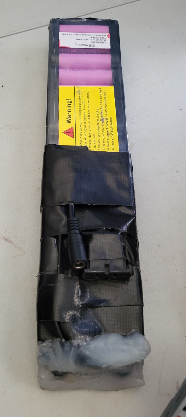

I use my old POS ebike to get groceries,..
It's a 250W DD motor with regen and the three 12VDC SLA batteries crapped out, so I bought an 8AH Lithium Ion scooter battery to replace it,..
I wired it in with polarized extension cords.

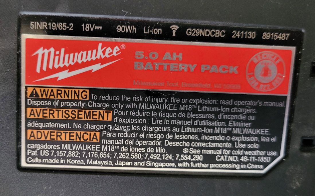

I also bought battery adaptors so I can use my Milwaukee 18V 5AH batteries with two in series to get more range.
Everything is working fine, including the regen.

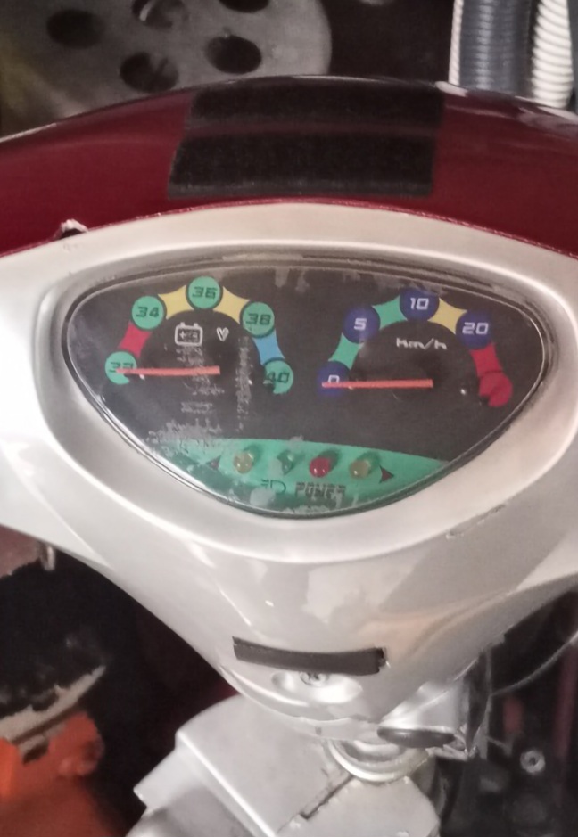

We recommend choosing a battery with a single port for both charging and discharging, as this type supports our regenerative braking function.
I'm not sure what's going on with that with my batteries, but the voltmeter on my display is behaving the same way as it did with the SLA batteries.
The scooter battery has a separate charge port, and I'm not sure what's going on with the Milwaukee batteries?
I think that the BMS is bypassed and the regen is directly connected to the cell pack?
I figure that the regen just dumps into the battery?, unless there's a diode to prevent reverse charge on the Battery output?
