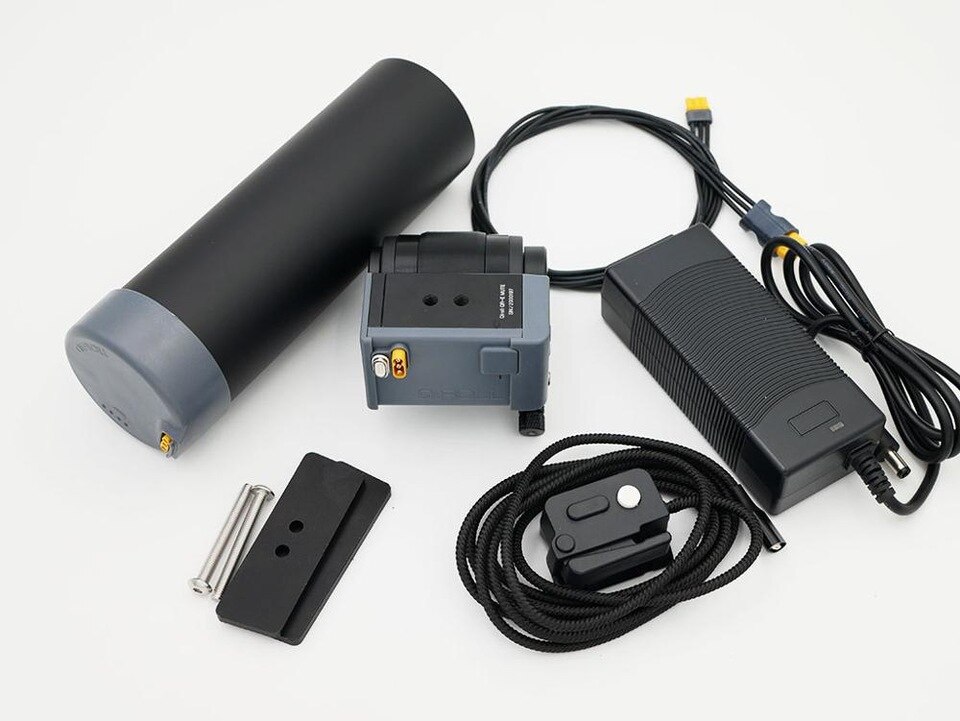

A big concern for me before ordering this kit was the length of the throttle cable as I have cruise handlebars that also needed the cable long enough to clear when I took off the handlebars to pack into my trunk. I needed at least 70 inches/178 cm. The throttle cable is 78.5"/200cm. BTW, the battery cable is 27.5"/70cm.
Also included are a number of different size mounting plates and various sets of mounting plate bolts as well as zip ties and extra friction roller replacement plates.

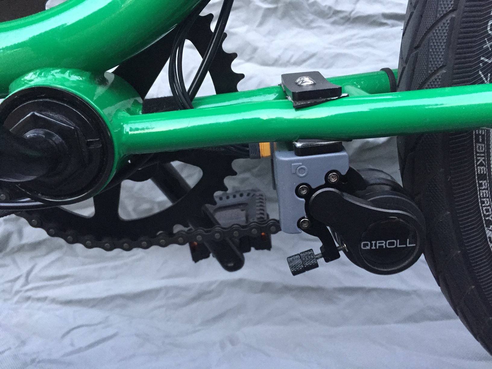

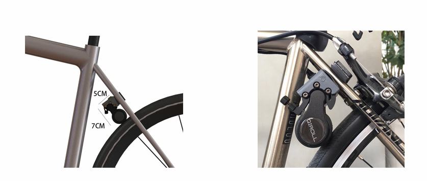

The motor can be mounted in 2 ways to drive the rear tire. One is at the seat stays or at the chain stays where many kickstands are mounted. Since I have rear fenders the seat stay mounting method would not work. Also, because my kickstand was located at the chain stay, I had to remove it and attach a rear chain stay kickstand which actually looks better than the original that came with the bike.
Chain stay mount.
The kit comes with a several sets of various sizes and screws and allen wrench tools to do the installation. Mounting the booster motor at the correct angle for the roller contacting the tire at the chain stays should be such that the distance from the front of the booster to the tire surface is approximately 2 1/2" which also happens to be the length of the allen wrench that you use to secure the bolts through the mounting plates. Then it's simply a matter of using the other smaller allen wrench to adjust the C ring so that it is about 1/8"-3/8" away from the tire with the rotating nut loosened all the way back and the end that touches the roller should be right up against the roller. You should also make sure that the center of the roller is not askew and is contacting the middle of the tire flat on and not at an angle. After you tighten the 3 nuts, the booster motor and roller should be in the proper angle and position.

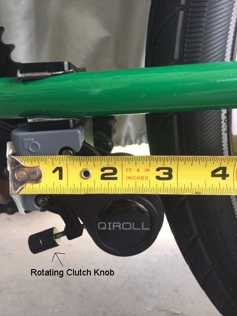

To use the motor you need to tighten up the rotating knob such that the roller is touching the tire. You'll discover the right amount of pressure for the best result. I usually turn the knob till the tire makes contact with the tire and then give it another 1/2 - 1 full turn more. It will vary on how much wobble your tire has I suppose. The trick is to get the tire in contact with the roller such that one full revolution of the tire has as much constant contact between tire and roller. You don't want too much pressure or too little as that can cause skipping or undue tire wear.

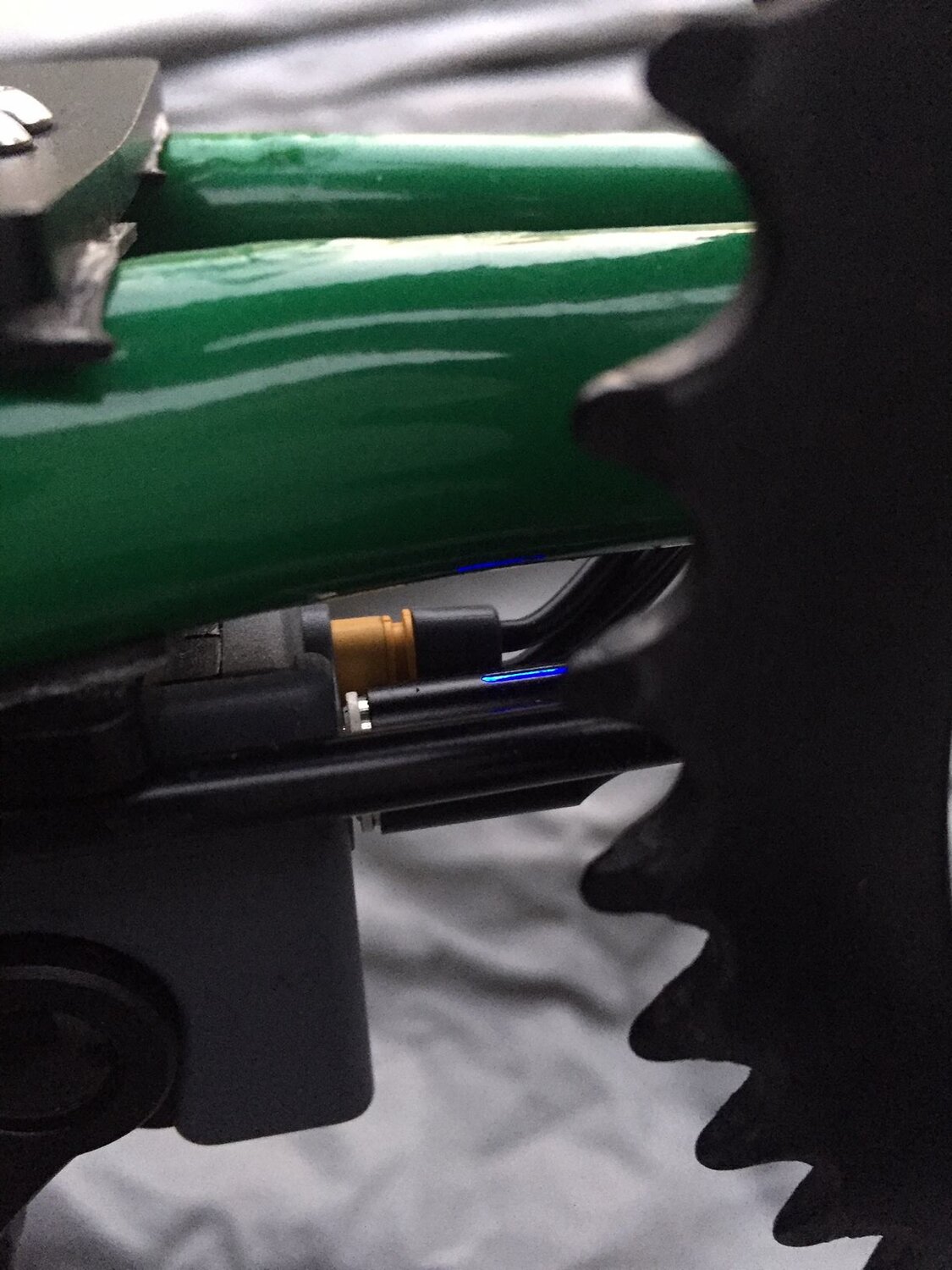

Battery and throttle connected to motor.
Your almost through. All you have to do is connect the throttle cable and battery cable to the motor and put the battery in your water bottle holder. Finish up by neatly ziptying all the cables and you're ready to test drive.

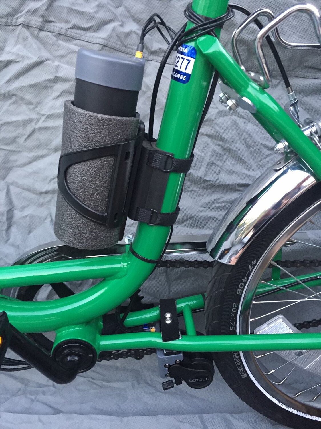

Battery in water bottle holder.

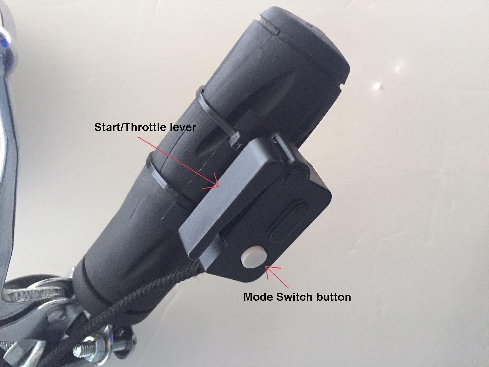

I was a bit confused at first on how to use what I called the throttle. This by the way is mounted on the underside of the left handlebar grip. You operate it by depressing the lever with your middle or ring finger which gives you power. The button is also accessed with either finger to change the mode in which your motor will operate.
Throttle zip tied on the underside of left handgrip positioned so that ring or middle finger can press lever and reach mode button.

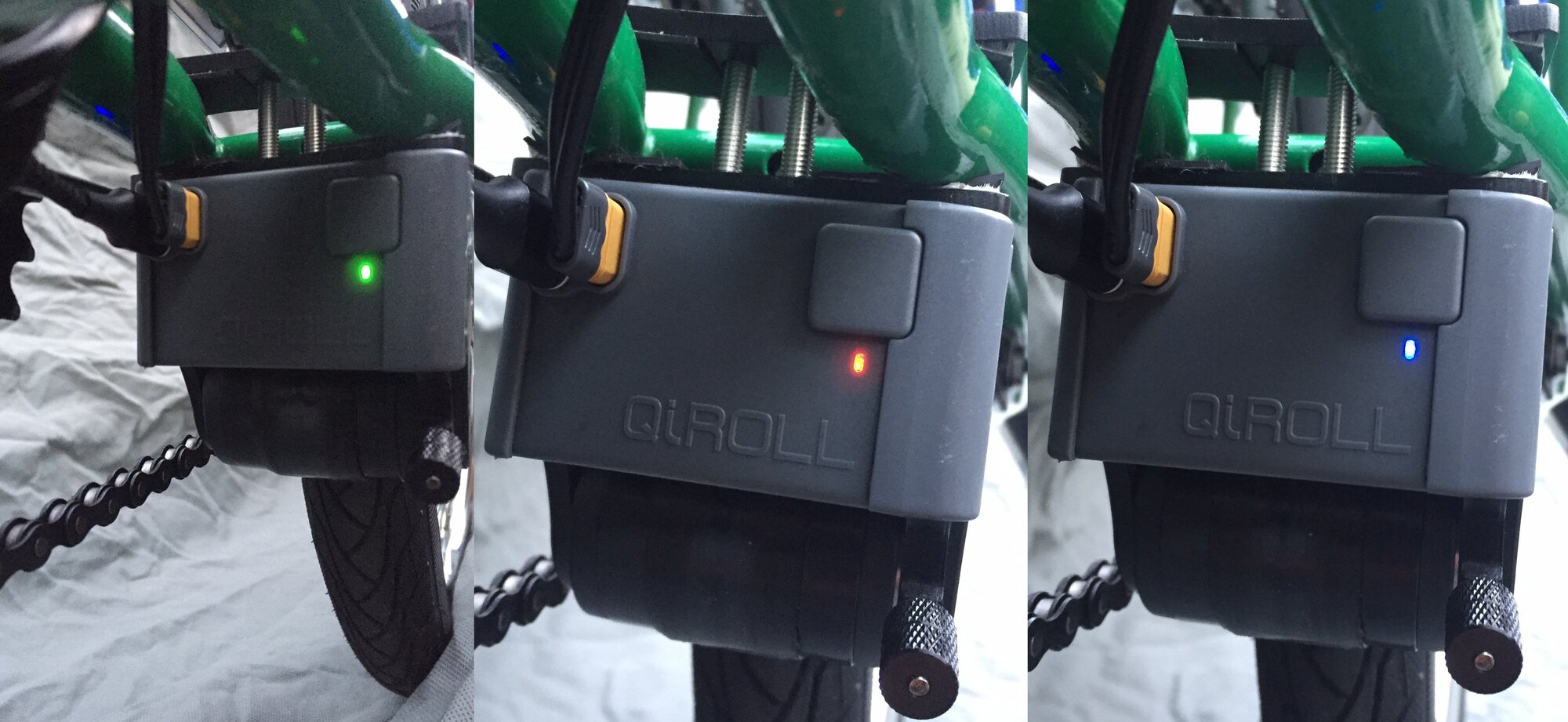

There are 3 modes:
1. GREEN LIGHT/Sleep Mode - a green light that blinks on the motor. You enter this mode by holding down the button for several seconds. You can still ride the bicycle with no motor assist in this mode.
2. RED LIGHT/Power/Pro/Sport Mode - You can wake up out of the sleep mode by pressing the lever/throttle which will instantly activate the red light which is the Power mode that gives you the highest level of boost that this thing can provde. Once you start peddling you can press the lever which will give you speeds up to 13mph without peddling and more if you do peddle. Mind you that's my personal experience with a total bike/rider weight of 200 pounds. It may vary according to your own bike weight, type of bike and your weight.
3. BLUE LIGHT/Eco Mode- This is the Economy mode in which the booster just gives you a bit of help while you peddle. You have to hold down the throttle lever. If you brake or stop it stops the roller from rolling against the tire.
3 different color light mode indicators on the motor: green-sleep/red-power/blue-eco.
You can switch between RED/Power and BLUE/ Eco modes by pressing the button. The motor will automatically enter Green/Sleep mode after 10 minutes of inactivity/no peddling.

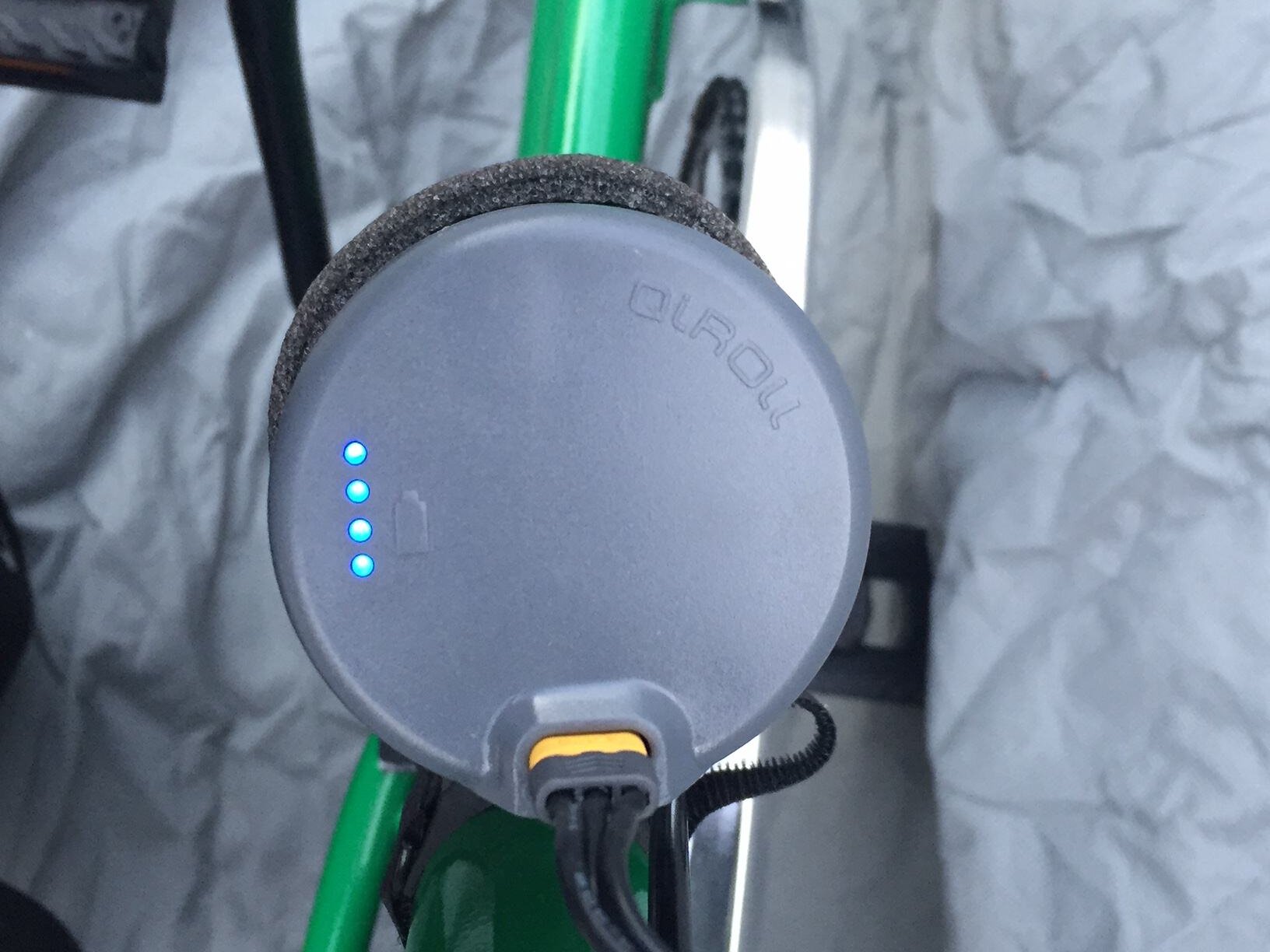

Battery light display
This is the manufacturer's explanation of the 4 blue battery indicator lights:
4 lights on = 100-80% power
3 lights on = 80-45%
2 lights on = 45-25%
1 light on = 25-10%
1 light flashing = 10-0%

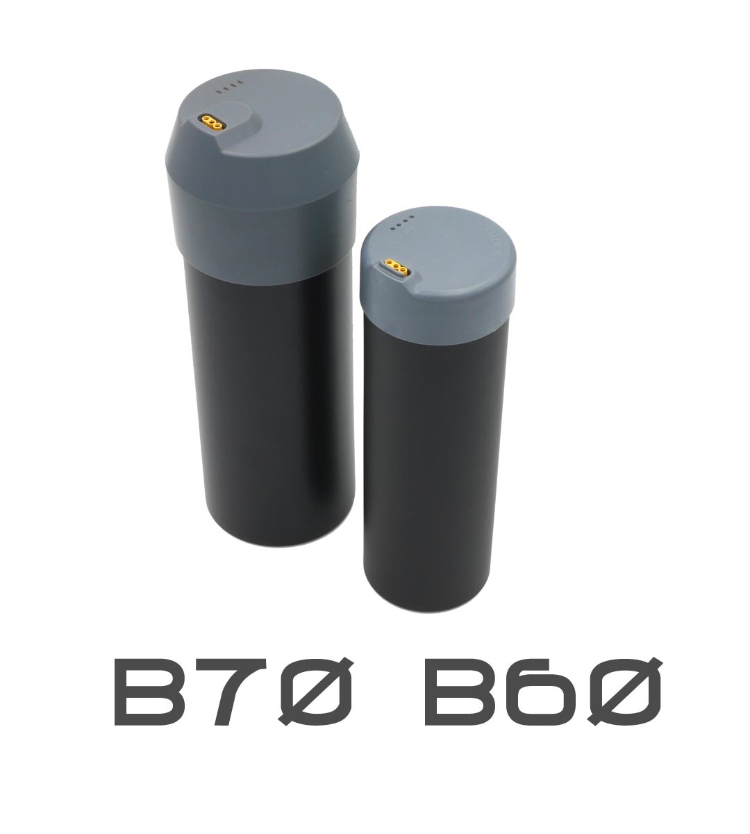

BATTERIES - B60i and B70
The B60i is smaller and has less power.
Rated at 6 Amp Hours.
25 volt.
Weight 1 lb 7.7 ounces
Manufacturer claims 80% capacity after 500 full charge cycles (works out to 2-3 years -depending on usage - before 80% capacity)
The B70 is a larger battery more power
Rated at 9.8 Amp Hours
25 volt.
Weight: 2lb 6 ounces
Based on subsequent rides, I believe the manufacturer's claim of getting 20-30 miles on the B60i using the Eco mode (motor and peddling) to be accurate. I'd say you could depend on 25 miles out of the battery in Eco mode. I don't usually go more than 10-12 miles on one bicycle ride and the occasional 20 mile ride on level/slight incline paved road, so this is quite adequate for me.
The B70 is slightly heavier and the claim of 30-40 miles in Eco mode, also seems in the ballpark.

This is how the seat stay mount looks as opposed to the chain stay mount on my bicycle.

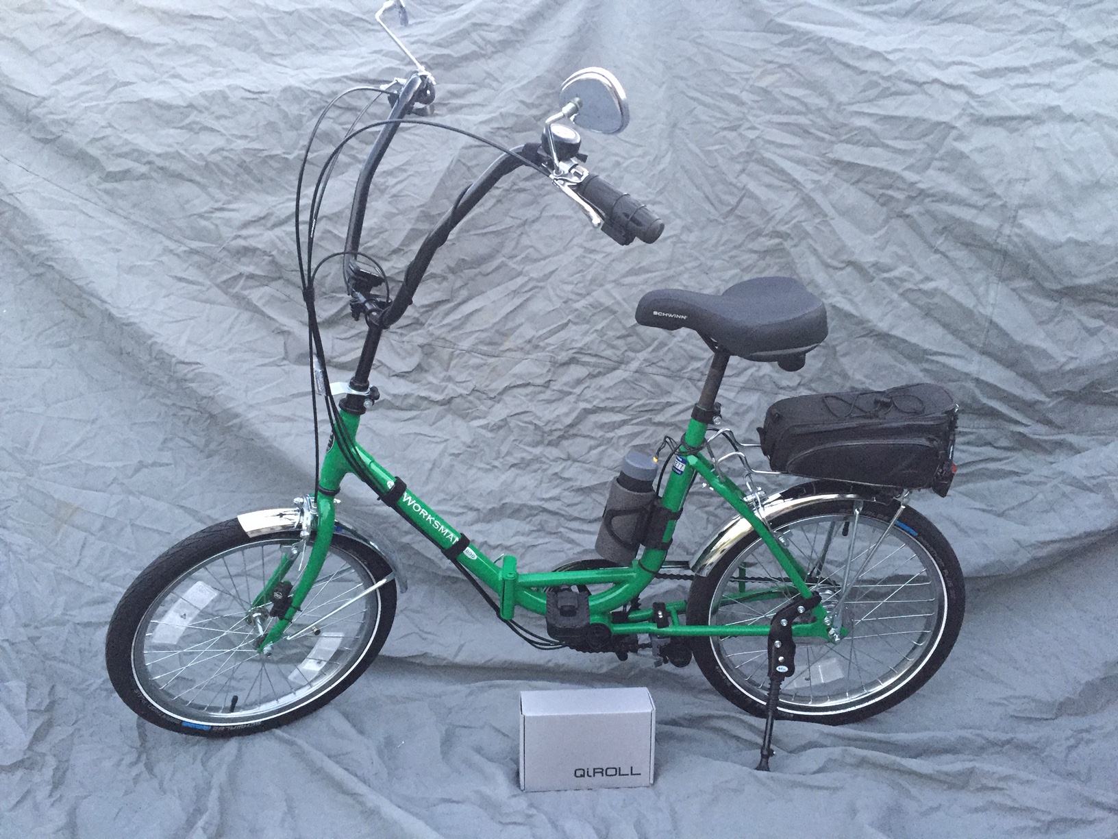

This isn't the most powerful bicycle motor kit but for my 20" folding bicycle it goes fast enough and helps me get up that occasional hill or long stretch of incline. It was easy to install and easy to use. I do wish the mode indicator was on the throttle so you could easily see it on the bicycle handlebar instead of looking way down at the motor.
With that being said, I think this kit meets a lot of critical points that I mentioned at the outset earlier:
1. Cost (motor, cables, throttle, battery, charger, mounting plates, zip ties, instructions)$299-$400+ plus tax and shipping. Price may vary depending on where you buy it and what size battery is included.
2. Tire Wear: minimal if any on my Marathon Schwalbe
3. Power: Adequate for my needs...long flat roads, some inclines and occasional hills.
4. Noise: very minimal - you really don't notice and neither do other people.
5. Installation: Easy, fast (allen wrench tools provided in kit). I'm pretty fussy about cabling, I'd say arranging the cables to my picky perfection took more time than mounting the motor and adjusting clutch knob and roller on the motor.

Other things to consider is that the tire must be a relatively smooth flat (no knobbies) continuous pattern type of tire so that the roller can make the best contact with the tire. My Marathon Schwalbe's (e-bike ready) worked perfectly. The roller itself on my motor had a flat relatively smooth rubber plate unlike the abrasive almost sandpaper grit I see on other friction drive rollers. Extra rubber plates were included, in case you had to replace the one that came with the motor. Replacement is as easy as using your fingers to pry off the old rubber plate and pressing on the new one.
The smoother the tire, the better the contact and effectiveness. Knobby tires won't work.
If your tire treads have a lot of grooves, these might trap gravel or little rocks and it could adversely affect the roller plate. So inspecting the tires occasionally and removing any little rock stuck in and protruding from your threads is a good idea. Personally, I haven't had any issues with this. The grooves in my tire treads don't really pick up much.
The QiRoll company claims that very little tire wear occurs with their smooth rubber plate and that it also works well should your tire get wet. I haven't tested this out too much, although the few times I went through a puddle, I noticed no slipping or decrease in performance.

I am wondering if these small motors would stand 36 volts( my 36 volt batteries are 20 AH) or would the torque be a problem on the interface?
Hi,
Good question and the best person to ask that would be the one that sells the kits on ebay as he speaks Chinese and English and can give you an answer directly from the manufacturers of the motor. Search 'Qiroll electric bicycle kit' on ebay and contact the seller.
BTW, is the purpose of using a more powerful battery to try and get more power out of these motors which translates into greater speeds?
Hi,
No, just to see what these little beauties could eat( wouldn't have to manage the stock battery- a backup or booster if you will.) I would like to use this as a "trolling motor so to speak and a boost on the really steep hills( plenty of them around here, no I do not use my Ebike as an unregistered Ecycle ,I like to slow down and enjoy the ride the only reason I do the 30+ downhill bursts is just to save the brakes. I want full suspension and regen on my next Ebike.

Just to confirm:
Red mode is the main power/sport mode but do you have to hold the button down the entire time like you do with the Eco mode?
Or can you release the button and the motor will stay active and running in full power mode?
I watched the youtube video by Jim Chung and he mentions that the motor will still power your wheel after releasing it. Which i think is what you've said above too but just double-checking. I want that feature as i do not want to hold the button down all the time (unless i'm in eco mode).
The tire will engage with the motor as long as the roller is touching the tire and moving in high power mode. It will give you a slight boost. To achieve a constant full boost you must constantly depress the power button, which is no big deal as the button can be positioned conveniently underside the handle grip as shown in the pictures.
When I depress the button it is merely a matter of moving my hand a tiny bit higher on the grip and then closing my fist as I would when holding the grip such that my middle or index finger is depressing the throttle lever. To release I just release my finger and shift my grip back down normally.
I hope I explained that clearly as holding down the throttle lever is not tiring or a big deal. My finger/hand has never become tired from pushing the throttle lever and I know what you mean about that being a possible nuisance, as I have had throttles that take a lot of effort to depress.

Also, as i live on island, QiRoll mentioned i could buy the kit without the battery to allow the QiRoll to be shipped via air rather than slower sea-based shipping required for hazmat.
Anyways, this means i could buy a bigger battery as long as the spects are compatible. Cost-wise, due to shipping hazmat regulations, i will not save money going with a non-QR brand battery. It will actually cost much more. But, in the future, I might get a much bigger battery if I like the qiroll.
