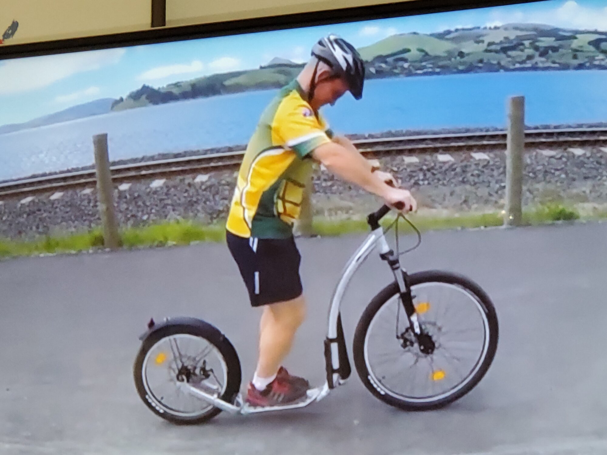

Pardon me if missed: can the qiroll be mounted in any rotational direction? Im looking for this to go on my footbike. TYIA.
