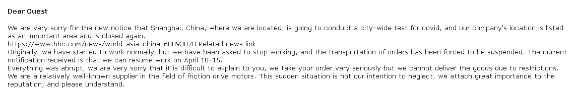

Unfortunately the Qiroll QRE Pro package was still not deliver out for shipping since my last post. Still worry how long i have to wait since its been more than a week. Has anyone has issue buying from official shop.
Thanks for the info, glad to hear since i commute a lot in the rain. Should have no problem friction drive in wet since i use sticky tires.
Generally no issues, but I know somebody whos order is also taking a while to ship now. My guess is that the recent covid lockdowns in China/Shenzhen could be delaying things...
Has anyone who recently purchase and awaiting received email from QiRoll?
As per attached looks like i'll be receiving mine somewhere in the month of May. That means took 2 month to reach my door step. They should have delivered it after i made payment a week before covid lockdown strikes. Slow and poor processing response. *Face palm*.

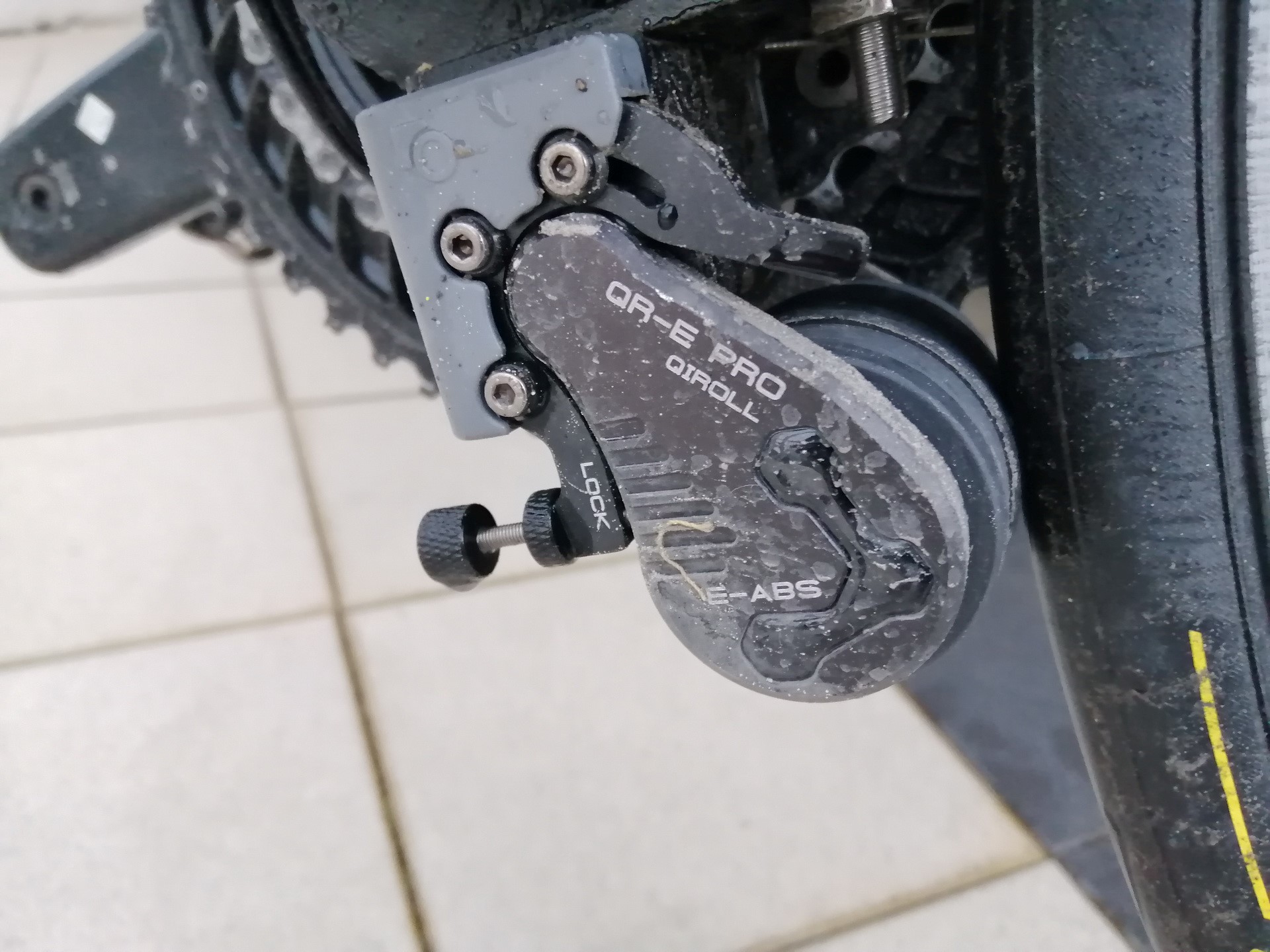

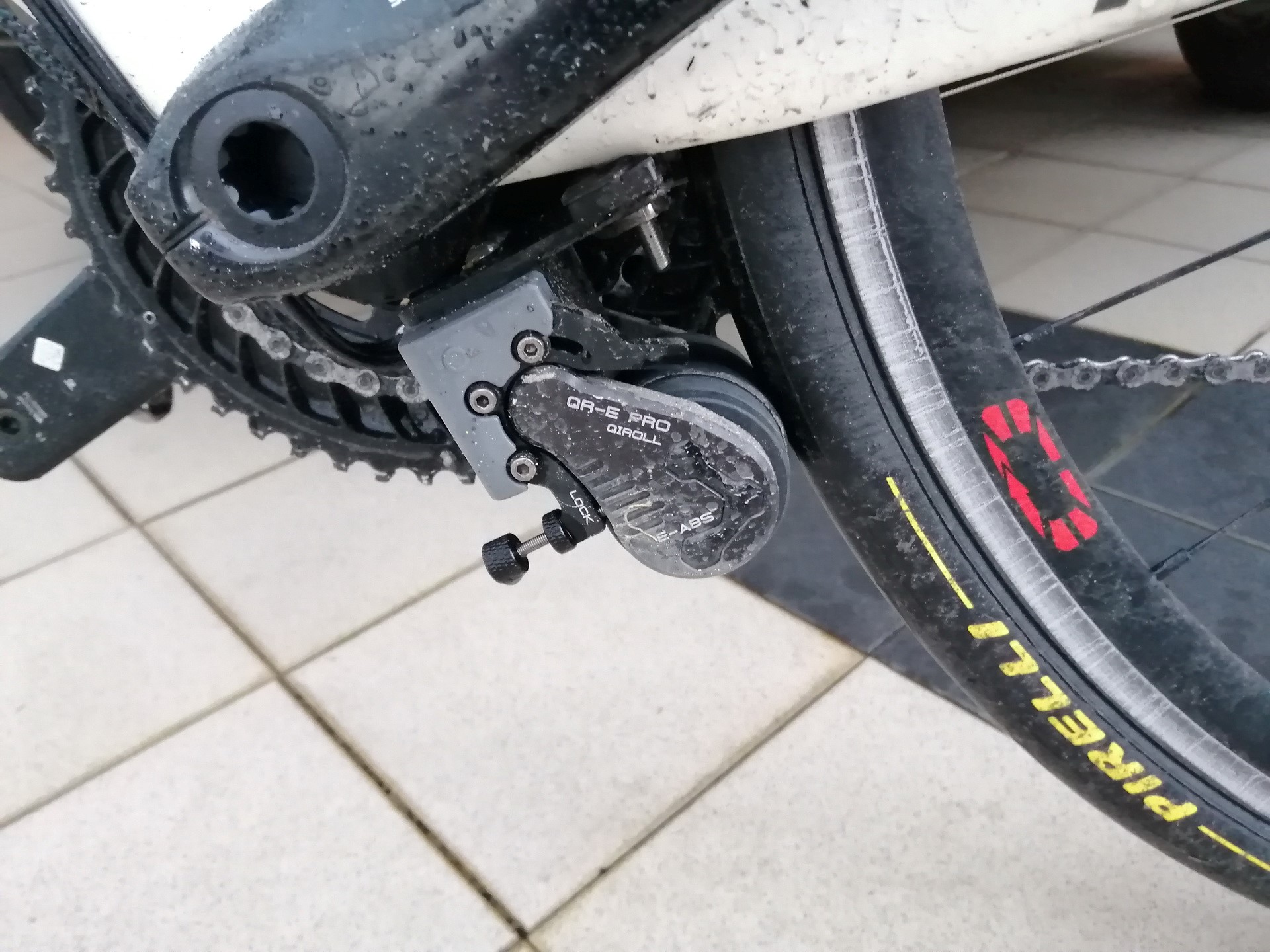

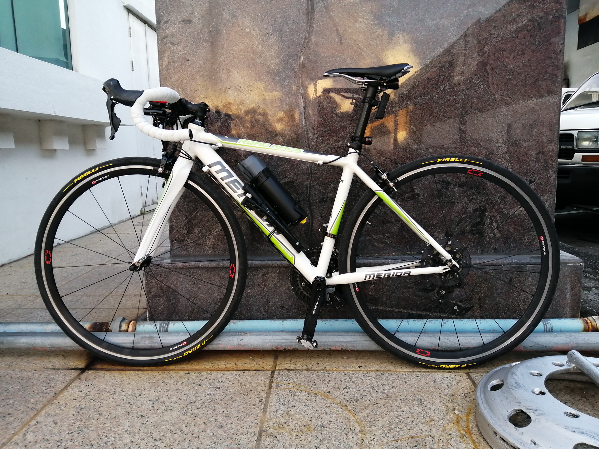

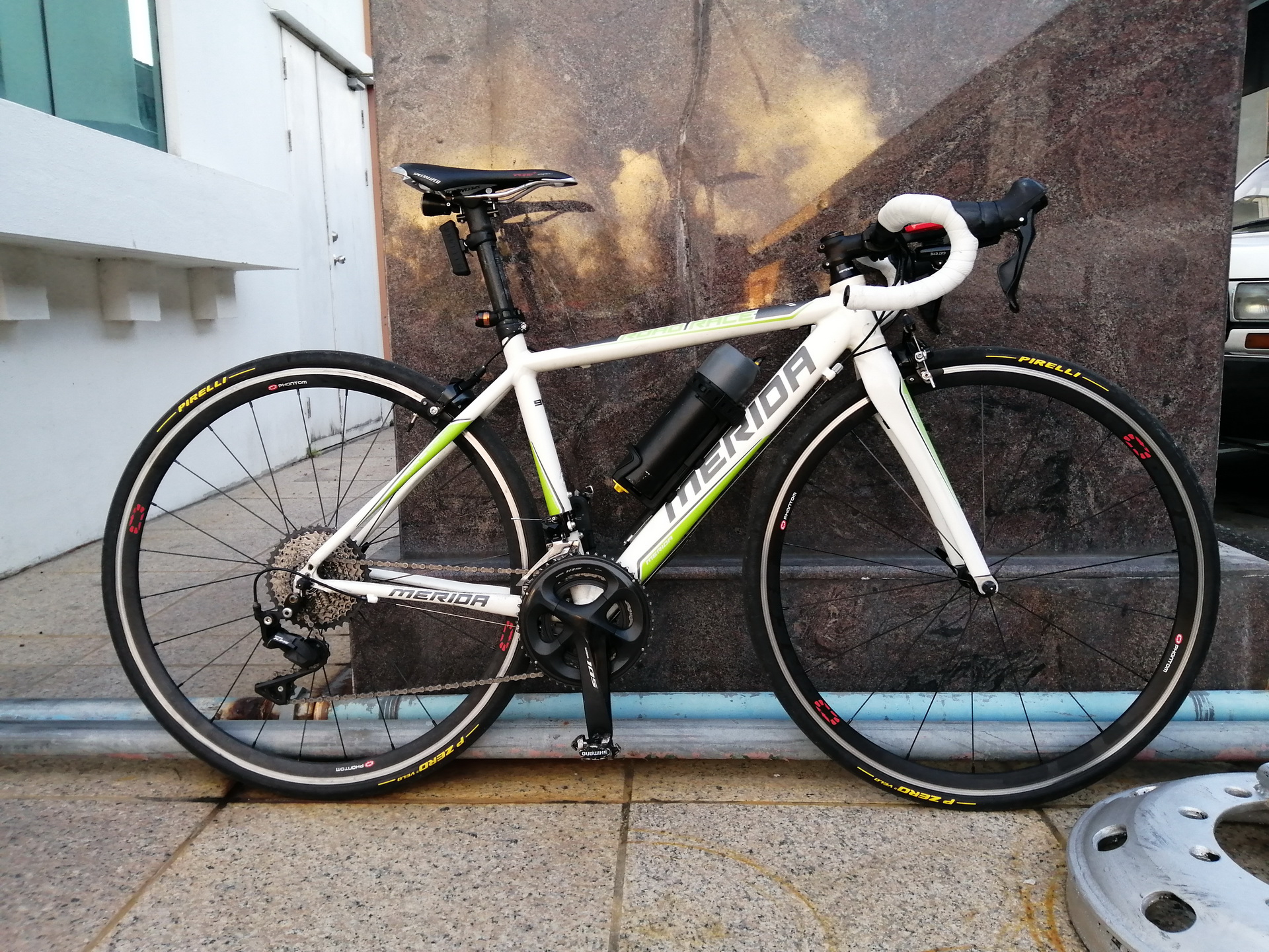

Got my QR-E PRO with H70 battery kit and installed on my daily commuter road bike and rode through various weather dry and wet. I'm very impress how much the PRO version can pull so much torque noticeably during uphill climb at 15% incline with all boost. My legs just spin so casually. Below are summary of my findings (i used sport mode a lot):
Ref:
> Rider weight: 65kg
> Commuter setup road bike weight + bags + with Qiroll Q-RE Pro + Batt: 10.5kg
> Road bike with 700c x 25 slick tires (Pirelli P-ZERO full bald slick).
On dry weather:
+ 21~26km/h non-pedaling mode.
+ 34km/h on assisted casual pedaling.
+ 42~45km/h on high cadence pedaling with boost trigger before Q-RE PRO exceed its rpm assist and no longer able to provide extra acceleration. There's no more assist past 46km/h.
+ 5~10km/h on 15% hill gradient with assisted casual pedaling.
+ 20km/h on 15% hill gradient with boost trigger assisted casual pedaling.
On wet/rain weather (wet tires):
+ 5km/h non-pedaling mode (motor slips a lot).
+ 20km/h on assisted casual pedaling (motor slips a lot).
+ 32~34km/h on high cadence pedaling with boost trigger before Q-RE PRO exceed its rpm assist and no longer able to catch up (motor slips a lot).
+ 5km/h on 15% hill gradient with assisted casual pedaling (motor slips a lot).
+ 10km/h on 15% hill gradient with boost trigger assisted casual pedaling (motor slips a lot).
*Obviously Q-RE pro slips a lot on wet slick tires when the tires are dampy wet. I can hear the motor whining a lot try to catch a grip on slipper tire threads.
Is it waterproof?
I'm not 100% sure the bike was outside fully exposed drench in heavy rain so i can see my Q-RE PRO unit all soak up heavily with water including the handle bar switches and wire connection. I rode and hit the deep puddle of water too and it was continuously raining. All i can say from what i experienced it seems ok being fully wet.
Overall i used sport mode and frequently trigger the boost on mixture of flat and hilly area, so with fully charged H70 battery i left with just used up 25% juice (3 LED lit) for the range of 25km range. As a daily commuter going from home to work place daily the Q-RE PRO totally worth the money for my commuting purposes. Now at the office with no sweat and pain on my legs. I can ride all day! But will try to avoid wet roads if i could. I like the Q-RE kit, it doesn't make my bike looks too much of an ebike and remain stealth, the motor sound quite silent too. Sometimes i go 'moped' mode if i'm too lazy to pedal.

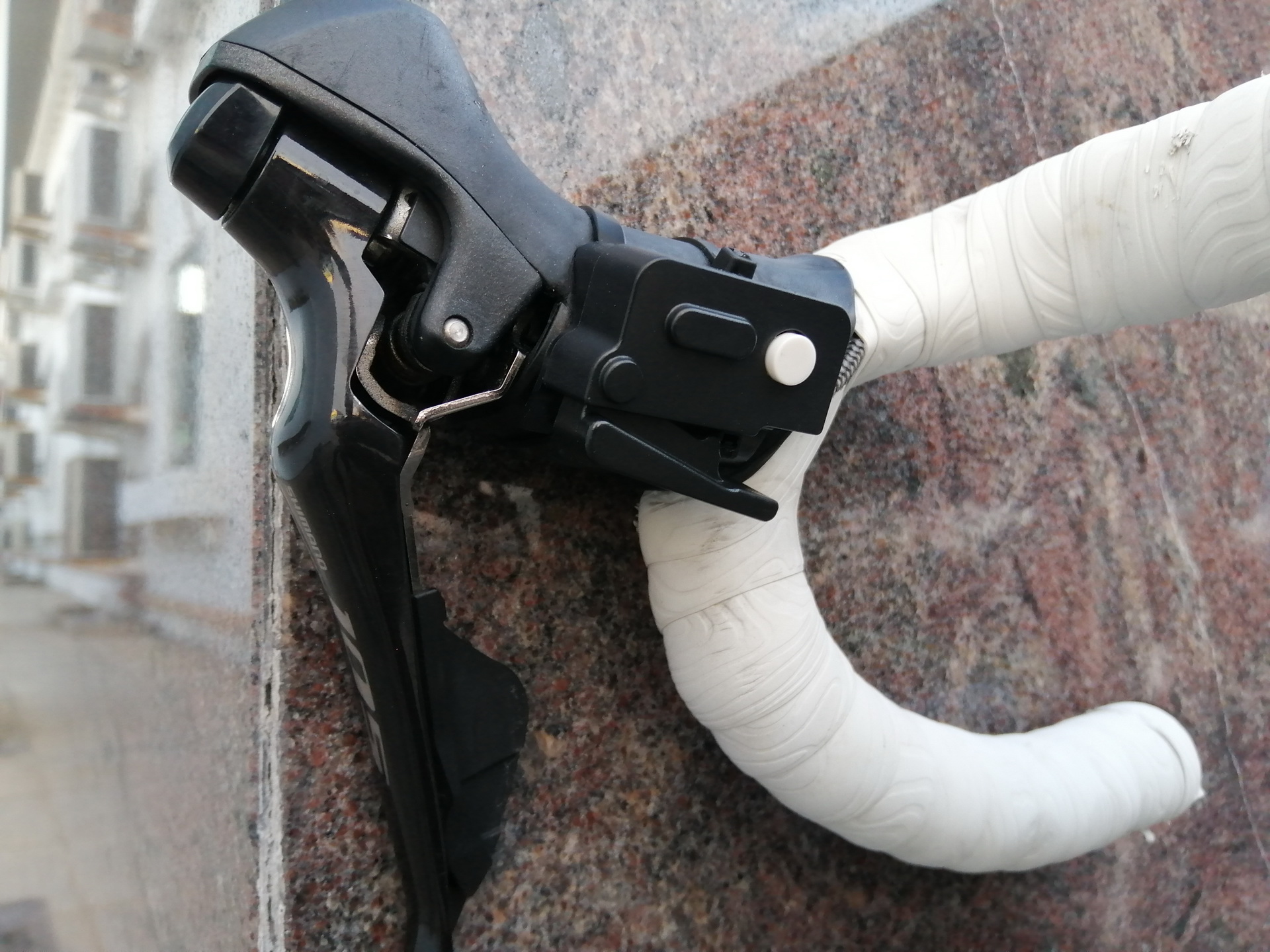

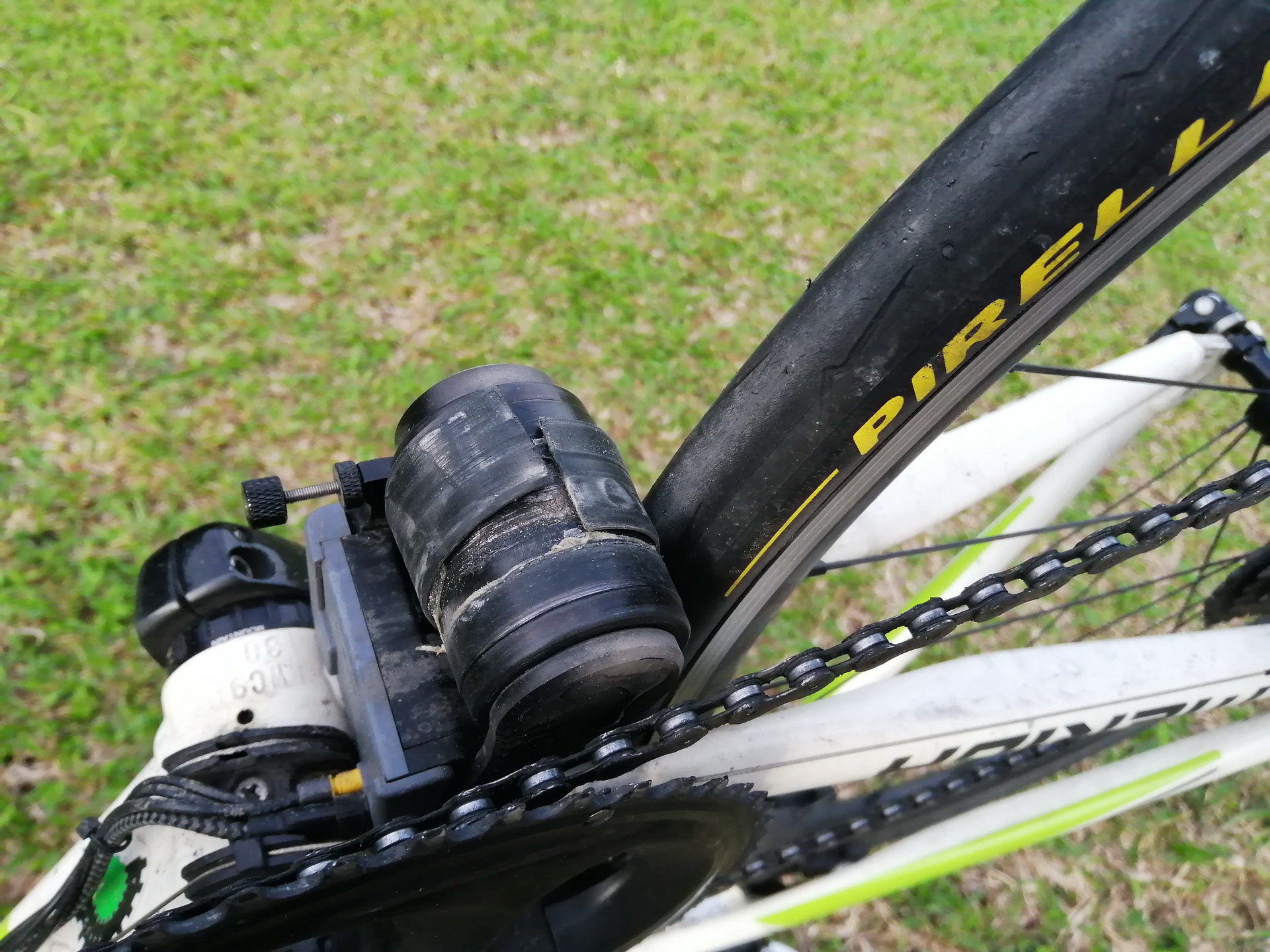

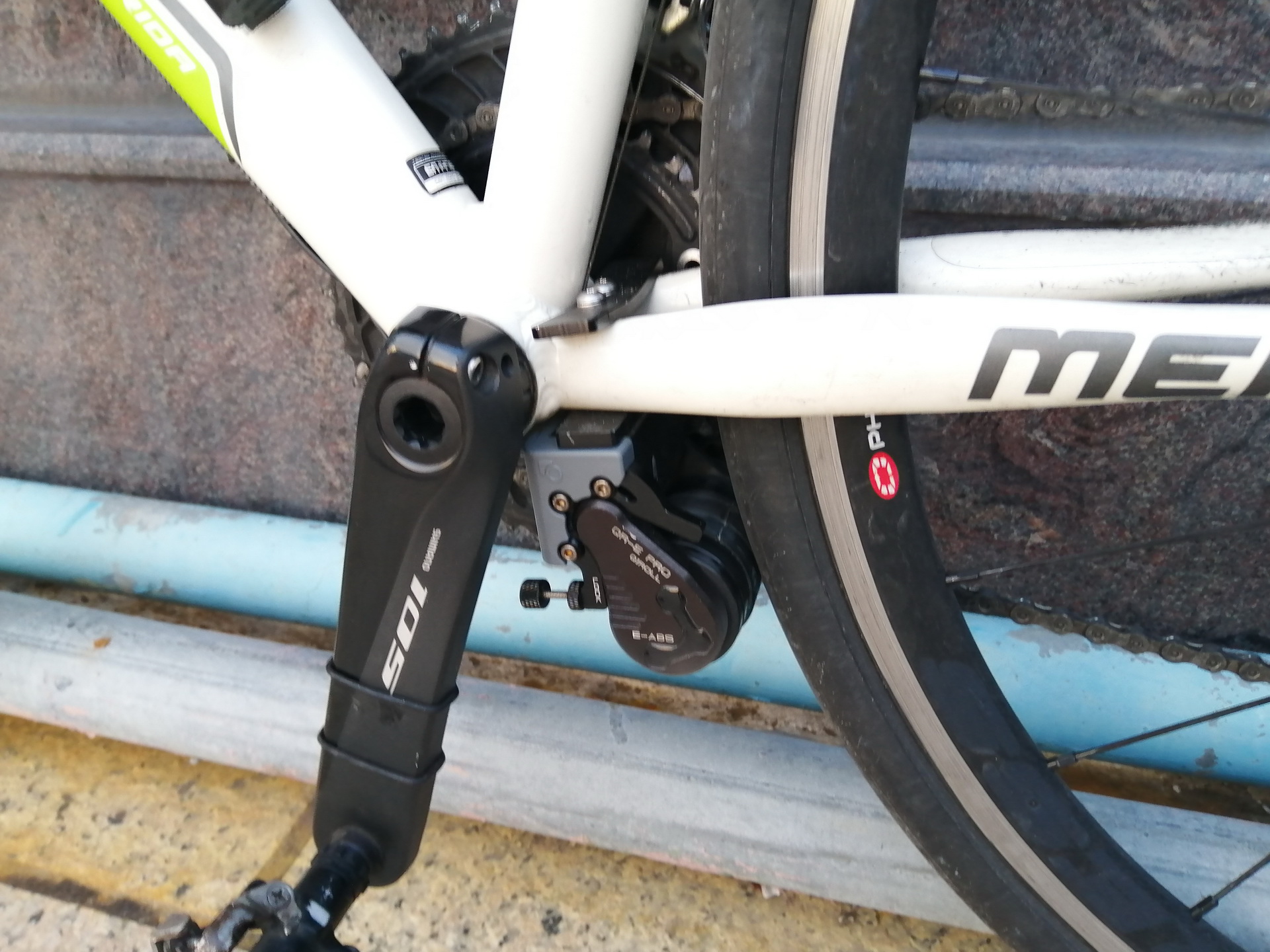

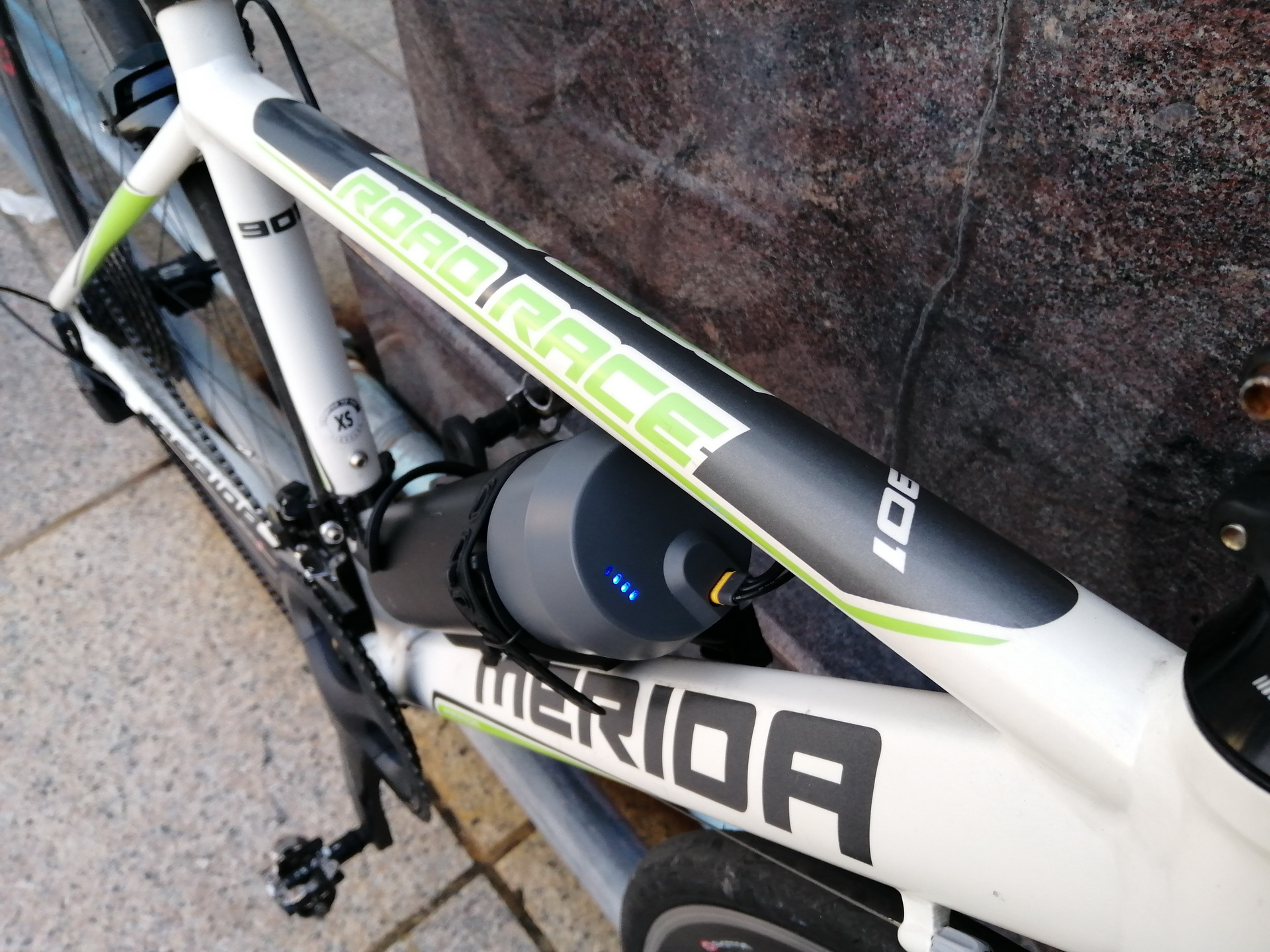

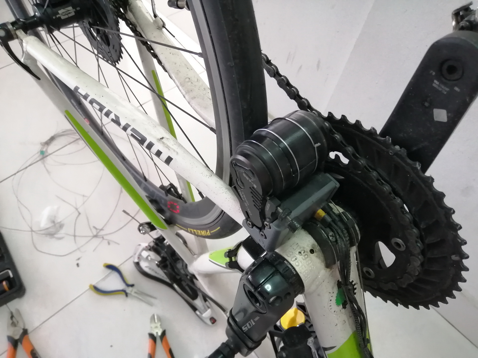

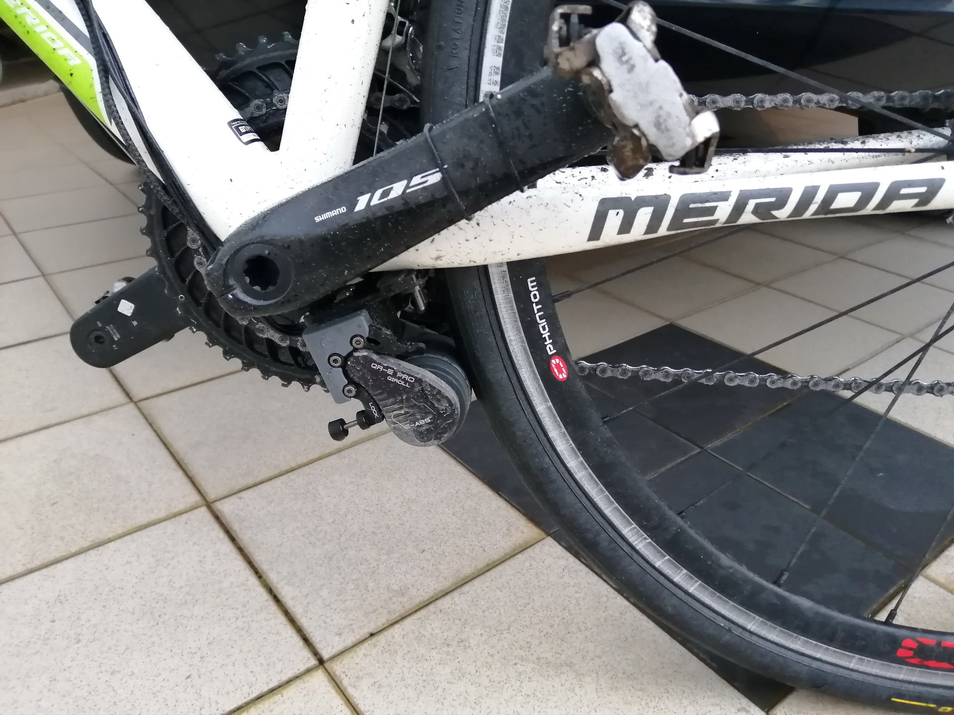

Finished cleaning my bike after rain and being dirty during commute on QR-E PRO few days ago. So here are photos of my clean build with QR-E PRO kit with H70 battery on my 12 year old road bike that i commute to work daily. I like the stealth look for not being 'totally' an ebike from outside and still keep being lightweight. The bike now weighted around 9.5kg with kit installed. Now its a powerful hill climber, really helpful to get me back home with less sore on my 40s year old leg muscles.
Photos:
I've been riding daily to work this week both hot and extremely rainy season on QR-E PRO and i kind a like i how it performed and helped a lot to ease commute on my bicycle. I didn't fully waterproof it yet and it did holds well in heavy rains and even soak heavily outside the office where i park in the open exposed to weather.
Here's the video from reddit i posted climbing uphill, weave through traffic, grass and speeds in heavy rain.
Video link >>:

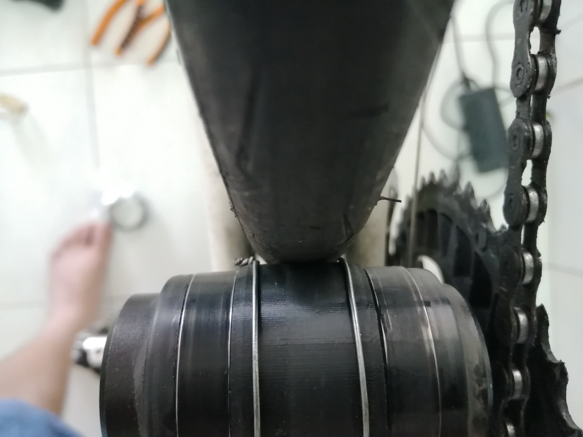

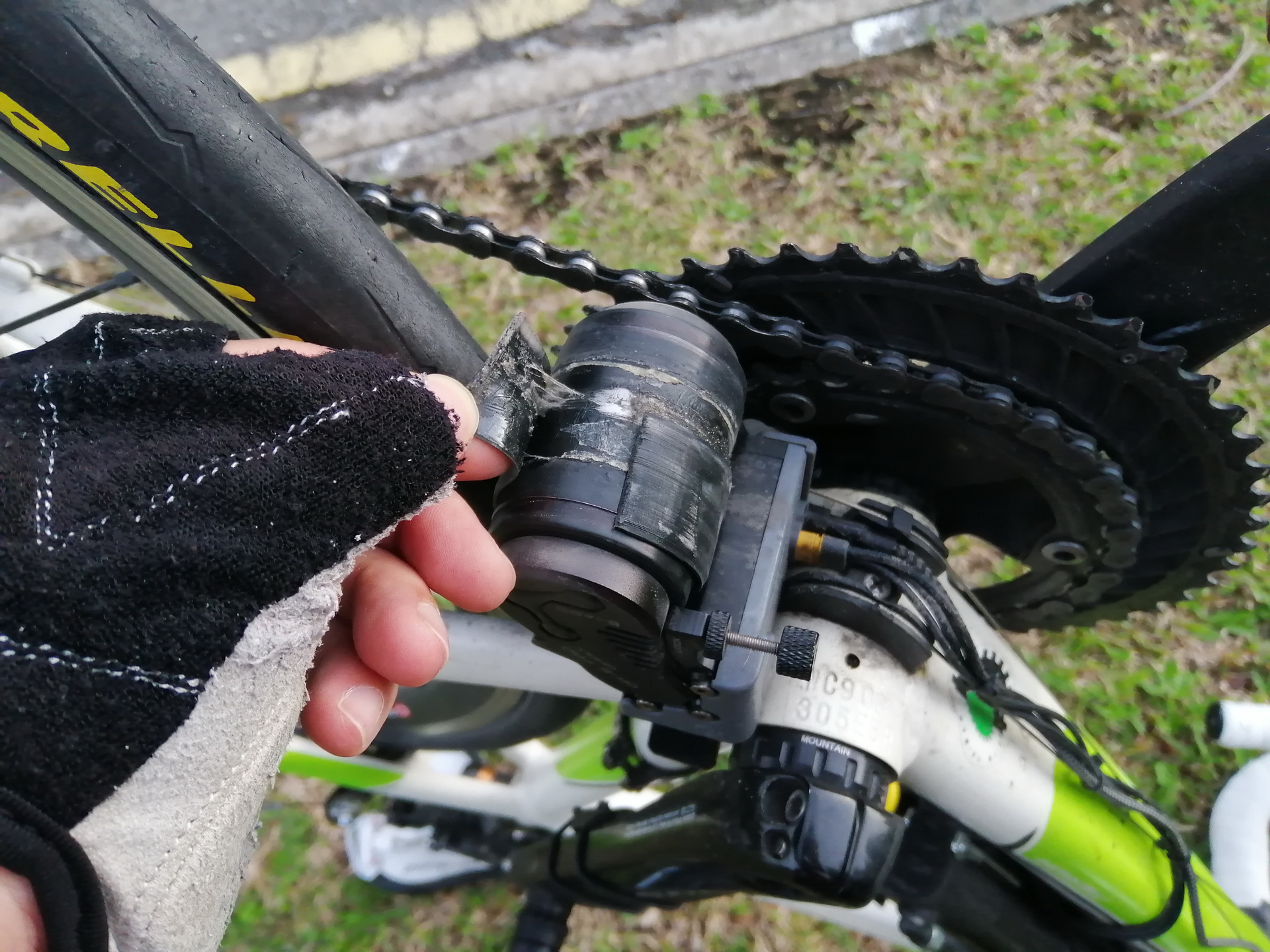

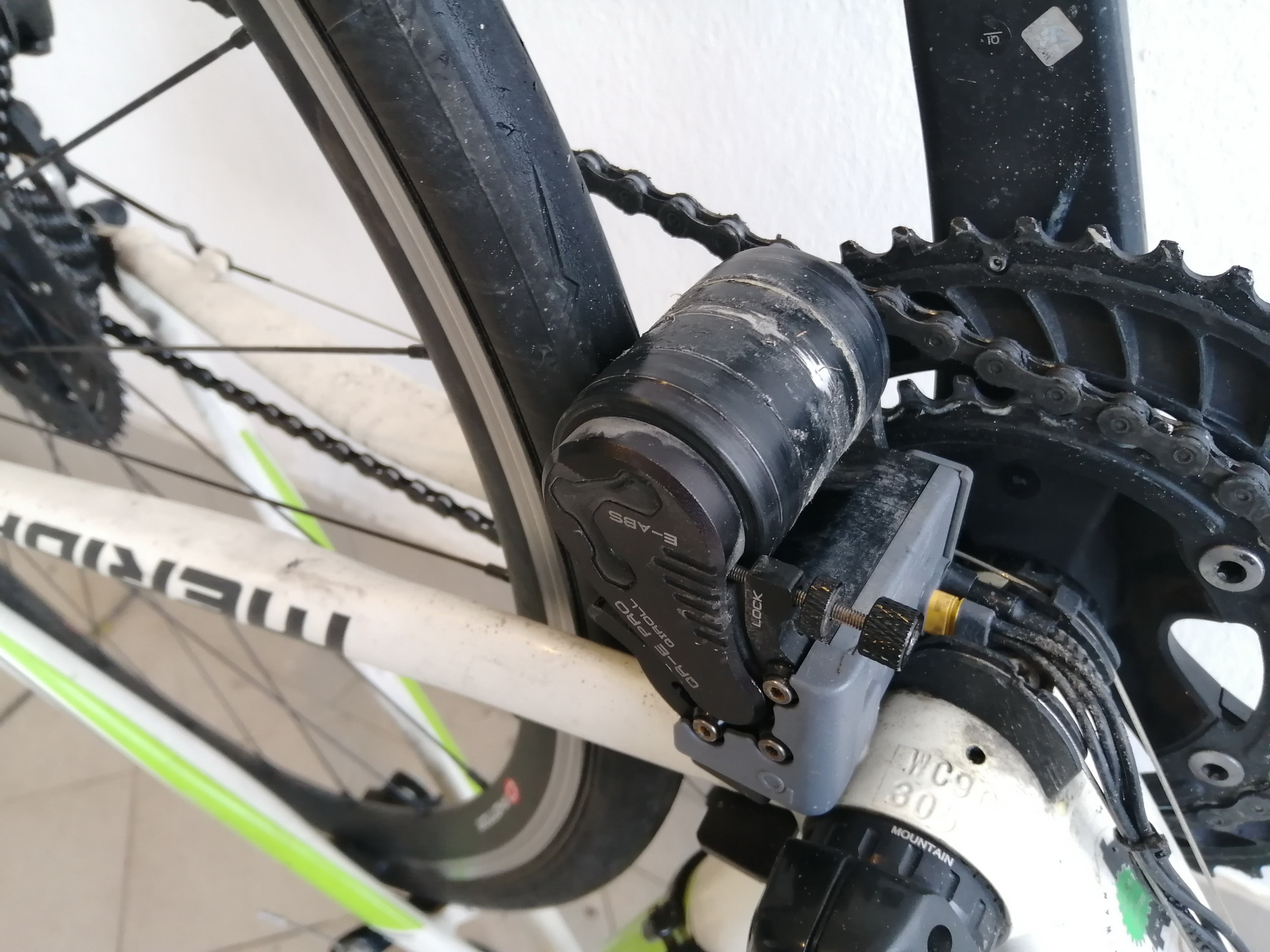

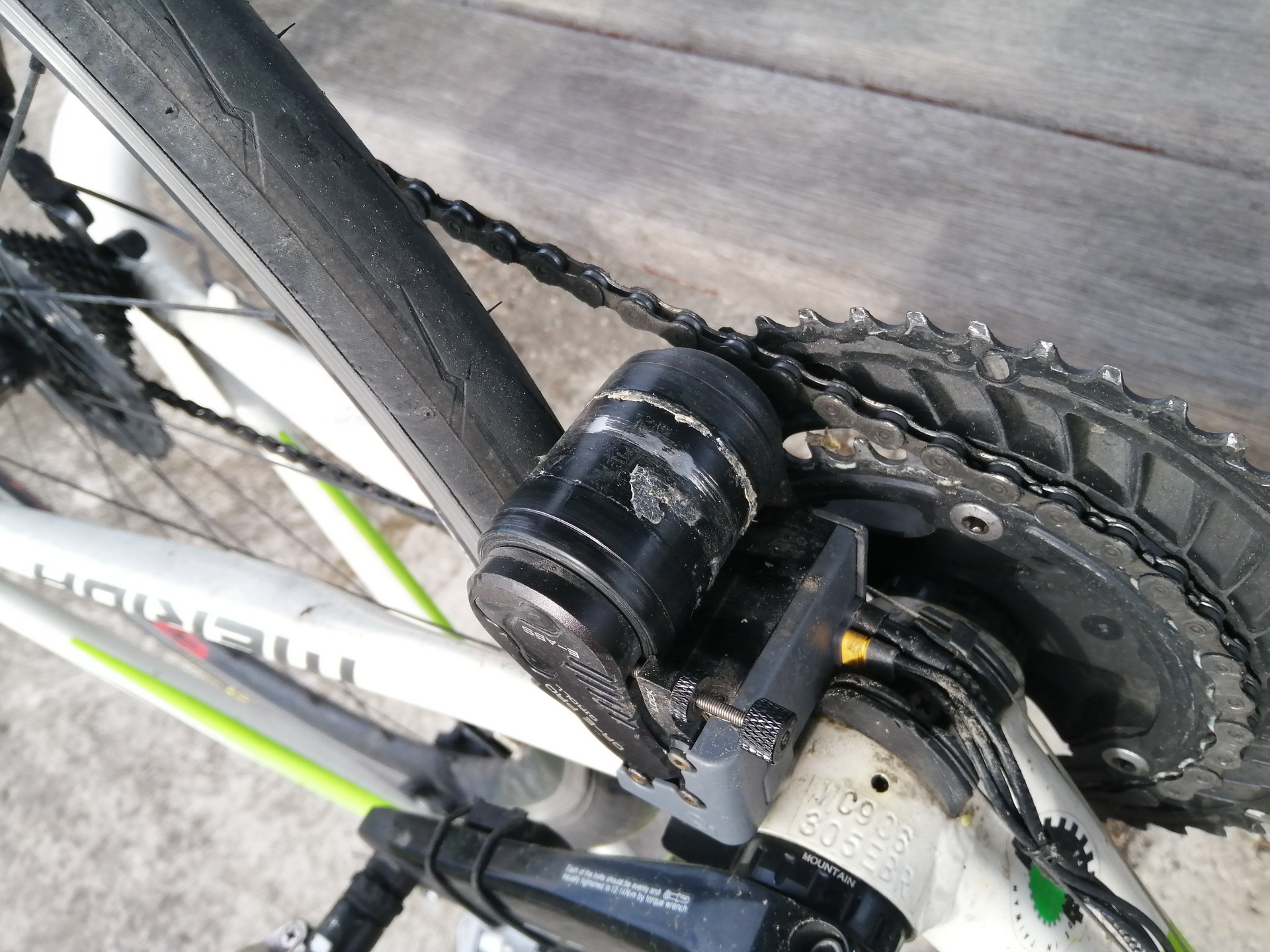

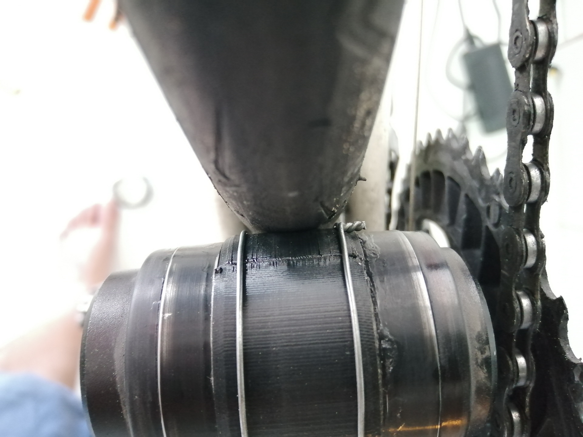

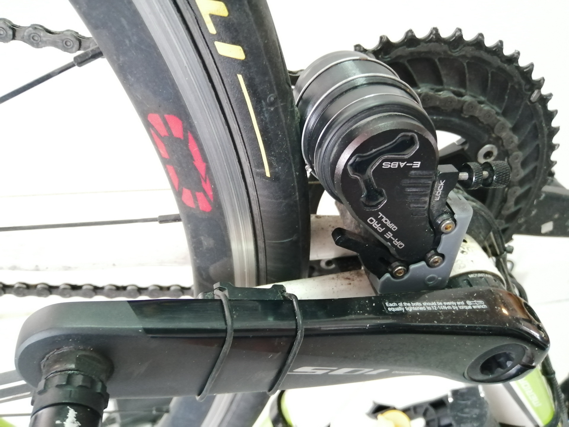

Big problem: Some serious Cons on QR-E friction tape
However despite some good amount of pedal assistance i notice that everyday i had serious problem with their friction came out loose and ejected violently on the road as i speeding and also climbing slowly and high incline slope. It always happened in the evening on hot weather but nothing happened in cold morning. QR-E PRO gets over heated and the friction tape glue melted causing it to slip hard and ejected. Sometimes it sounded like some plastic card slapping hard loudly against my chainstays of my bike frame before it flung out into the grounds. Unfortunately i've lost 6x newly installed friction tape in just one week of riding. I couldn't retrieve the peeled friction tape that was bounced on the road due to incoming traffic so its quite dangerous and hazardous to pick it up. So i ended having to peel new spare pack of friction tape and again the next day it happens over and over. I did try using super glue and bits of epoxy to keep it stick hard to the roller but it doesn't worked. I've tried lots of clutch adjustment from loose, medium and tight pressure on the roller to the tires but all ended the same problem having flung out from the bike.
I'm trying to contact Jason from Qiroll via email to have a word and solution about it later. Attached are photo's of mishaps.
Updates: Qiroll sending PRO version of friction tape.
Good news, i just emailed Jason from Qiroll company and received quick responses few minutes ago. They will be sending me replacement of PRO version of friction tape that can handle heat and pedal torque that fits my riding style, hopefully will solve overall problem. Meanwhile while waiting to receive the improve PRO friction tape i might need to do some DIY fix to enable me to use normal version of frcition tape temporarily so i can commute to work next day while waiting for the parcel to arrive. Will keep you guys updated.
*Note: Thanks to Qiroll technical support for fast customer service and assistance via email. :)

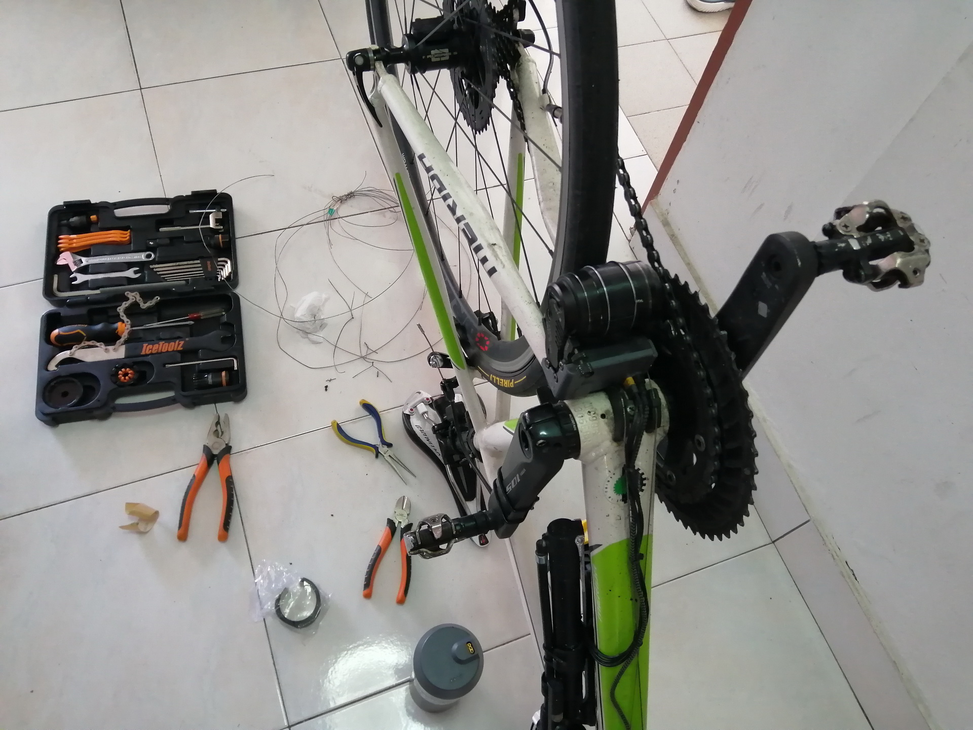

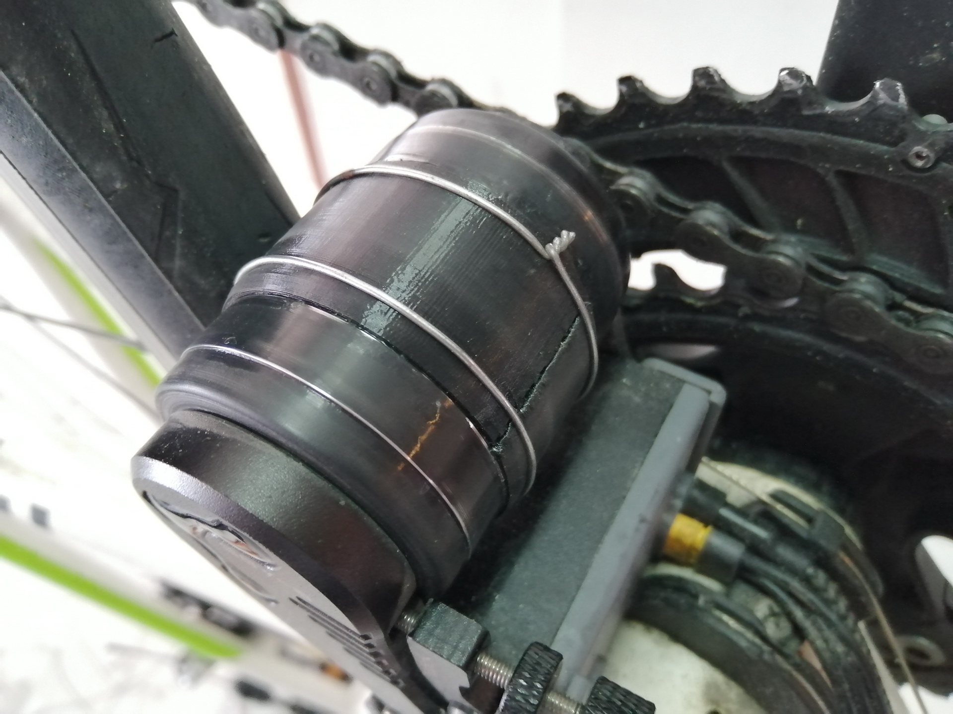

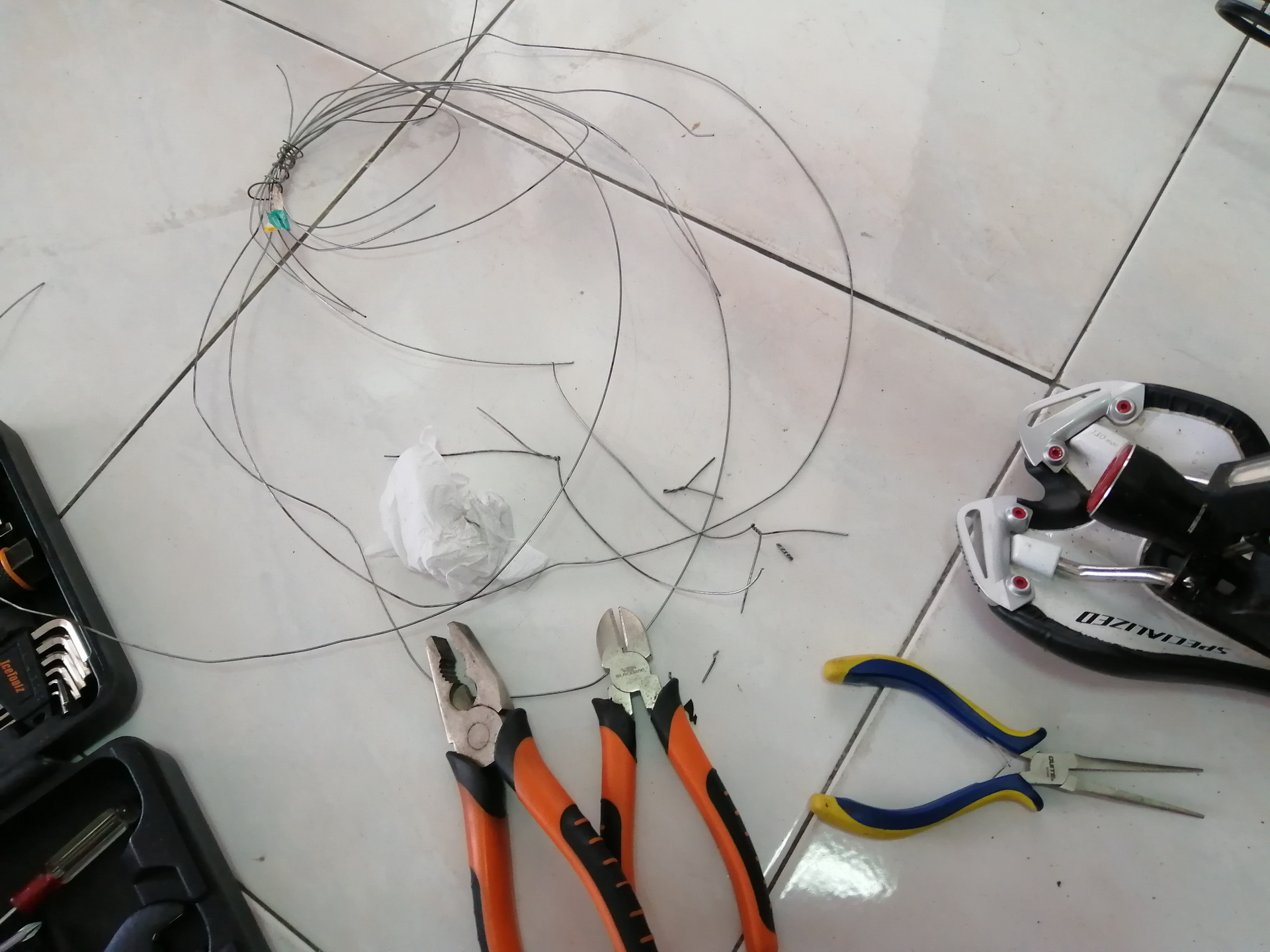

DIY fix solution: Home made ghetto friction tape lock ring
While waiting for the improve PRO friction tape to be delivered by Qiroll, yesterday i've decided to do some DIY fixes how to keep this stock friction tape intact from flung out at high speed again or avoid slipping out from melted glue (when roller motor gets hot due to overheating) when i get torquey pedalling up hill. I pull out some hard wires and plier, wrap each side of the friction tape into ring like clamp and twist the wires to tighten it. This will keep the friction tape lock on tight firmly on to the friction roller. I did some test on my training roller, few high speed laps around town and climbing on hard gradient hill and it worked!!...for now. The only drawback is since both wires clamped on each side of the friction tape the usable tire contact area with the roller is quite narrow but ok since my tire size is at 700cx25. Looks ok and hope it holds up until i received the PRO frictiontape from Qiroll company. Today i commute to office on hot morning; with some hills climb and high speed passes through traffic again clocked from 41km/h to 60km/h, motor does over heating but lucky the friction tape no longer fluttering around or flung out anymore... now it feels more solid and trust worthy performance!.
Attached photos of my DIY fixes below:
