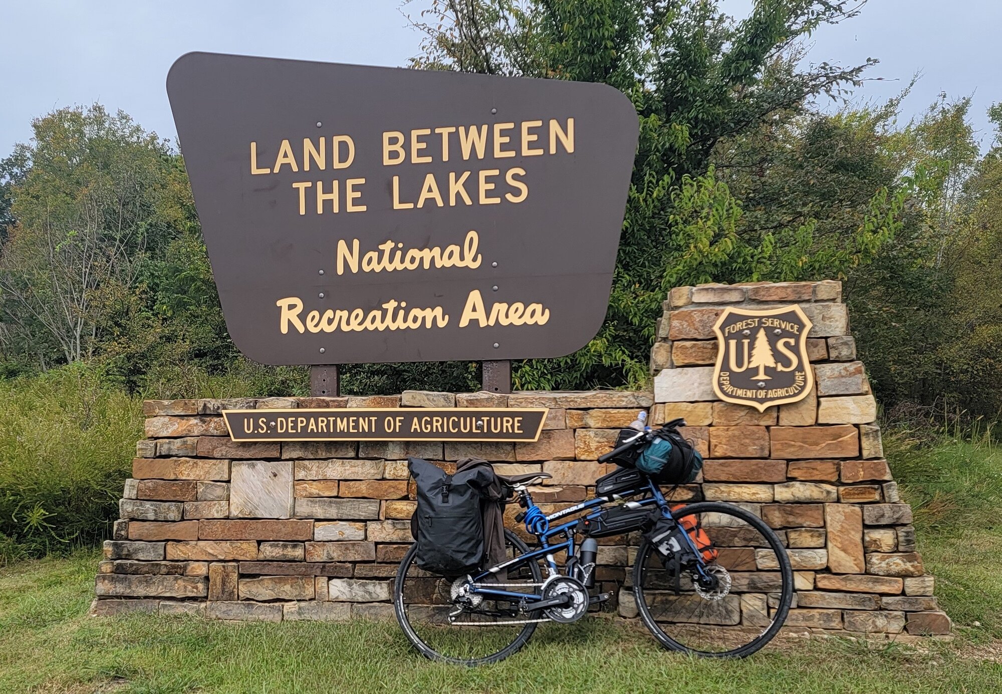

Came across this thread searching for info on what seems to a common issue with the qiroll; wear on the friction tape. I wished I had read through all the posts prior to starting a tour/bikpacking with the qiroll (750+ miles/1210+ kilometers) from southern Illinois to New Orleans via Baton Rogue. I tested all my equipment prior to starting out, but was mainly on road and mostly flat (I am in illinois after all). The tape showed some wear but nothing serious, and I brought a spare regardless as I was expecting 400 miles from it. Day 1 and everything worked flawlessly, with the small boost from the Qiroll my legs weren't even tired.
Low water on Mississippi meant I had to go west and cross Ohio river. This where the issues started, lots of gravel roads and some serious inclines caused the the friction tape to come off. I put on the spare and got another 10 miles before that one failed as well. There was fraying on the ends on the first one that failed. For the second it was strictly the adhesive. Had I not been doing a road side repair the second would probably lasted longer with proper cleaning and time. I was near the highest point, so from there it was downhill to the Ohio & wouldn't need the Qiroll for the rest of the day.
I never go camping without bringing duct tape as it's good for all kinds of fixes. I reattached the second qiroll strap, and used the standard duct tape (2" width) to cover it with and extra 1/2 inch on the roller on each side to help secure it. I wrapped it twice to increase the wear time. The duct tape quickly wore through but made it to a store and bought a roll of gorilla tape. The gorilla tape worked much better, but still needed to be replaced each day. I would spend 15 minutes each day replacing the tape at camp. Not a great solution but acceptable. The height of friction strap is slightly higher than the roller, so the edges are not perfectly flat but the portion the wheel contacts with is.
Even with the issues, I really like my Qiroll mute. For me the small boost it gives and not having slough through long (smaller) inclines is great. I only ride in eco mode and with a B70 battery I would consistently get 42+ miles with it. Everyday I would run it all the way down with the only issue is the recharge time has gotten very long, 5 hours. But considering how long it lasts and the build quality it's tough to find a better battery for the price. Only $100 or $120, Admittedly I am only using 25 volts.
