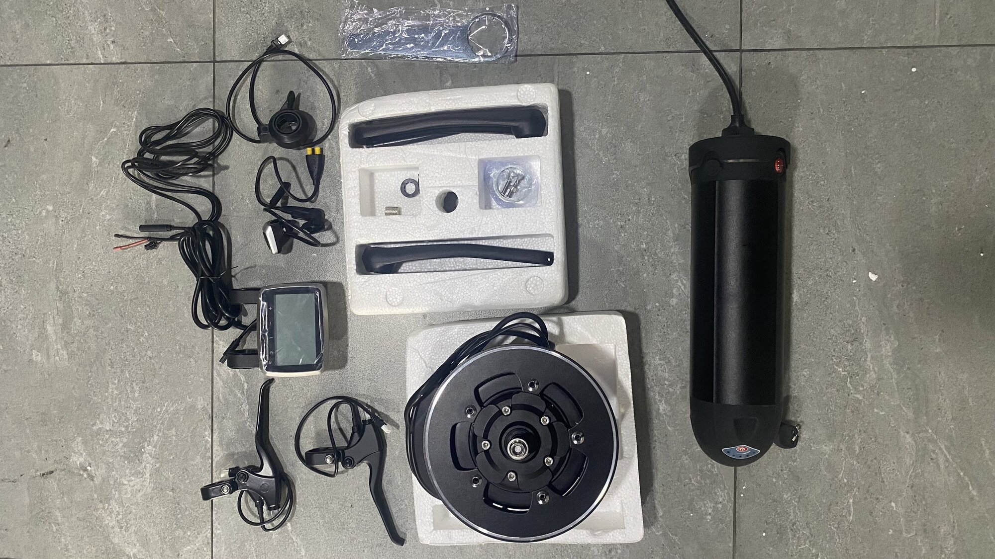

Latest updates on my order;
Jason from Qiroll gonna include additional S-2 button and cables. Looks like i'll have both S-1 and S-2 to play around on Qiroll QR-E PRO. Nice!

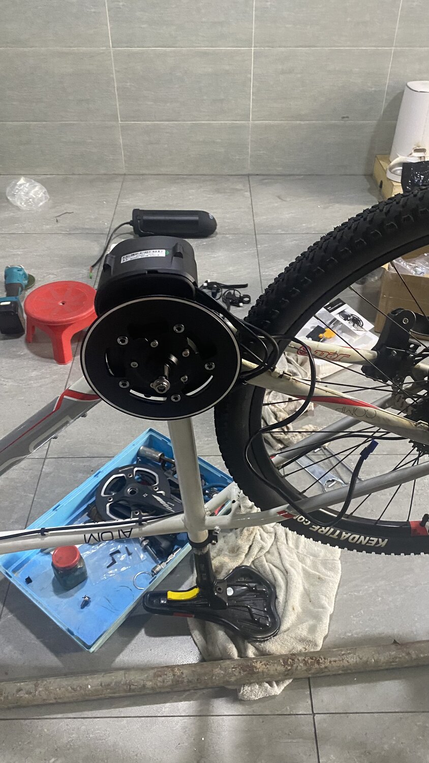

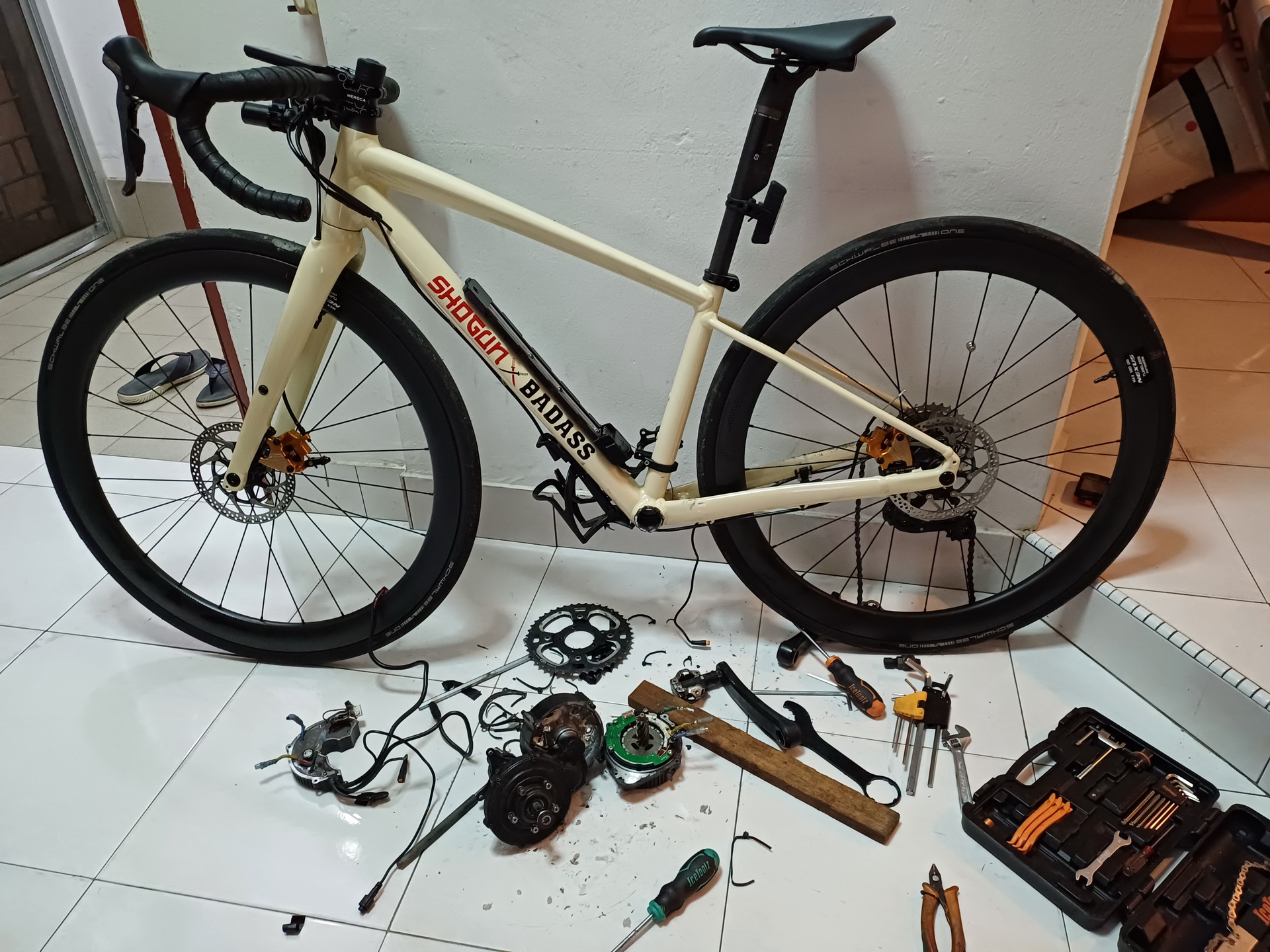

Already dismantled the 750w mid drive, awaiting for QR-E Pro. Man its been days of waiting with no answer from Jason from Qiroll.

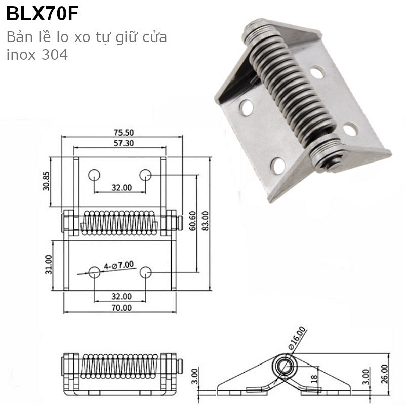

Hi.

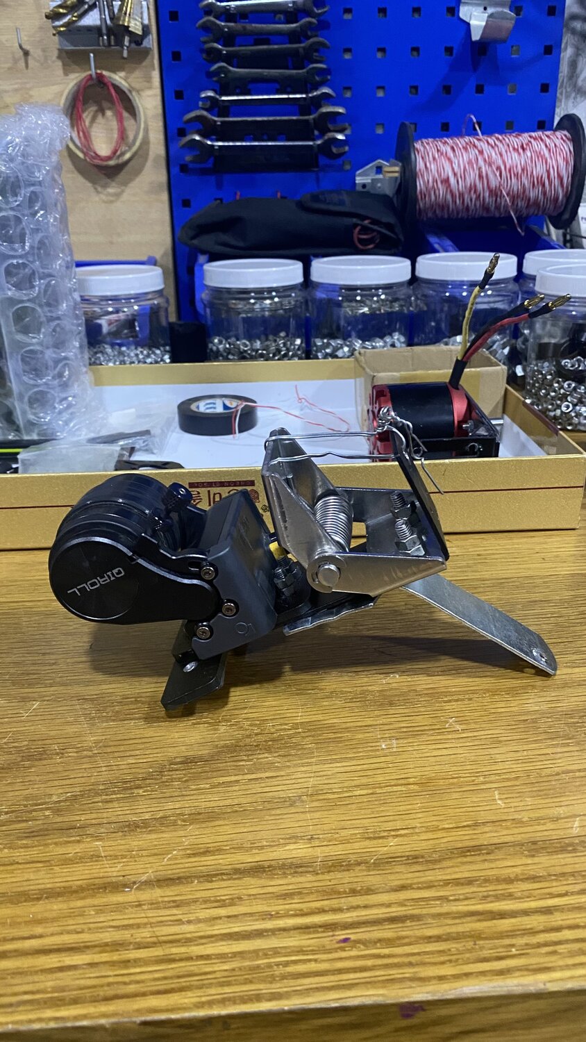

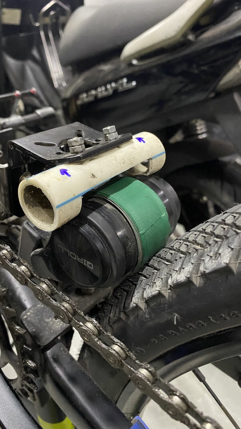

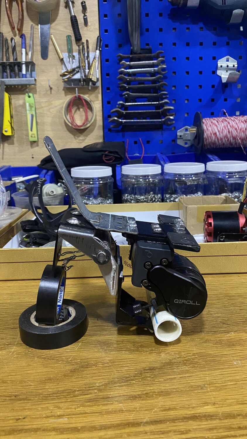

Thank you for mentioning me. I used a self-retaining spring hinge to force the Qiroll motor into the wheel. I use abric tape as friction roller tap. It is ok.

Hi.

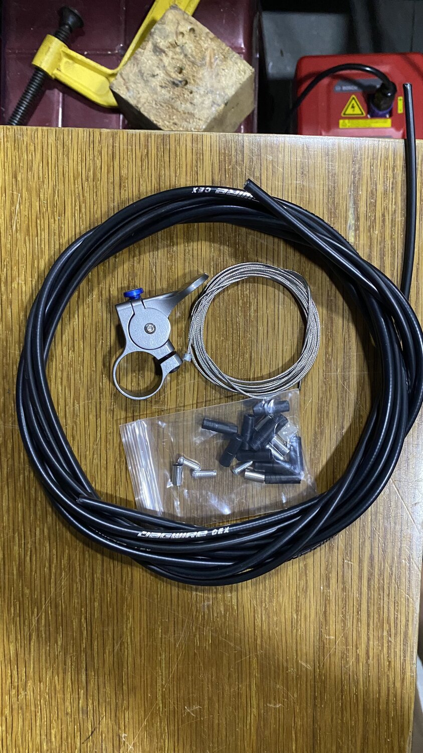

Looking forward to see video in action, looks like manual clutch.

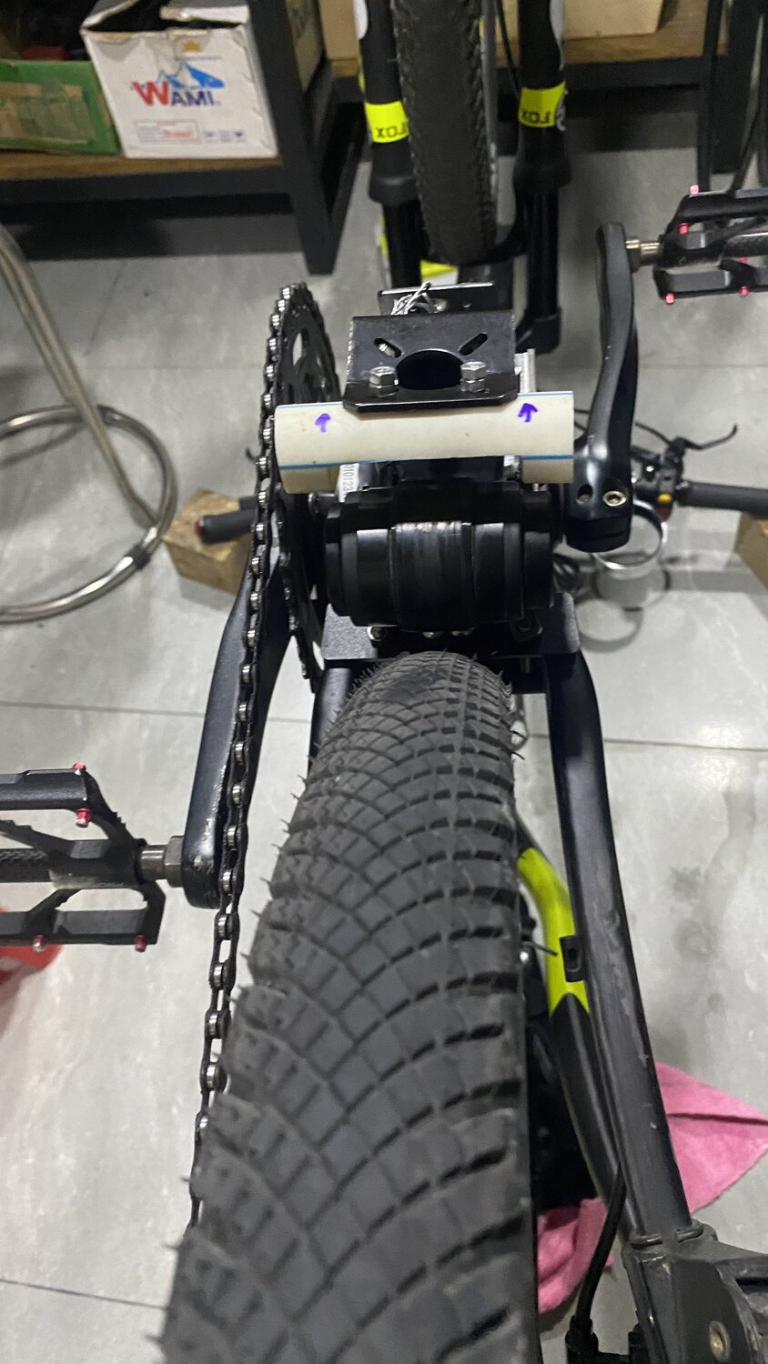

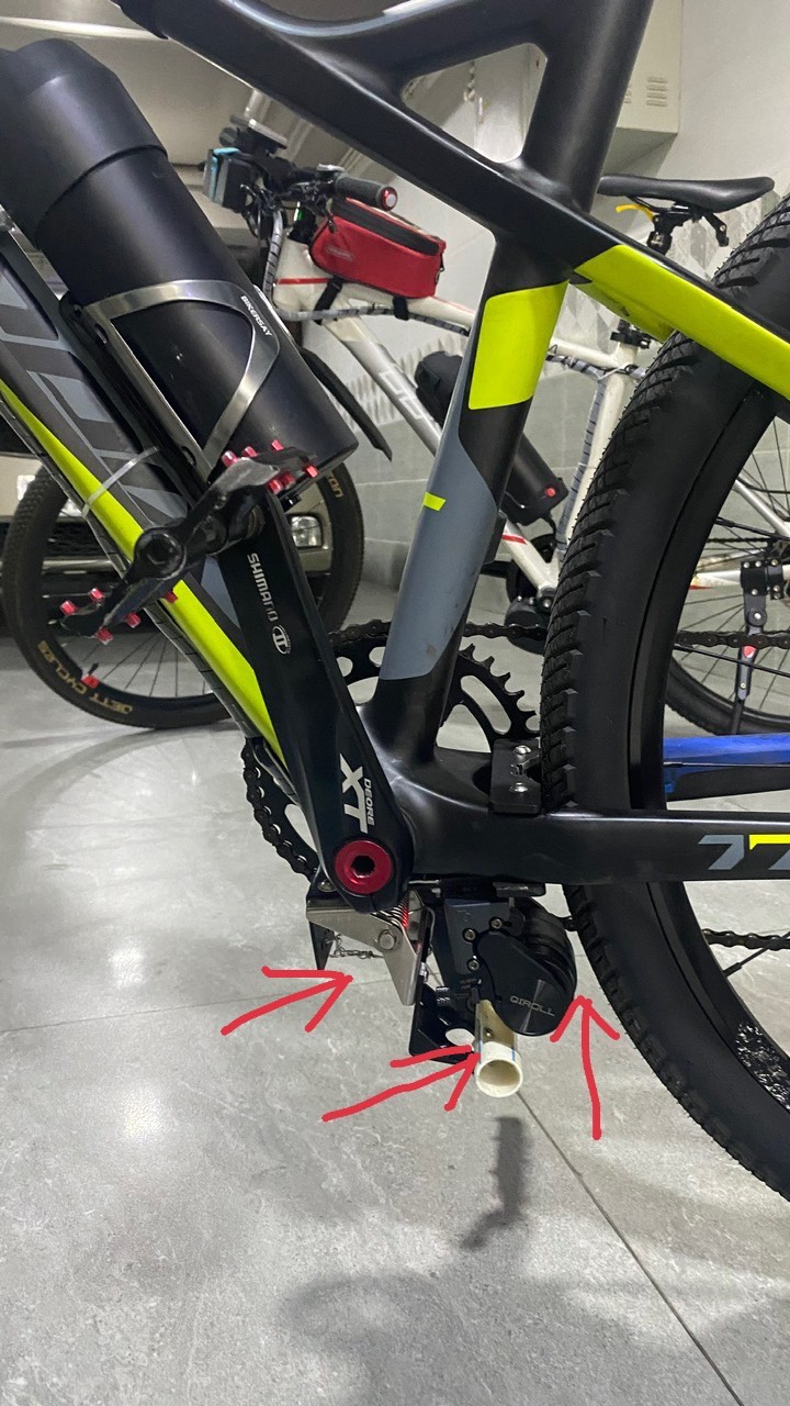

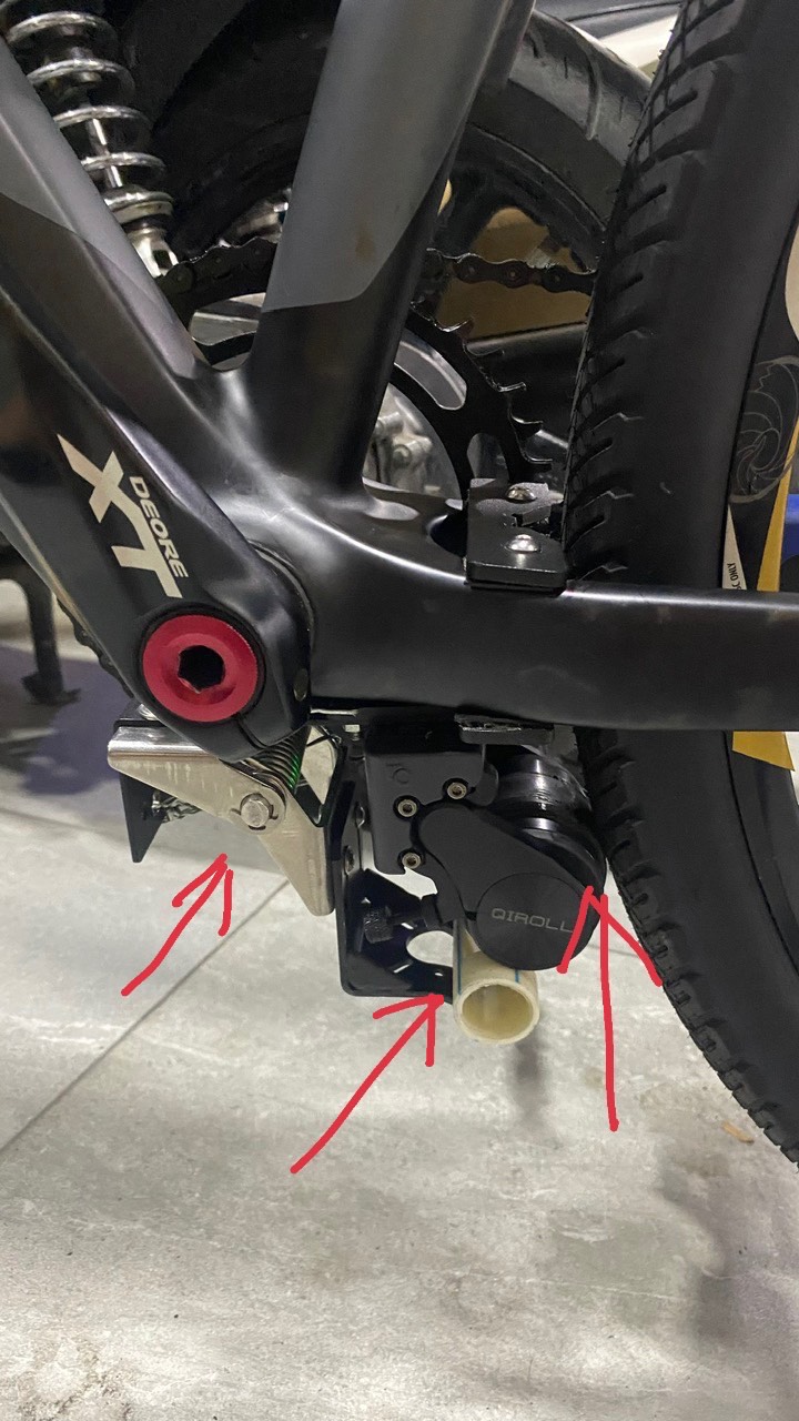

I'm not smart enough to figure out exactly what you did to make the spring compress the Qiroll against the tire. It looks like the spring hinge pushes the plastic conduit pipe against the roller thereby pushing the roller against the tire (and requiring the roller fixing screws be loosened to allow the roller to contact the tire)? If that is correct how does the plastic conduit stay in place and also rotate with the roller? Forgive me if I'm way off base but it looks like the Qiroll body is fixed to the bracket and the chainstays so the roller is the only thing that can be acted upon by the spring?

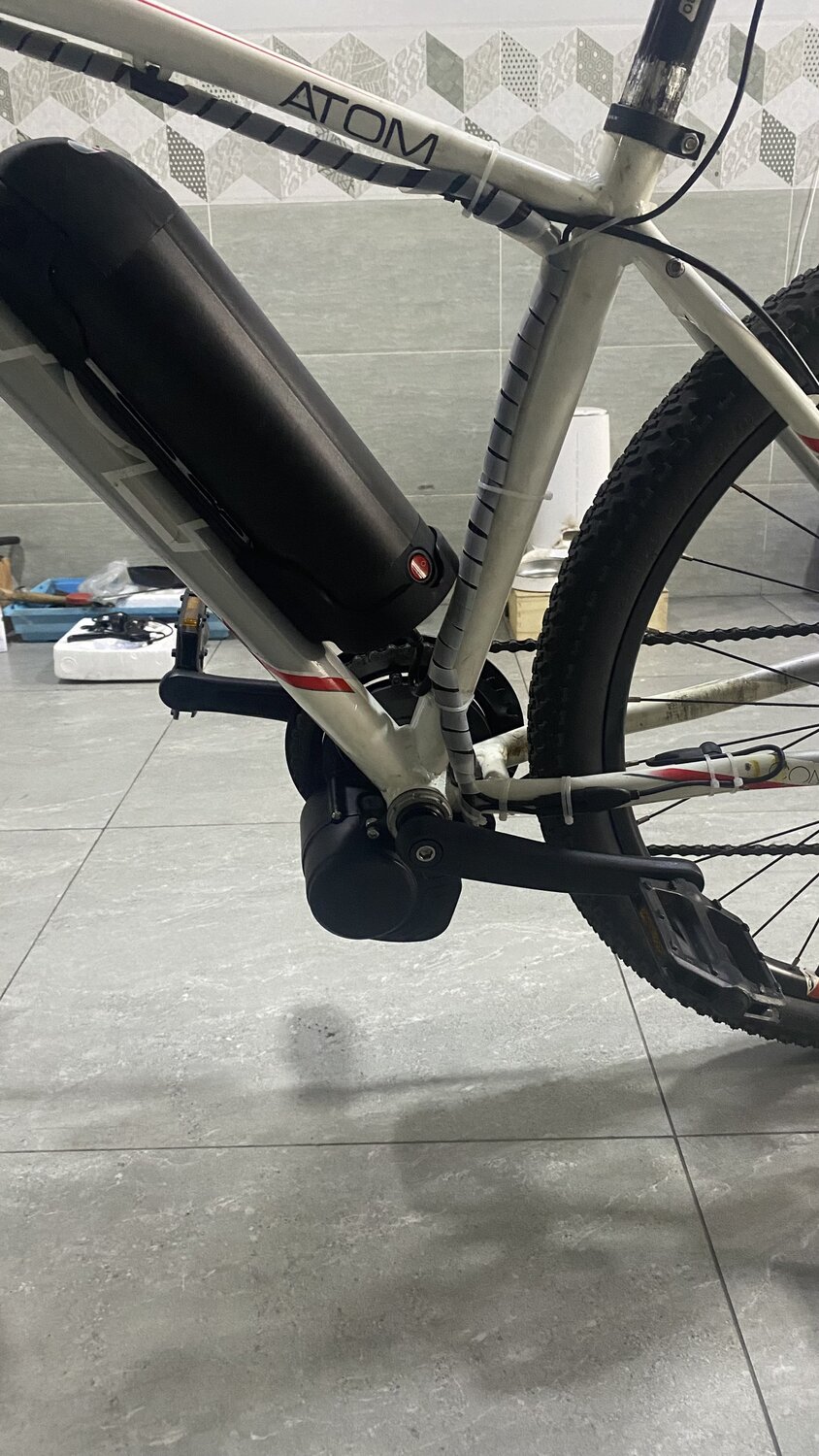

Is that a Tongsheng TSDZ2 mid drive installed on the white bike in the background of your picture?

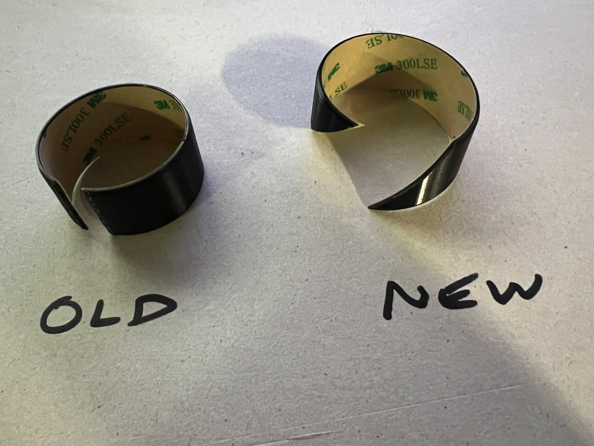

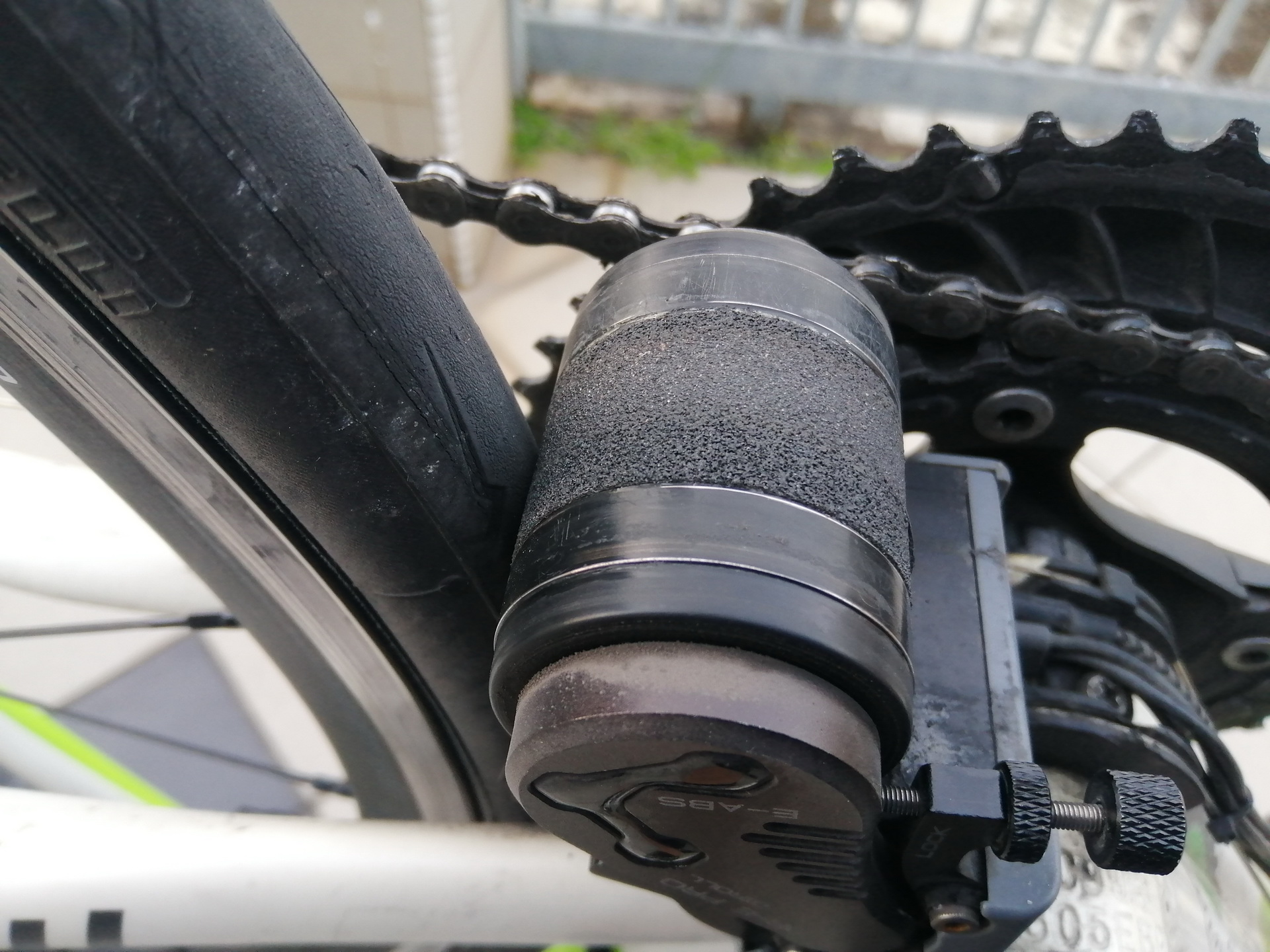

Do I understand you use fabric tape instead of the friction roller tape that Qiroll sells? For me, the friction tape has always been the weak point of this system as it can degrade and come off after awhile and depending on how much your ride and over what kind of terrain, you may end up having to replace the tape every month or maybe even sooner.
I was always wondering about what a more suitable and maybe even stronger longer lasting replacement for the friction tape supplied by Qiroll would be. Can you tell me what Brand/model of fabric tape you use?
Above is a pic of the old style Qiroll friction tape. As you can see the ends of the tape are cut straight across. This tended to eventuall peel off very quickly. Qiroll then changed the design to an angular/diagonal cut which seems to stay on the roller a bit longer. The old straight cut friction tape lasted me anywhere from 100-200 miles, the newer diagonal end cut tape lasts me up to 300+ miles.
Nevertheless, If you've found a suitable replacement for this tape, I'd love to see pics of how you cut it and what it looks like attached to your qiroll roller motor. And let us know how long (how many miles) your tape lasts and does it wear down your tire, provide sufficient grab against the tire.

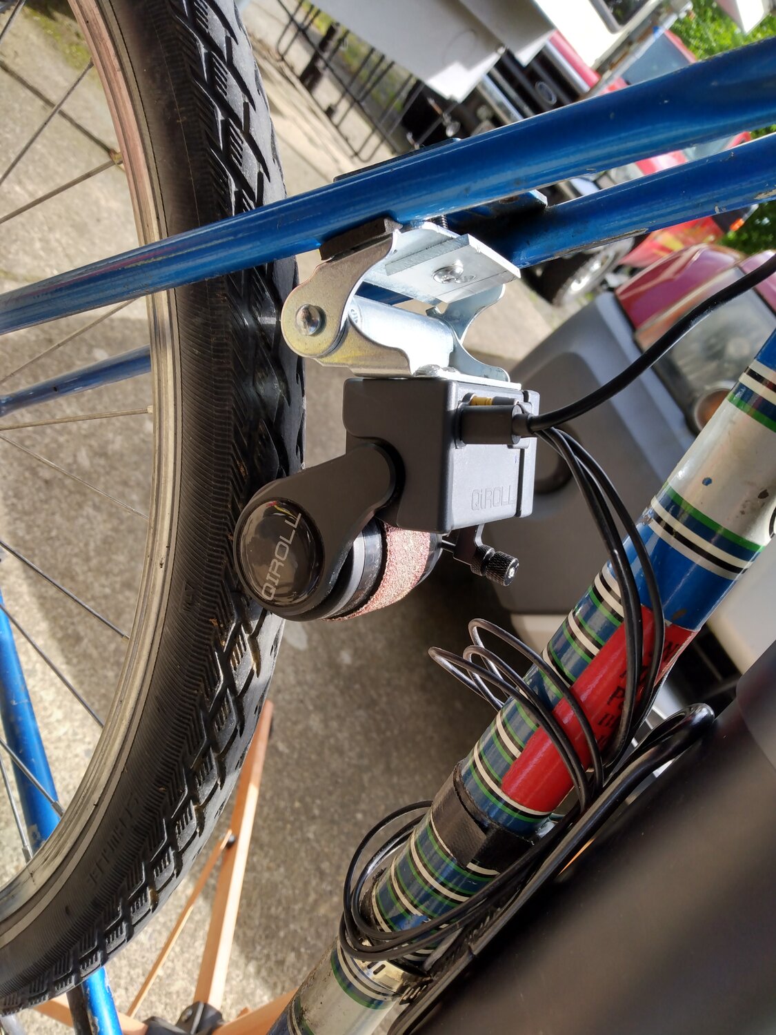

I couldn't quite figure out what kinhsang fabricated up but I like the idea of spring loading the Qiroll instead of fixed tension as stock. Gboost makes a friction drive with spring tension which you can see on their website. From what I can see on the product image the tension spring doesn't look very robust but apparently still gets the job done. Here's what I tried today on my Qiroll test bike which has a lot of room on the stays for installation.
I've only tested it a bit but it seems to work well without slippage. The spring hinge can be adjusted for more or less tension - I have it in the middle setting.

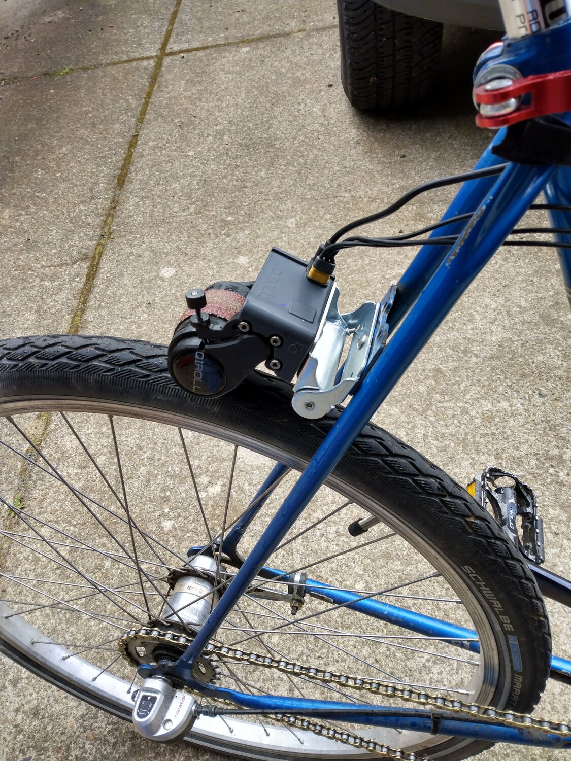

As an aside, has anyone else noticed that when the Qiroll is installed centered on the stays that the center of the roller isn't centered exactly on the tire? I had forgotten about this otherwise I would have drilled the holes in the hinge to compensate.
It also seems to work as well on the inside of the seat stays.

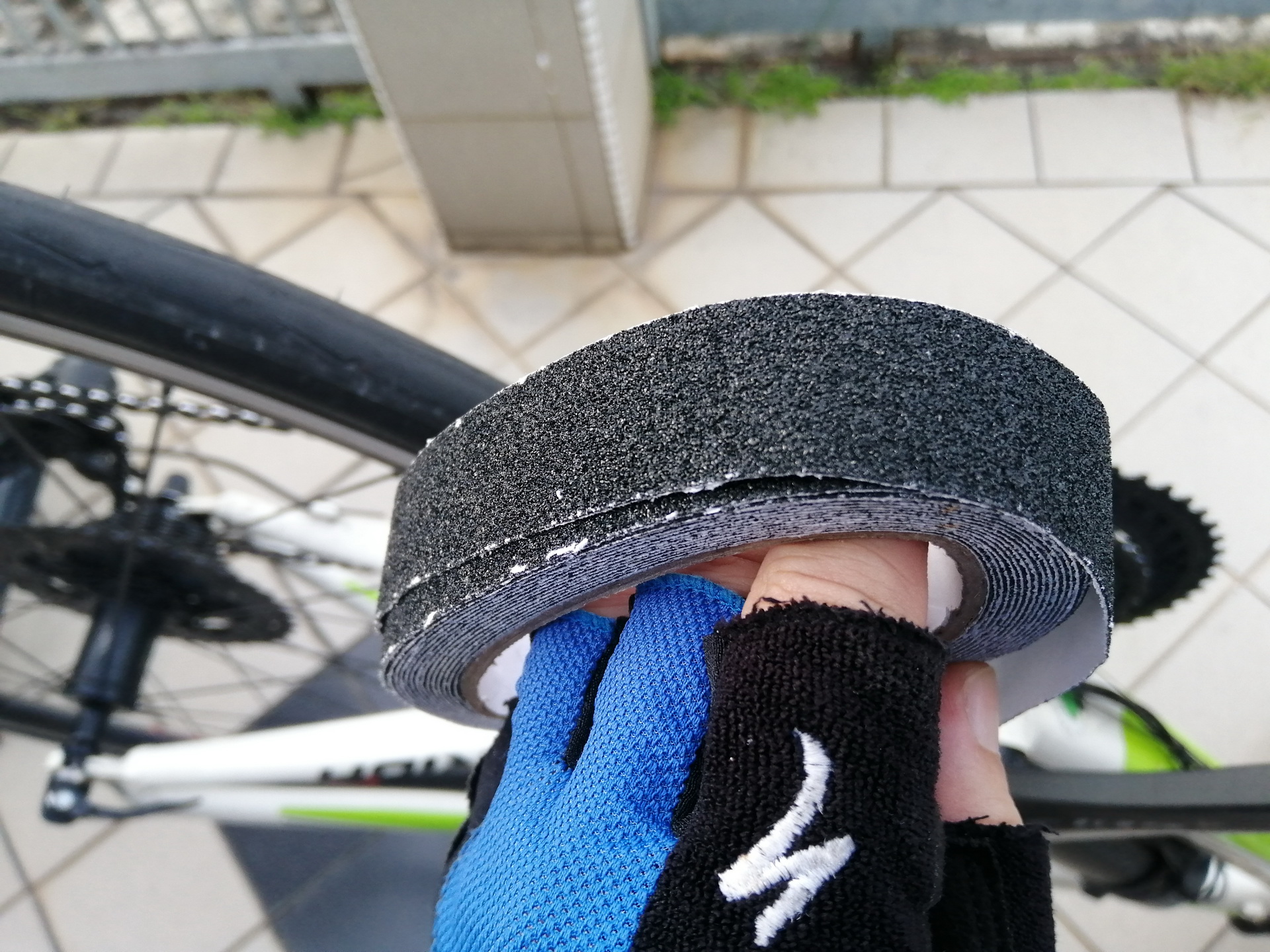

As shown from previous page and discussion i use 3M industrial floor grip tape, have rough solid surface almost like sand paper but really grips and non-slip on roller. Feels faster, impossible to slip and really works in rainy condition. You can feel more torque and assisted power when climbing hills. After two years running it i never worn out my expensive tires and have 100% success rate keeping me riding for 3 months or daily fast ride or more before need to change. 100% strongly recommended to use industrial floor grip tape. Even aliexpress alternative e-bike roller kit uses rough sand paper like grip roller. This tape costs around $2 per-roll and it takes 3 minutes to change. 1x roll gonna lasts for years.
This 3M grip floor friction last me approximately between 2,520km ~ 3,257km (based on my watch GPS tracking) riding through dirty and rainy condition commuting everyday to work before i need to change Floor tape wins!.
*Important note: For 320W QR-E Pro owner if you need to use 3M floor grip tape you must adjust the clutch roller to press much harder on the tire else 320W power might slip and worn out the tape faster and slipping too much causing more gash on the tire. Don't let it slip, apply more pressure on the clutch adjustment. I always apply more turn on the clutch screw knob adjustment until the tire surface have full contact yet able to spin assisted.
Hi
You think right. I made a manual clutch mechanism. When using Qiroll, the spring hinge will press on the Qiroll motor by the white water pipe. I cut the middle groove of the white water pipe so that it only overlaps the two sides of the Qiroll motor. I just got my hands on the bike's front fork lock to open and close this manual clutch. When finished, I will upload pictures.
I have another bike with a Tongsheng mid drive motor. It's very heavy. Tong sheng mid drive motor 4kg and battery 2kg. It is not as light as Qiroll.
