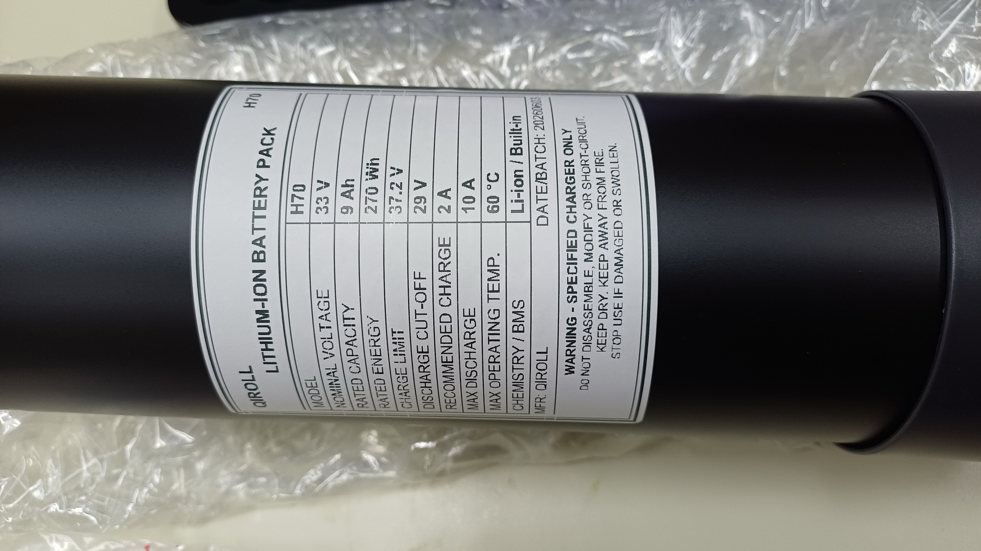

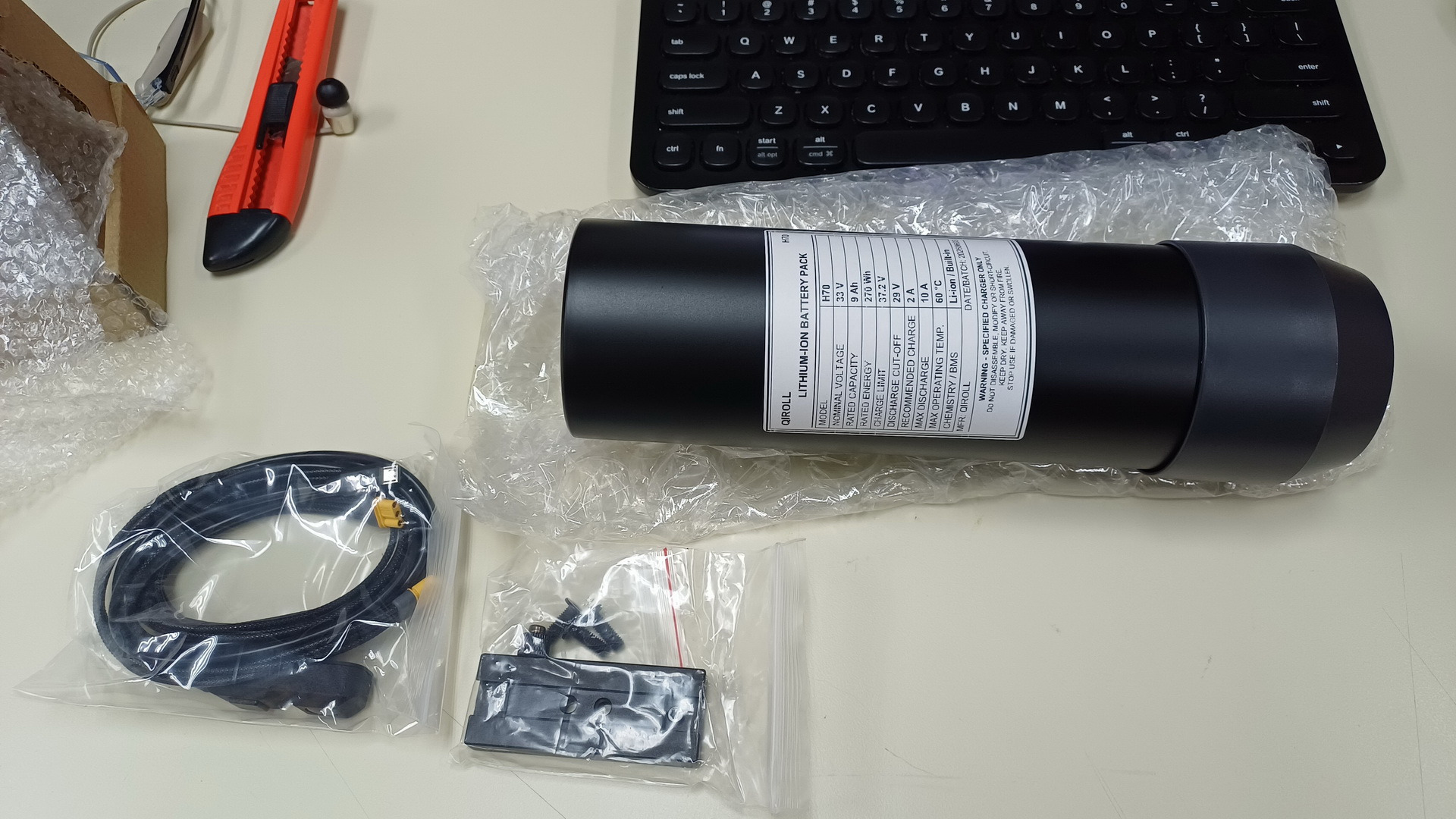

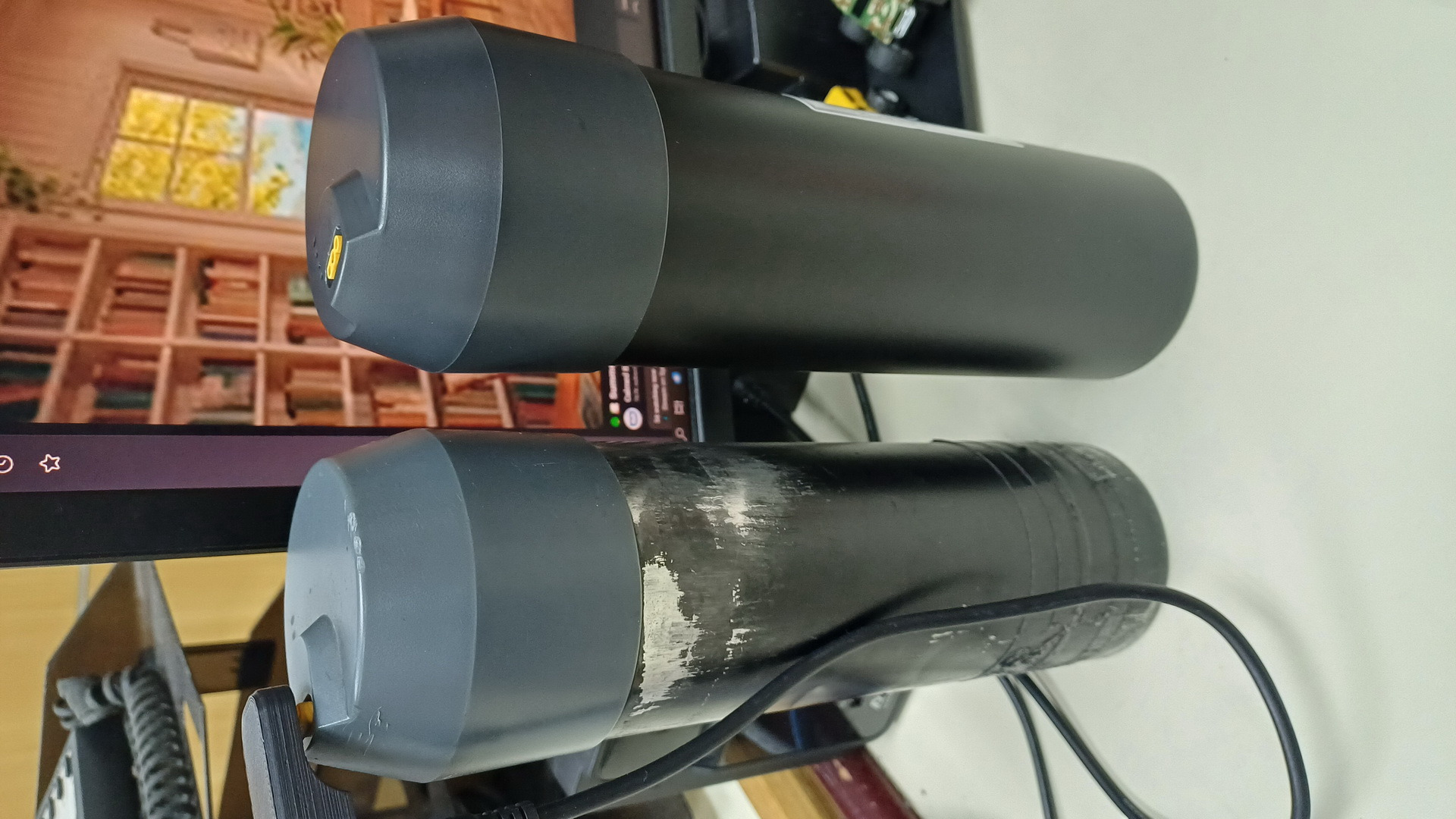

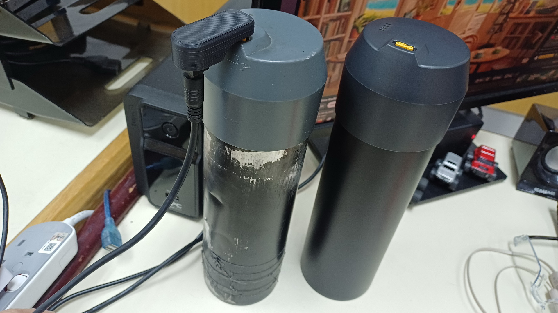

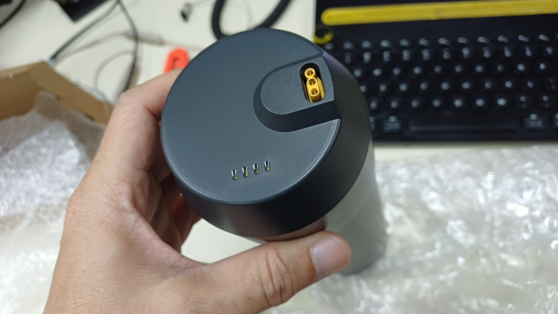

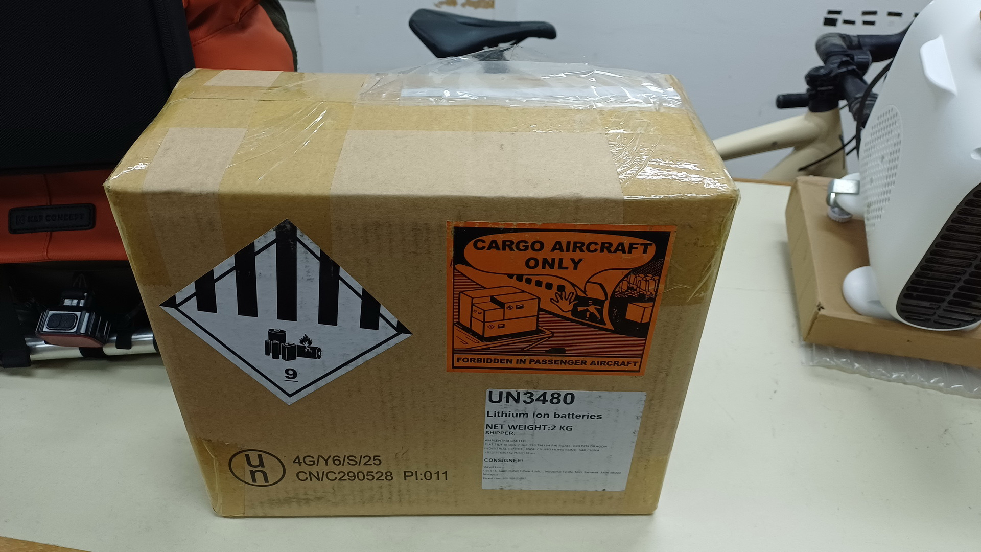

New Qiroll H70 battery arrived!
Finally i need to replace my 4 year old H70 battery..nothing wrong still works but sag 2 LED blue bars (voltage sagging) when i ride just doesn't have that "OOmmpphh!" power like it used to recently this month. However consider this old battery have been survive for 4 years with everyday bike commute use to work and daily charging i was amazed it still hold up today without dying. Old battery still alive hopefully i'd get extra lifespan until next year. Kudos to QIROLL for making quality battery while my other e-bikes battery died within a year for triple the price.

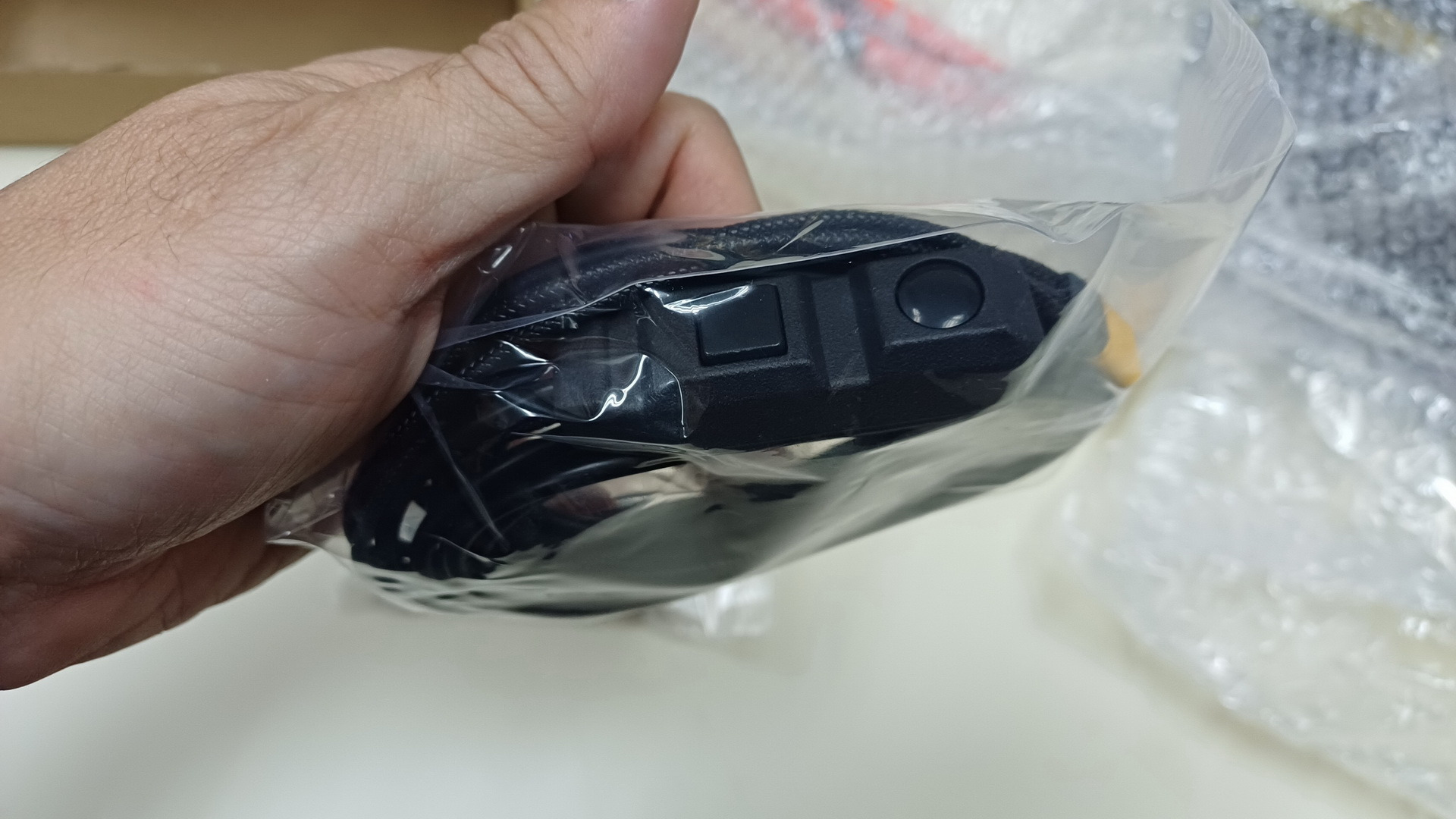

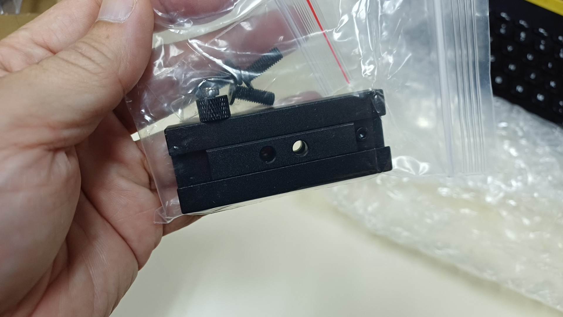

As for new battery i bought last week (fast shipping): Qiroll H70 it looks like an improvement over the old ones with different cap color and added proper user label. I'm planing to get another one after i do some rigorous battery test this week. Btw thanks to QIROLL again for adding extra goodies inside the box: Free switch cable (Actually my old ones was wreck) and also Quick release adapter (Also i need it for my folding bike)....i didn't ask for it but it seem that they can read my mind across continent, lol! Awesome gift pack.
Hope this new battery give me another 4~5 year of riding longevity. :cool:😍

New battery tested, felt like super human again. Gonna order 2nd one so i could daily rotate its usage.

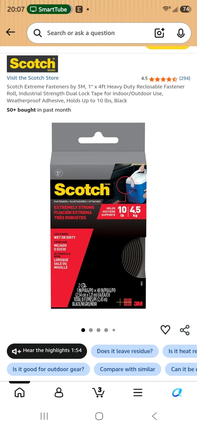

I've sent this email to Qiroll but would like others opinions. (On another topic, here is my unboxing of this kit:
I've had this kit for a few years now and everything is still working great. The only issue I have is with the friction layer. I recently applied my last friction layer and it came off after only a few miles. The adhesive separated from the rubber part. So I've been using the kit without the friction layer. Seems to be working fine. What are the long term effects of not using the friction layer? Seems to me that there might be slightly more wear on the tire but I can't imagine the hard surface will wear very much since the tire is much softer. And maybe that the tire will slip more easily since the coefficient of friction will be lower? Please let me know if I may continue to use the kit without the friction layer.

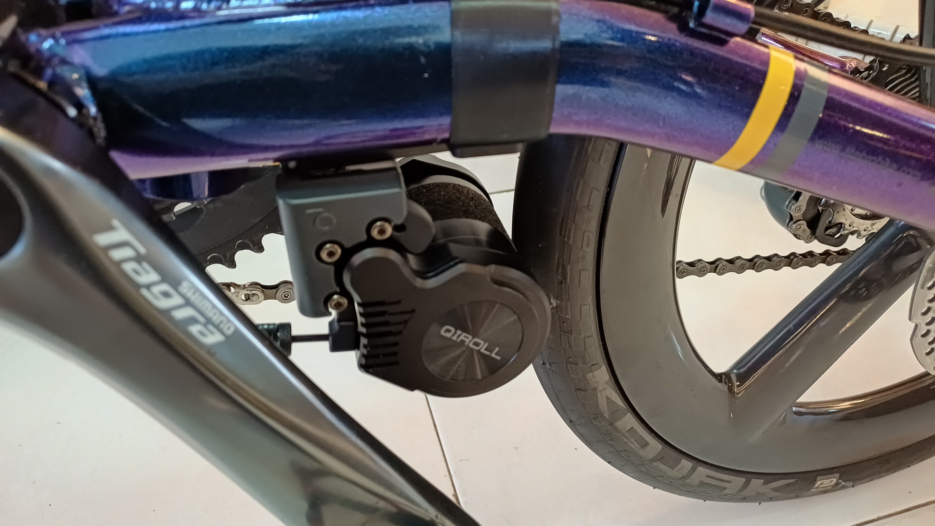

Without the friction tape you'll lost lots of torque..you may not feel it but it slips a lot even when dry but super worse on wet roads like 0 torque. I ditch the stock Qiroll friction tape 4 years ago and go for 3M flooring friction tape (those looked like sandpaper surface) gave me powerful 1:1 ratio torque without slipping. Within 4 years of use i don't see my tire worn off because of that sand paper 3M tape, the road surface is far more abrasive than that friction tape. Still use the same rear tire for 4 years until i decided to upgrade because of the rubber started to rot at sidewall due to hot sun over years of use. I love riding Qiroll in the rain.

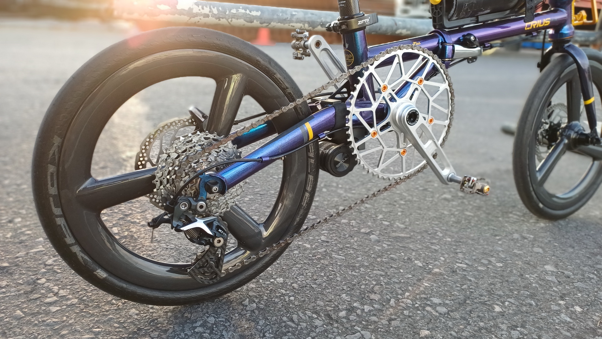

Ah I see, do you know if there's any changes since the demo version? And whats the range you were able to get? Im mainly gonna be using it for university commute probably around 13km one way, just wanted to see if I can make it either one way or both way with minimal pedaling if i dont need to.
Furthermore I was reading over the thread and just wanted to make sure, do u put the grip tape over the included friction layer with superglue or is do u put it straight on the roller without the smooth friction layer?
That Pro with whining sound i knew very well happened on my Merida (white bike), is it continuous? Mine like that, sound like jet turbine engine when throttle. I suspect the clutch mechanism inside making some scratches or something. Happened twice on same Pro unit. My other Pro so far was silent. I can't comment much on the clicking noise for MUTE and lost power on Pro since i haven't encounter such. Did you contact Qiroll support?
Yes on the "jet engine" sound from my Pro. They're both now a few years old so I'm not hopeful for any warranty support. I just need to move on from Qiroll or any other friction drive and stick to what has proven to work for me.

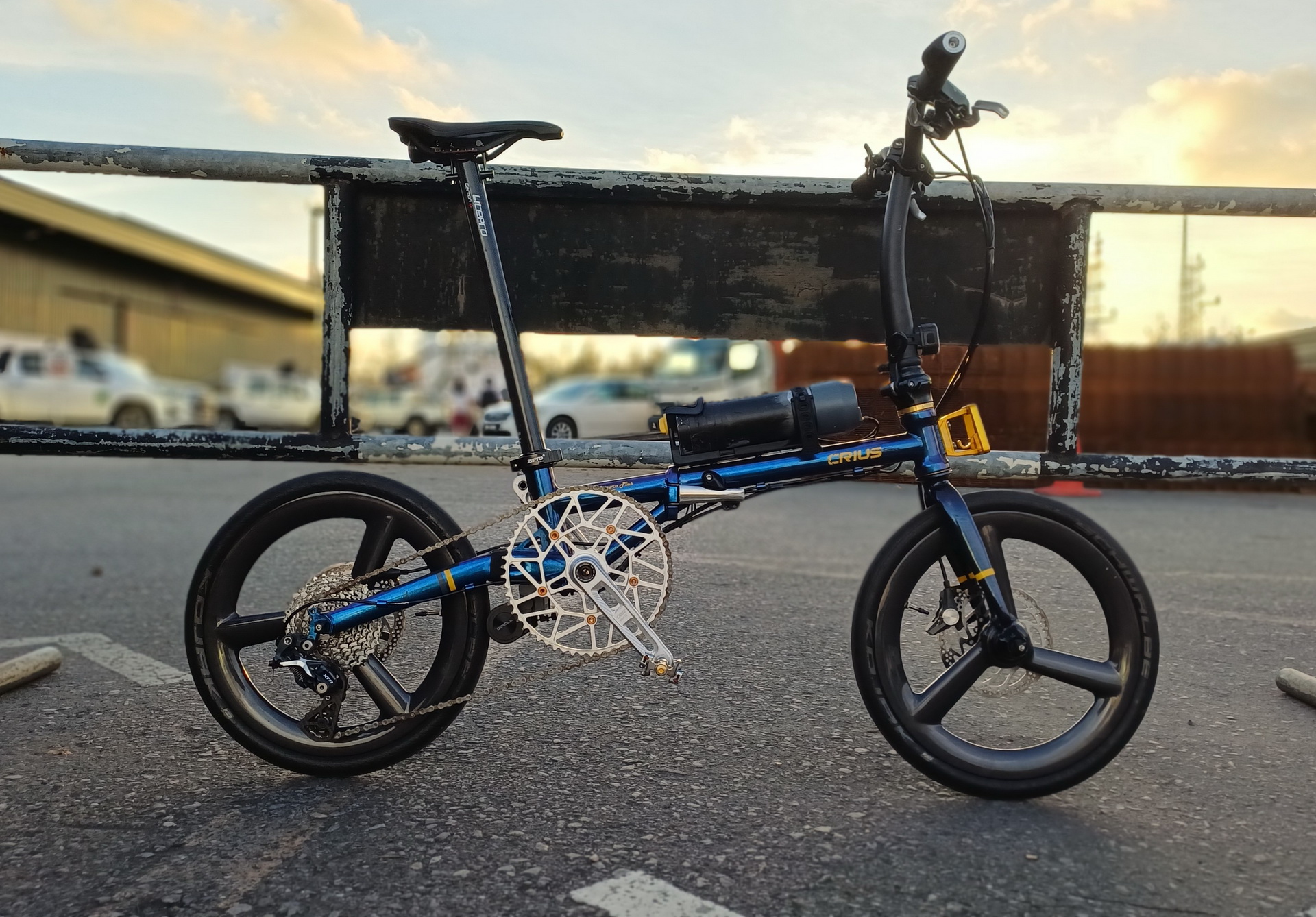

For the MAX (400W) 13km x 2 way should be no problem. Hefty amount of power left inside H70 battery. I put my 400W (MAX) on my folding bike just to scoot around the town with zero pedaling.
I don't put the Qiroll original friction tape..that tape fail me. I use 3M grip floor tape as previously recommended directly over the roller but since its wider than PRO unit i have to layer 2x side by side. No need super glue unless two ends of the tape tips flaked out.
