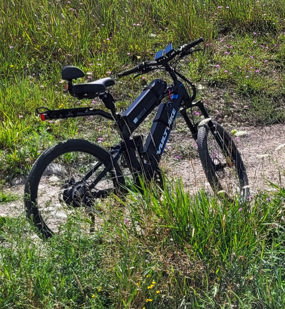

Have you considered a dual motor dual battery setup what like I've got ??
I've got a full suspension 500W (750W peak) hub-drive Voltbike that can be unlocked to 43 kph and 18 amps (Canada's limit).
I added a 750W BBS02B mid-drive to help it get up hills and Plow into the Gale Force winds. 😁
You could get some sort of full-suspension hub-drive ebike that's legal in the states,(750W nominal, 1000 Watt peak) and add a 750 Watt mid-drive motor of some sort, with a 1000W peak and end up with 2000 watts.

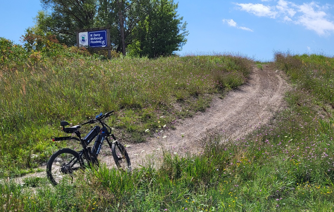

I used 1st gear (34t) on my smaller chain ring (44t) to climb this hill with both motors, and it just climbed right up the hill.
People here on the forum talk about 8% grades.
I thought that 100% grade was straight up at 180°, but it's not.
100% grade is only 90°
This Fricken Hill is damn close to 100%.
I walked right up it.
I didn't pedal.
I detuned my motors to 18 amps so not to overheat them.
The motors share the work and the heat.
I could climb all day up hills hills like this at 18 amps per motor and not break or burn out anything.

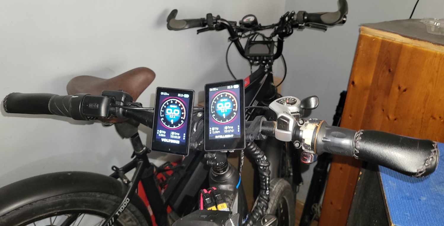

Checkout my cockpit,..
Two of everything. 😁
It's completely intuitive though.
When I fall over I instinctively roll off both throttles to grab the brakes.
And I Hold On For Dear Life, cuz both my throttles are locked on at Full Blast, and I might not have rolled em' off all the way when I fell over?😁

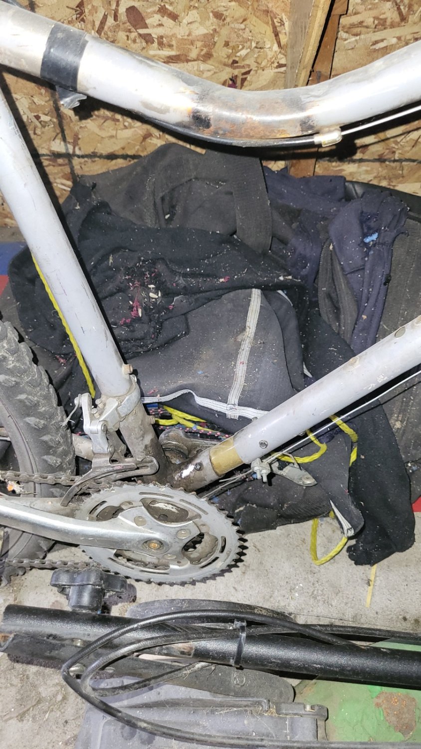

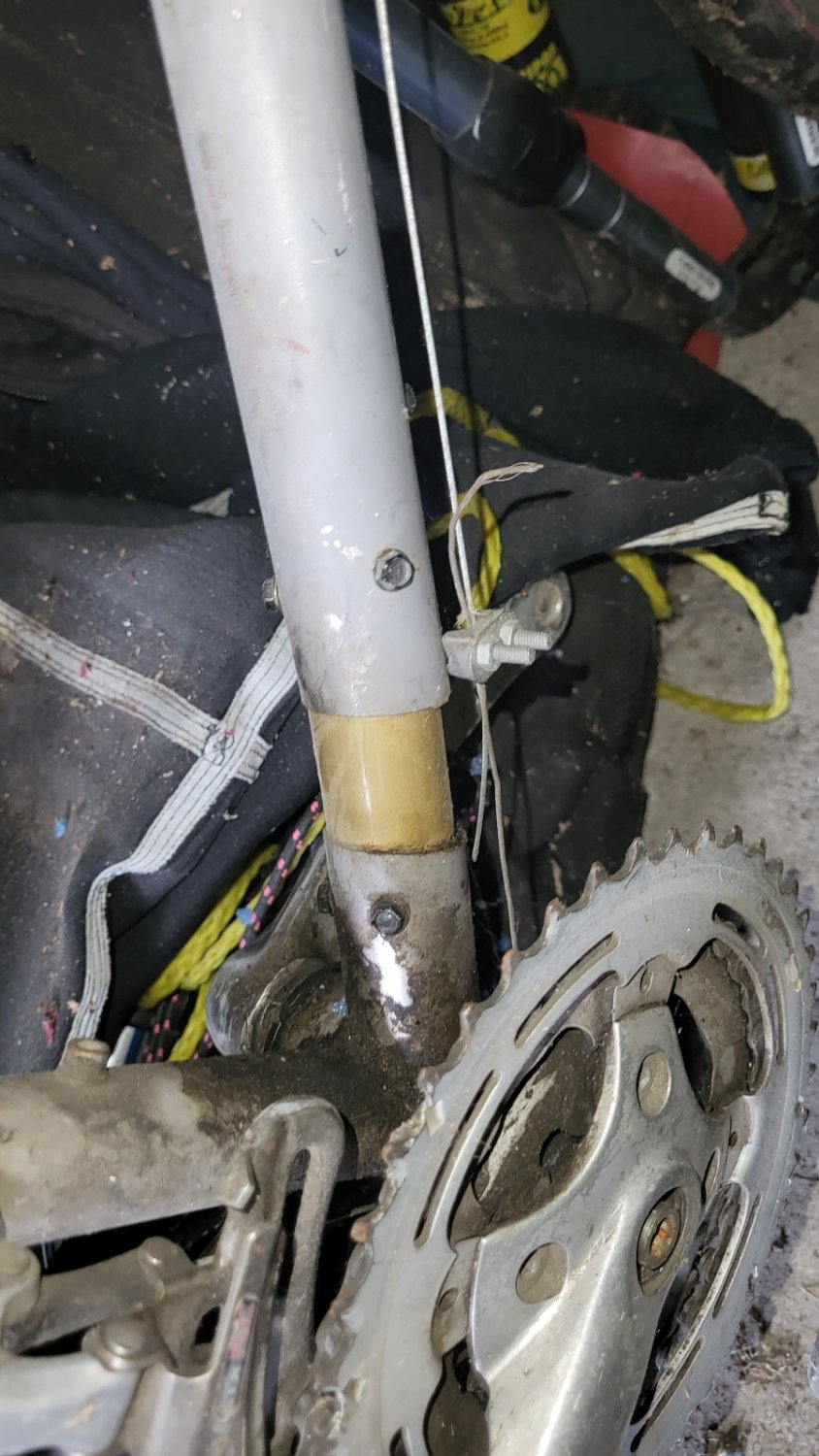

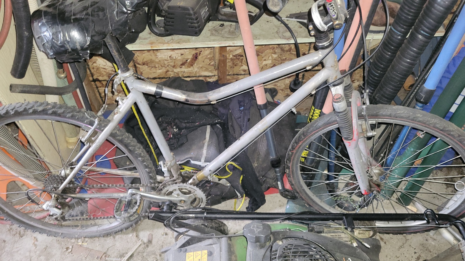

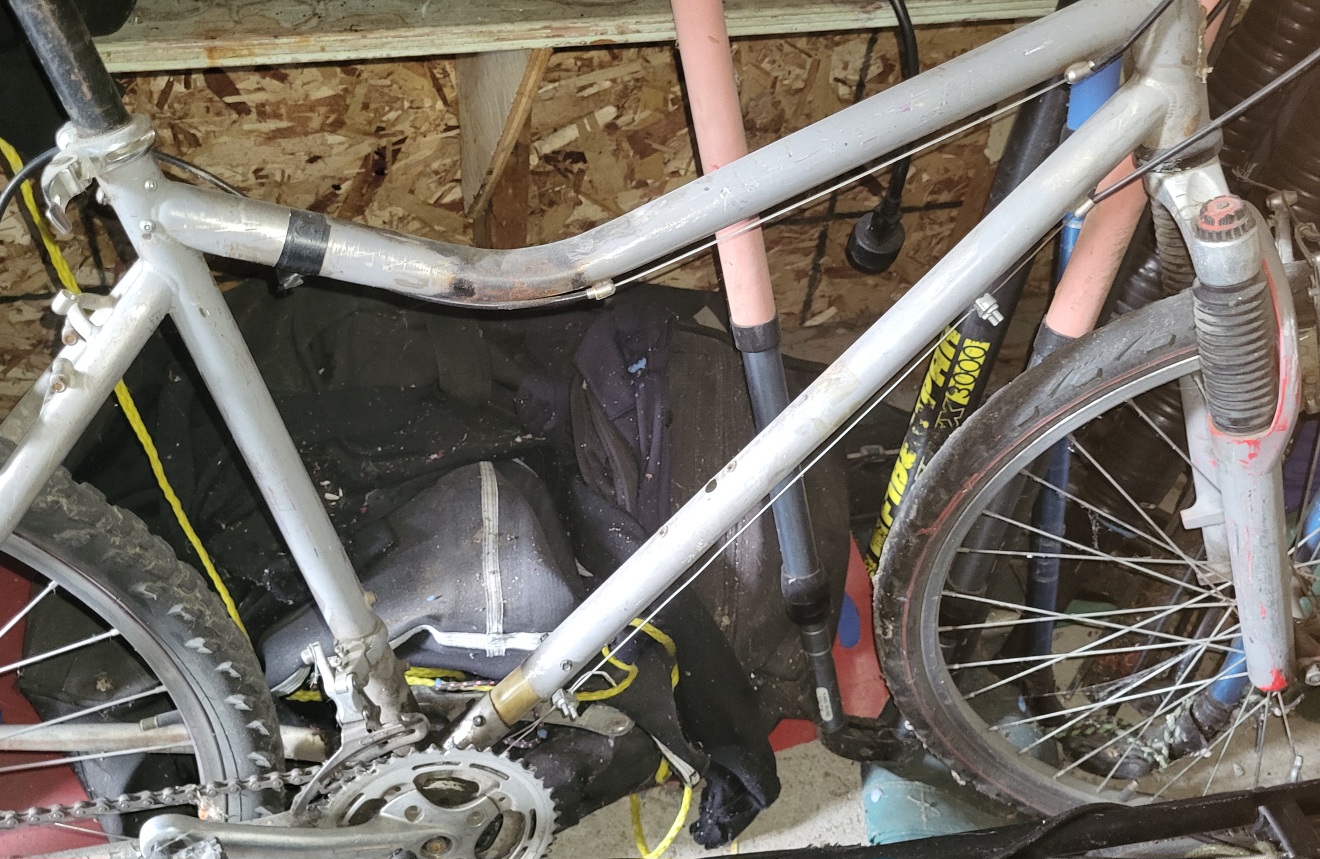

I HATED the quick steering on my mountain bike So Much that I cut my bottom tube, and Smashed The HELL Outta My top tube to Rake out my mountain bike.
If I knew how to weld worth a Sĥiṭ, I woulda cut the steerer tube off at the downtubes and rewelded them back on at an appropriate rake angle, but I can't weld worth a sĤit, and this was the best that I could come up with.,..
It worked, but not that great.
The biggest thing that I noticed was that I had way more pedal strikes with my BB closer to the ground.
My forks didn't rotate forward very much.
I remember when you tried to buy a frame WITHOUT Quick Steering and were stonewalled.
There's simply nothing available.
We need to build our own ebikes with proper angles.

I'm pulling 18 amps outta each battery at ~48V, and throwing it into two motors for over 1700W total.
I can turn up my mid-drive to 25 amps for a total of over 2300 Watts with fully charged batteries.
Both my motors can handle 52V batteries and 25 amps (legally purchased), and that would give me almost 3000 Watts with both motors pushing.
I'm not legally allowed to do that in Canada with our 500W, 750W peak limit, but it's fine to purchase in the USA.

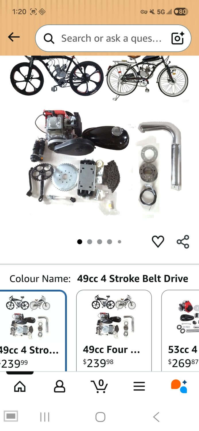

What about adding a 4-stroke engine to the bicycle of your choice?
The engine is only a few hundred bucks, and you can probably find a cheap or almost free bicycle to attach it to?
I'm not sure how a 50cc 4-stroke engine compares to an electric motor for power torque and range, but it's supposed to get over 90 mpg.
In Canada a gasoline powered engine on a bicycle is legal if it's under 50cc.

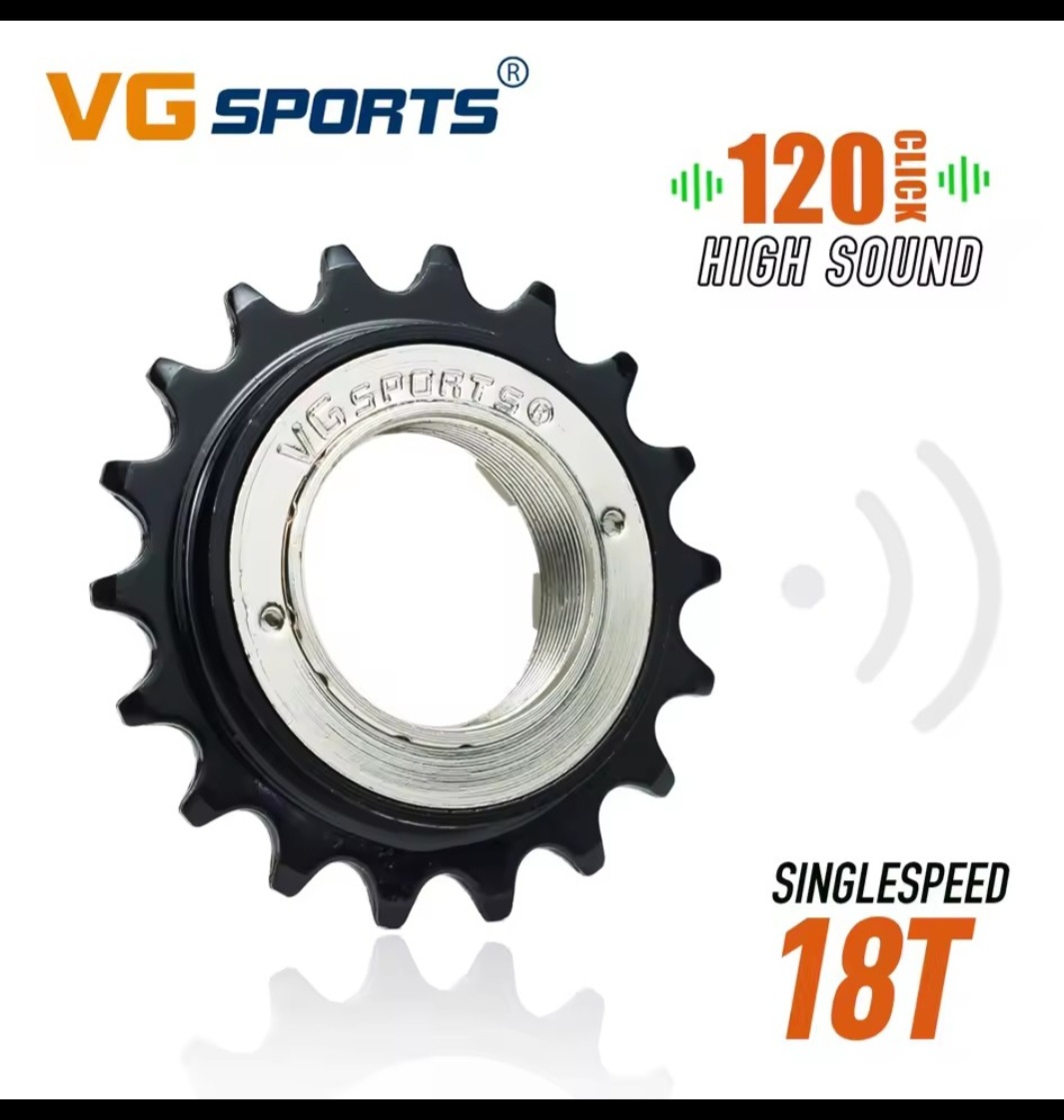

,.. I have seen that the Yamaha motor on Yamaha bikes was one that you did not spin the motor with your feet when riding unpowered.
Some sort of clutched gear like this single speed freehub gear, could be used with the gas engine so the engine wouldn't rotate when you're pedaling.
My mid-drive has Tons Of Drag on the internal motor clutch, but a freehub gear has Very Little resistance when freewheeling.
I just found this on AliExpress:
VG SPORTS Single-Speed Bike Freewheel, 1 Piece, Threaded Freehub Replacement Parts Compatible with 1/2" x 1/8" Bicycle
