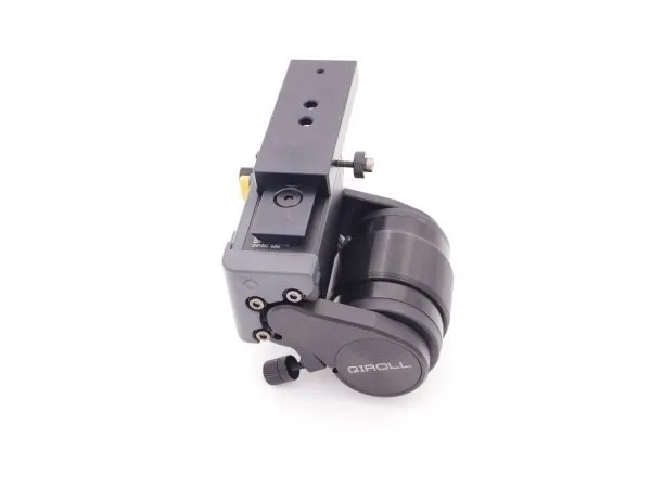

Just got the qiroll recently and have been riding more often and further than ever. It's barely even noticeable when installed near the chains.
Stock friction tape sucks and only lasts around 10km before falling off. Tried the floor grip tape which lasts maybe 50km for me. Currently trying out sandpaper belt for belt sanders which seems to be the best option so far. Also started to design a better TPU tape to 3d print.

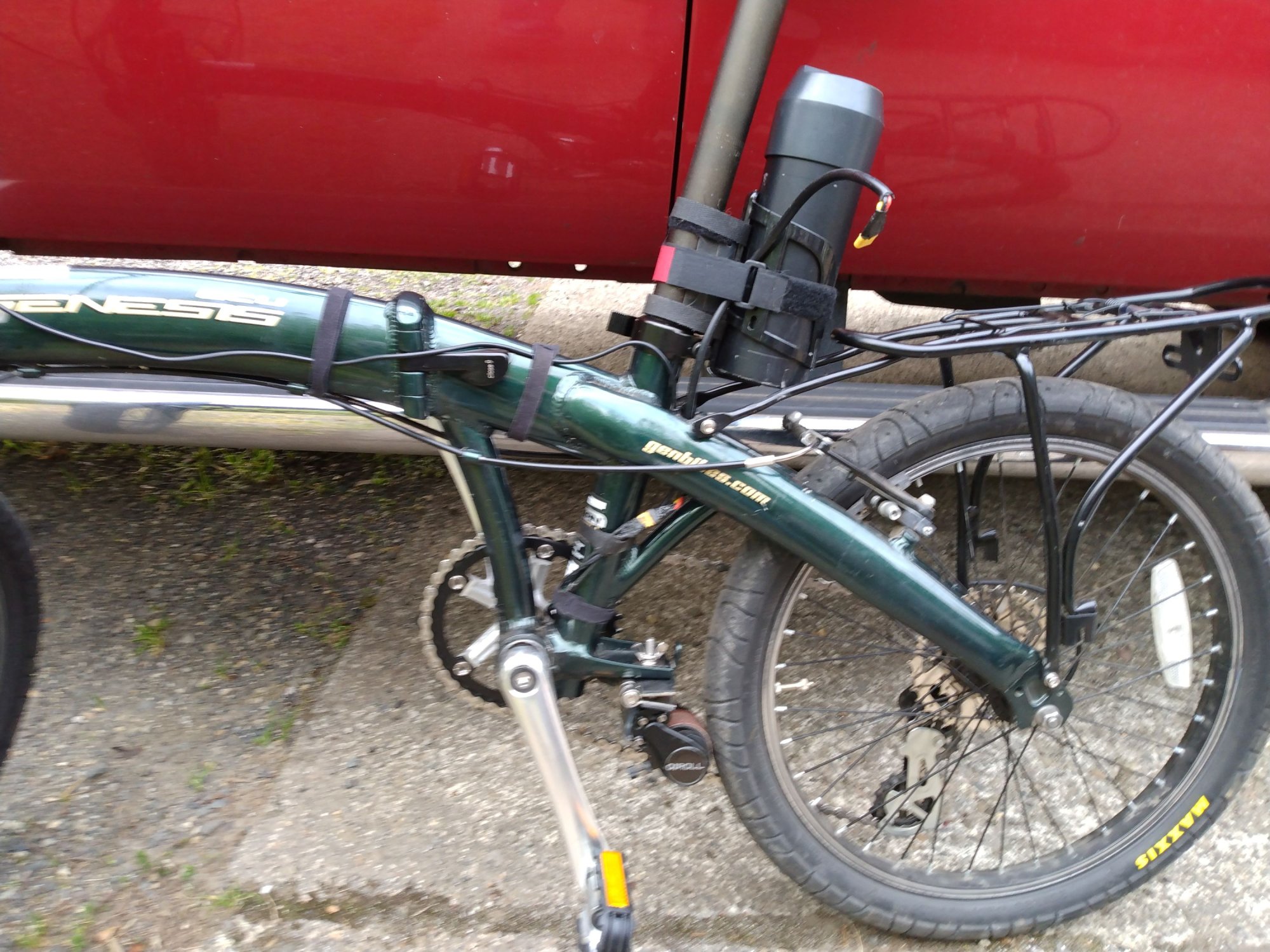

Nice stealth setup, barely looks like an ebike. Keeping things looks like normal commuter bike.

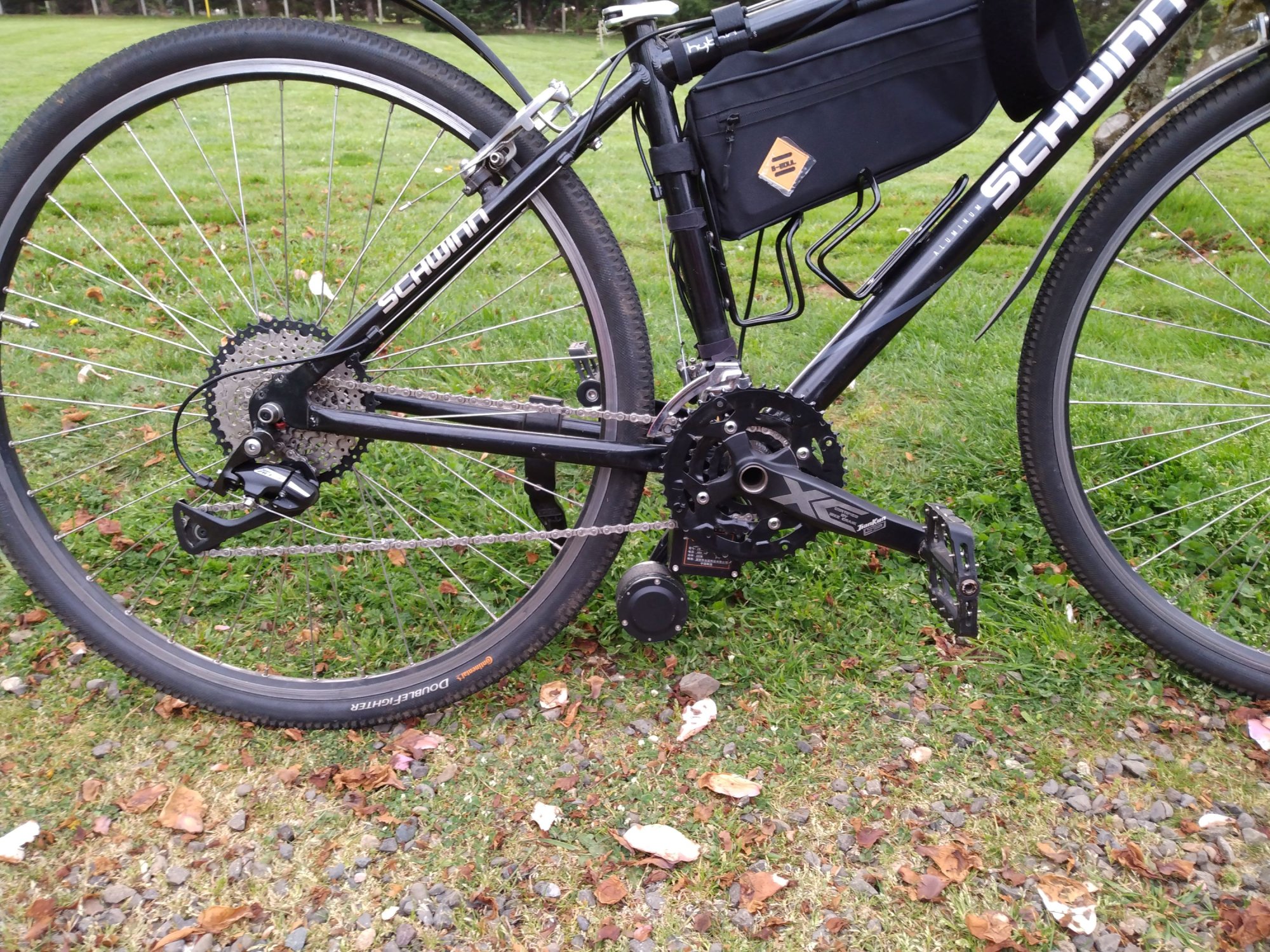

My current bike setup. Battery still running well everyday.

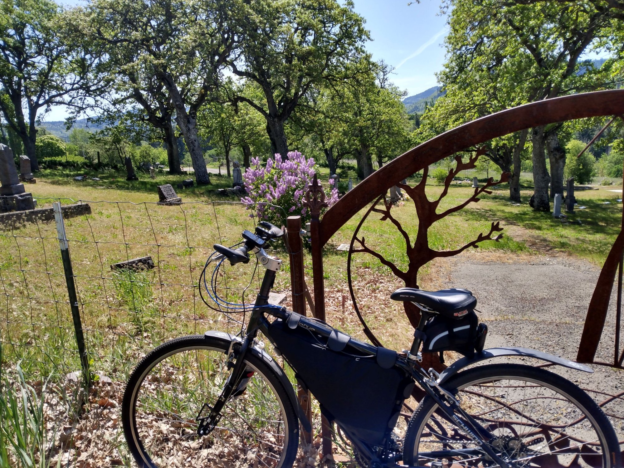

The non-Qiroll friction drive in the image above burned out after 7-8 miles of riding on a hilly route. Up until that point I thought it worked pretty well with significant assist although I was putting in a good amount of effort pedaling. It died suddenly on a 12% incline (per Garmin) in level 4 of 5, again with me inputting a lot of pedaling effort, motor was quite hot. YMMV but it didn't work out for me. Of note my Qiroll Mute Plus on the same bike had survived without an issue on the same route although it provided significantly less assist.
Here's where it died, appropriately along side a cemetery.

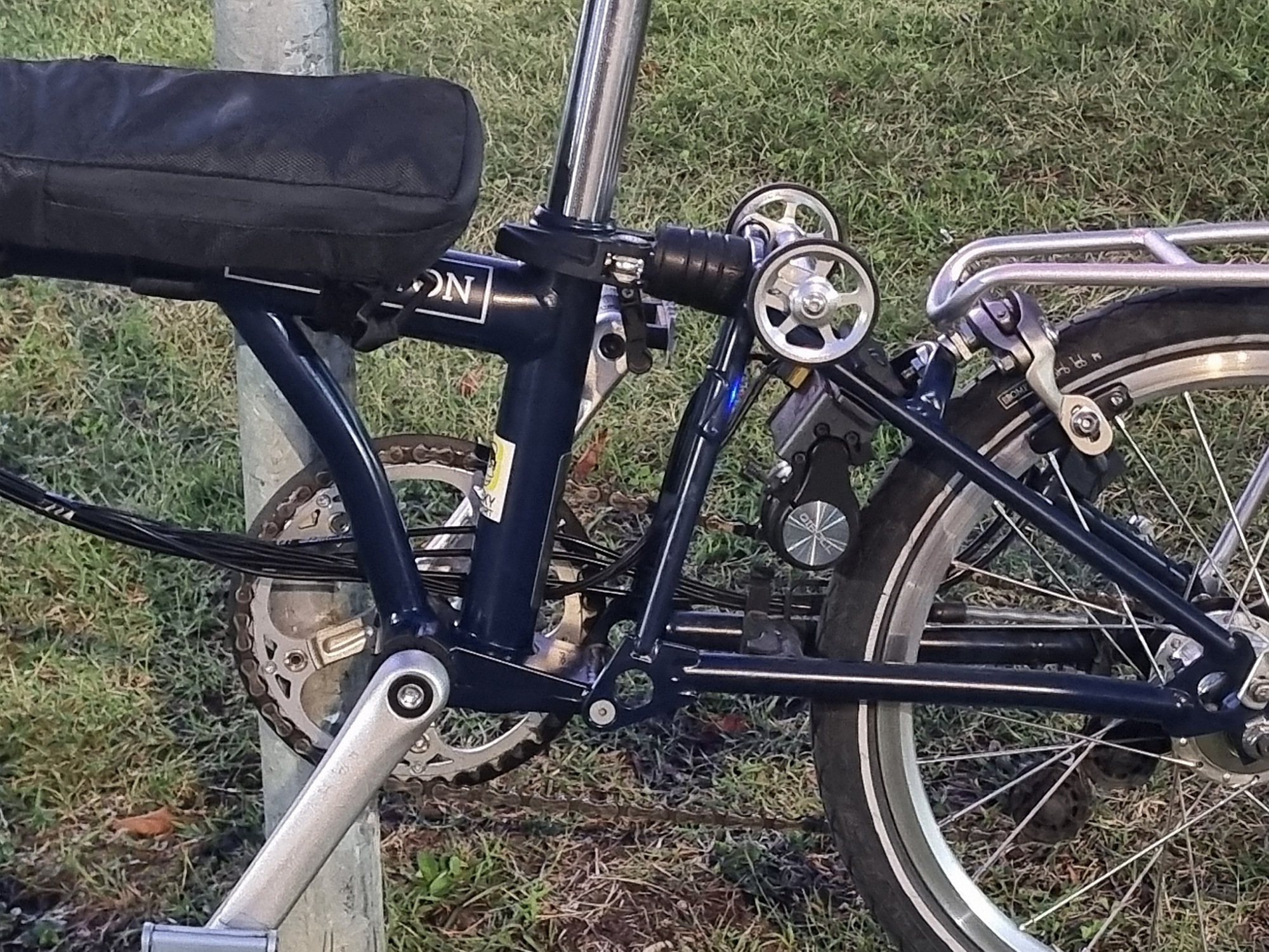

Anyone have experience with installing qiroll on a Brompton? I know there's an installation on their website (https://qirollshop.com/install/) that says it's compatible, but it looks like installing in the rear triangle will interfere with the seat post from engaging the seat post stop in the folded position.

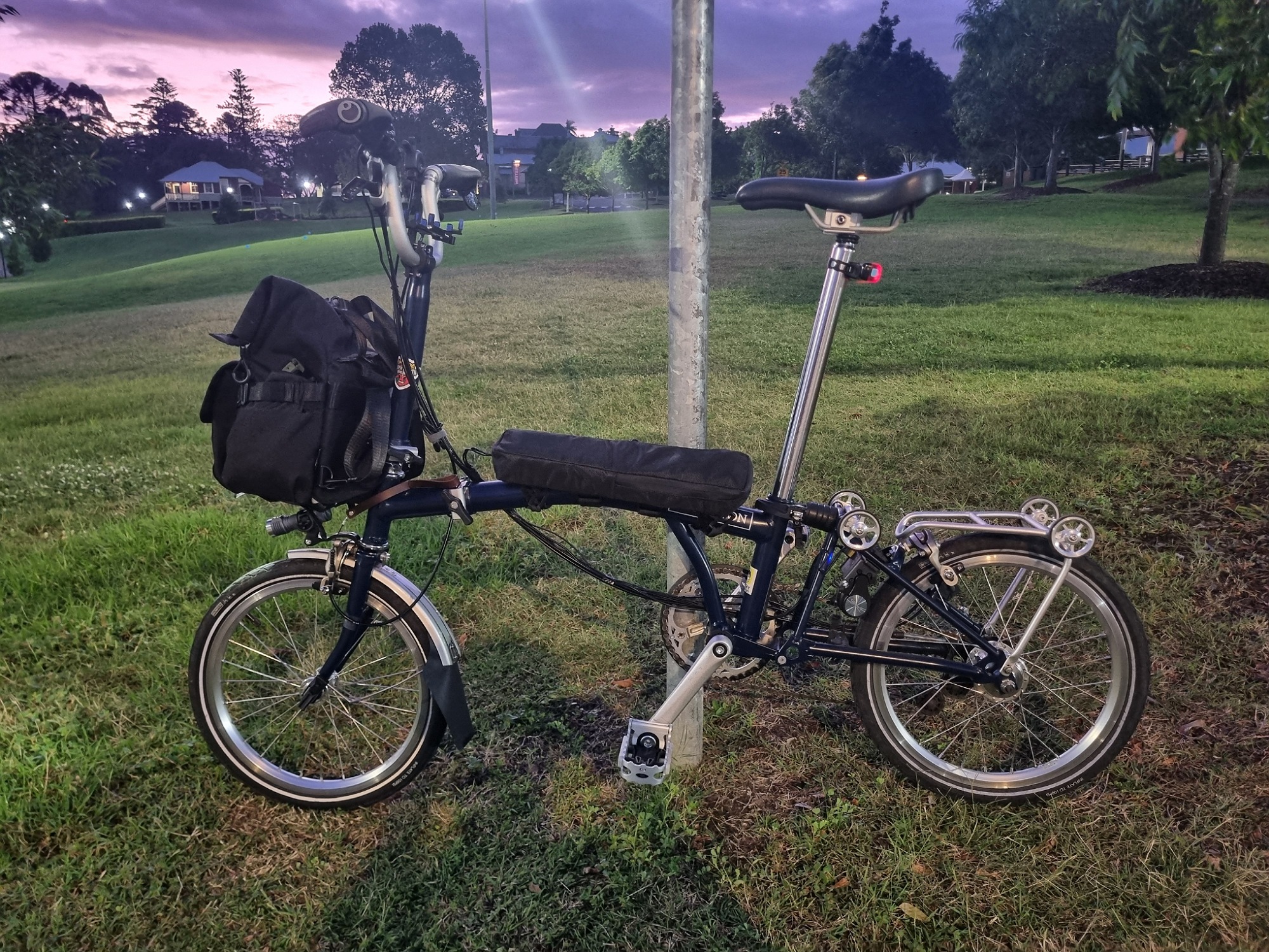

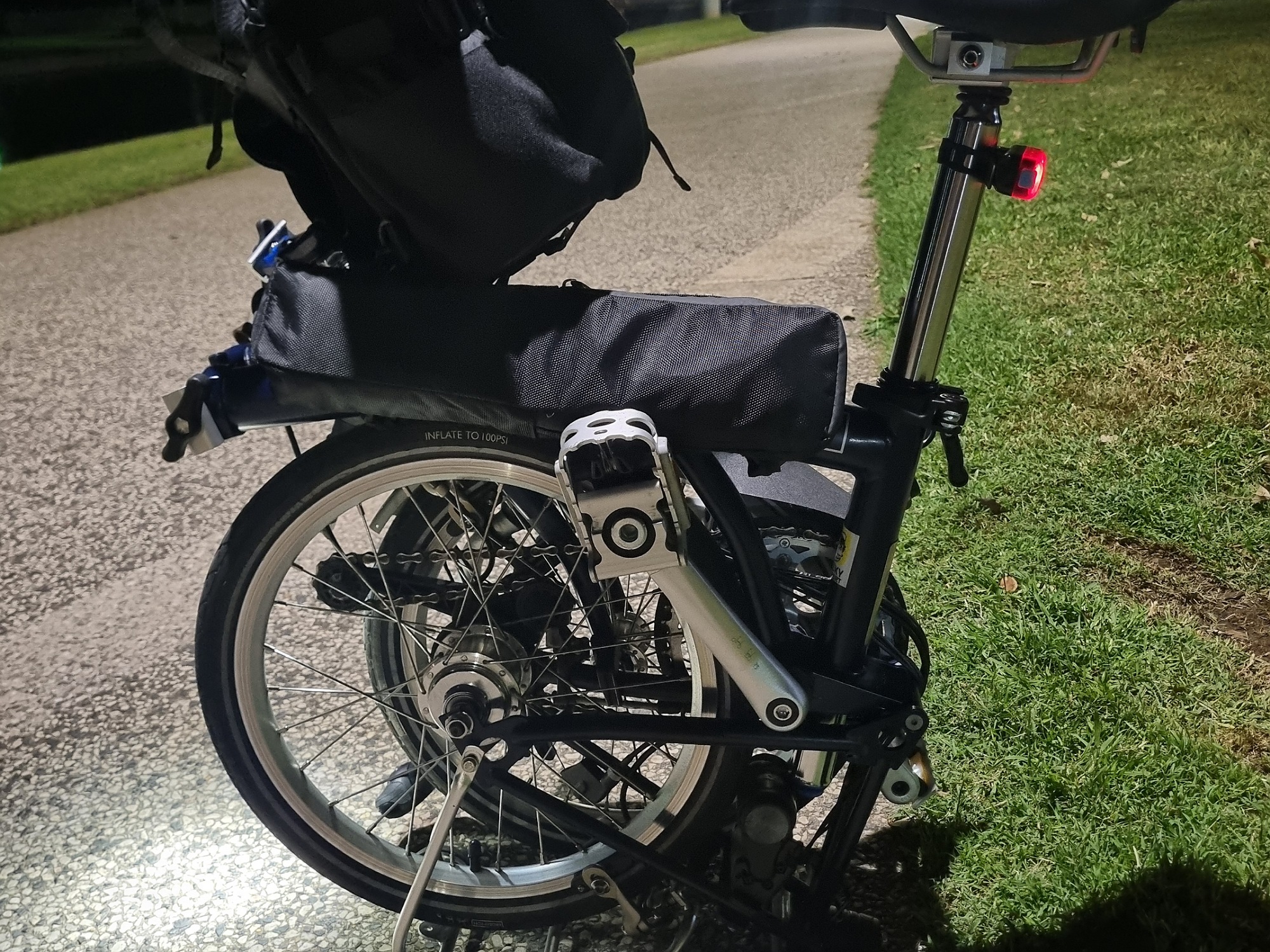

To answer my own question about Brompton compatibility.
It does fit in the rear but involves removal (or trimming) of the mud guards. Fold is affected because the seat post doesn't go all the way down. There is also this option for front mounting which I might explore at some point:

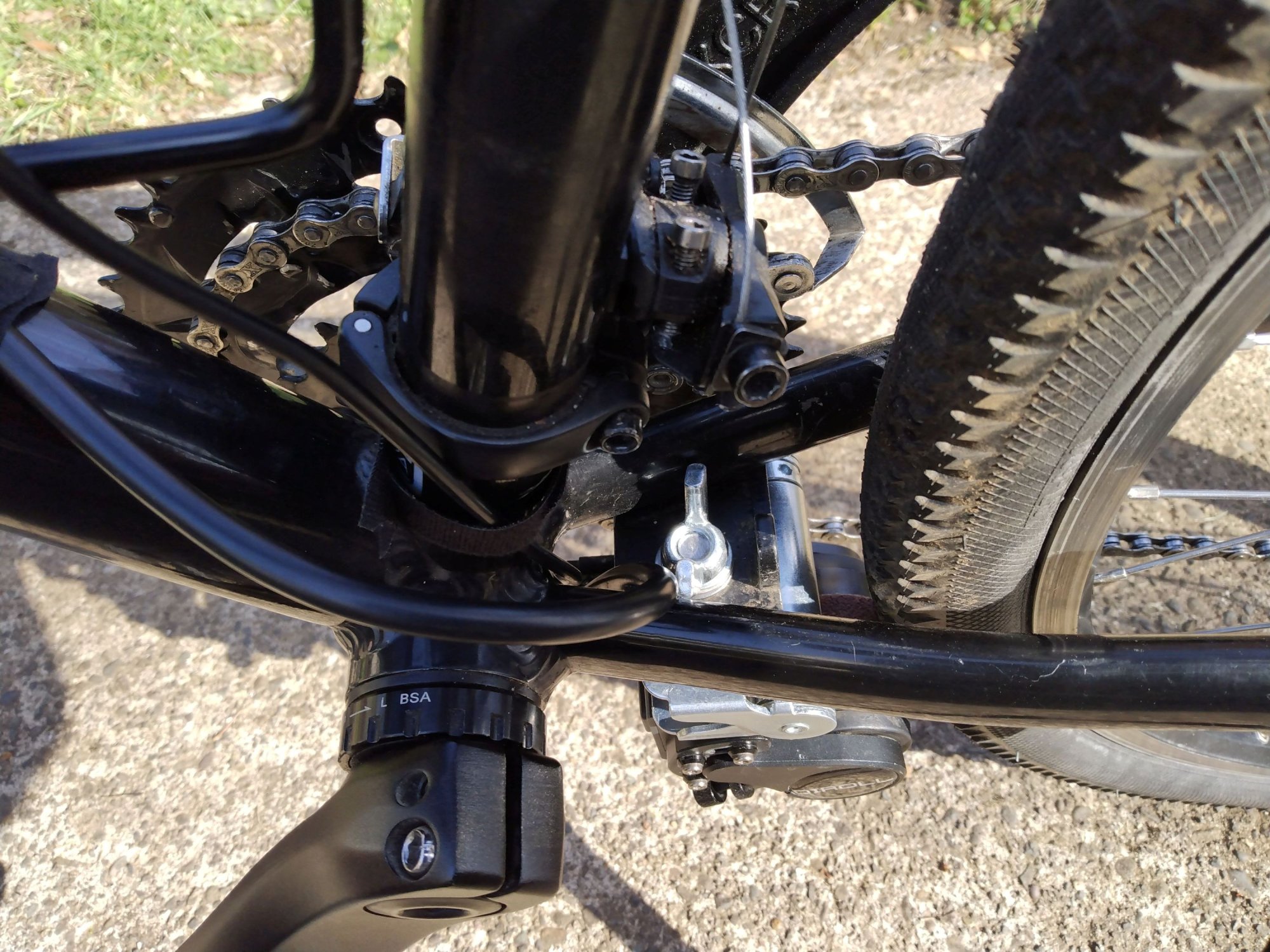

At one point I installed my Qiroll on the front fork of a 26" bike that had an easy install unlike your Brompton. It seemed to work as well as it does on the rear wheel (caveat, I only did a couple short test rides).
The quick release would help in the sense that the motor can be removed without tools, but that's not something I can see myself bothering to do every time I fold so I think I will just have to live with the slightly bigger folded size.
By the way, where did you get that spring hinge from? I can't seem to find anything similar at my local hardware store
The spring hinge is 3" stainless steel that I got off Amazon. I needed cobalt drill bits to make the Qiroll attachment holes and one for a bolt to the kickstand platform, if you don't have cobalt bits it might be better to source a hinge that isn't stainless. I have used a similar 4" hinge on a different bike where I mounted the Quiroll on seat stays but 4" is to long for this bike and location (would hit chainring or left crank arm). Couldn't use 3.5" self closing hinges because the knuckle/barrel portion length is the same as on a 4" hinge.
