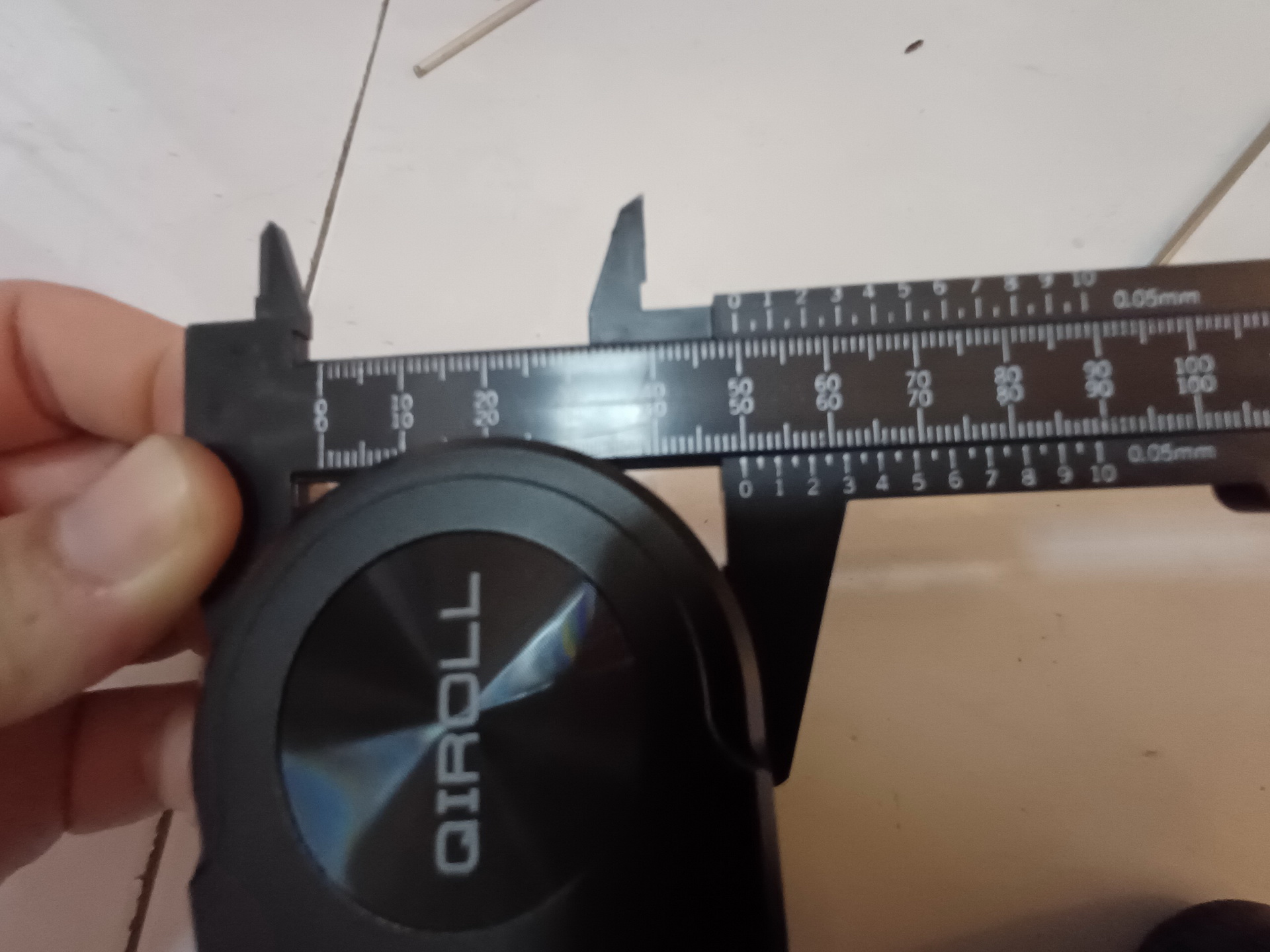

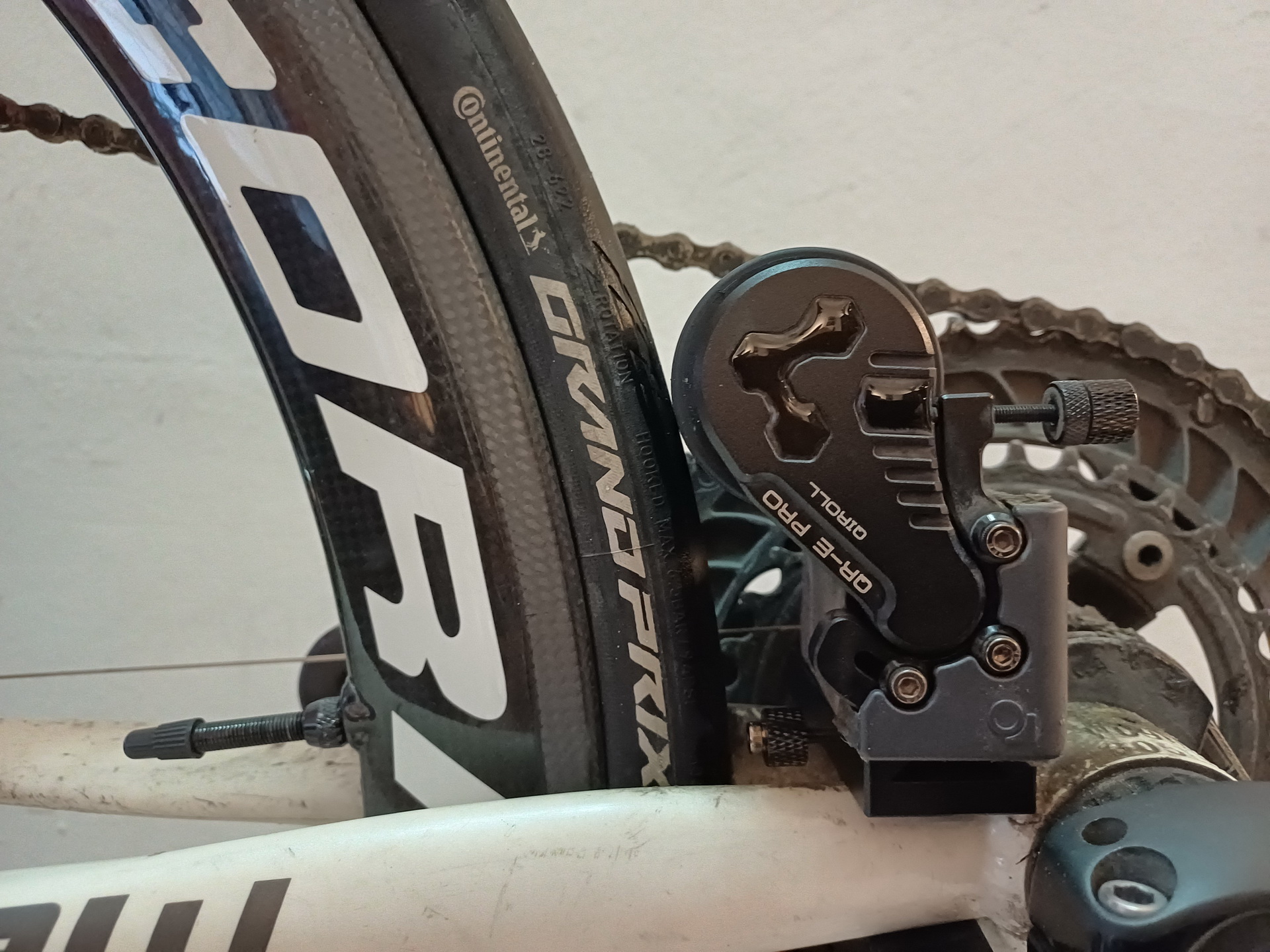

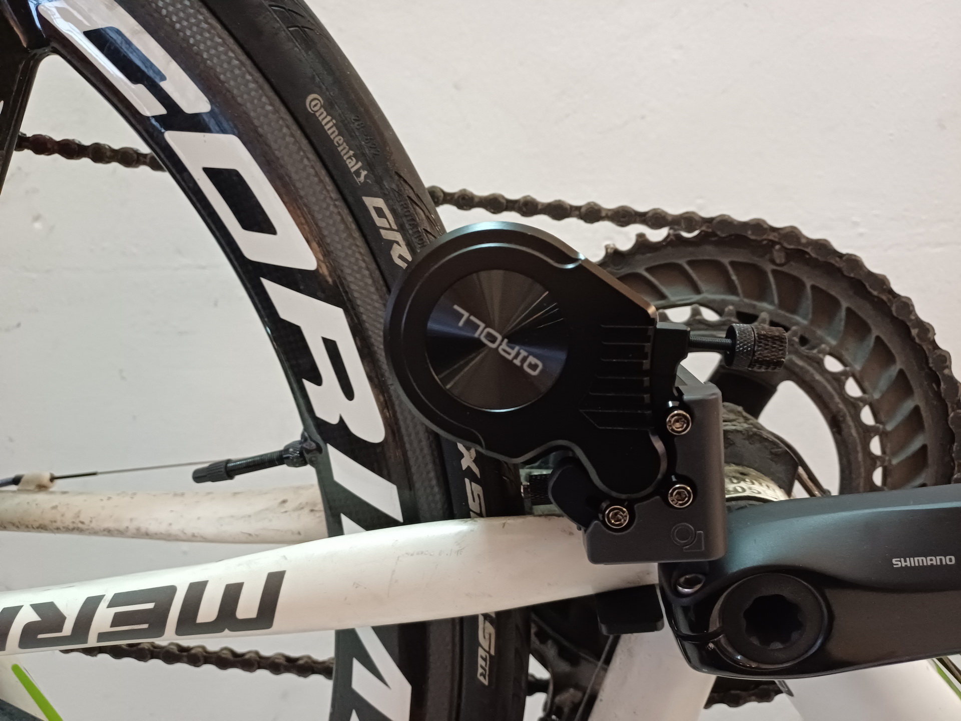

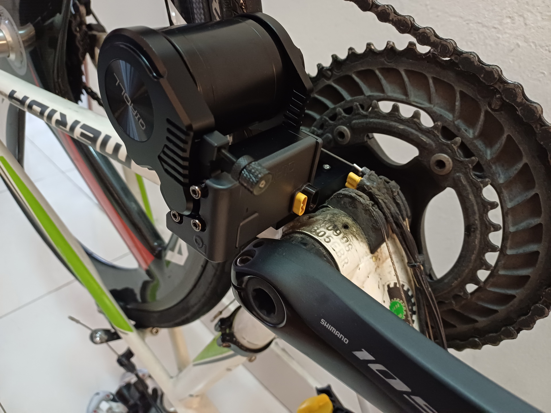

So i did test the 400W+ QIROLL yesterday but i find there some issues.
  1. Too long/protruded to fit on standard bicycle such on road bike, gravel bike or other commuter bike with short chain stay. The clutch already extended to max angle. You can see from the picture attached the unit has very long protruded reach unable to fit on rear chain stay neither able to adjust the clutch angle latch to tire, it doesn't even fit behind rear brake caliper at upper triangle frame. The clutch rotation angle movement already max up not allowing it to clear the tire area unlike other models like PRO, MUTE and others. I tried to use additional provided mounting to get more clearance but it does works because it already hit the bulging part of bottom bracket. I can see this one build for older bicycle frame with longer/larger triangle and 100% more likely able fit folding bike or frames with smaller wheels.
  2. Regen braking not working, i press the circle button on the remote and it won't stop. (I'll post video on twitter soon). You'll have to use brake lever as usual to stop the bike ....else maybe i got a dud since its a test unit.

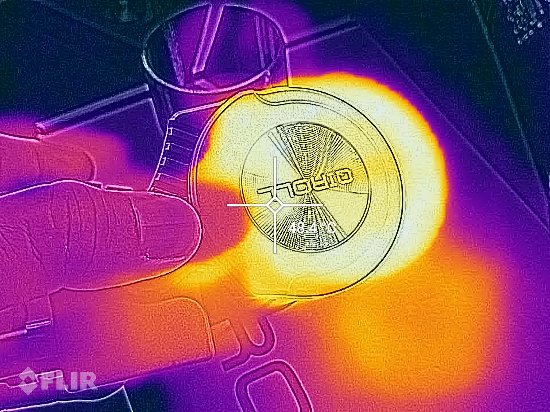

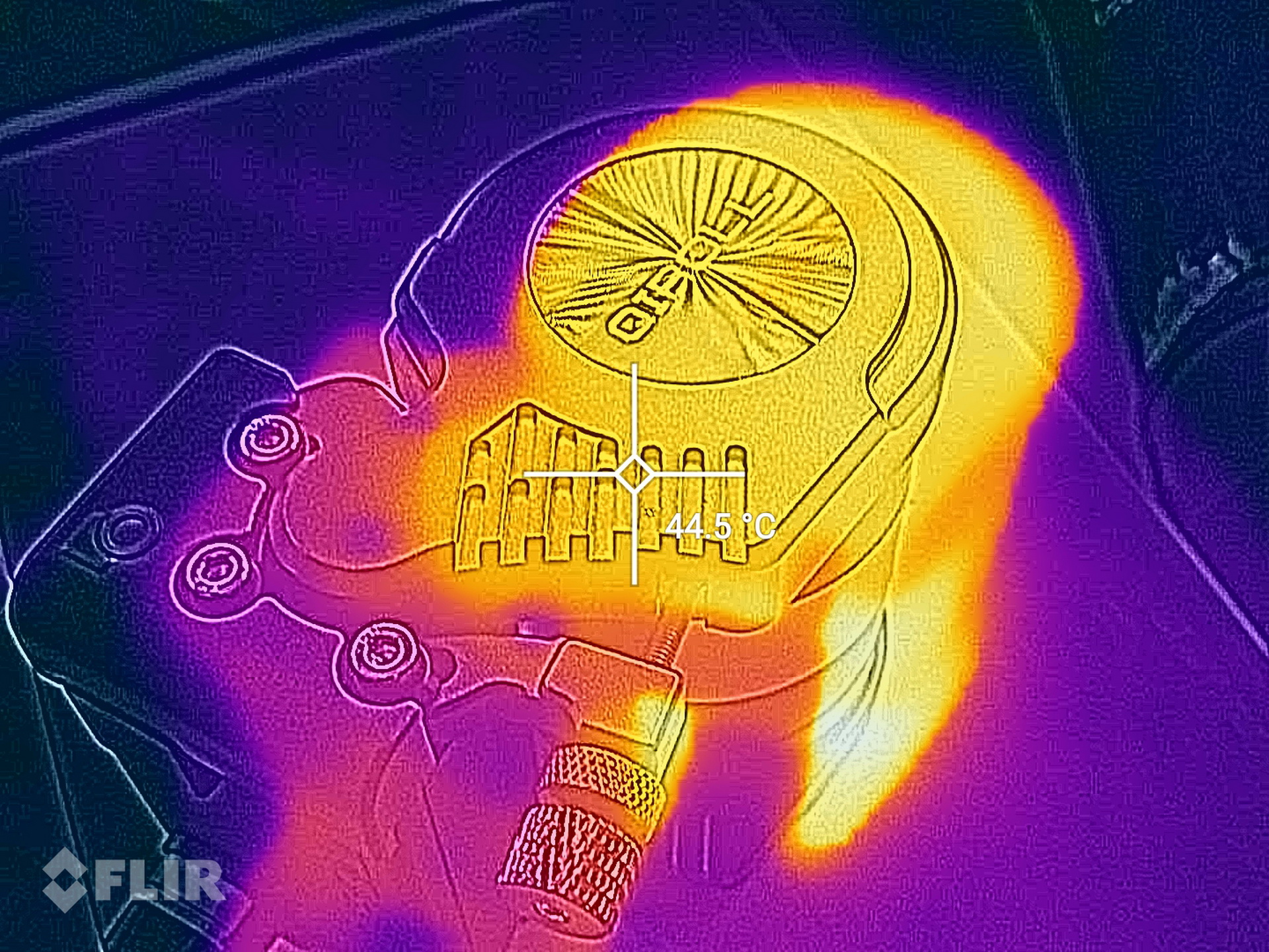

  3. 30 second test run without any load (no tire contact) on my hand it get extremely hot to touch. Was worry how much power it consumed. Took a FLIR temp photo on it.
  4. Stock/default friction tape still got ejected violently when i test throttle run it on my hand. DIY 3M floor tape still the best choice to date.

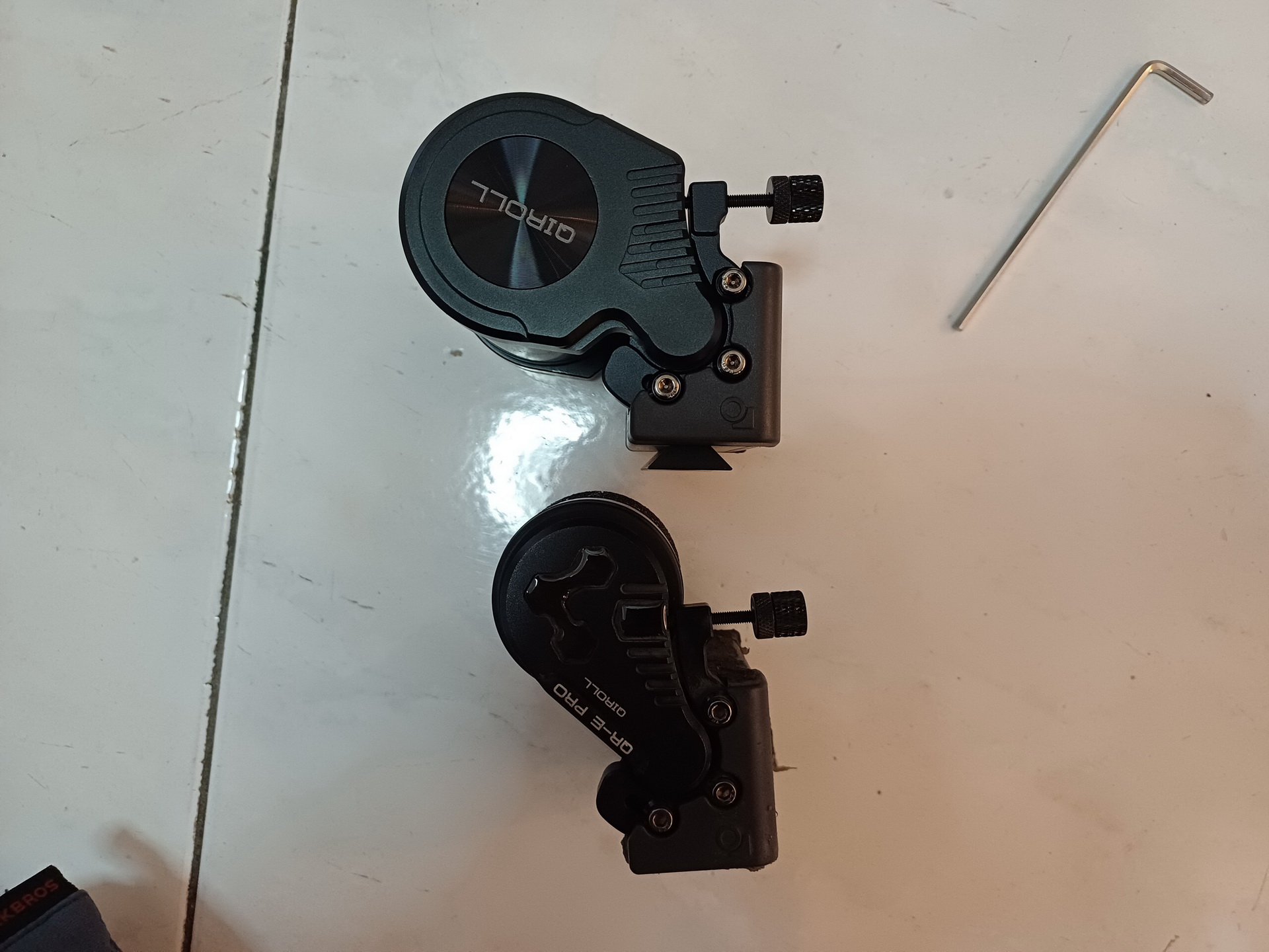

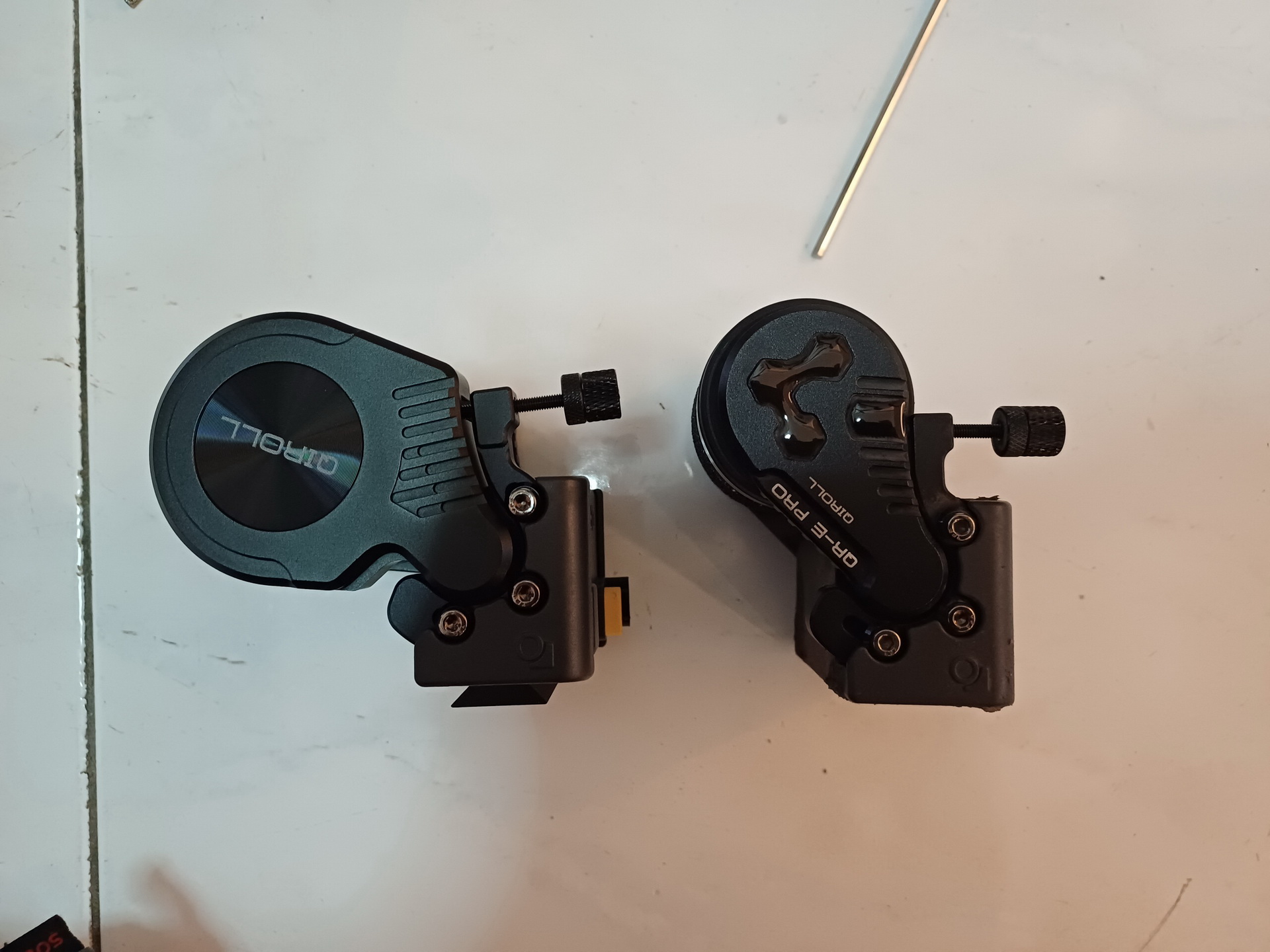

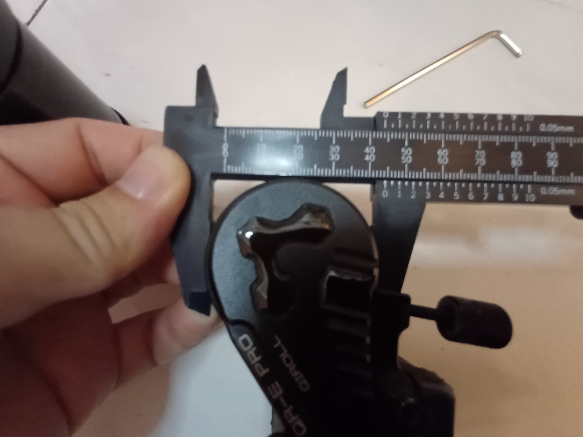

The Problem: The problem of this unit is not the size of the roller which only have minuscule 0.5mm differences in diameter, but its the angle of the clutch not giving enough degree of clutch rotation to clear the space to sit on the tire. I think Qiroll push the clutch angle higher a bit give it more up extra degree of rotation adjustment.
Conclusion: I don't think this unit able to fit on any performance bicycle since modern one have shorter chainstay clearance between rear tires and bottom bracket. However this type of bikes are the one benefits more with 400W+ power if we could get it fit. Hope Qiroll make special adapter mounting for it.
Possible use for it: As for me i think i'll just have to get a folding bike and fit this 400W+ unit just to have fun. But i won't be bike commuting to work on small wheels daily, maybe grocery shopping going up the hill side which helps a lot with having 400W+motor with climbing power. I'll let you guys know once i done shopping for another tiny bike with long chain stay.
The Good news: I love their "Quick Release Rack" they included in the kit. Makes mounting the motor easy since the screw mount to secure the unit is screw from below the frame (when the bike flipped upside down) rather then tooling the allen/hex key between the narrow gap behind frame seat tube, chainstay and tire. Nice!

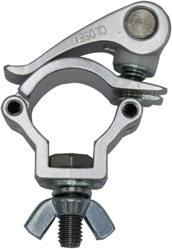

Not sure this would work well for you but I've used truss clamps on other projects (not the Qiroll) and it seems that they might work in your application with a little imagination and fabrication. Here's one that is QR which might be interesting instead of the Strida clamp.
