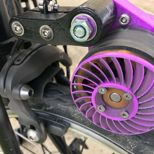

The spring hinge is 3" stainless steel that I got off Amazon. I needed cobalt drill bits to make the Qiroll attachment holes and one for a bolt to the kickstand platform, if you don't have cobalt bits it might be better to source a hinge that isn't stainless. I have used a similar 4" hinge on a different bike where I mounted the Quiroll on seat stays but 4" is to long for this bike and location (would hit chainring or left crank arm). Couldn't use 3.5" self closing hinges because the knuckle/barrel portion length is the same as on a 4" hinge.

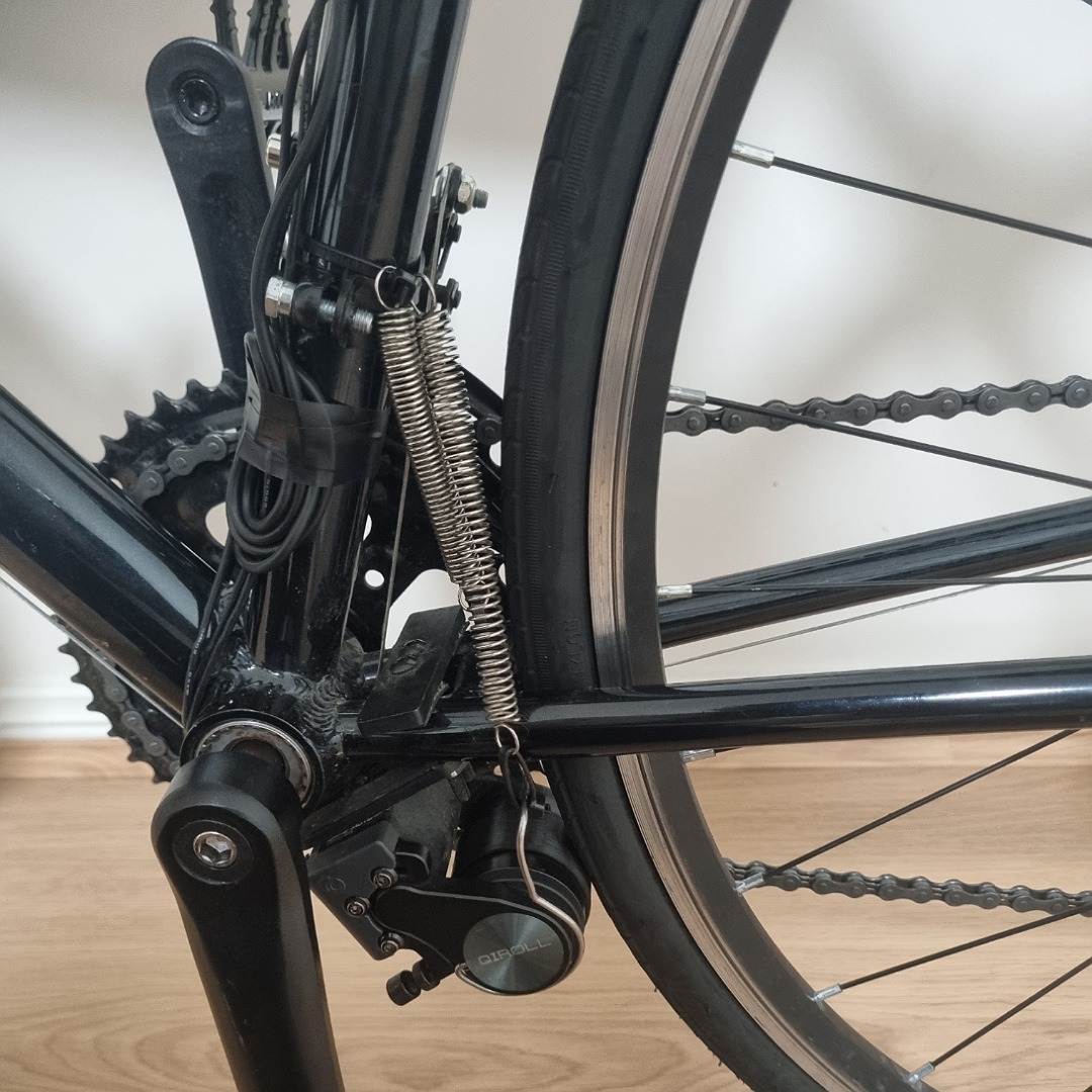

Thanks for the info. It's certainly neater than the zip tie, bent coat hanger and springs from an IKEA desk lamp contraption that I had going on before 😅

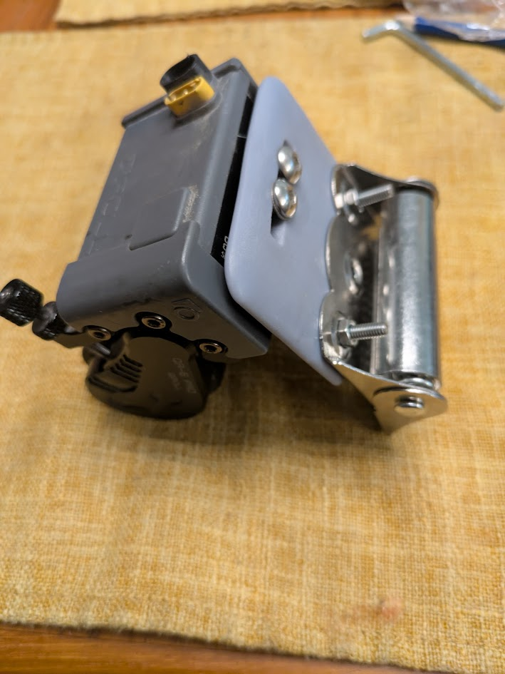

It's only my second go-round with CAD & 3d printing. The first was for a nylon shim which sat between QiRoll's Strida adapter and my tandem's smaller-diameter tube. The shim itself turned out fine, it just wasn't a great mounting arrangement on my bike,

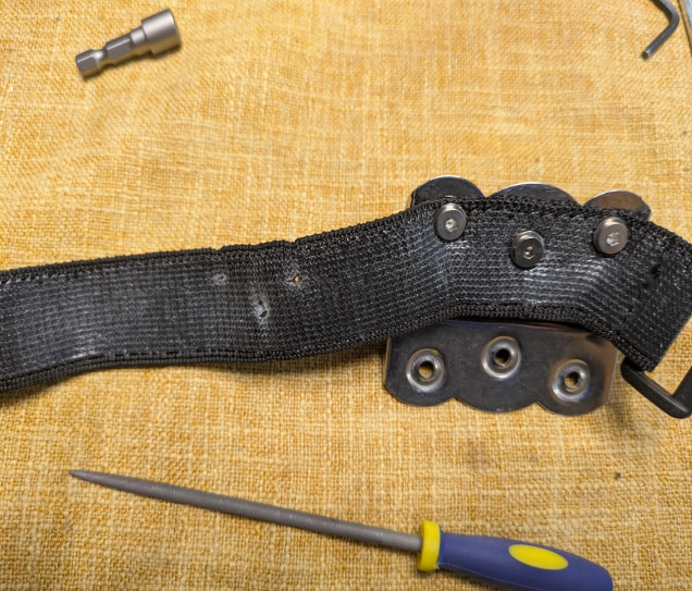

Getting close. 3D printed adapter seems fine, and simply bolting it to a stretchy velcro-based strap seemed like it'd be plenty secure on the bike. But the strap's flexibility gave the assembly too much freedom to easily rotate in multiple planes (viewed from above, viewed from the side of the bike).
I'll have another go with a nylon ratchet strap which should arrive tomorrow. The ones I already had turned out to be much narrower than I recalled.
Predictably this project has me repeating "this is why I'm a software guy."
Bolted hinge/motor assembly to strap
But even this non=flexible nylon strap, tightened as much as I could manage on the bike, twisted a lot with the tension of the spring hinge. Clearly I either needed to use a very rigid strap - like the hose clamp EMGX suggested earlier - or, the light bulb went off, give this hinge assembly enough length so that I could anchor it in two places, front and back. I had some scrap wood nearby, formerly louvers on a closet door. Cut a piece and bolted the hinge to it.
Even my very stretchy velcro-based straps hold this reasonably securely, wrapped around both the front and rear of the assembly. Good enough for a short test ride, though I think a cleaner, more secure solution will involve bolting this to a universal bottle cage mount I have, which I've confirmed will strap firmly where it'd need to go on the bike's frame.
The problem that quickly arose surprised me: my 3D printed hinge-to-motor adapter snapped in half! Apparently the "tough resin" material I selected for this part isn't tough enough.

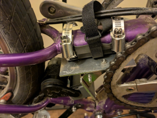

The water bottle cage adapter has slots for 1/2" wide straps, which conveniently seems to be the standard width for hose clamps. I bought a kid which let me cut my own clamps to desired length. It took a few tries to work out to position and orient stuff in this tight space between two cranks and with other neighbors like brake/shifter cables, but once that was solved it was pretty straightforward. As expected, tightening these stainless clamps holds the assembly in place extremely securely. Nothing is moving a millimeter!
The adapter's original velcro-based straps work well for holding the hinge closed, to physically disconnect the motor from the tire, so when I bolted my platform to the adapter I slid one of those straps in between..
I had also drilled a couple more holes in my aluminum platform, to try the standard "clamp to chain stay" method:
but between the cable guides and the irregular welded joint, I couldn't get it to lie flat and securely. Though in theory I now have a more universal hinge/motor assembly - if only I can get it to actually, you know, work! - with both chain stay and bottle cage mounting options, so I could I could move it to my road-ish/randonneur bike.
And trying to get this to work emphasized how shockingly out-of-round this bike's rear wheel is! Had this thing (inadequately) mounted in a position that gave several mm of clearance, only to have the tire rub & get stuck along the platform's edge after half a rotation. Seems like the mounting the motor on a spring/hinge should allow it to follow the contour far better than fixed/rigid mount.

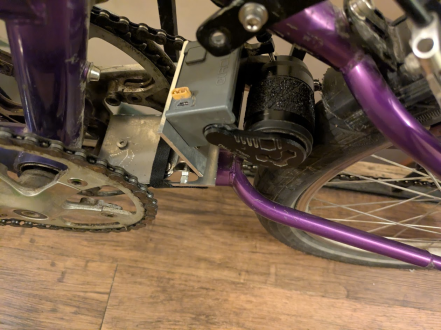

Adding supplementary pull from the rear seemed like far & away the simplest thing to try, so I tried it. First I bolted a short bit of stretchy strap + buckle to the motor assembly:
And when I'd finally added enough pressure for the motor to retain grip in boost mode, it was with a daisy-chained pair of reusable zip ties, hooked through a slot in a steel adapter which holds the rear fender:
I may try to refine this a bit, perhaps replacing the zip ties with a strap and routing between fender & seat stay... but at least I've arrived at something that has worked well for a quick jaunt around the neighborhood. This weekend I'll aim to get out with the kiddo for a longer 15+ mile shakeout ride.
