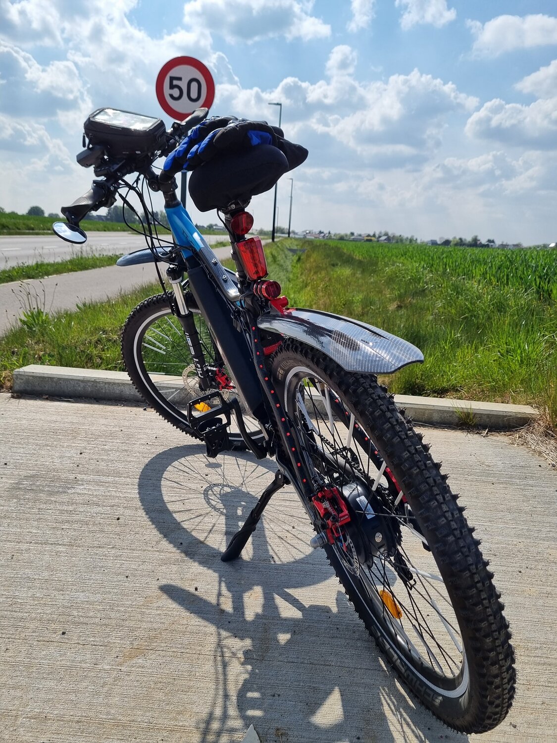

Last week I tested the bike in normal mode until the battery reached 0. I did two routes in total of 99.5 km distance and 5.5 hours till the battery had no more lines, but even so without any battery bar I can do a few more km until the display turns off. So, to be more precise, I think that 40% of the route I climbed hills and the remaining 60% was flat. What I noticed between Normal and Power mode (2 and 3) is that on mode 2 my legs got a little tired and on power mode (3) my legs never got tired because of the full torque and I can climb big hills with 30-35km / h most of the time depending on the slope.

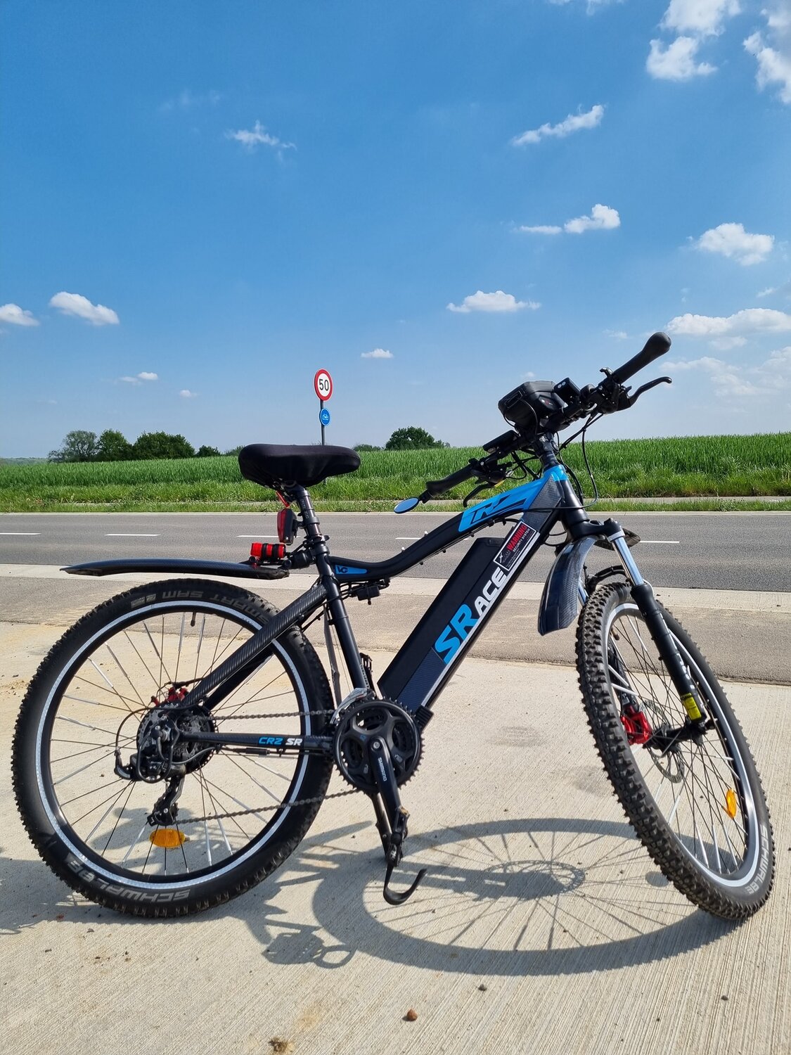

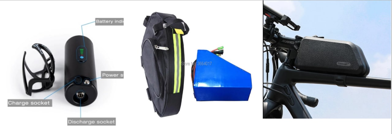

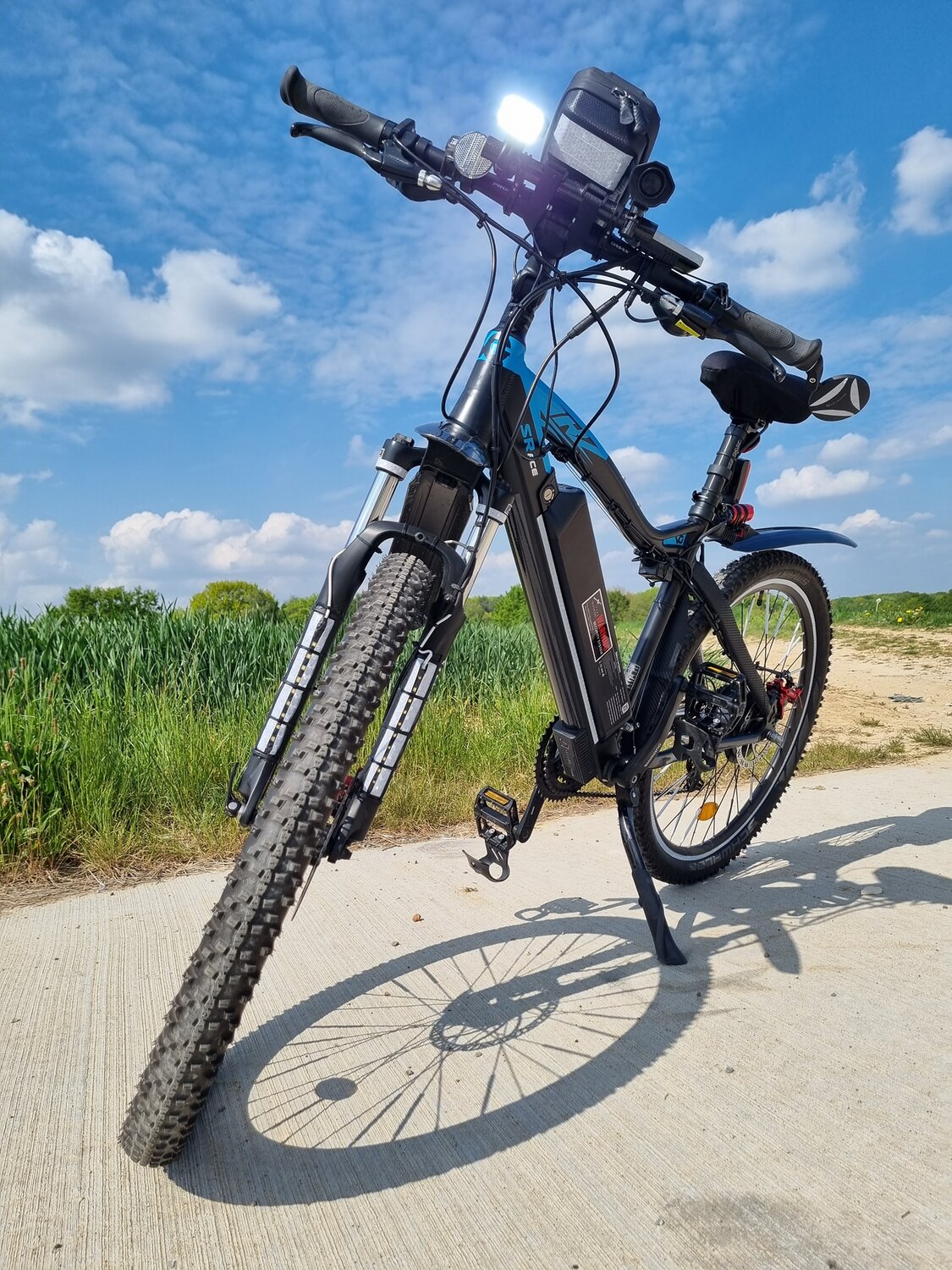

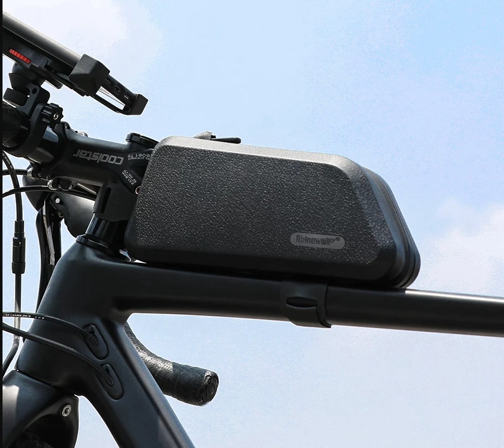

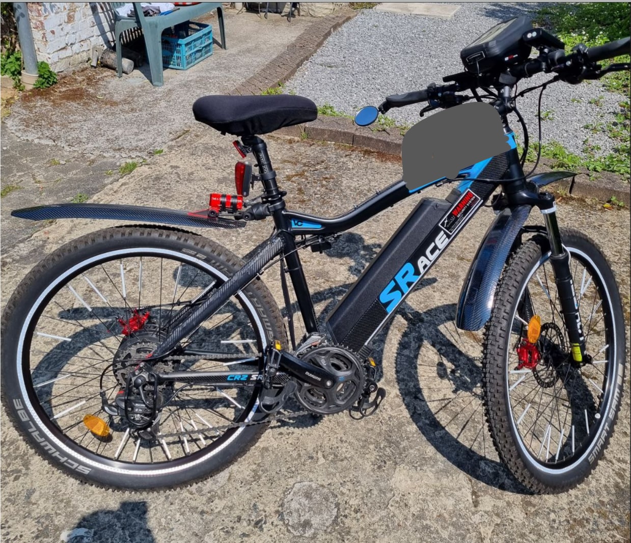

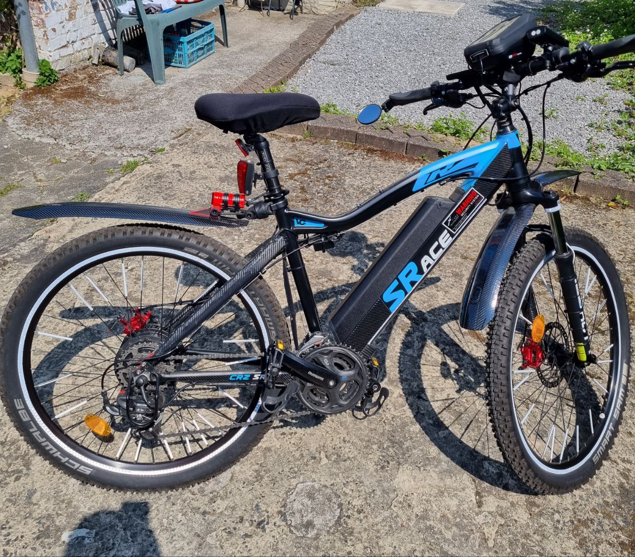

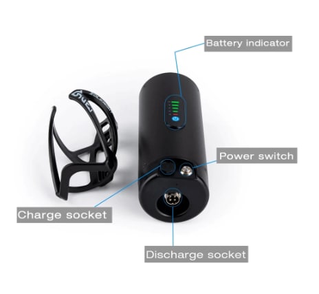

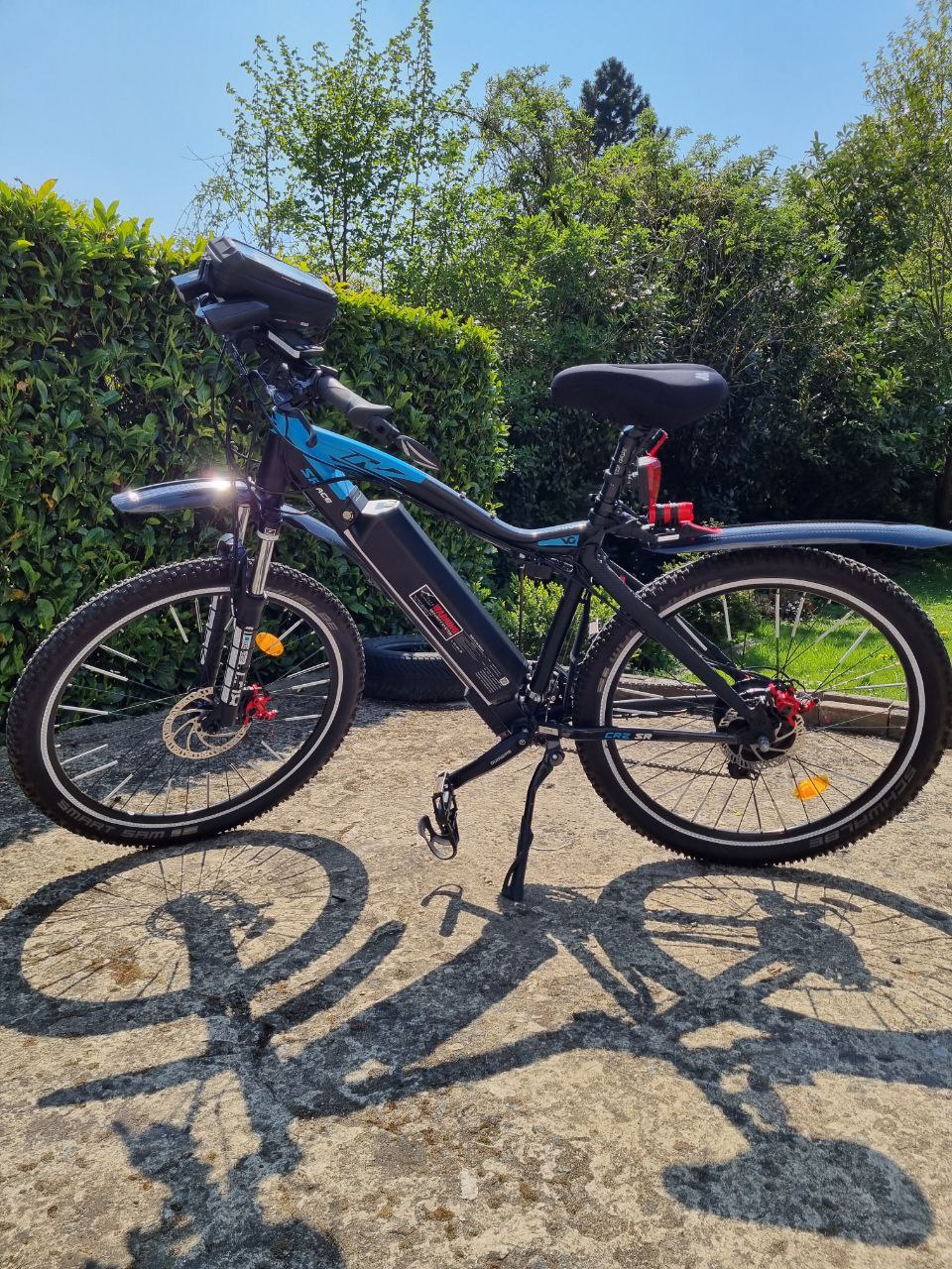

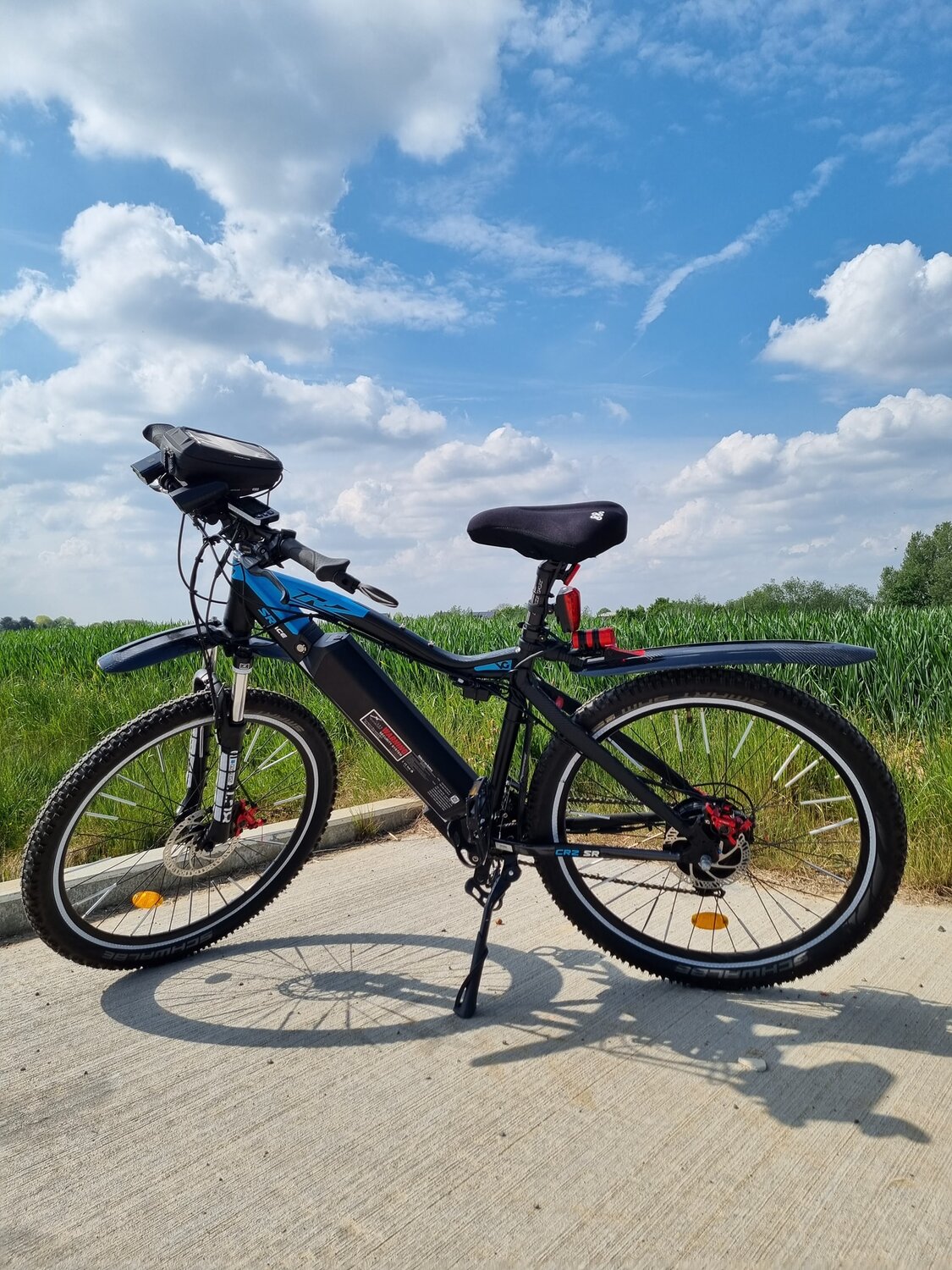

Here are some new pictures of my bike from last week. It remains to be seen where to put the second battery, I have a choice between triangle battery, close to the handlebars or a Bottle eBike Battery.

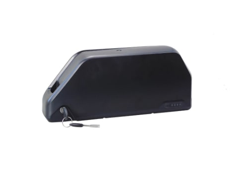

I think this second battery would fit best on the frame, it also looks like a motorcycle tank, and with that module i can connect them in paralel.

Yes i know that but it was only a test to see what it is the maximum range. After a long trip, you may run out of battery power, but that doesn't mean you're destroying your battery. If you don't do this every day nothing bad will happen.

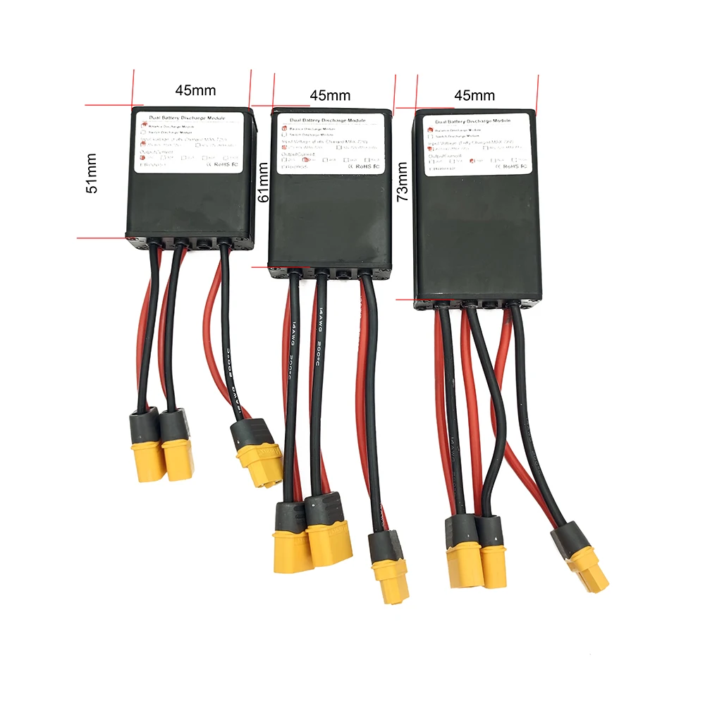

Hi, which dual battery converter module you chose? As I know, there are two kinds of module, one for discharging from A to B battery, and another for discharging from both batteries in the same time. Even for the latter, it is suggested to choose a second battery with on/off switch to still let the battery discharge from main battery to second one. Lithium ion battery is ususally not suggested to be connected in parallel, and two batteries, new/old, or in different voltages or from different manufacturers, will cause problems in parallel connection, especially when the BMS charging & discharing in common port, the higher voltage battery will charge the low battery.

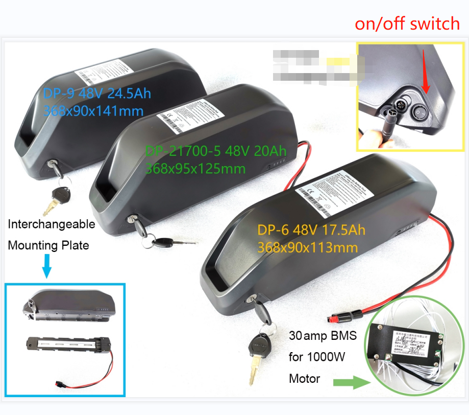

Reention Polly or Shanshan Hailong series are most polular down tube type for second battery. Below are all Polly battery options with 21700 available.
DP-5/5C, 368x90x96mm, 48V 14Ah max for DP-5
DP-6/6C, 368x90x113mm, 48V 17.5Ah max for DP-6
DP-9/9C, 368x90x141mm, 48V 24.5Ah max for DP-9
DP-2170-4/4C, 368x95x106mm, 48V 15Ah max for DP-2170-4
DP-2170-5/5C, 368x95x125mm, 48V 20Ah max for DP-2170-5
The C version means there is controller box on base plate, which takes up some space of battery body causing smaller capacity.

Hi, may I know your ebike model? It looks same as NCM Moscow. I will invite @Bitmugger to share the testing result, who owns a NCM Moscow and he will test the Dorado 52V 20Ah after the lockdown lifted here.
Thank you!! The bike it's another brand but 100% like NCM Moscow, the same frame and kit. Das-kit CT5-i5 controller, L6 Display, X15R(MXUS Rebranded) motor, 48V battery.

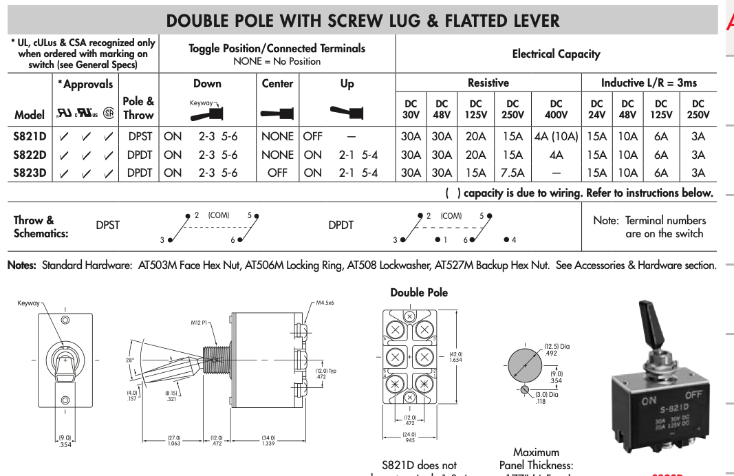

I was going to buy a secondary battery with the same voltage to connect both in parallel. So it's much better to choose a second battery with on / off switch to let the battery discharge from main battery to second one, than to have discharging from both batteries at the same time?
Yes, that is suggested by our engineers unless you can make sure the two batteries are totally same and new, and to charge both batteres to same voltage to use everytime. And pls also check with the converter module manufacturer to see what is best way to use.
I can buy 2 switch like this for both battery or i also need to buy a converter?
