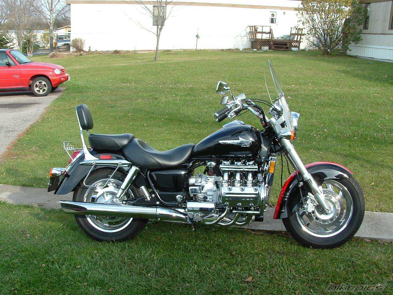

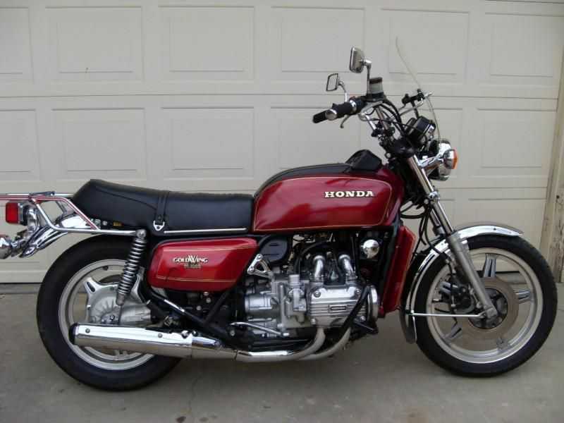

Oh geez, don't go Valkyrie. Compared to an "Old Wing" that Valky is a top heavy freight train.
"Um, wut?!"
Not to derail the topic any further here, but I believe the naked Valkyrie has a lower center of gravity (& slacker fork angle) than the Goldwing...
Only good reason it might feel top-heavy, is a lower saddle height, with the feet farther forward; meaning less control.
Extend the seat up & back (where I need it) & it shouldn't feel "top heavy" at all!
I've spent just a little time on a '75 GL1000 & an '02 Valk... While the naked wing was a simple beauty, the Valkyrie kinda blows it away, in more ways than one. If I ever find one without an engine... ⚡⚡⚡⚡⚡⚡🔋🔋
"Um, wut?!"
You have a PM, in consideration of the fact we're so far off topic here.
BTW, I thought the '75's had spoked wheels? -Al
