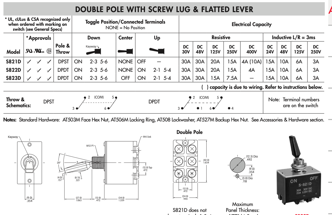

I'd not be happy using a $4 switch. The specifications are worrisome.
Type: (ON)/OFF/(ON) ;Connector Type: DPDT ;Power: 15A 250VAC / 20A 125VAC

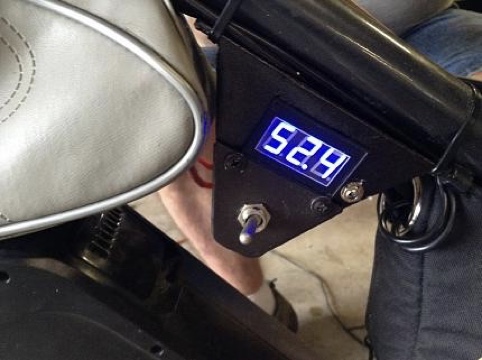

It's so much easier to just use a switch. DPDT
We used an inexpensive voltmeter. The switch has three positions.
Frame battery - OFF - Rack battery
UPDATED SWITCH VERSION
Be certain the switch you use is up to the task. Confirm the switch specifications. The switch I posted has been used on a dozen bikes but not tested with any pack over 48V(54.6V) and 30A.

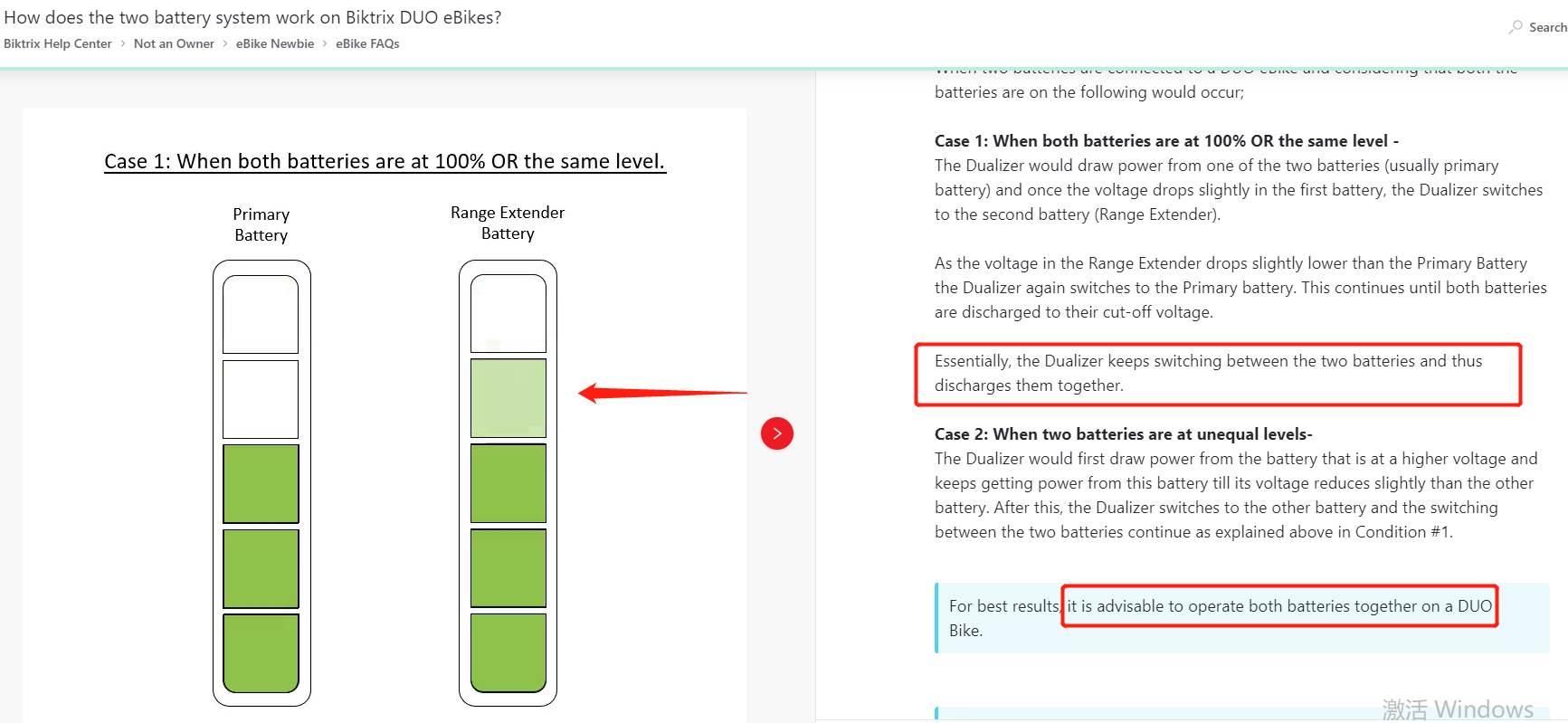

This is how dual battery converter works explained by Biktrix. But I haven't figured it out clear myself. 😅 It sounds like the converter smartly keeps switching between the two batteries, makes the two batteries dynamically in same level voltage till the cut off voltage. If so, there is always only one battery discharging at any time. But Biktrix explains it is two batteries discharge together and they advise to operate two batteries at the same time. Quite confused.
But if the primary battery is firstly used till ends, and then turn on the secondary battery, to avoid the converter keeps switching. Is this better? Any ideas.

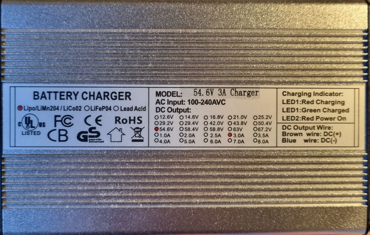

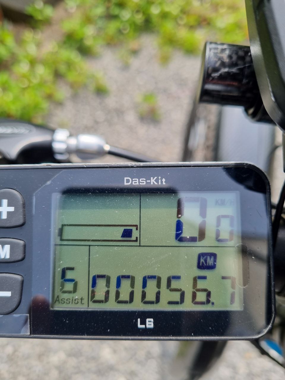

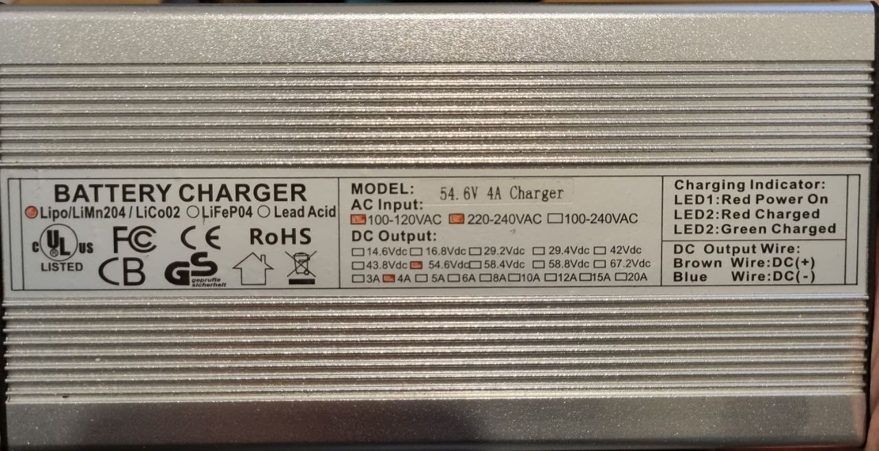

Does anyone know why if you charge the battery with a higher amperage charger it discharges faster? I have two chargers, the stock 3A with which the battery came, and I bought another 4A. If I charge the 48v 21Ah (1008Wh) battery with the 3A charger I can cover 100km, and if I do it with the 4A one the autonomy is smaller. I took some pictures today, after 56.7km I had only one bar left, but with that remaining bar I could have covered another 15-20km. Let's say a total of 75km traveled by charging the battery with the 4A charger. So there is a difference of 25km. There are already electric bikes that have 4A or higher chargers in stock, even 10Amps fast charging, and I don't understand why with my 4A charger I lose over 20km that I could have covered. Charging time with 4A charger is somewhere around 5.5hours. Maybe someone will enlighten me.
Could it be that charging at a higher amperage causes the cells to NOT balance properly? Kind of like when you fill a bucket of water with the hose full open, water will splash out. Topping it off will be harder. As opposed to, filling the bucket slowly so the water doesn’t spill over.
I don't know,it's just an amp difference between them. There are other bikes that come from the factory with 4amp chargers, and scooters that have 10A chargers.
Some chargers cut off earlier , charge with 4amp then plug 3amp in and see if it charges more ,, you could always check with a multimeter from both chargers
Thanks for your advice!! I'll do that next time.👍
