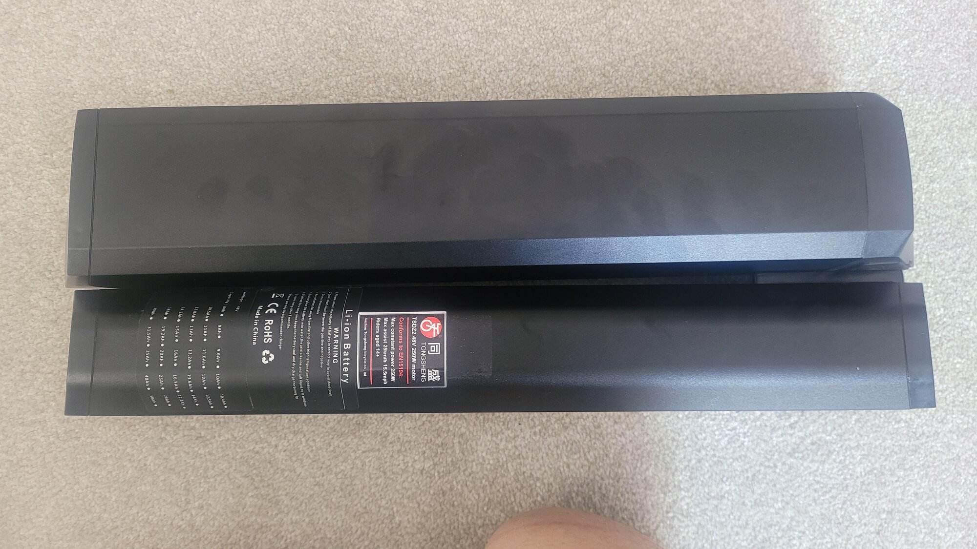

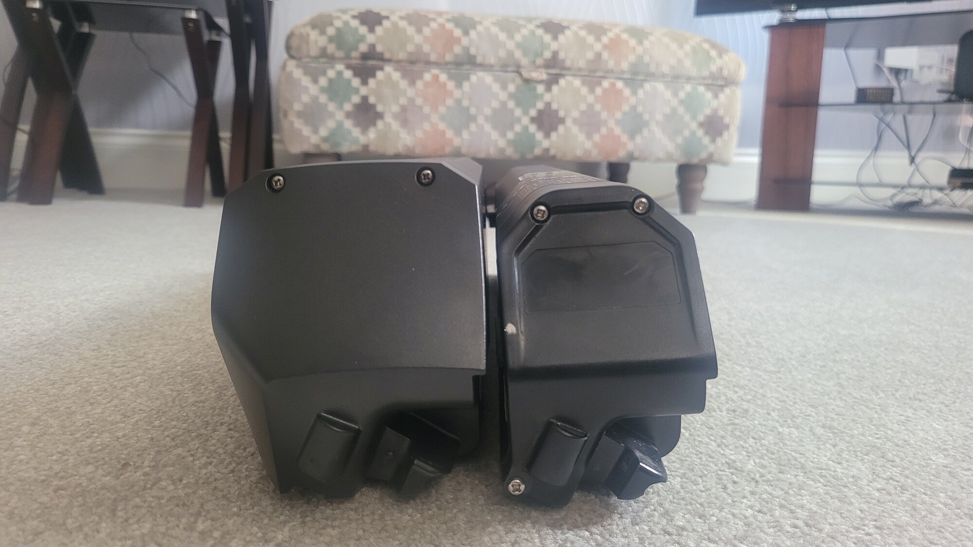

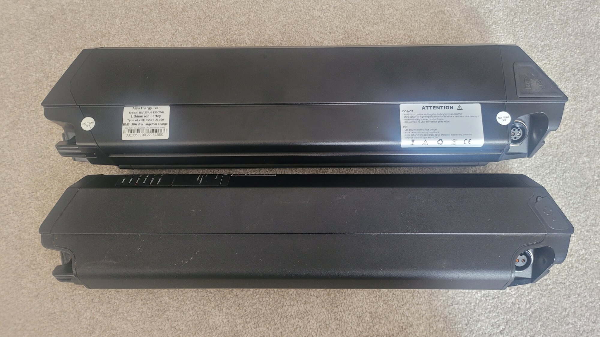

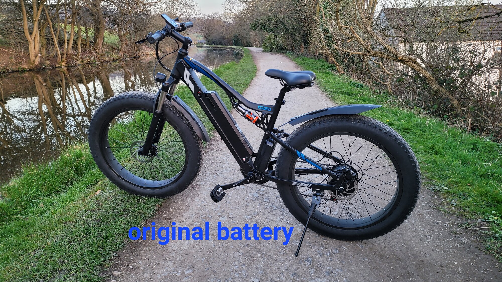

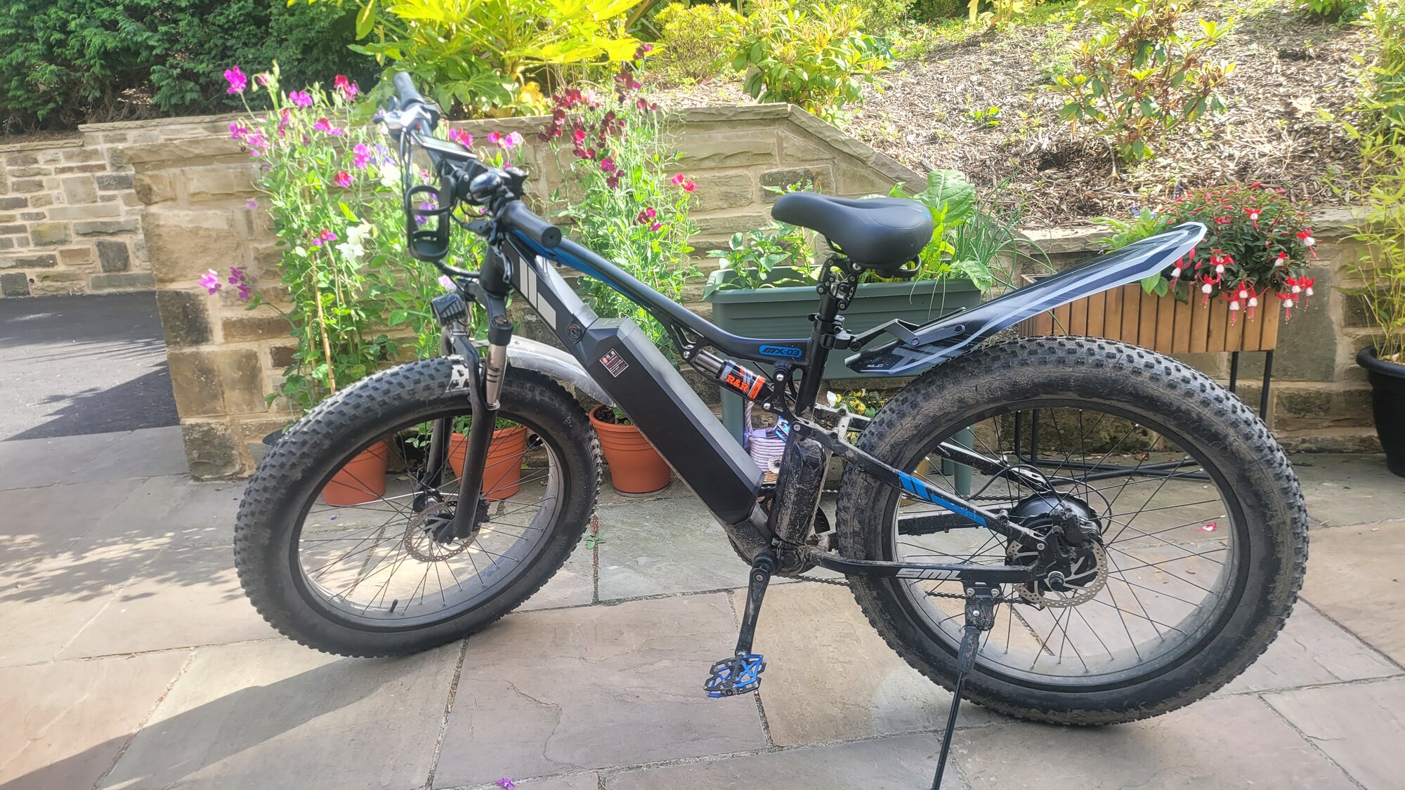

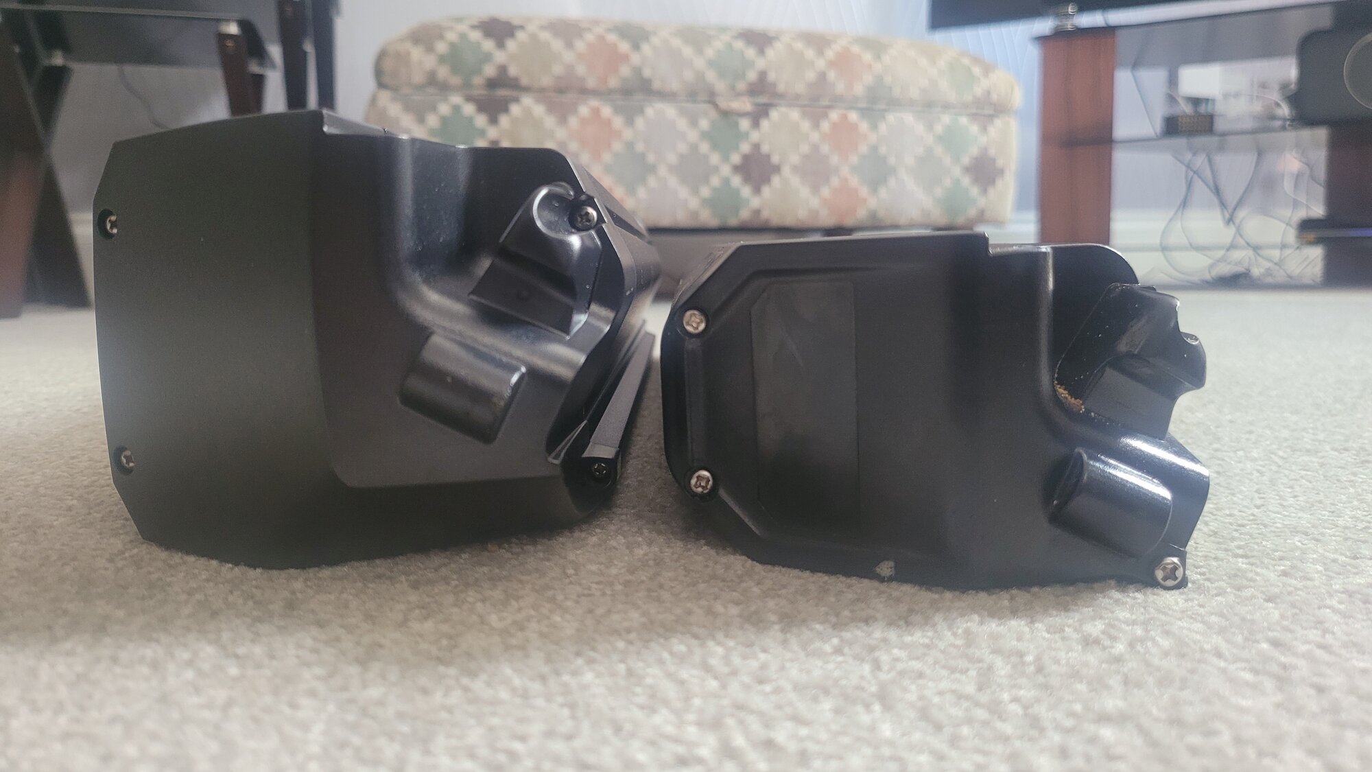

Had a quick ride out today mostly steep hills, covered 21 miles and voltage went from 54v to 51.5 using power assist 2-5 (hills was steep) , battery still showing full, the power delivery is smooth with no battery sag at all , I was smiling away going up the hills using the right gears as appropriate and using good maintained speed up the steep hills I'll finish the battery tomorrow it will be mainly flat riding, I want to see if there's much battery sag near the end of battery and then give it a good charge , the battery is a little bit bulkier than original but not too much(see pic)
So far I'm happy with the performance but much more testing needed.
The battery fits well and plenty of clearance if any shengmilo mx03 owners wondered, any questions or requests welcome ,
One thing I noticed when riding up steep hills before I got this battery was it could do with a little bit more torque but with this battery there's no voltage drop/sag and handle them well obviously with a bit of effort that's how I like to use my gears, I'll keep this thread updated

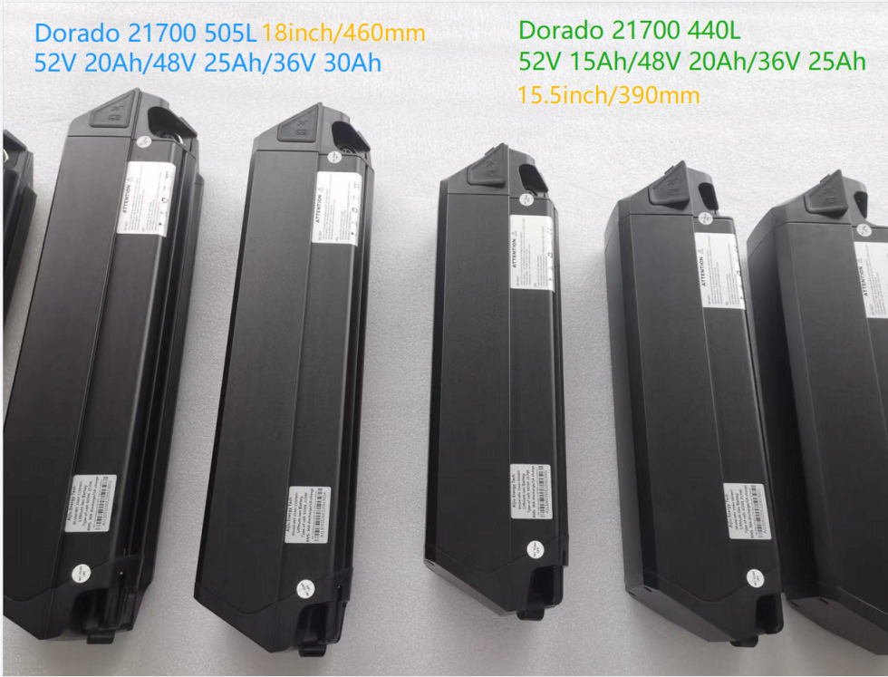

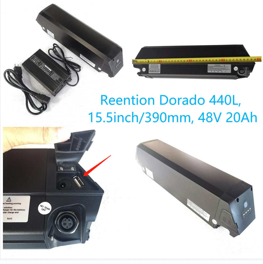

Hi, it is short Dorado 440L, battery length about 15.5inch/390mm, that is used on Surface 604 2022 Werk, Shred,Rook, Colt,and Boar. Surface604 provides the Reention Dorado plus 440L 48V 14Ah and their own proprietary design of 48V 20Ah. We have the Reention Dorado 21700 440L case for same 48V 20Ah, (charging port position is different) built with Samsung 50E 21700 cells, with 30A BMS, compatible with 250W-1000W motor.
Here are some Dorado 21700 440L 48V 20Ah ready in stock for shipment. Pls contact me via email or Alibaba for more details.Thank you!
