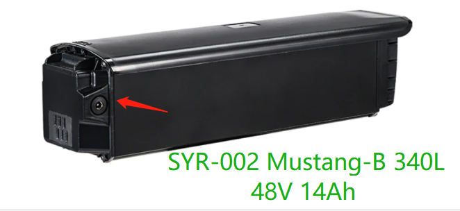

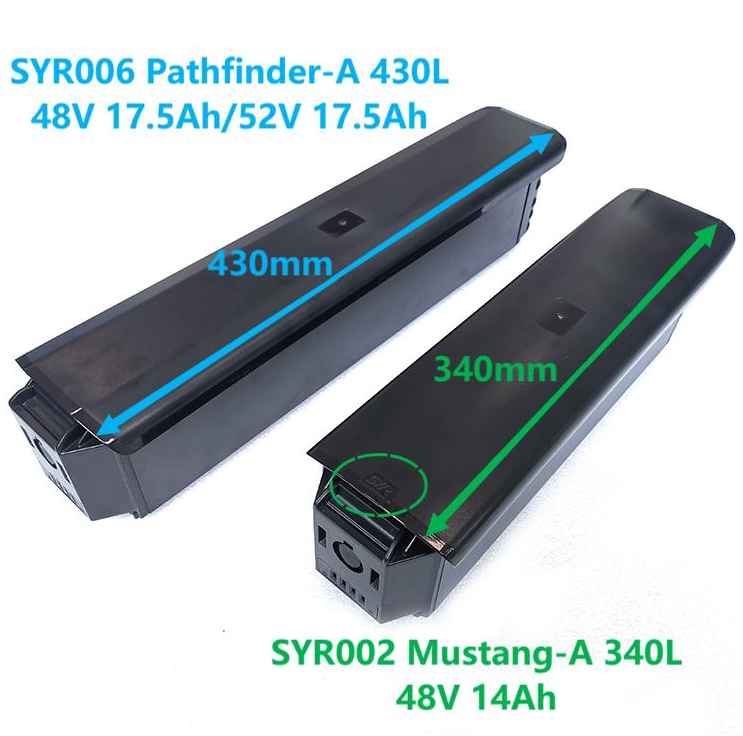

Hi Mohammed, it is SYR intergrated battery, called SYR002 Mustang-A, 340L, the plasitc cover length is about 340mm.Hi @Jenny Mao what battery do I need to the Aventon Level? Thank you!
Thanks Jenny!Hi Mohammed, it is SYR intergrated battery, called SYR002 Mustang-A, 340L, the plasitc cover length is about 340mm.
48V 14Ah is already the max option.

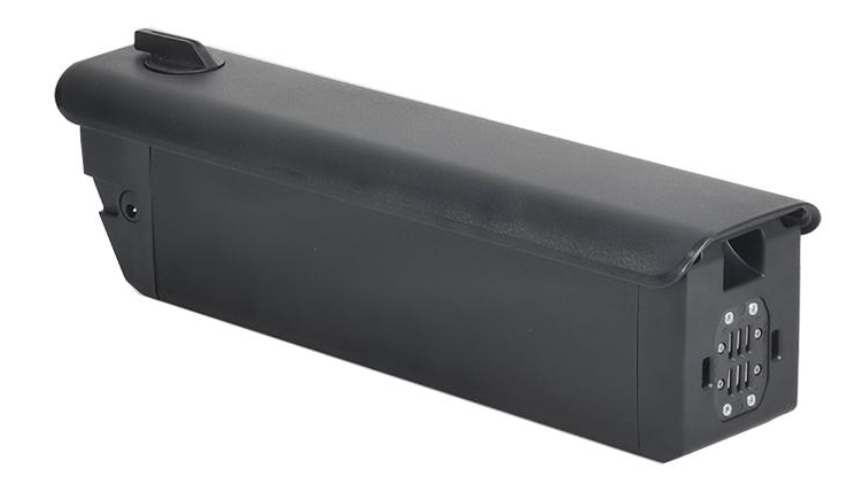

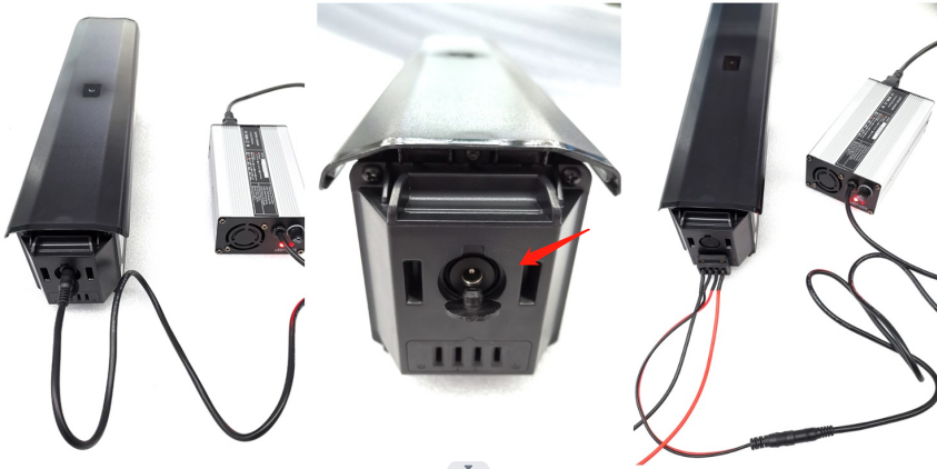

A type means the case has the bottom charging port, and it is also available for charging via the frame charging port, connected via the middle two pins among 4pin discharging port. (Sounds a bit complicated, pls refer the pics below.)
There is also similar B type, which has a side charging port. (e.g. Haoqi ebike uses all B types.)

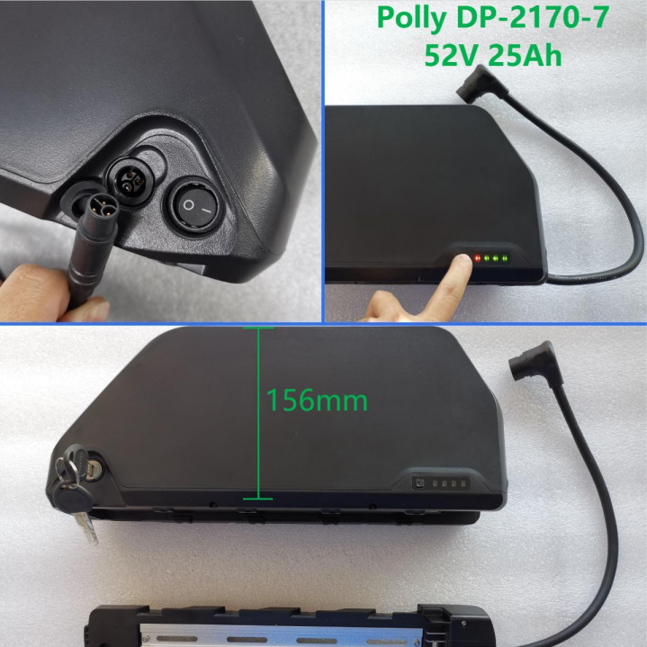

How much?Reention Polly DP-2170-7 52V 25Ah 1300Wh for 1000W Ebike Conversion or 2nd Battery
1) Battery Size 368x95x156mm
2) 14S5P Samsung 50E 21700 Cells Pack
3) 5Pin Discharging Port (Non-C/controller box version)
4) Reention 3Pin or ST-3Pin Charging Port
5) 30Amp BMS for max 1000W motor
6) Base Plate with 30cm XT60 female, Anderson, or customized
[email protected]
[email protected]
Best to email Jenny for an accurate shipped price to your location.How much?

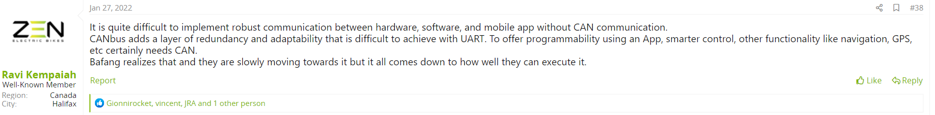

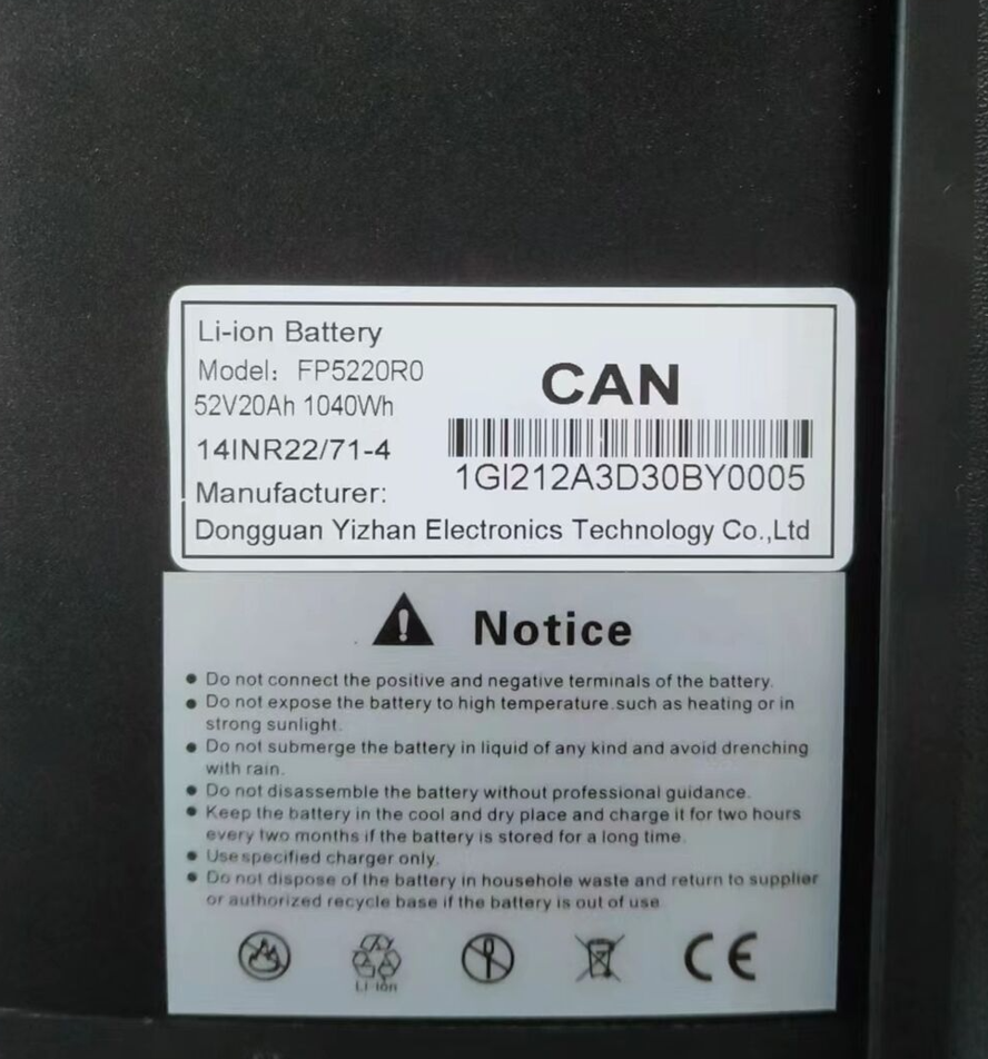

For anyone who doesn't know what CAN and UART mean (I didn't!), I used my friend Google to find the following:Hello Jenny. What does CAN battery mean? Will this battery work with Bafang UART motors or this battery will work only with Bafang CAN BUS motors?
Here is Reention Rhino IR-2170 battery with CAN protocol.
www.solomotorcontrollers.com
No, just no. IF the canbus controller uses the protocol, AND has a third communication wire a two wire typical UART battery will NOT function. And likewise the Canbus battery with a com wire will likely have a BMS preventing proper function with the typical two wire power lead system.For anyone who doesn't know what CAN and UART mean (I didn't!), I used my friend Google to find the following:
CAN Bus Explained - A Simple Intro [2026]
What is CAN bus? How to log CAN bus data? Where does J1939, OBD2, CANopen fit in? See our CAN protocol intro tutorial for the Controller Area Network basics!www.csselectronics.com
What Is UART?
Communication and data transfer is an inevitable part of every electronic device. There are many protocols which organize data transmission.www.solomotorcontrollers.com
IMHO, I don't think the battery cares what type of motor it is feeding the 52V to. It shoud work with either as long as the controller is rated for 52V.
However, I'll let Jenny respond.
We already exchanged emails, thank you!How much?
Hello, I agree with @Fred and @tomjasz points, the 52V CAN battery shall power a non-smart (non UART,RA232/485, CAN) motor/controller system. But for the CAN motor/controller system, it must need a matched CAN battery, or some controller functions won't work.Hello Jenny. What does CAN battery mean? Will this battery work with Bafang UART motors or this battery will work only with Bafang CAN BUS motors?
electricbikereview.com
In the case of m620 motor+controllers, you'll surely want the UART version, if you are starting from scratch.The ebike is Dengfu e55 frame (designed to fit Reention Rhino IR-2170 battery case) paired with Bafang m620 52v motor. The motor can be UART protocol or CANBUS protocol so I need to figure out which motor version to pick for this battery. I do not have the battery on hands yet.
Thank you for the information.
