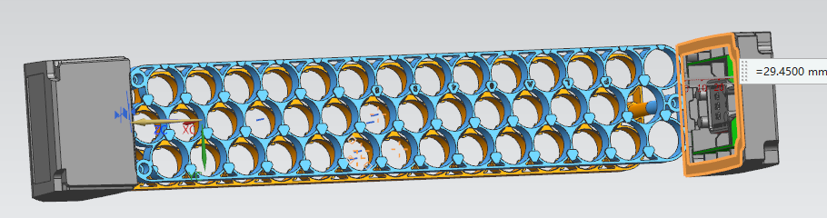

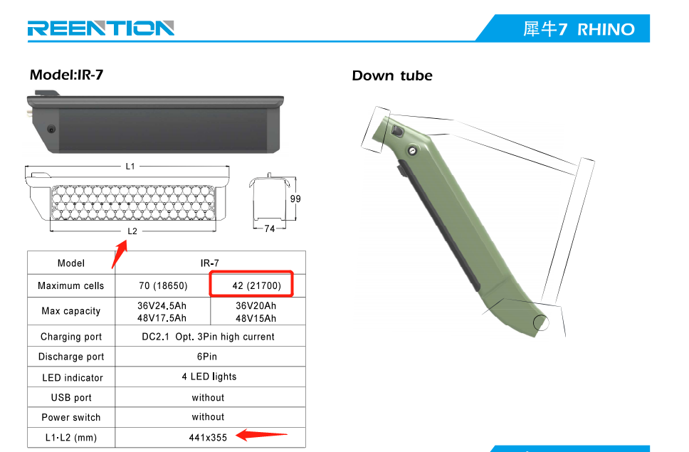

I'm super stoked to see new 21700 cells being used now. I'm hoping there might be plans to use these cells in the Reention Rhino battery for the Ride1Up 700 series. Here is a link to the battery https://ride1up.com/product/700-series-battery-48v14ah-reention-rhino/
I believe this battery is also used in other bike companies, such as Dost and Rize. This battery measures L2 355mm x W 74mm x D 92mm and is currently using Samsung 35e 18650 cells in a 13S4P formation.
I'm curious to know what the nominal capacity and discharge current would be rated at with then new 21700 cells.
Hello
L2 355mm x W 74mm x D 92mm is Reention IR-7, and it is already available for 42pcs 21700 verison.
13S3P Samsung 50E 21700 48V 15AH 720Wh
14S3P Samsung 50E 21700 52V 15AH 780Wh
Both come with 30A BMS for max 1000W motor.

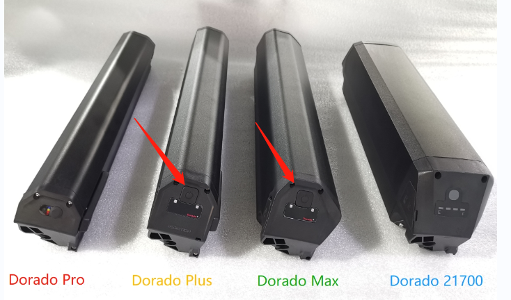

Hello, i have a question regarding the 25ah dorado battery (as well as some newer versions of the other sizes). When you press the button on the top, the charge indicators only stay on while you hold them, does this mean that the output of the battery is always on?
Yes, eactly. The button on the Reention original indicator board is only used for showing the battery capacity when your press and hold it. As I know, some ebike manufacturers replaced the indicator board in order to add the function of powering on/off the battery on the button, mostly on Dorado plus or Max (Both button is easy to press.)We haven't offer such kind indicator option.
It shall be more conveinent to use such 25Ah battery as long as there is on/off switch for controller.

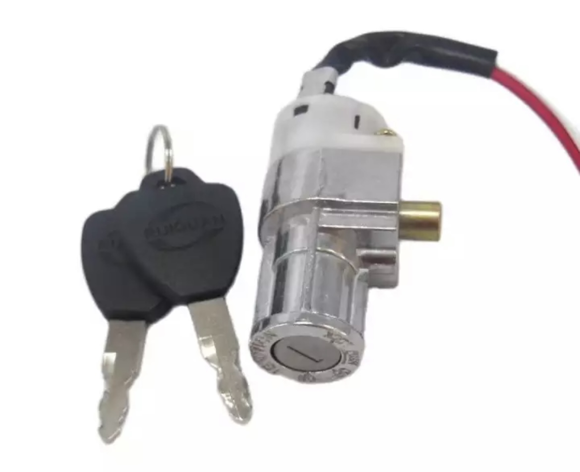

It is a magnum peak with a reention dorado plus battery, it has the power button on the battery but I’d like to also be able to use the lock and key on the top battery mount to turn power to the bike on and off for security
To clarify, i mean something like the pictured item, except compatible with the reention dorado battery system
I see, this kind of lock system is a combination of mechanic lock and battery power lock, which is only used for like Silverfish battery. The Dorado lock is mechanic lock system. The lock is installed on the top mounting brackets, seperated from the battery body, not available for powering battery use.
Alright, thank you for the clarification! I’m not sure whether you have any say in this at all, but I’m sure it would be beneficial to all involved to make something of that sort, since i suspect the reason that some manufacturers modify the control board to include the power function is at least in part because there is no key power switch available for these batteries.
