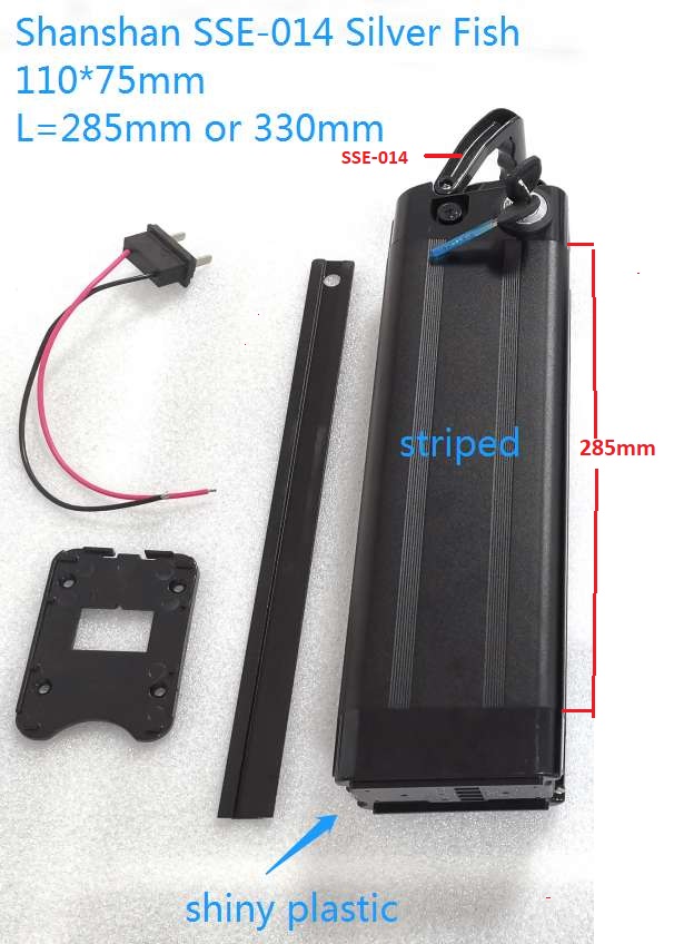

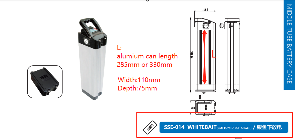

There are more than 10types silver fish from Shanshan battery case designer, different in size and shape,
their SSE-014 is mostly used, with regular 285mm or 330mm long of middle aluminum can, designed for max 48V 17.5AH or 48V 21AH.
Pls check if there is SSE-014 carved logo the handle, and pls confirm the case size.

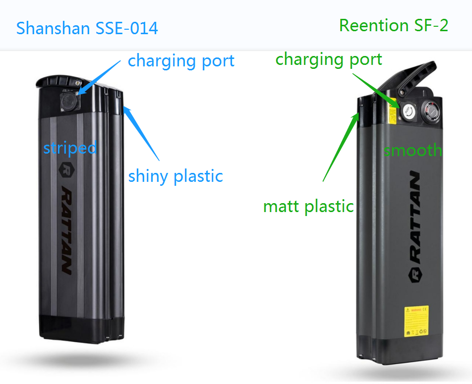

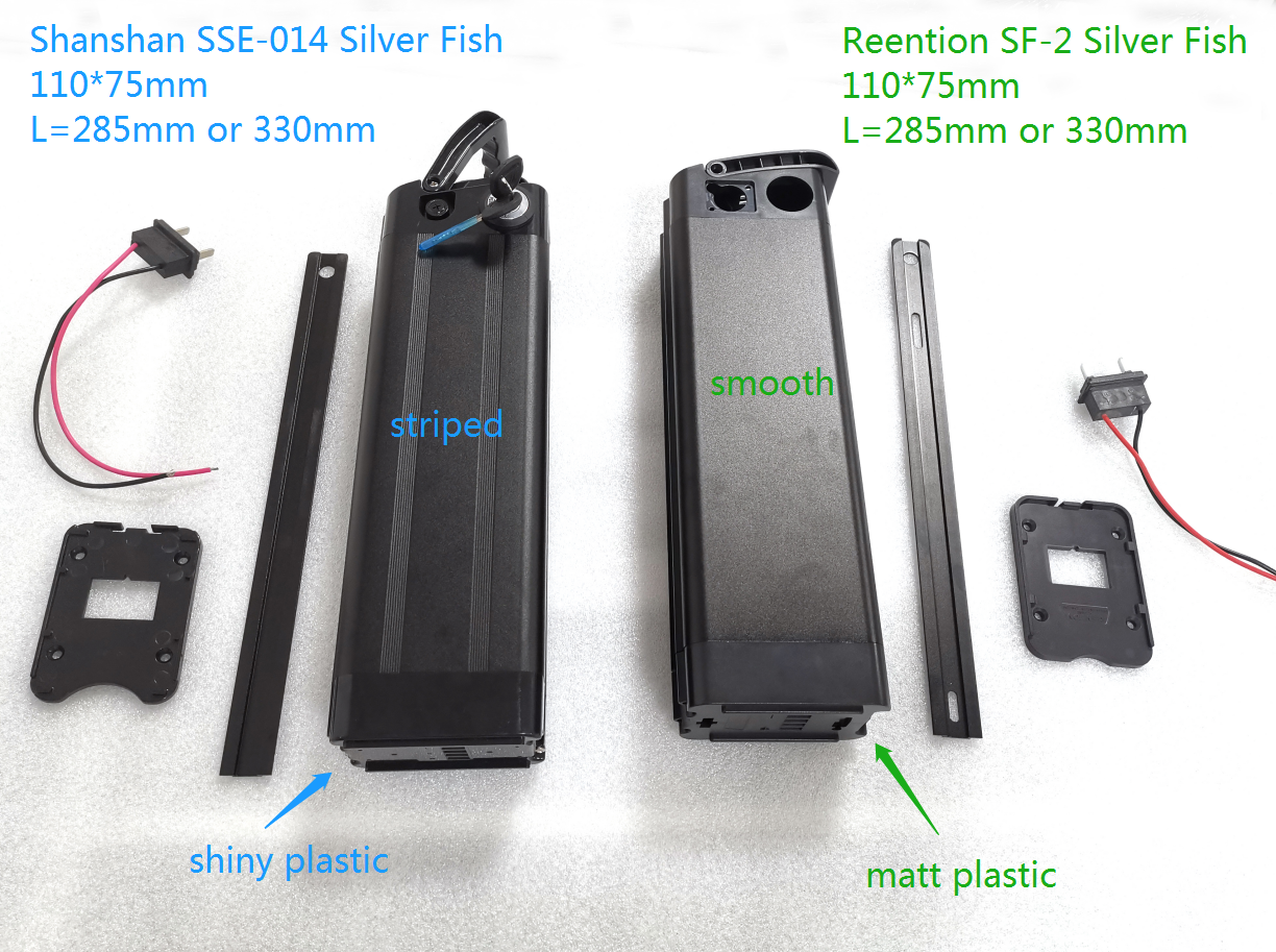

I think arcom was asking for Reention Silver Fish.
That one looks similar, but will they fit?
Reention SF-2 Silver Fish size is same as Shanshan SSE-014 Whitebait or called Silver Fish, both are interchangeable.
Reention SF aluminum can surface is smooth and with matt plasic top and bottom part, while Shanshan has striped aluminium can and shiny plastic top cap and bottom part.
Their charging port and fuse postion are different too.
But the discharing port and slider are all same,which makes both interchangable.

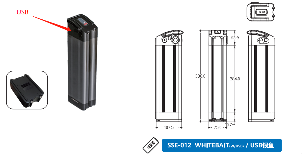

Hello Jenny

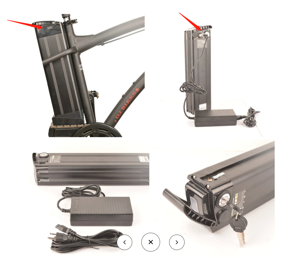

My ebike is from DJ-eBikes and is their Mountain Bike model. The stock battery is a 14ah, 48v. The handle of my battery is imprinted with SSE-014 on both sides. The length, not including the shiny top and bottom pieces is 285mm. It has a USB port on the opposite side from the key switch and charging port.
Thanks very much!
Thanks @arcom
It is SSE-012 silver fish with a USB port, so I guess they use SSE-014 handles on your case. 😁
Both SSE-012 and SSE-014 in 285L are max for 48V 17.5Ah, and upgrade 330L available for 48V 21Ah.
Some other DJ folding ebike owner just ordered the SSE-014 330L 48V 21Ah by Samsung 35E cells.
Could you pls send me an email, will quote you there. Thanks!

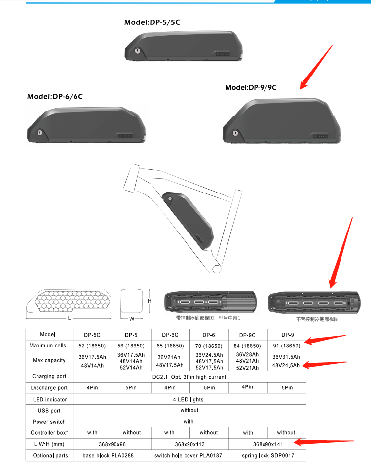

What is the maximum ah you can fit in Dorado DP9 case with Samsung 50e cells? Also can it be made to fit to a Rize MD? https://rizebikes.com/products/rize-md

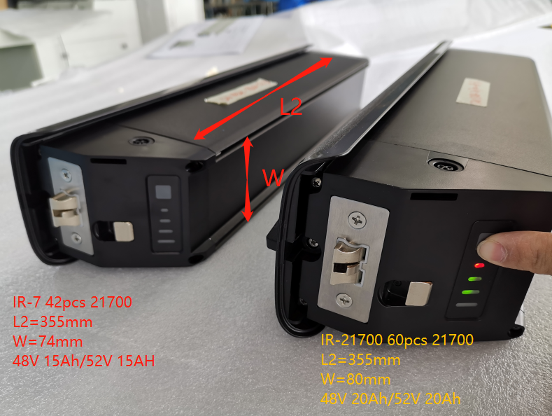

Hi BeltzerNYC
It is seen that Reention Rhino in-tube battery and Reention Polly frame-mounted battery used on Rize MD.
We haven't got chance to customize a replacement battery for Rize owner, so I am not sure which specific model of Rhino and Polly used.
Could you help measure the two battery size and will check maximum upgrade options for both?
For Rhino battery, pls help check the L2xW( length and width of aluminum can), expecially the width, 74mm or 80mm.

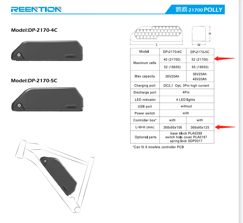

For Polly battery, DP-9 (without controller box) 48V 24.5Ah is maximum upgrade option, but with 18650 cells.
Rize use 48V 15Ah Polly by Samsung 50E, so it must be DP-21700 .
Pls help confirm the WxH(case body width and height).
Thank you!

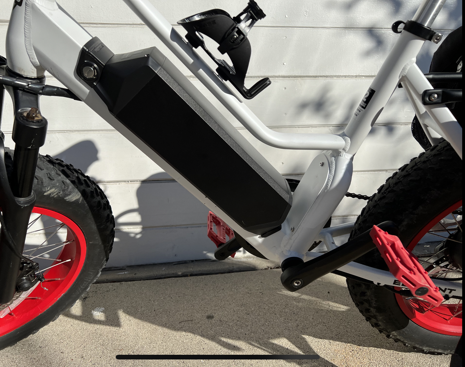

Just received my Dorado 21700 440L 48V 20AH from Shanghai Aijiu Energy Technology Co., Ltd.that fits my Pedego Element perfectly. Was a pleasure working with Jenny and shipping to Los Angeles was less than 5 days from ship date. This battery has doubled the range of my Element coming from the Pedego 10ah battery to this 20ah battery. Thanks to Jenny and all in this forum for the excellent info.
