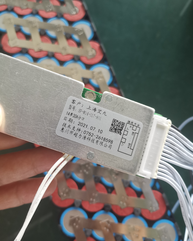

All these 5pcs 25Ah battery is configured with 30A BMS,compatile with max 1000W rated 1500W peak motor, so it will perfectly fit in most ebike models when they come with a Reention Dorado 505L/18inch battery.

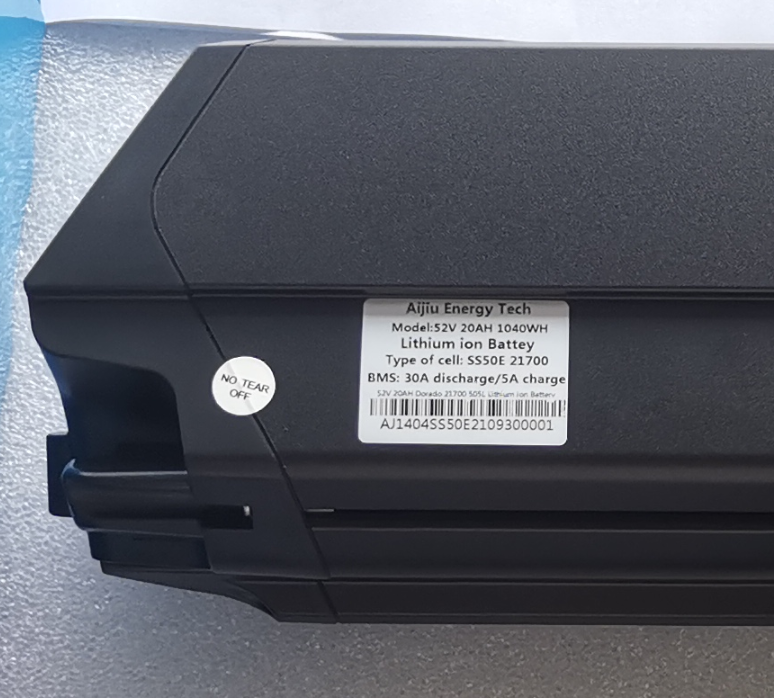

Hello all friends, now 52V 20AH by Dorado 21700 505L/18inch case is available for order.
It is configured with 14S 52V 30A BMS compatible with max 1000W rated 1500W peak motor.
Here is a 52V 25AH PVC battery pack and 52V 20AH Dorado ordered by a Rize owner for parallel connection.
Thank you for all your continued supports.

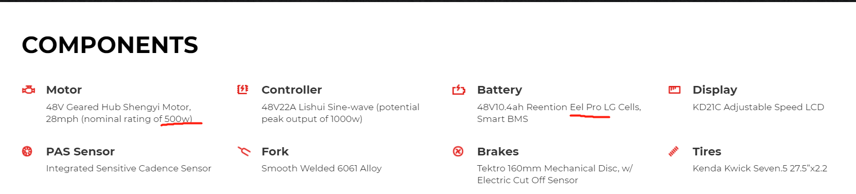

Do you have any Reention Eel options?
Hello, yes, Reention EEL Mini/Pro is another popular series ebike battery.
May I know what is your ebike model?

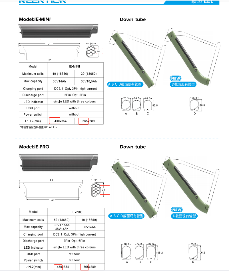

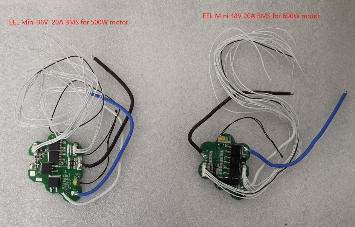

The regular EEL Mini size 430x64x74mm, max for 36V 14AH or 48V 10AH, especially we have developed 36V and 48V 20A BMS in specific shape to fit in the case working for 500W motor.
The regular EEL Pro size 430x64x94mm, max for 36V 17.5AH or 48V 14AH, with regular 25A BMS can put in to work for 750W motor.
The two models case are not interchangeable for upgrade as the height is different.
There are also some shortened EEL Mini/Pro with 365mm length or even 300mm(not listed on Reention catalogue), which are all available for customization.

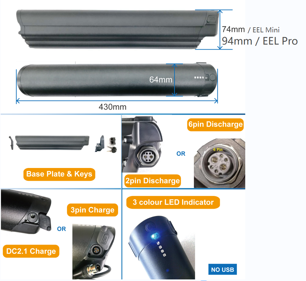

Pls check your current EEL battery in following steps:
1) Battery length and battery height
2) Discharing port is real 2pin or real 6pin
3) Charing port is DC2.1 or Reention 3pin
4) Checking motor rated and peak motor power
5) Confirm to take a new charger or not
6) Share your shipping address
Will check you best offer upon your request. Thanks!

Nice I have a Ride1up Core 5.
