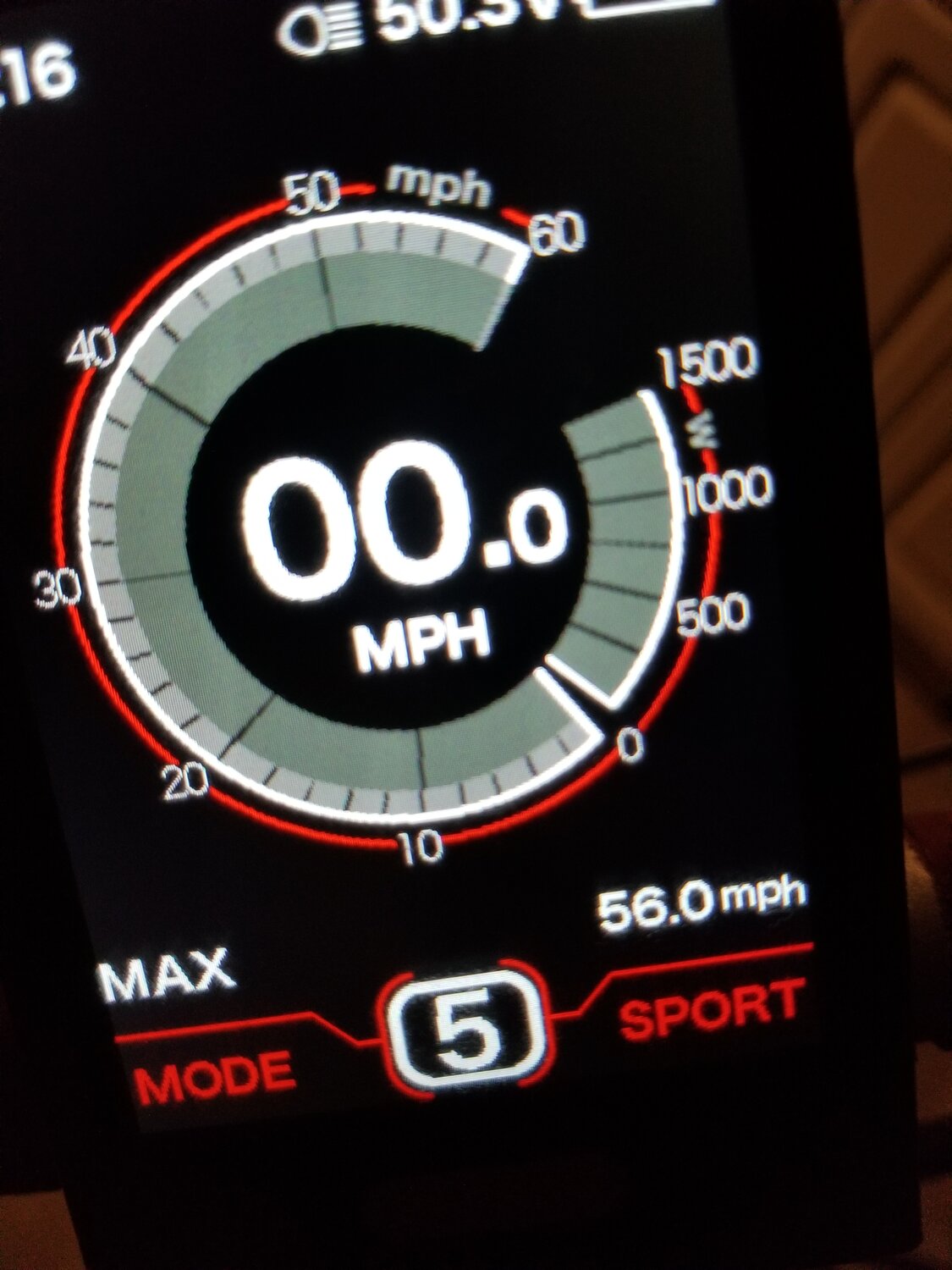

No more X1. I can't have another motor like this ready to go. The controller's a rare item.
Comments on other stuff.
X1 in street legal Eco modes is little more stressful than stock Bafang programing on the M620.
It being all I need (the display ratting me out aside), I'm rarely past Eco 3.
X1 Sports modes (off-road) are best used on the fly, not stop and start stuff - as afterburners.
It's like having Nitrous and in SP I'm programmed wide open throttle; ala off-road motorcycle w/ bicycle gears.
