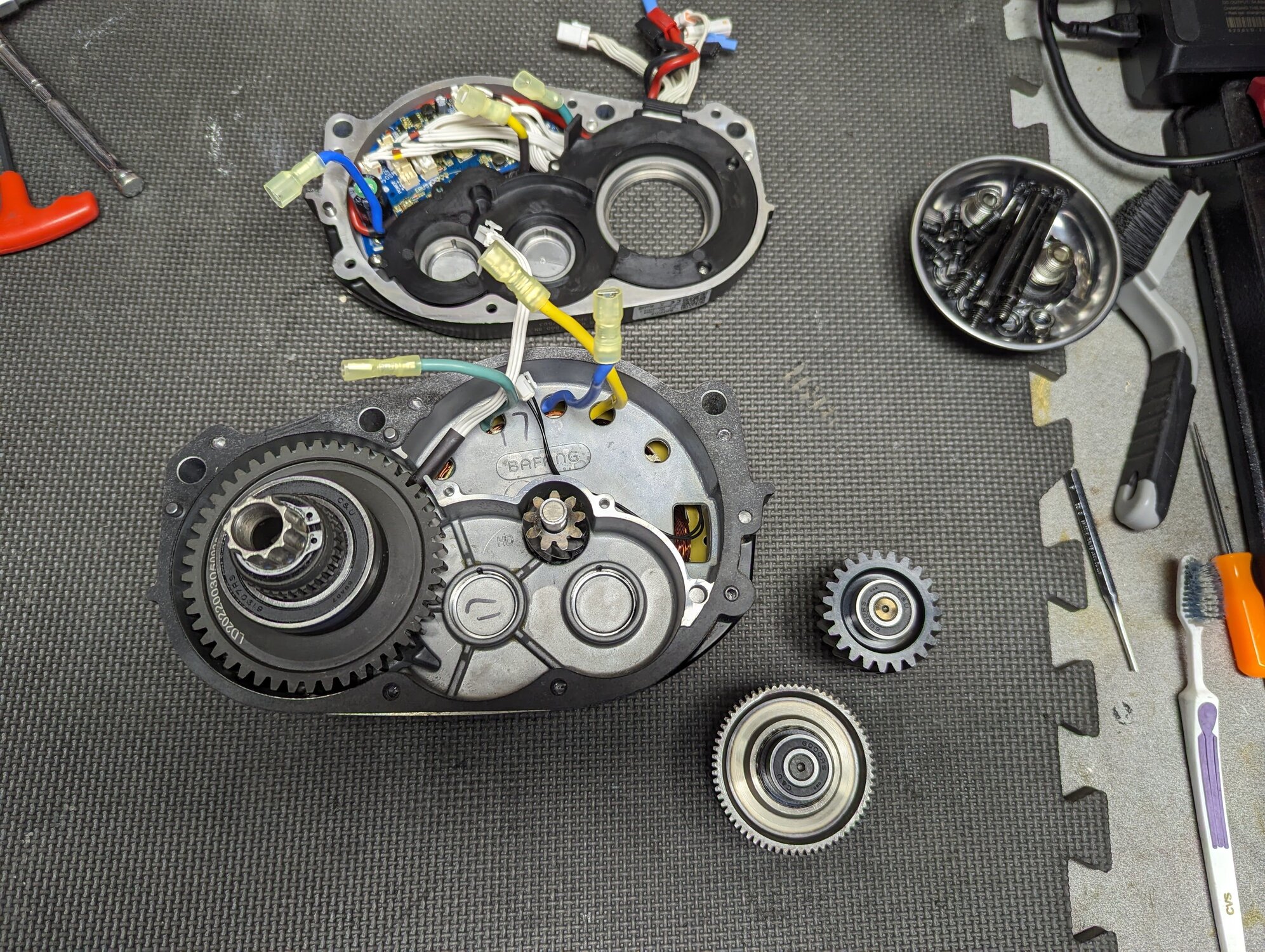

Why is your frame so damned clean!Ok.... My turn @ 1400mi.
First try I had to retreat as the chain ring lock nut wouldn't budge and after 10 minutes of putting all my spaghetti arms had in them.. I warped the p.o.s flat wrench that Bafang provides with the BBS02B.
Ordered this 1/2 drive Socket
View attachment 170603 which arrived in 10 days and I spun off the lock nut in 5 seconds.
There was fair amount of factory grease.... at least more than I've seen in other pics. View attachment 170597
Cleaned it up nicey nice... View attachment 170595
I'd say I added back about double the factory amount. Basically I lightly coated all surfaces and packed between the teeth of all the gears. I used Mobil SHC100 because I had almost a full tube on hand left over from my BBS02B. Additionally I've read it's similar to the factory grease and less chance of contamination from grease incompatibility if any remnants exist.
My gasket looked just as good as the two replacement ones I had on hand so I didn't change it this time around.
One things no one mentioned in any of the videos I watched...
Careful with this ring that sits on top of the large gear bearing as it's delicate. Mine fell off when I split the case leaving me not sure where it went.
On assembly I sat it on the controller side and held it in place with a thin coating of grease.
Now for the results...
I went for about a 20mi ride and it was noticeably smoother with less micro vibrations. As for the noise that too was noticeably less, especially at low power output.. Almost silent say below 100w. At higher output the sound changed to a deeper more pleasing tone then before but was still pretty audible. Went from a GRrrr sound to more of a RRrrr sound. Or from a super charged electric can opener to a high end stand mixer.
Didn't get arrested during any of this.... So I guess it was time well spent![]()

100mi Update:Ok.... My turn @ 1400mi.
Careful with this ring that sits on top of the large gear bearing as it's delicate. Mine fell off when I split the case open leaving me not sure where it went.
