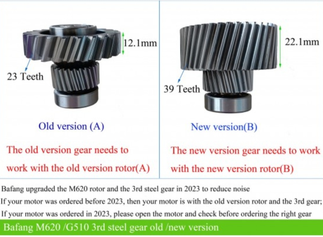

I see there's a new, new rotor gear available - steel like the last but with more teeth.
Geenbike's pumping it. They say it's an upgrade from Bafang, but I can't find in PRC sales.

The new 'noise reducing' gear replacement does look interesting but I've read no reports of just how much the noise level is reduced when compared to the old gears. It looks like 2023 sourced Ultra motors have the 'new' gears (did I read that correctly?) A side-by-side noise comparison of factory 'old' gears vs the factory new 'quieter' gears would be helpful to see if the new gears really do significantly reduce motor noise. Anyone have a motor with 2023 gears? Unless the gears are worn out, the cost doesn't justify switching just to reduce motor noise. Properly greasing the gears is a better choice. Read below for my experience with noise and re-greasing.

I'd think that manufacturer wouldn't go through the trouble of putting out an upgraded gear set if there wasn't an improvement... But then again we are talking Bafang 🙃

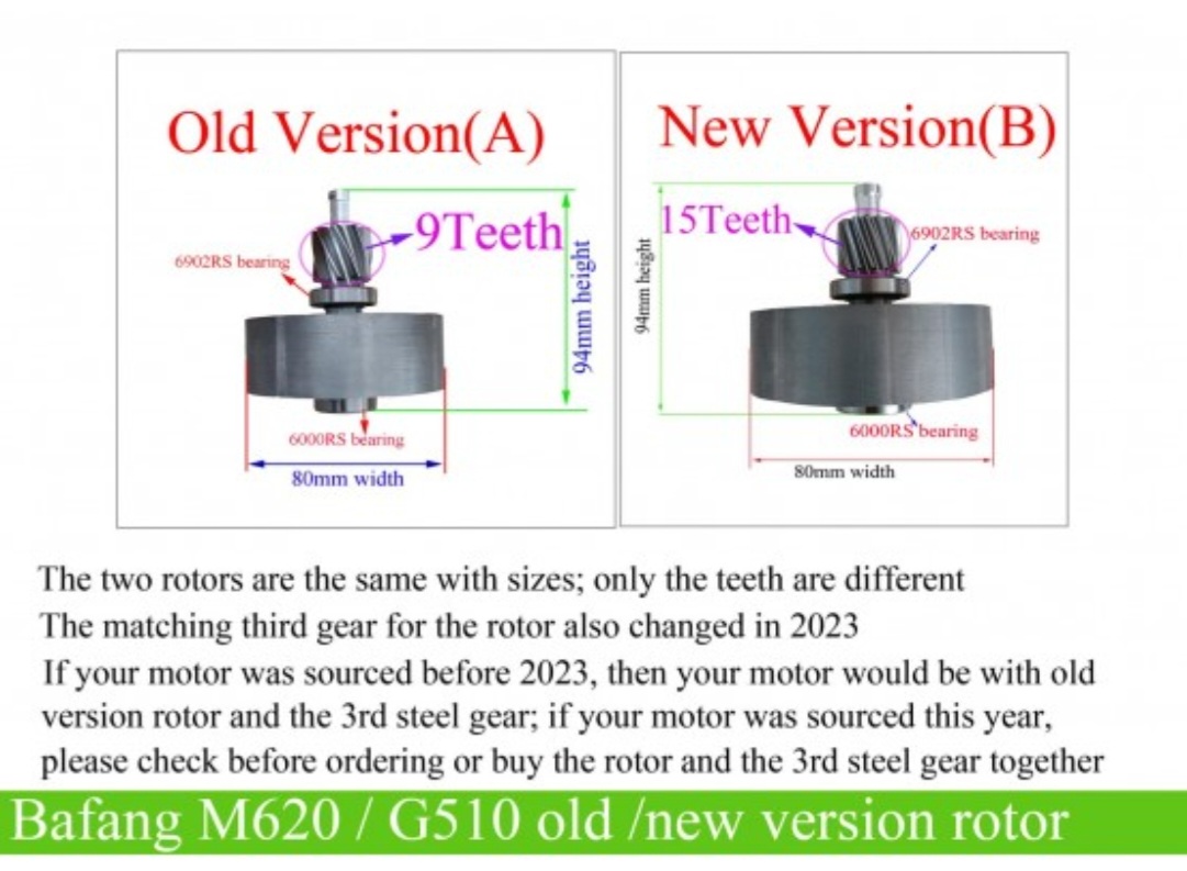

I'm not gonna open my motor again but helical gears 9t vs 15t?
I don't know what I have.
I have a new motor, purchased 2023. I did not check the number of teeth on the gear, so I do not know if I have have the 15 tooth version. I also greased it with cornhead. It is tons quieter as I said, but I had not greased my old motor with cornhead, so it is hard to compare.

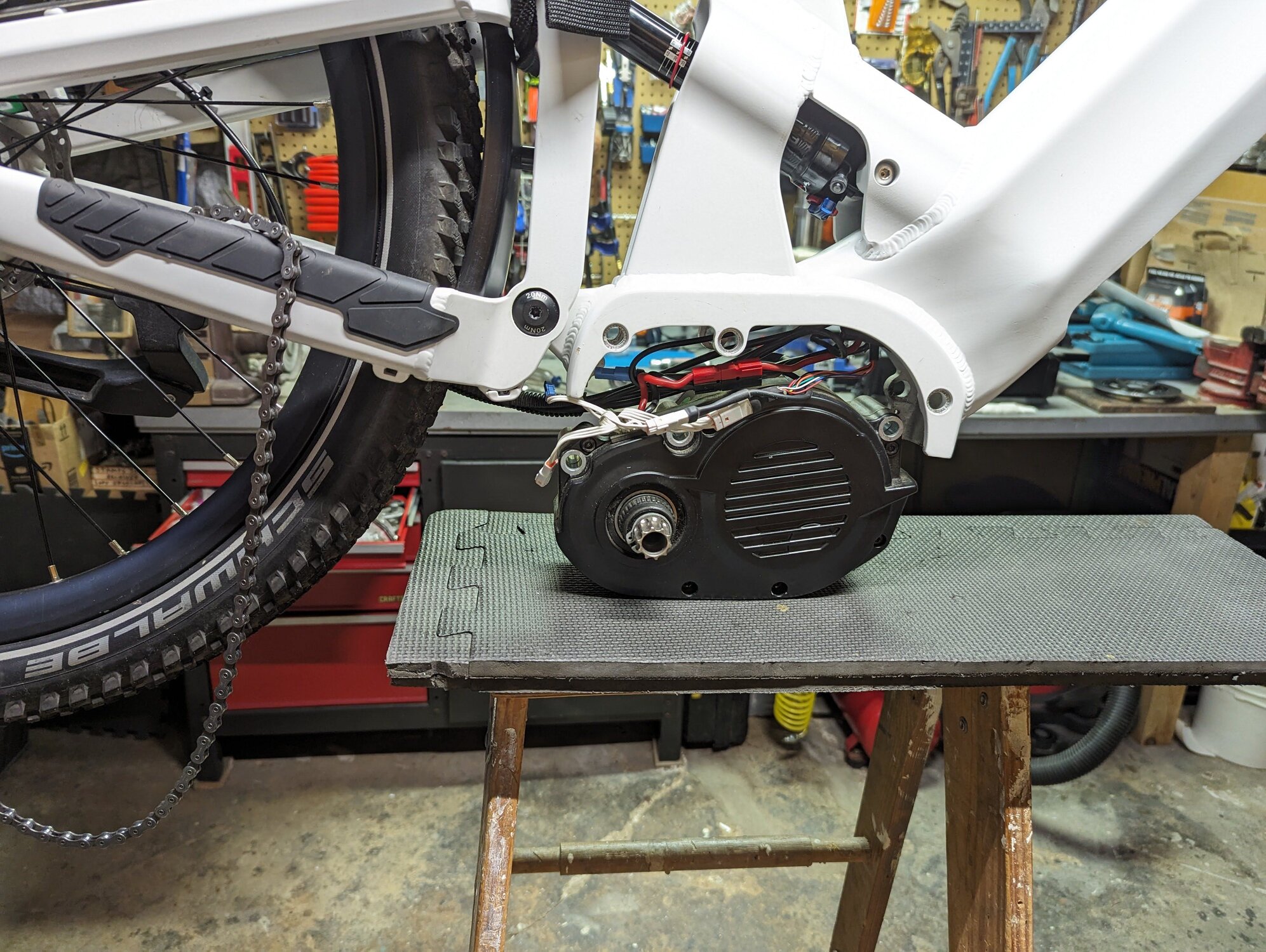

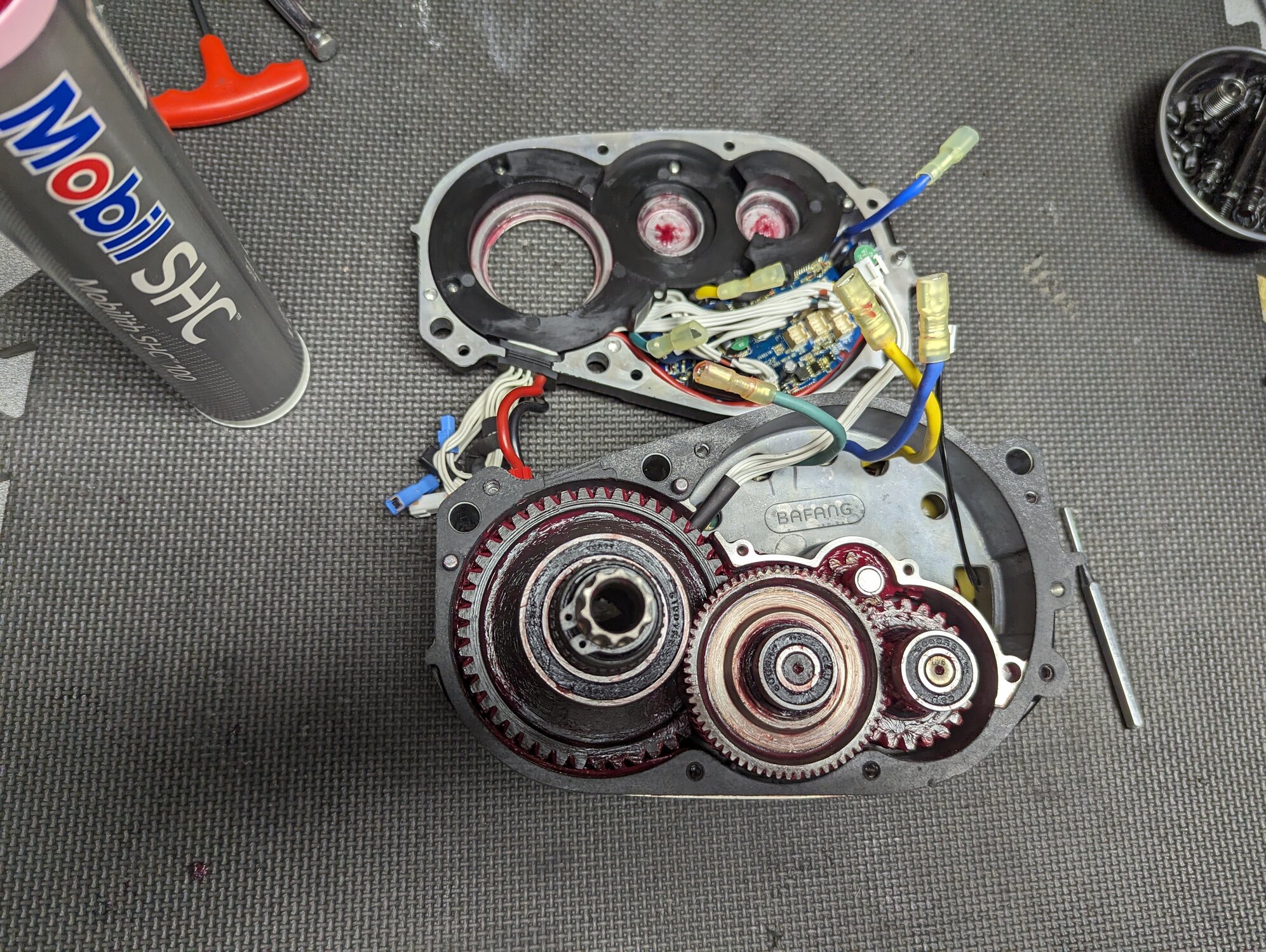

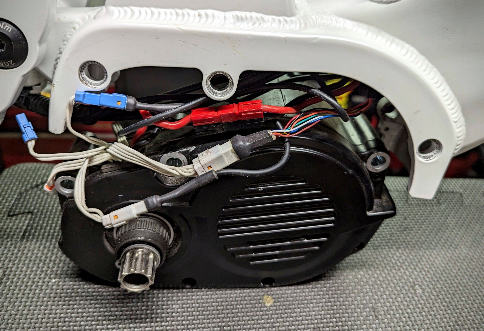

Ok.... My turn @ 1400mi.

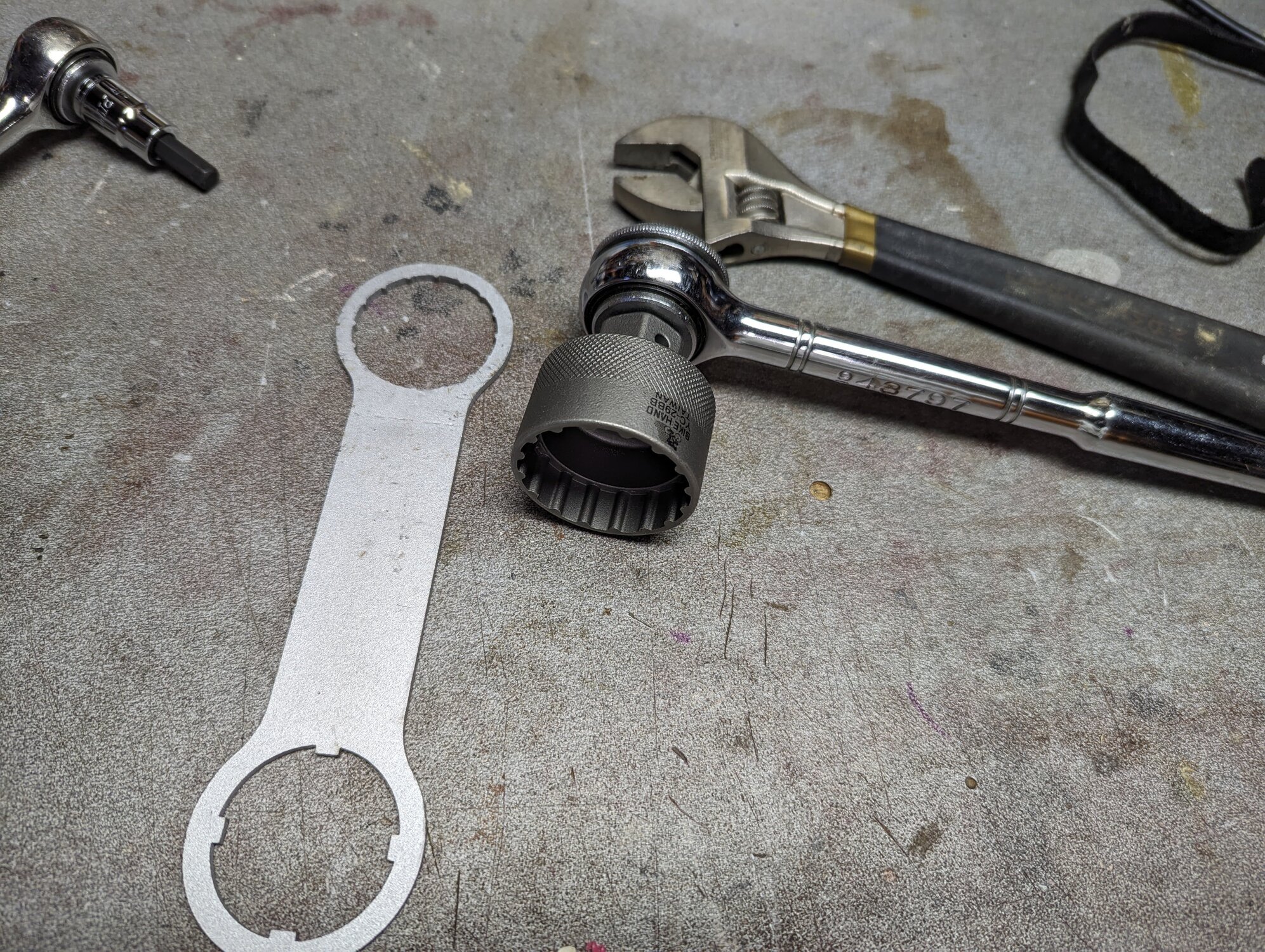

First try I had to retreat as the chain ring lock nut wouldn't budge and after 10 minutes of putting all my spaghetti arms had in them.. I warped the p.o.s flat wrench that Bafang provides with the BBS02B.
Ordered this 1/2 drive Socket
which arrived in 10 days and I spun off the lock nut in 5 seconds.

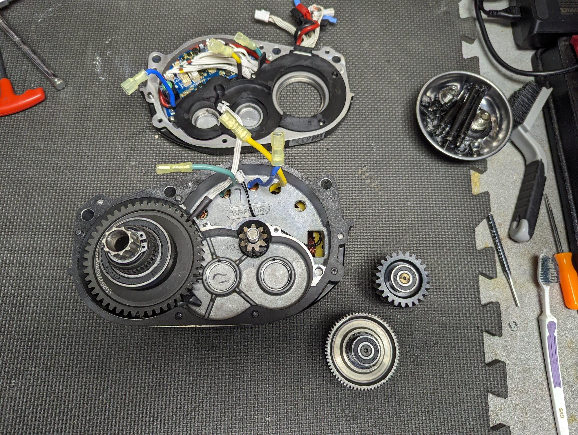

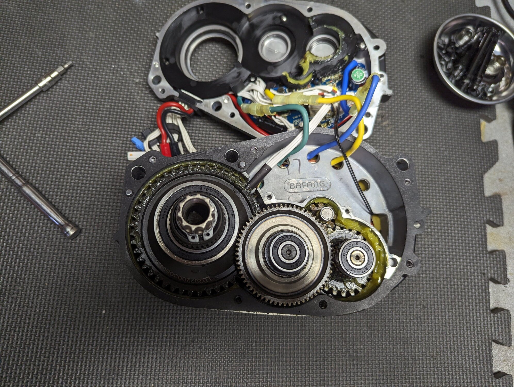

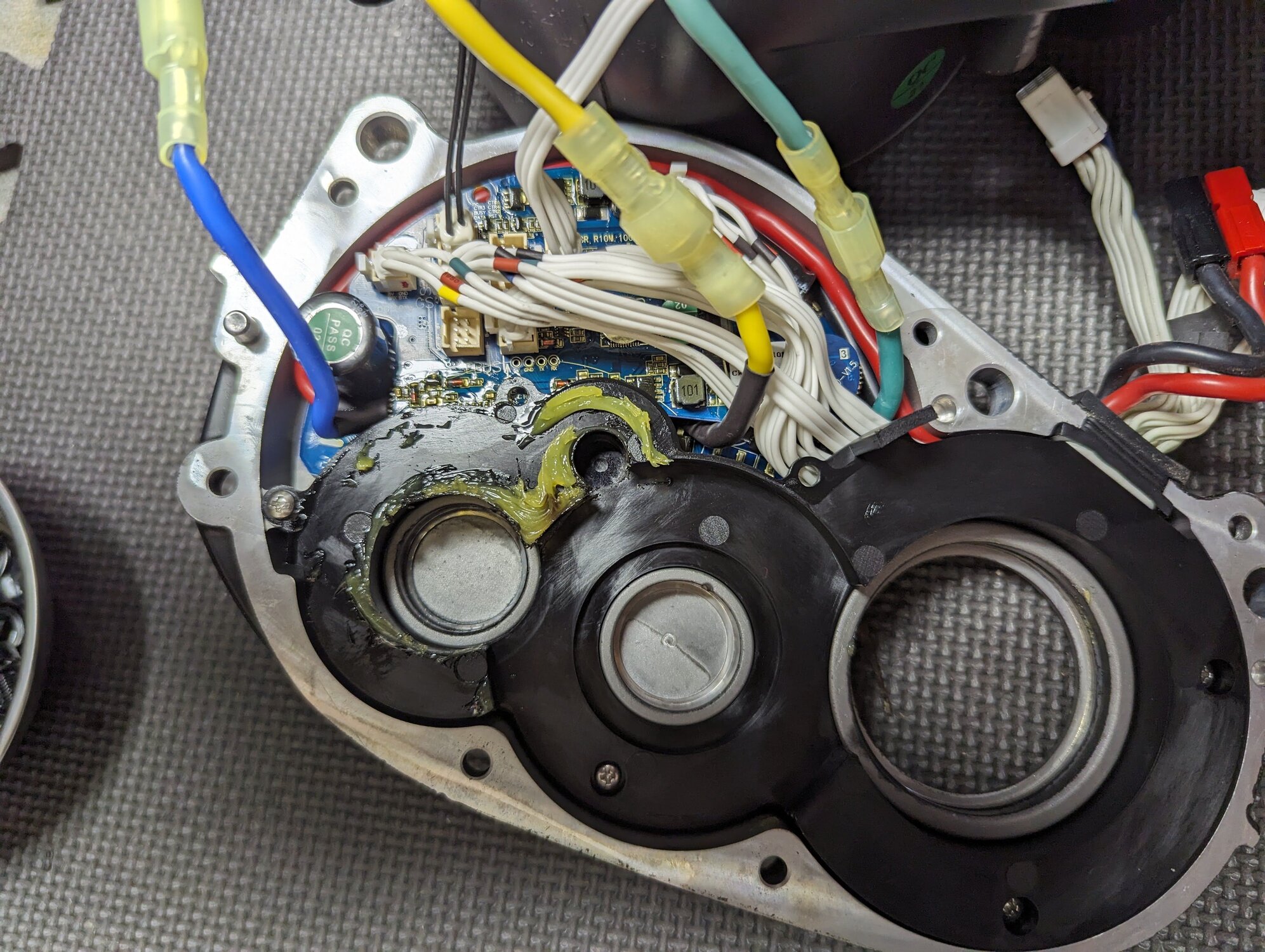

There was fair amount of factory grease.... at least more than I've seen in other pics.
Cleaned it up nicey nice...
I'd say I added back about double the factory amount. Basically I lightly coated all surfaces and packed between the teeth of all the gears. I used Mobil SHC100 because I had almost a full tube on hand left over from my BBS02B. Additionally I've read it's similar to the factory grease and less chance of contamination from grease incompatibility if any remnants exist.
My gasket looked just as good as the two replacement ones I had on hand so I didn't change it this time around.

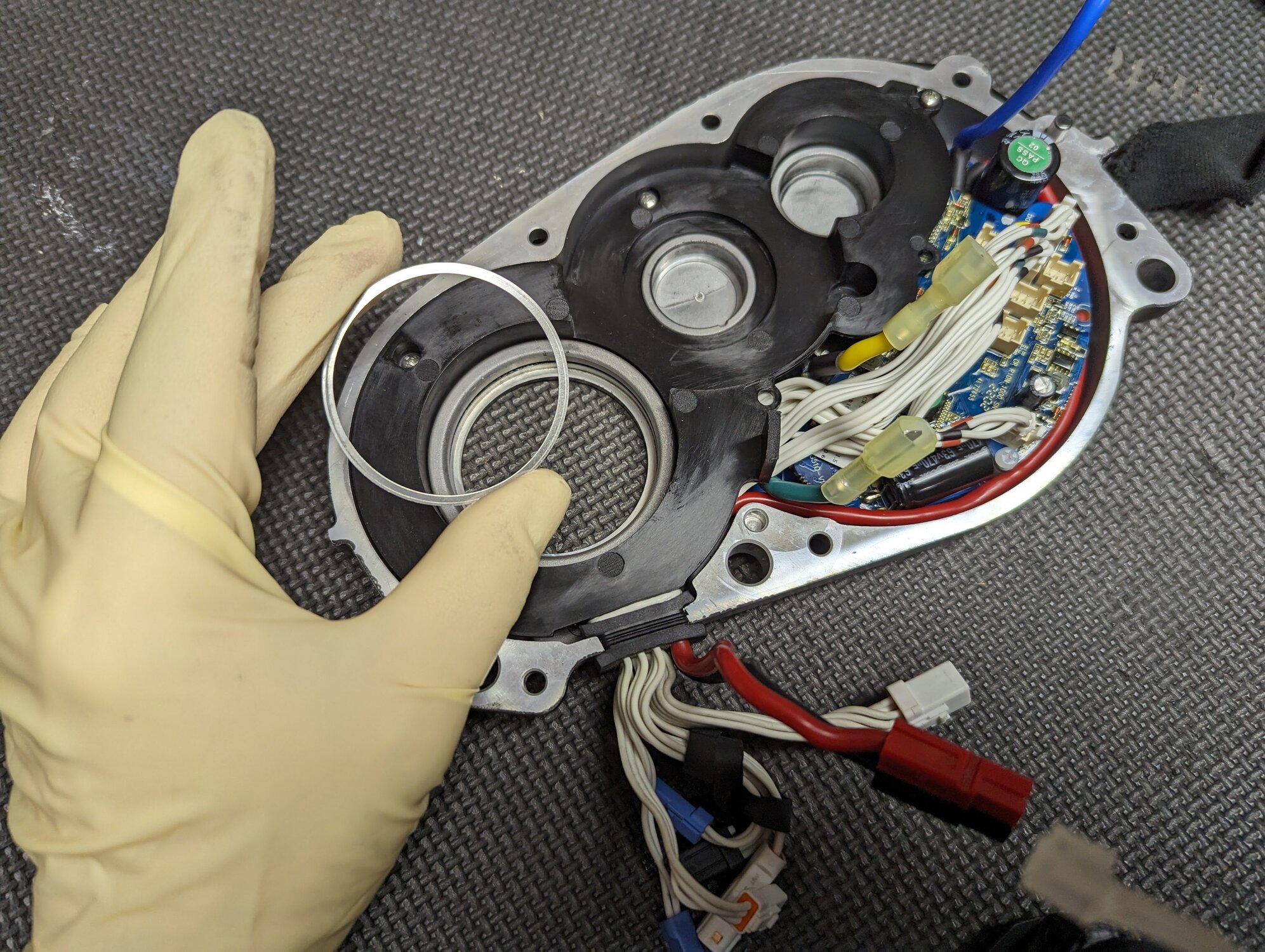

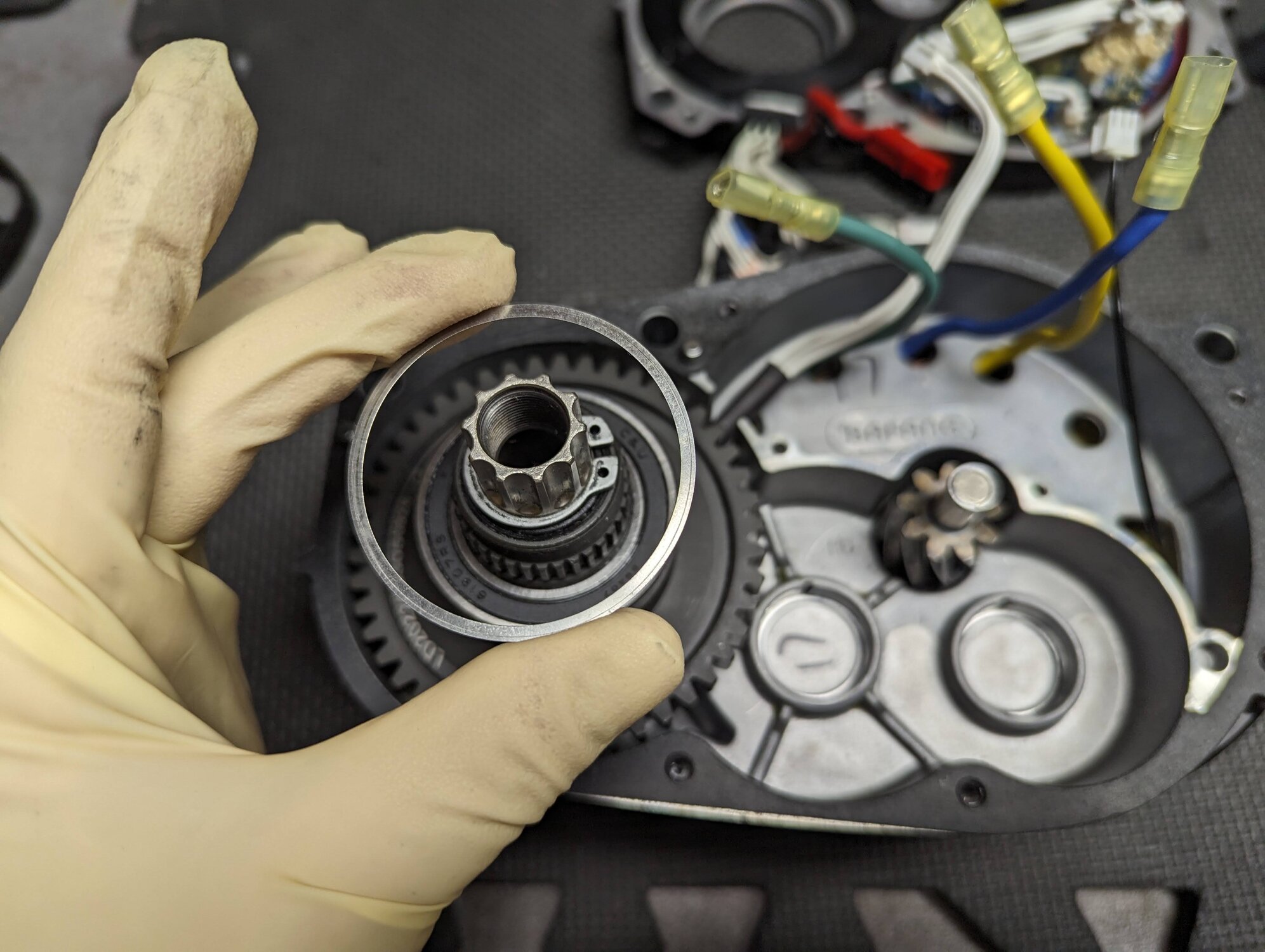

One things no one mentioned in any of the videos I watched...
Careful with this ring that sits on top of the large gear bearing as it's delicate. Mine fell off when I split the case open leaving me not sure where it went.
On assembly I sat it on the controller side and held it in place with a thin coating of grease.
Now for the results...
I went for about a 20mi ride and it was noticeably smoother with less micro vibrations. As for the noise that too was noticeably less, especially at low power output.. Almost silent say below 100w. At higher output the sound changed to a deeper more pleasing tone then before but was still pretty audible. Went from a GRrrr sound to more of a RRrrr sound. Or from a super charged electric can opener to a high end stand mixer.
Didn't get arrested during any of this.... So I guess it was time well spent 🙃
