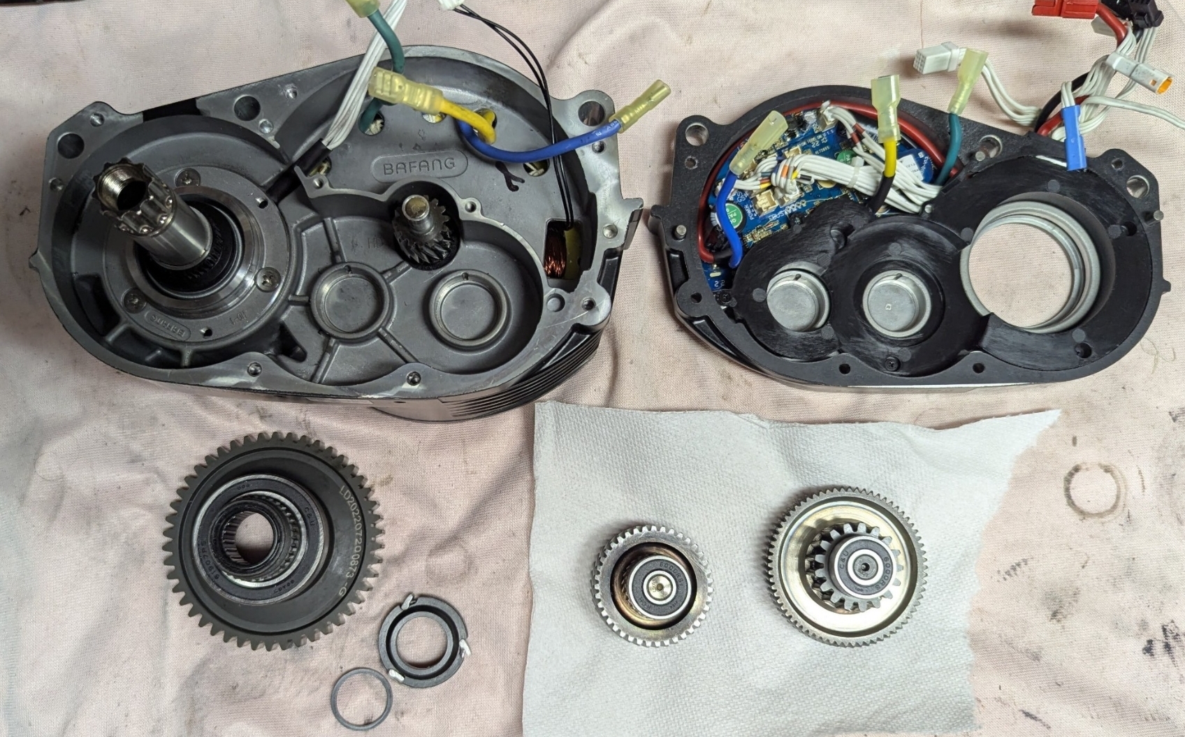

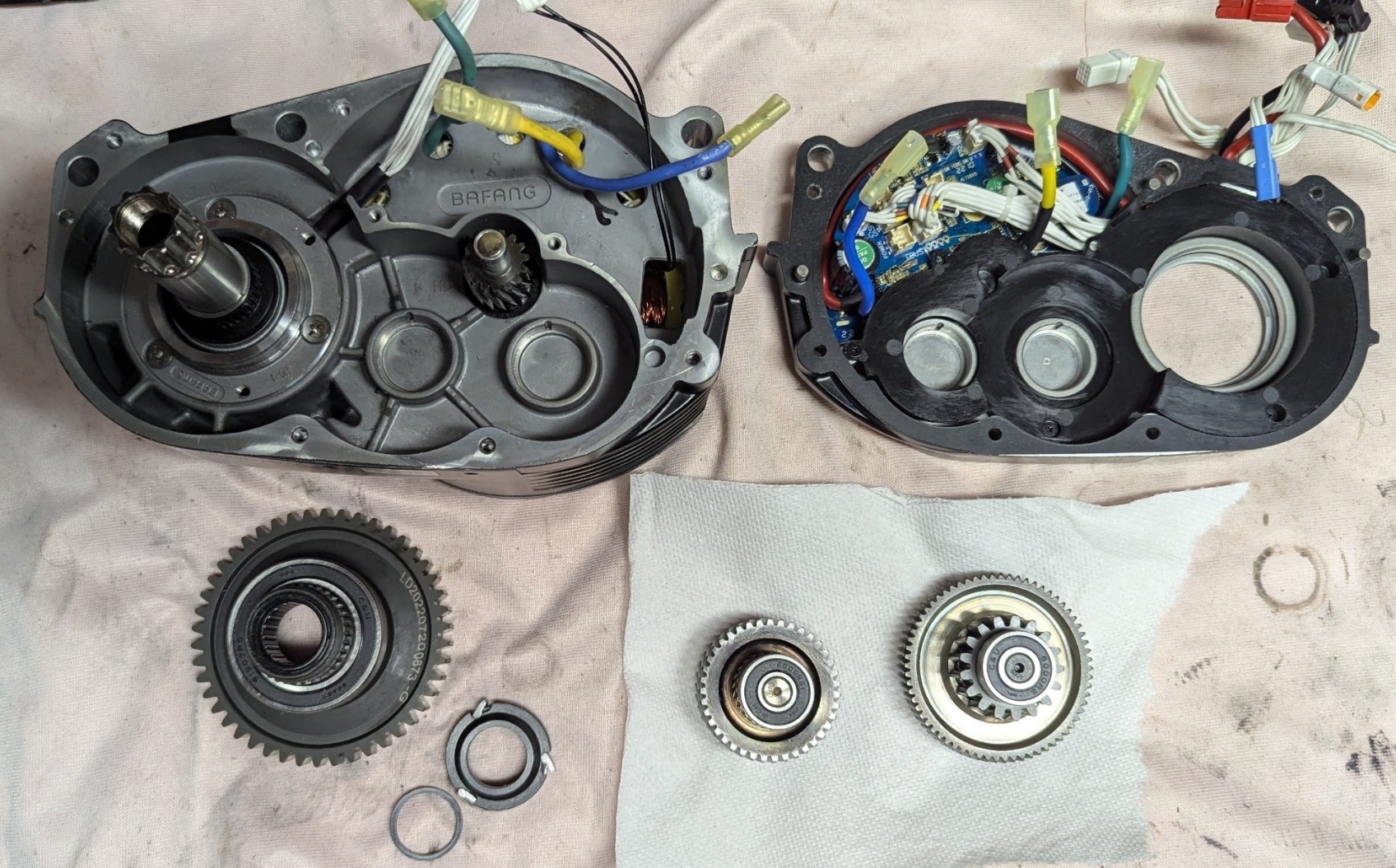

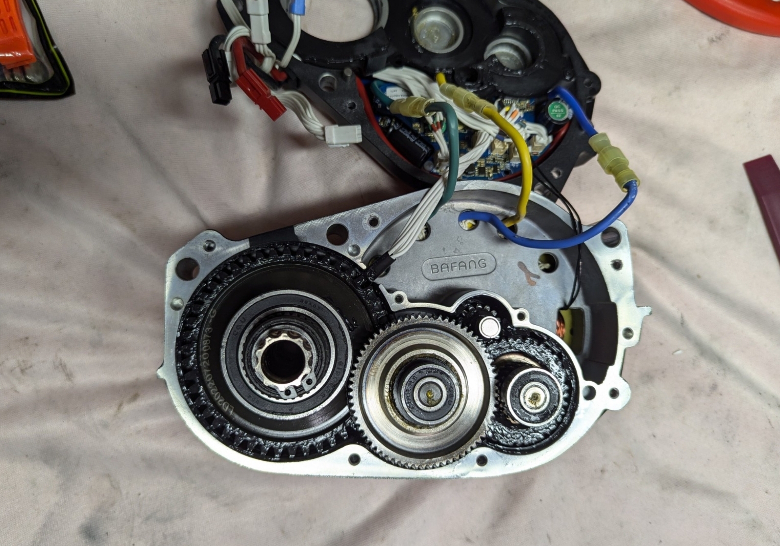

So I opened up a new Quiet Gear Ultra with just 100 miles on it...Note, I don't find it to be any quieter than my 2022 motor.

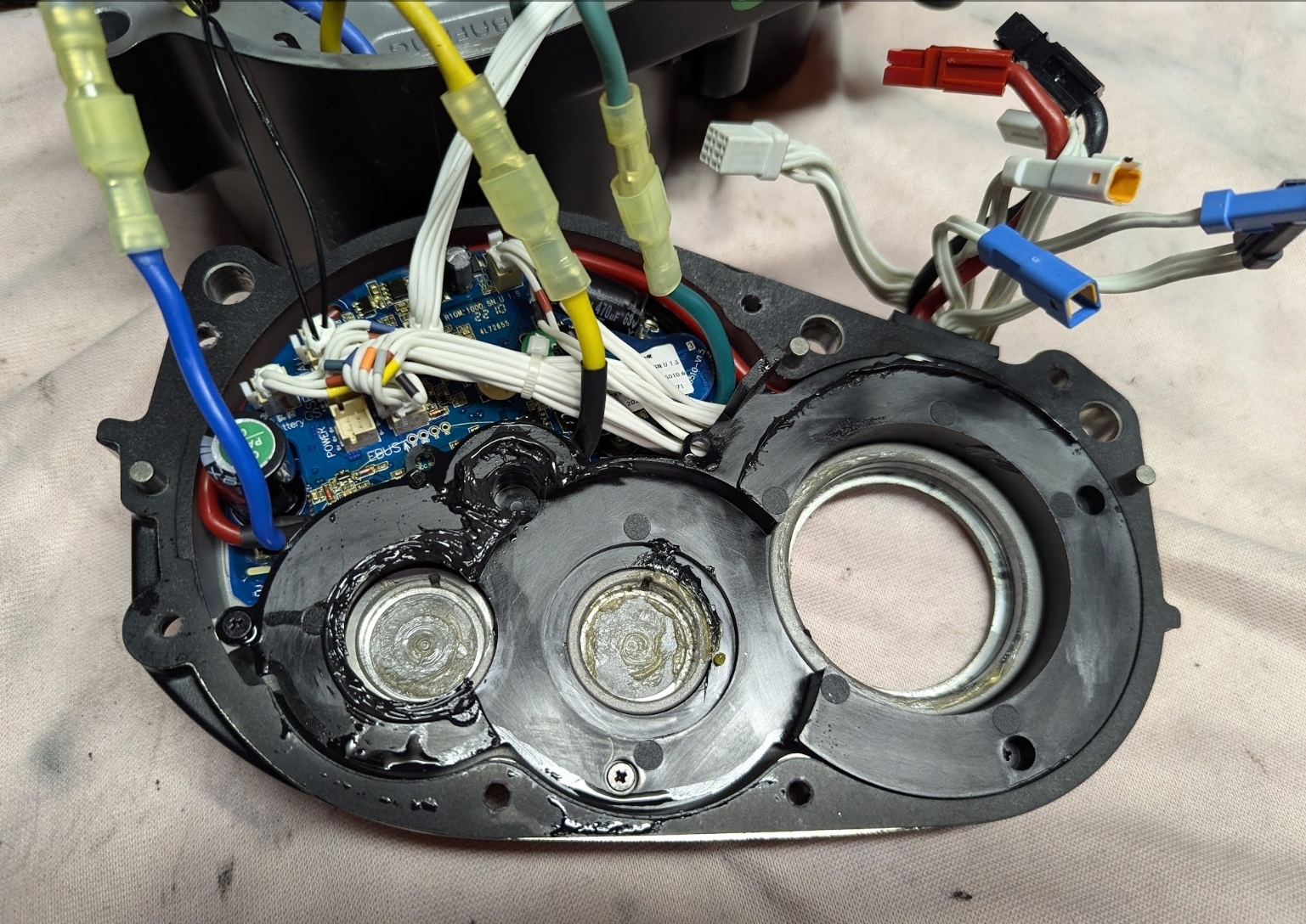

The amount of factory grease seemed adequate but was the same yellow seen before but had mostly black'nd in color and quite frankly looked burnt and wasn't easy to clean up.
So cleaning it up was tedious but with patience doable
Put back approximately the same amount of Cornhead grease and about the same as I had used on the 2022 motor when I used the Mobile SHC100
I found the Cornhead very hard to work with and to be neat with. It has a very tacky property and it's like working with snot.
This also lead me down the path of making a mistake. Not wanting to have two very different greases in the motor I also lifted the main large gear to lube the pawl clutch with the cornhead. And though I used as thin a layer as possible.. When reassembled the pawl clutch didn't work correctly due to the tackyness of the grease. Luckily I bench tested it and found out then. So I cleaned it up again and used some Mobil SHC100 which didn't give me the same problem. The greases are far enough apart so they shouldn't contaminate each other (hopefully)

Curiosity got the best of me so I ventured out for a short 5mi ride.
The MUP is still a sheet of ice and the streets have enough ice melt salt on them to start your own Dead Sea... But at least the temps made it to 40° this afternoon for the first time in too long.
This said and my first impression... I'm not experiencing the Quiet Gear nor Corn Head Grease miracle.
Probably measurably quieter but no where near what I would consider to be quiet motor. If you've ever riden with a BBS02B... Now that's near silent.
I'll give it a few more miles and see if things get quieter with break in like they did when I initially tried the Mobil SHC100
I may then open her up to check migration and possibly top it off as I've seen many on here with cornhead grease pics and much more grease was used.

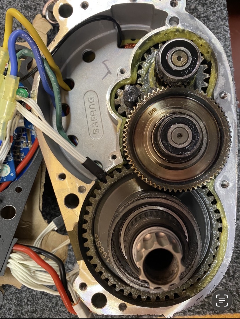

Hey @JRA ... You speak of only using a tblsp and I'd guess that's about what I used.. How do my pics compare to the amount you used?

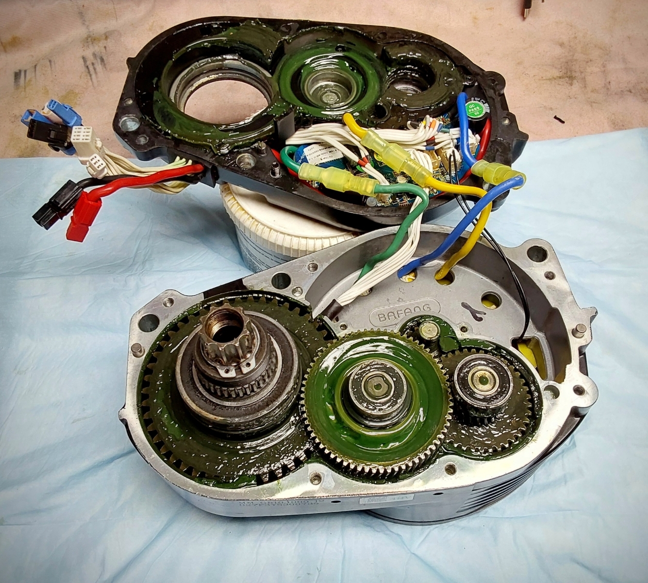

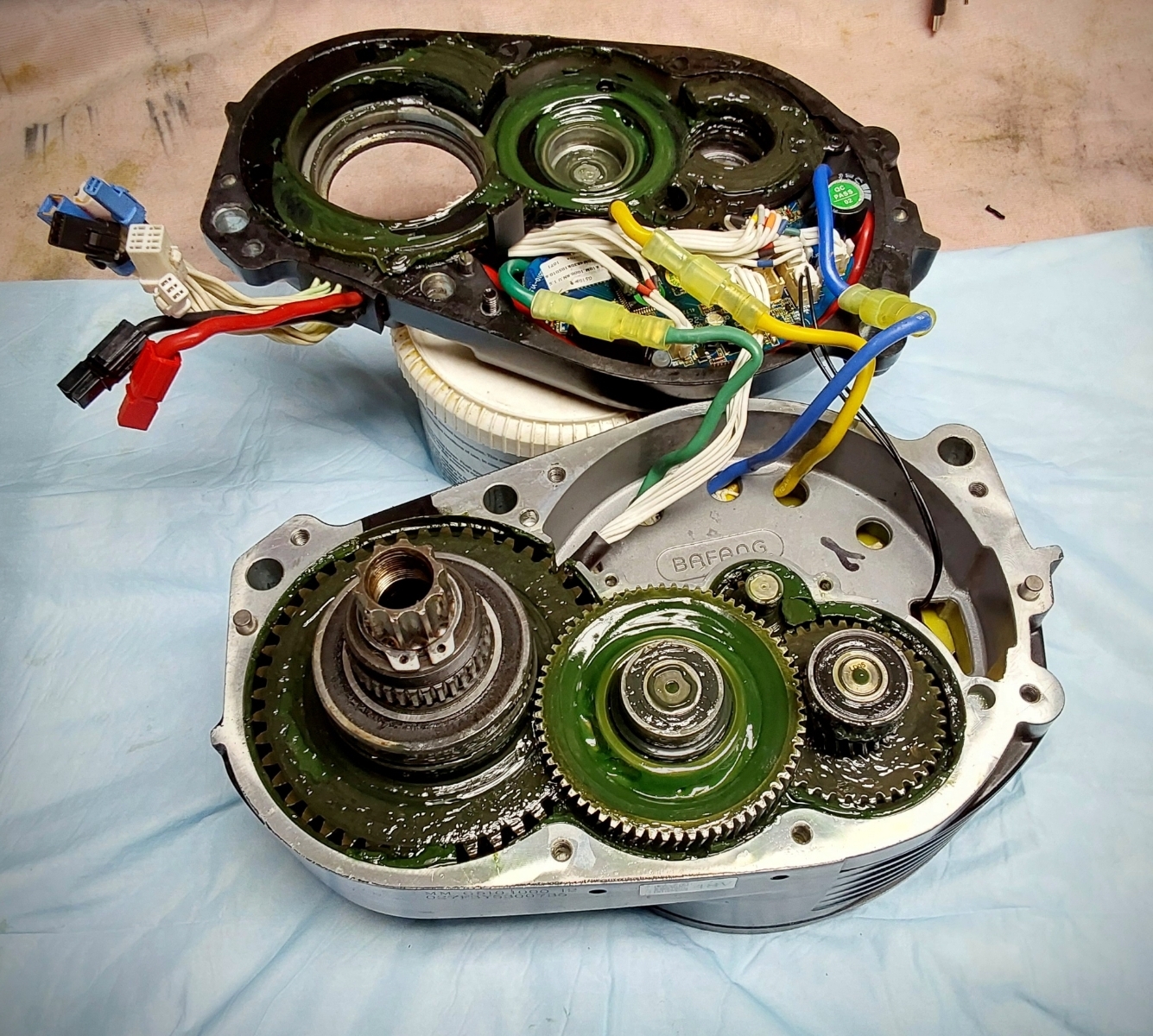

.... so I decided to add some more to see if it would make any difference. Not as much as @Tom@WashDC used.. but significantly more than the tablespoon that @J.R. uses.. which was about what I initially applied.
Like the first greasing I removed the 2 smaller gears and packed all the teeth in the underlying gears, then the upper gear teeth. Put the gears back in place and then I packed the space between the gears and the casing.
This tacky snot grease is so annoying to work with.

So with 750mi on the QG motor and 650mi since switching to Cornhead the motor was still whining annoyingly.
I opened her up and packed the gear box with cornhead as this was the only thing left to do and there was no sign of migration into the controller area. In doing so I didn't see any signs of wear but I did notice that the top of the gears (when looking at it in it's mounted state) looked almost dry of grease. I'm assuming the grease under load liquifies and flings off during operation.
Since doing this I've put another 150mi on it and now I can finally say that the motor is acceptably quiet though still not silent. Very quiet under 250w but put her under load and you can hear it.. though now at a much lower level and at a lower less annoying tone.
I think my initial hypothesis in my last post is proving true. Due to the thixotropic characteristics of the Cornhead the gear box needs to be full so that as it liquifies.. it has no place to go but back on the gears.
Honestly I don't see how a tablespoons worth of this grease can be sufficient as I'm using 8 times that amount now. A little less than 1/2 the tube.
Now my only concern is my original.. migration into the controller area... but since the grease is thicker in it's static state I believe it will contain itself to the gear area as it has so far.

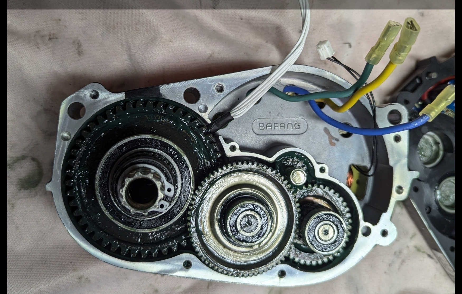

One more update on the Cornhead grease.
4,750 mi on the motor and 4000mi since the last inspection. The motor is running quiet and smooth.
I see no signs of gear wear or grease migration into controller area.
Top'd it off with another tablespoon around the gear teeth and closed it back up.
