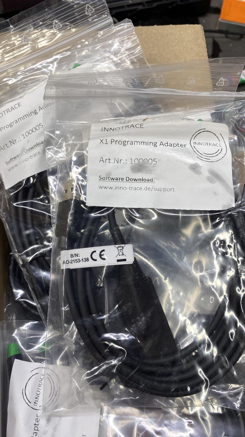

Hello can you help optain Dongle Kabel for x1. Thank Jan

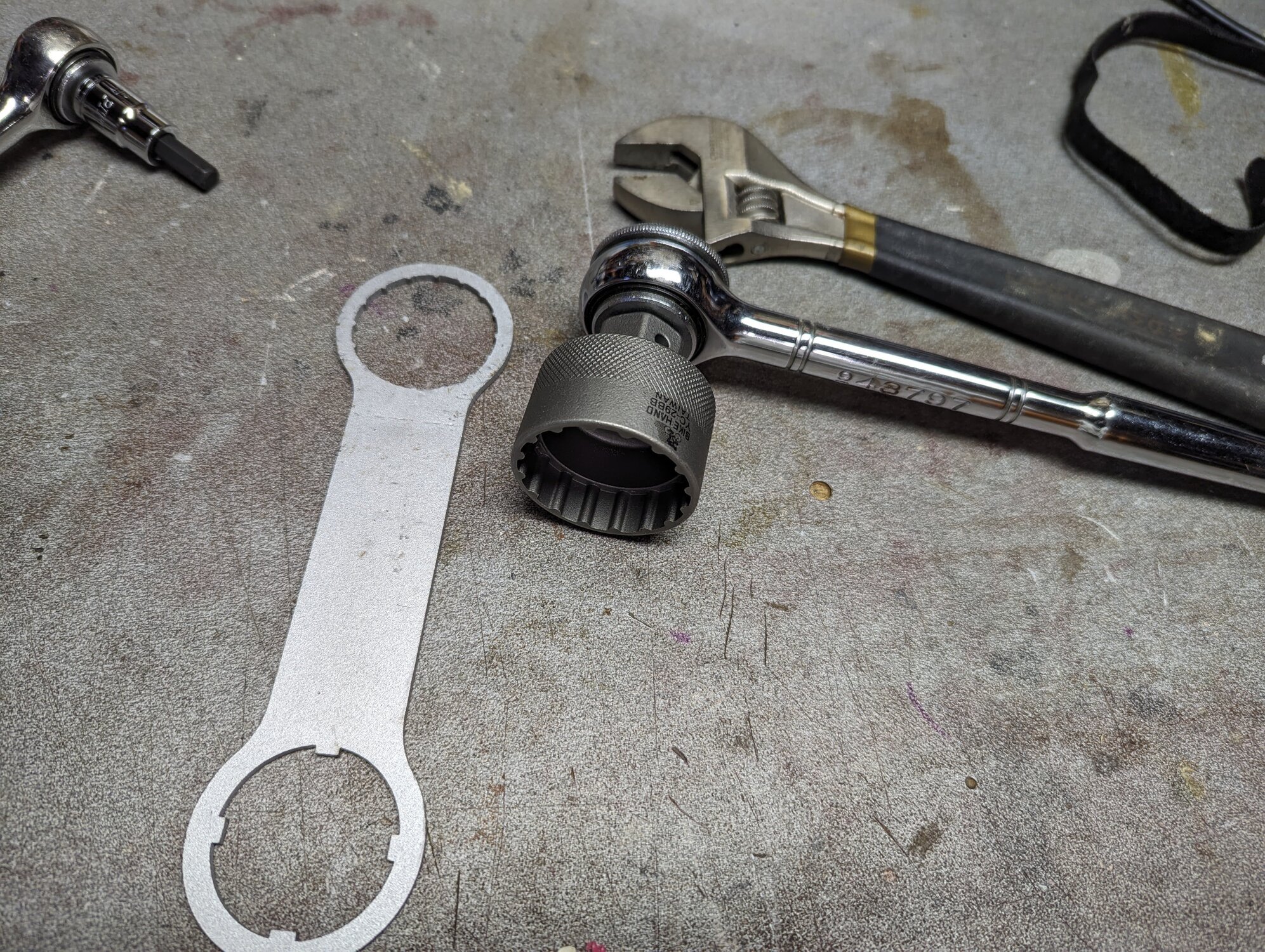

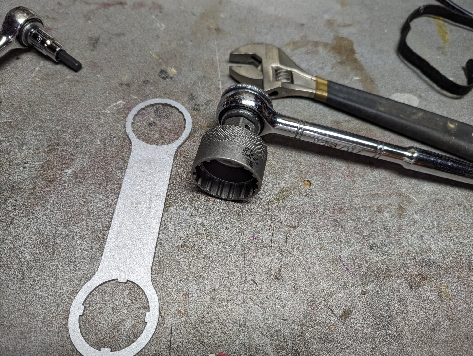

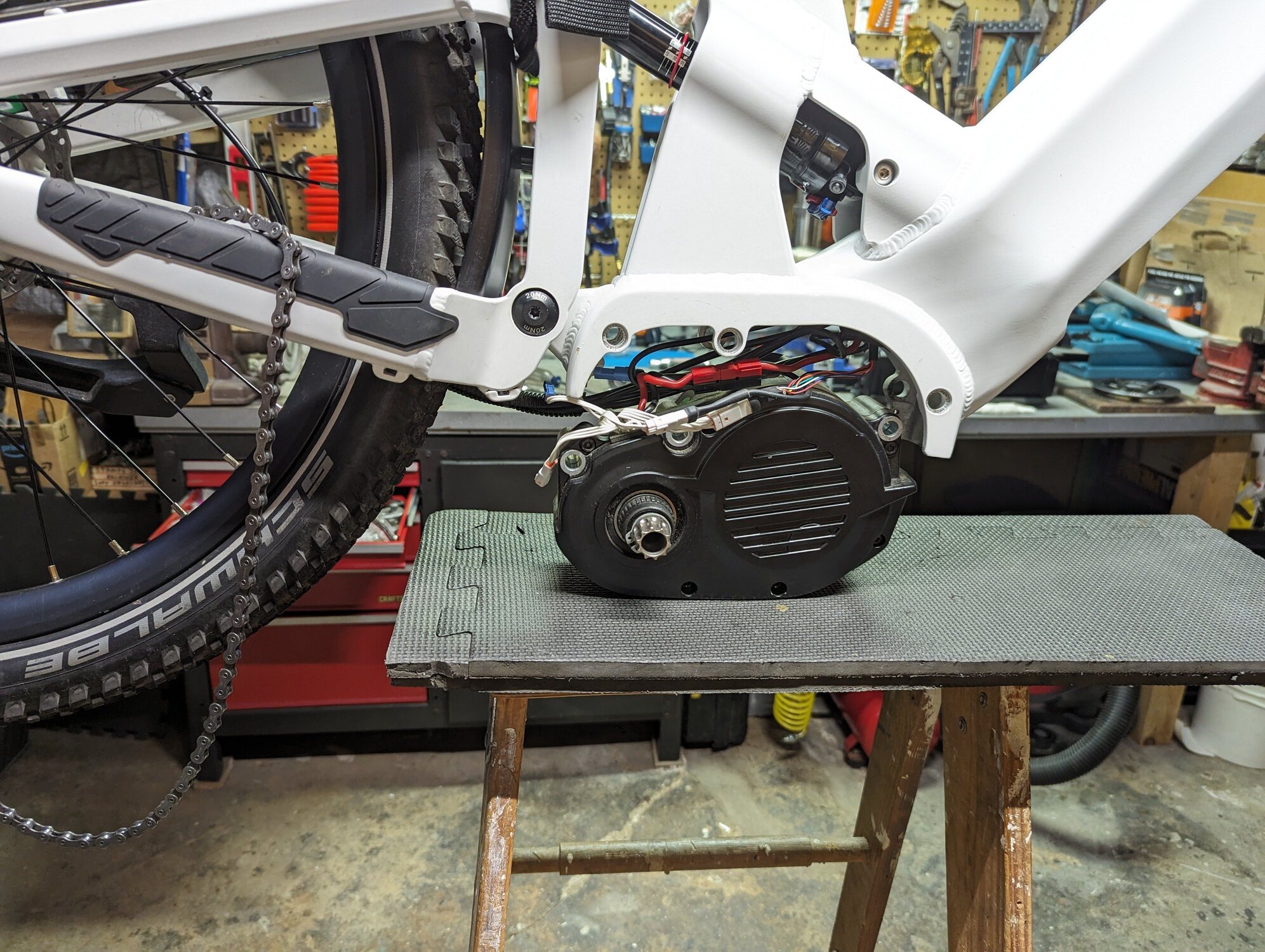

Ok.... My turn @ 1400mi.
First try I had to retreat as the chain ring lock nut wouldn't budge and after 10 minutes of putting all my spaghetti arms had in them.. I warped the p.o.s flat wrench that Bafang provides with the BBS02B.
Ordered this 1/2 drive Socket
which arrived in 10 days and I spun off the lock nut in 5 seconds.

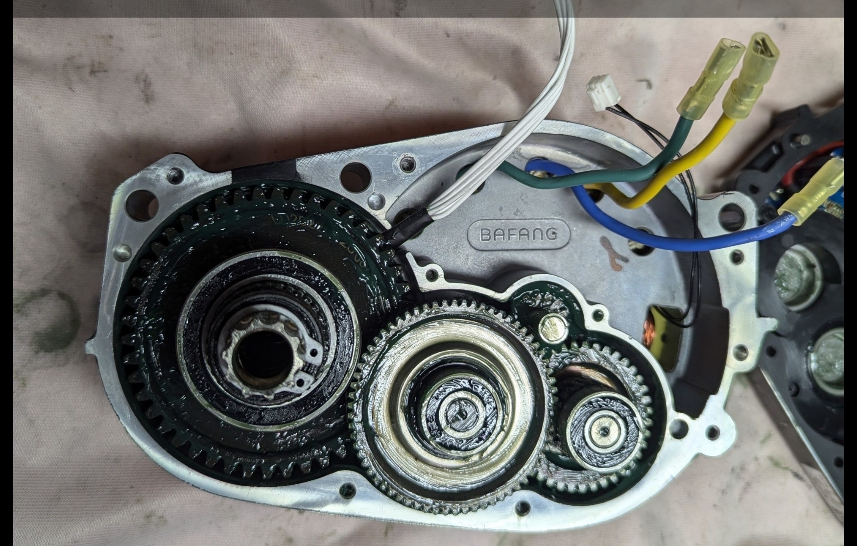

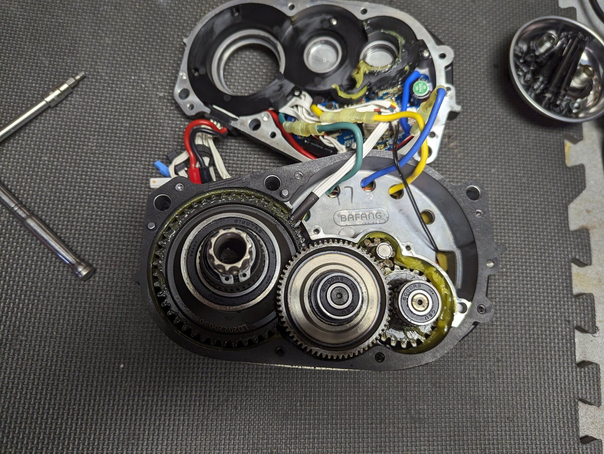

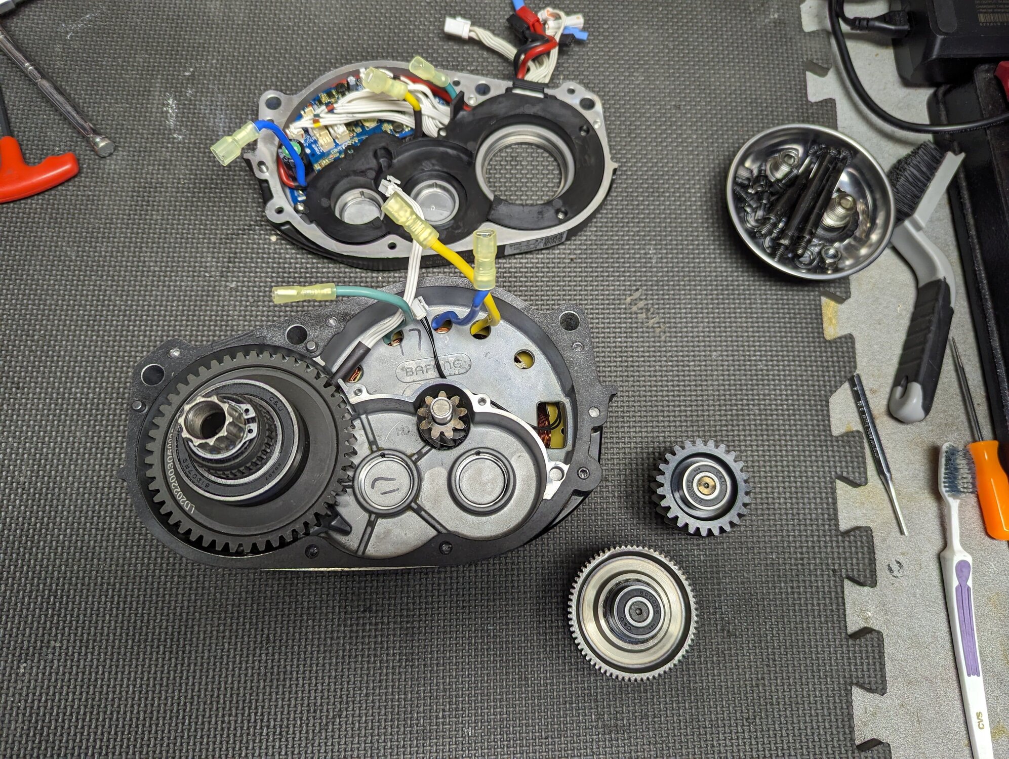

There was fair amount of factory grease.... at least more than I've seen in other pics. View attachment 170597
Cleaned it up nicey nice... View attachment 170595
I'd say I added back about double the factory amount. Basically I lightly coated all surfaces and packed between the teeth of all the gears. I used Mobil SHC100 because I had almost a full tube on hand left over from my BBS02B. Additionally I've read it's similar to the factory grease and less chance of contamination from grease incompatibility if any remnants exist.
My gasket looked just as good as the two replacement ones I had on hand so I didn't change it this time around.

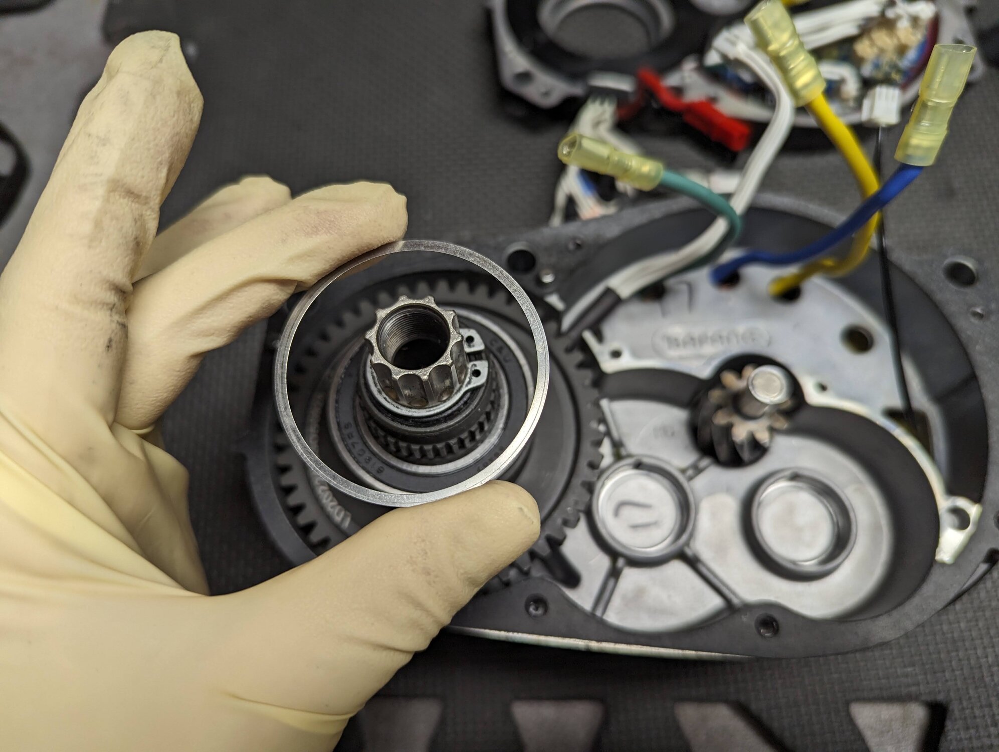

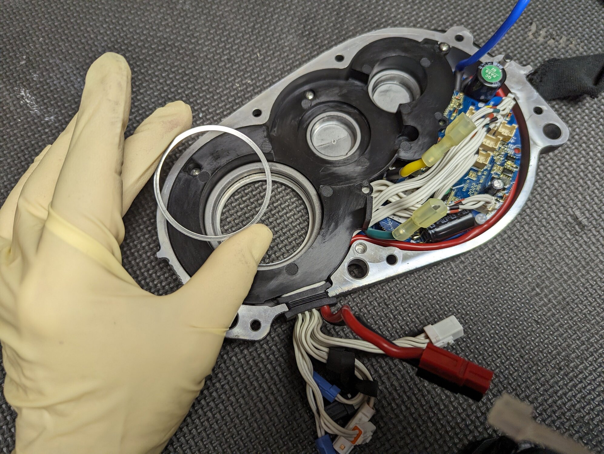

One things no one mentioned in any of the videos I watched...
Careful with this ring that sits on top of the large gear bearing as it's delicate. Mine fell off when I split the case open leaving me not sure where it went.
On assembly I sat it on the controller side and held it in place with a thin coating of grease.
Now for the results...
I went for about a 20mi ride and it was noticeably smoother with less micro vibrations. As for the noise that too was noticeably less, especially at low power output.. Almost silent say below 100w. At higher output the sound changed to a deeper more pleasing tone then before but was still pretty audible. Went from a GRrrr sound to more of a RRrrr sound. Or from a super charged electric can opener to a high end stand mixer.
Didn't get arrested during any of this.... So I guess it was time well spent 🙃

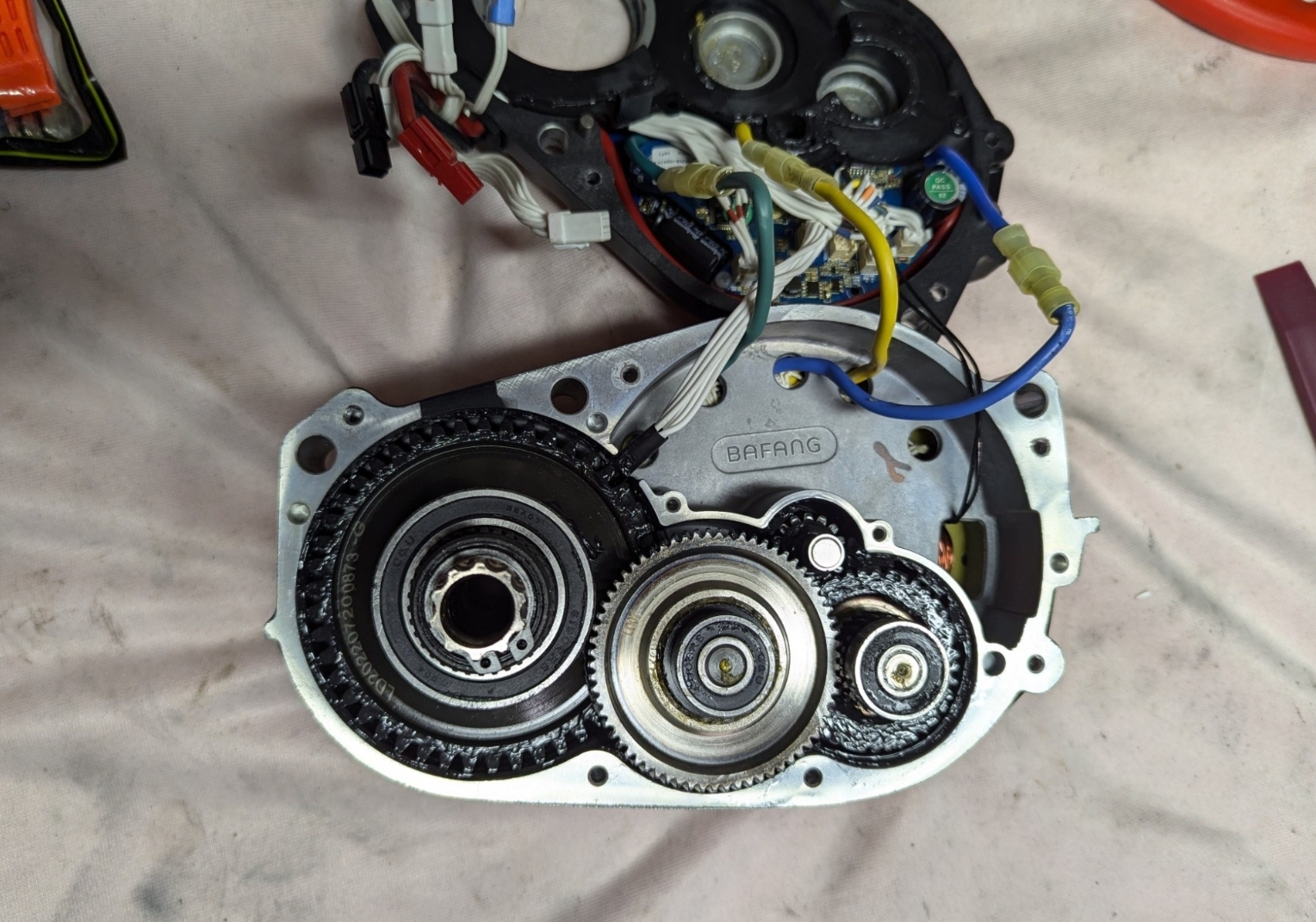

Ok... 4000mi later and at 5500mi on the odometer.
I opened her up with the intention of switching to Cornhead grease. But what I found was no wear on the motor or grease.
Hell even the gasket was still pristine.
So I decided to leave well enough alone. I spread out some of the grease that had gathered in spots and redistributed it back to the teeth and closed her back up.
I think the Mobil SHC1000 is good for 10k if not more. . .
ymmv

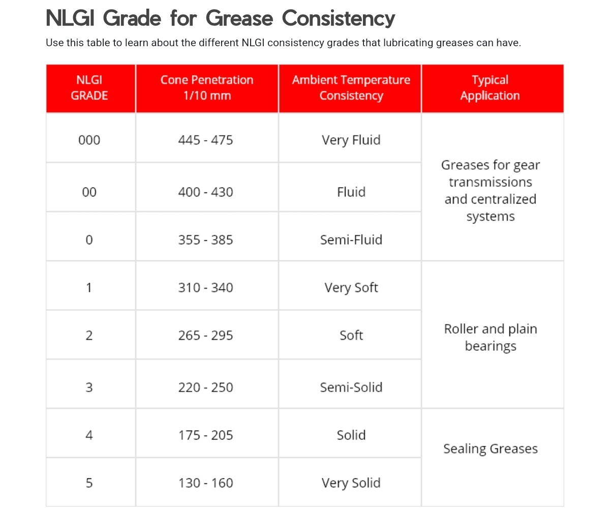

I believe I've posted similar somewhere on here....
Cornhead Grease is NLGI Grade 0
Mobil SHC100 is NLGI Grade 2
Neither could be categorized as a heavy grease and the Mobil is very close in viscosity to the factory grease.
The only issue with using the cornhead is that the gear box on the Ultra is not a sealed unit and the controller electronics don't have much of a barrier between them and the gears.
Assumption here.. but that may be one reason why the factory chose the viscosity they did.

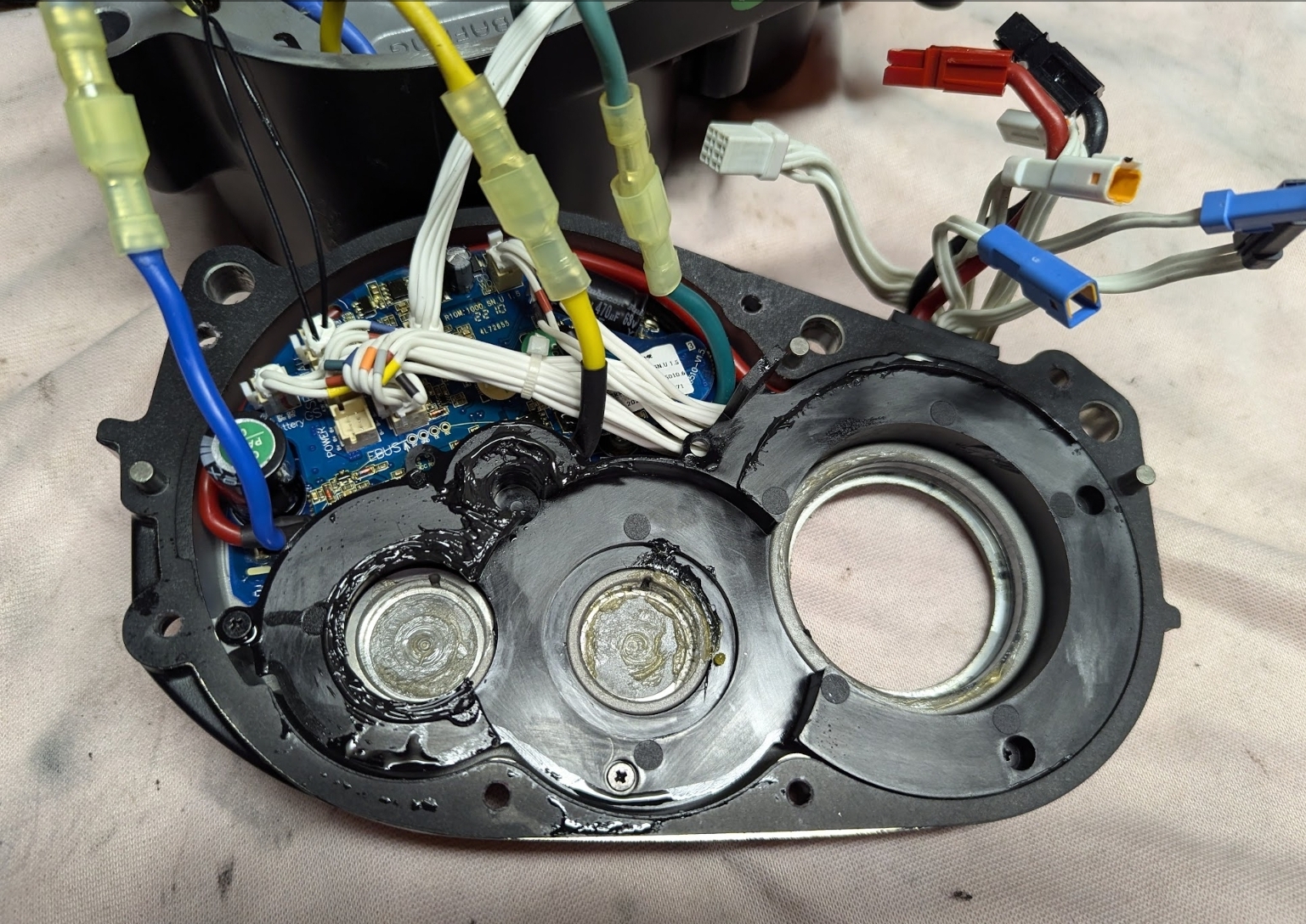

Look at the photos in post #150
A barrier between the board and gears won't be pretty or easily implemented as space is tight.
I've thought about using an insulating clay but it may be more trouble than it's worth.
The Mobil SHC100 did not migrate at all.
And I'm starting to feel more confident about the cornhead as only under mechanical pressure ( between the teeth) does it liquify. Otherwise it stays in its thicker grease state. I've yet to hear anyone report a controller failure due to grease migration... Cornhead or other.

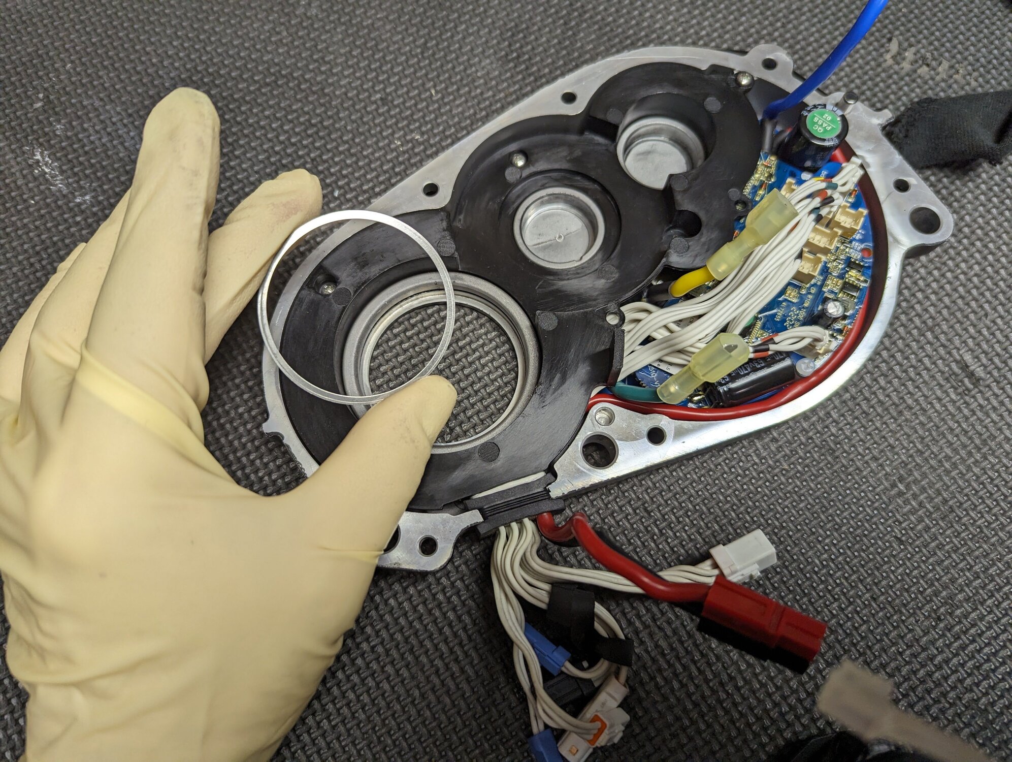

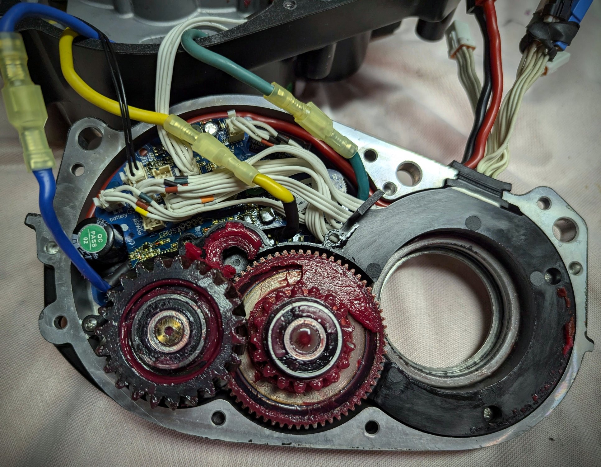

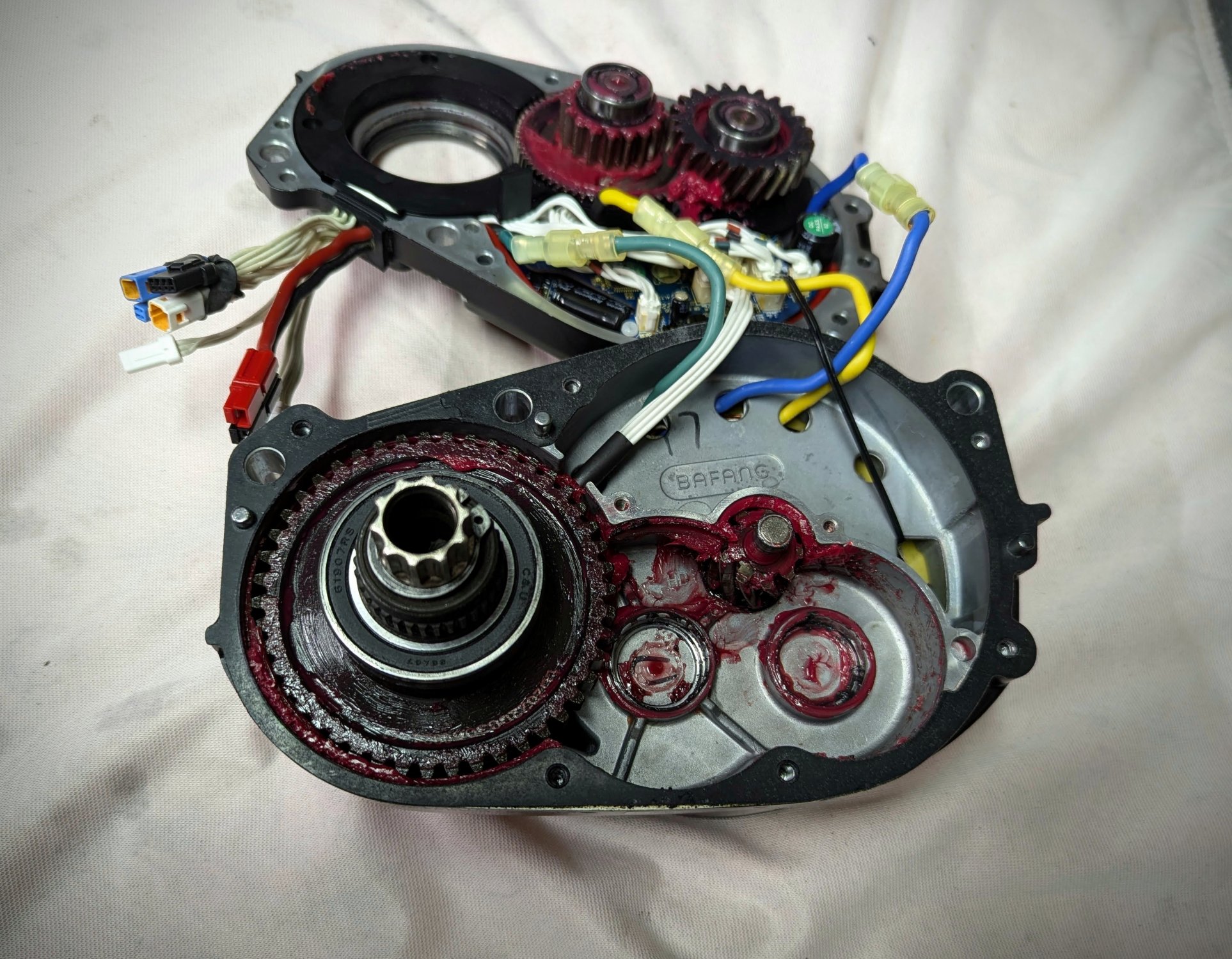

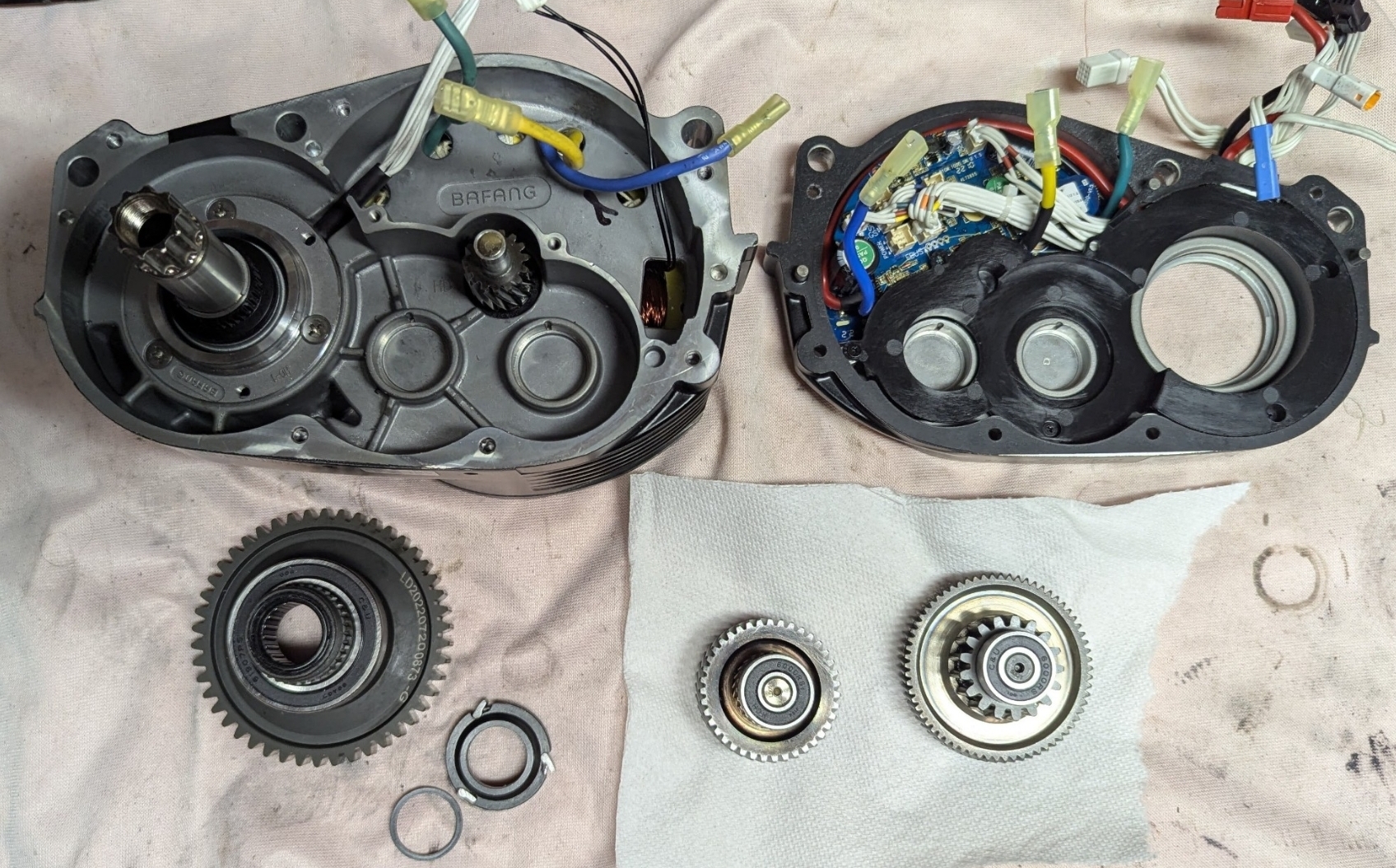

So we are currently in a very cold stretch here and I find no enjoyment in layering up to ride.... That and the MUP is a sheet of ice.
So I opened up a new Quiet Gear Ultra with just 100 miles on it...Note, I don't find it to be any quieter than my 2022 motor.
The amount of factory grease seemed adequate but was the same yellow seen before but had mostly black'nd in color and quite frankly looked burnt and wasn't easy to clean up.
So cleaning it up was tedious but with patience doable
Put back approximately the same amount of Cornhead grease and about the same as I had used on the 2022 motor when I used the Mobile SHC100
I found the Cornhead very hard to work with and to be neat with. It has a very tacky property and it's like working with snot.
This also lead me down the path of making a mistake. Not wanting to have two very different greases in the motor I also lifted the main large gear to lube the pawl clutch with the cornhead. And though I used as thin a layer as possible.. When reassembled the pawl clutch didn't work correctly due to the tackyness of the grease. Luckily I bench tested it and found out then. So I cleaned it up again and used some Mobil SHC100 which didn't give me the same problem. The greases are far enough apart so they shouldn't contaminate each other (hopefully)
This now done its still not favorable outside to ride and the temperature still hasn't risen above freezing. Hopefully it'll change soon and I'll get out in the next week.
First impression.. If the cornhead doesn't provide a much quieter motor, I'll stick with the Mobil.
