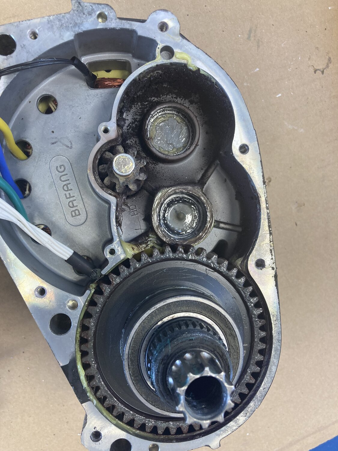

Off hand, the gear profile. Someone already mentioned a problem. The pictures of your motor's gears doesn't look good. The black goo looks to be made of iron and grease.
I turned the case upside down and the gears fell out and I'm wondering the heck the black stuff is. Wear from the gears?
I sent the photos to Pushkar, via email. I hope he responds.
I presume you've touched the "black stuff", rolled it between your fingers? Is it metallic, granular, magnetic? I do know that on steel gear components, during the "break in" interval, newly machined gears will lose microscopic particles as part of the "last fine filing". I did not notice that much black stuff when I greased my Ultra at 500 miles. When I take a second look at my original pics, there may have been a little.

Gionnirocket, that could be a possibility. I haven't ridden the bike in the rain, but I've washed it a number of times and a small amount of water could have leaked into the motor from the top hole where the battery cable goes into the housing. I silicone sealed it, but some moisture could have leaked through.
Tom, I think that's what I'll do, but I'm still considering replacing some or all of the gears. Unfortunately, replacing the gears won't be cheap.

I would definitely replace at a minimum the worn gear and it's adjacent... Probably best to do all three and start fresh and well lubricated.
The 'black stuff' didn't feel gritty, but when I put a small piece of paper towel, with some of the 'black stuff' on it, the piece of towel 'stuck' to the magnet, so there's definitely metal shaving in the 'black stuff'.

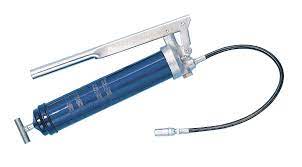

It would be cool to install a Zerk fitting. Then you could just pump it with grease without removing and opening the motor each time. Just like a John Deer tractor. You could use walk assist (without the chain on the ring) while pumping it. You would need to pick a spot for the fitting that is exactly the depth of the threads.

Greasing a motors drive gears is a bit different than a tractors bearings, bushings and other parts.
The proper amount of grease needs to be applied to the appropriate location (teeth) of the gears and properly distributed.
I think a visual inspection, cleaning and using the proper amount can only be done by cracking that bitch open.

It's just not the same and a totally different application and the reason you'll never see a zerk on a sealed electric motor.
And too much of a good thing... is a thing.

Pushkar says clean and grease it and put it back together. Since the bike is almost two years old I didn't ask him to send me a set of replacement gears for free, and he didn't offer.
What annoys me is it's obvious that this motor was installed on the bike with very little grease. I plan on taking my Hydra's motor apart to re-grease the gears.
Taking the motor out and apart isn't difficult, but if I can help it I'd rather not have to do it until it's time to re-grease the gears again in a year, or two, or three.
