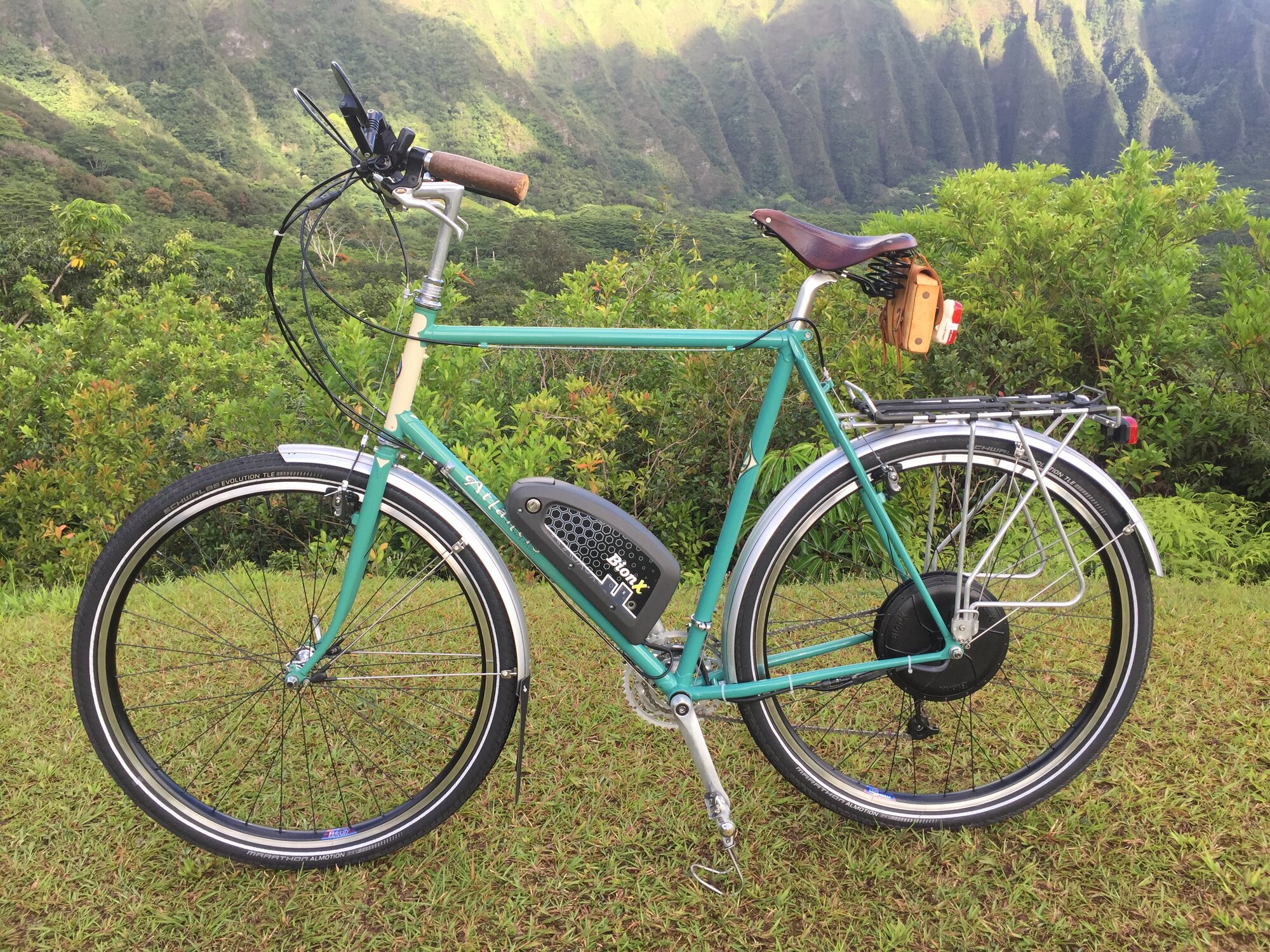

Hi everyone,
I'm 52 and cycling has been one of my life long interest. I live on the east side of Oahu and have some hills to deal with. I've come to the conclusion that I'm ready for a purpose built electric bike to increase my riding enjoyment.
I have a little experience with electric motors and retrofitted a tandem. Unfortunately my wife and kids did not enjoy riding with me. That was a huge waste of money...bike and all. I also put a Bionx on a Bike Friday which ended up cracking the frame in the rear triangle. And then I transferred it over to my Rivendell Atlantis. The Bionx system is good but I rarely used it. I tried it again this weekend and found it didn't have the power I want.
During vacations in Colorado I've rented a number of ebikes. My favorite by far has been the Specialized Como.
Giving that these bikes are in short supply I just purchased a current model Como 4 in XL from the Specialized website. I would prefer to current year Como 5 but don't know the current supply situation. Do the Como 5 models come up for sale often on the website?
The battery of the 4 will be fine since my rides are not that long. I'm more interested in the more powerful motor on the 5. Is the power and speed a noticeable increase between the two?
Thanks,
Dave

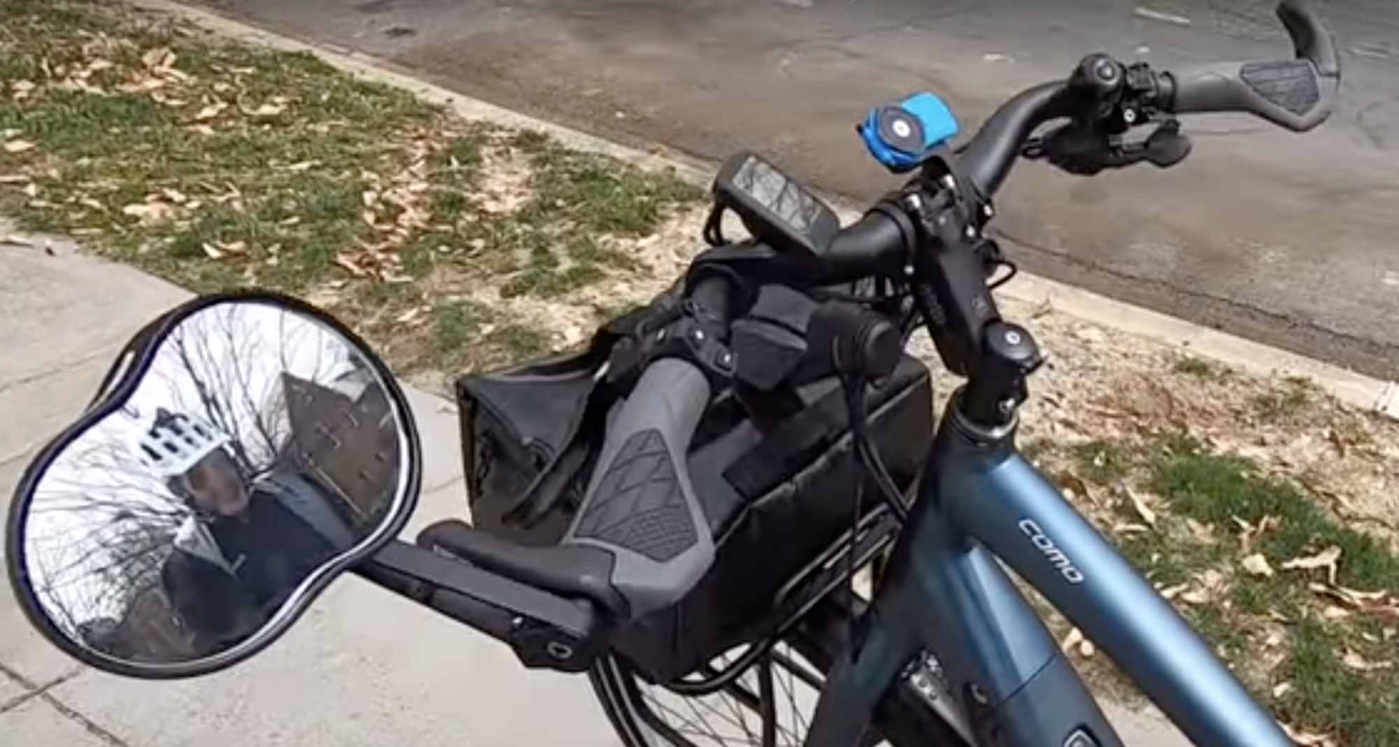

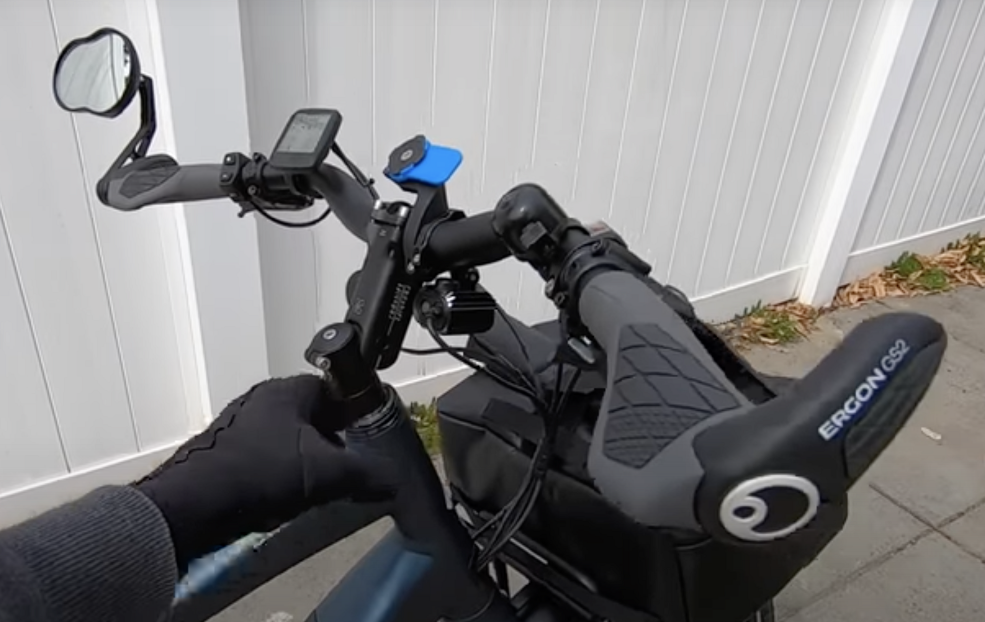

I really like a good mirror. Anybody know what kind of mirror Charlie uses on his Como? (See attached photo)
How about those grips he uses? They look sweet. He uses the GS2 model. The GS3 is slightly longer. Has anyone handled these in a store and have a preference?
Thanks

I found out that the mirror I was asking about in the above post is made by Ergotec.

We went with the GCS-3 Large purchased from this Ebay seller. About $20 cheaper than Amazon: https://www.ebay.com/itm/202810351014
So far very happy with them.
