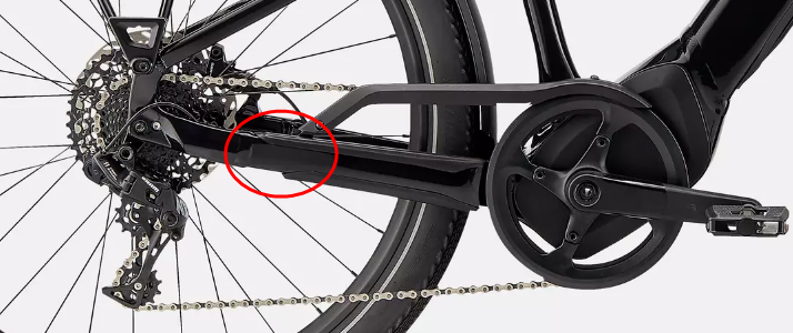

Maybe try shorter cranks if training your legs won't work. Or lesser shoes

I really cannot understand how that can happen... If I ever get heel strikes, it is on some ill designed panniers I own but not on the chainstay... Do you have big feet perhaps?
That was what I thoughtI deleted the bike from the app and started fresh, and that worked. I also had to hit the + button to complete the pairing, which the app & bike didn't tell me, whoops. When all else fails, check the manual ...
The sole of my shoe is 32 cm, so my foot is shorter. You could really try wider pedals!Perhaps.I wear US size 13, Euro size 46. My shoe is 13" = 33cm long. I'm not using clipless but I locate the shoe just about where it would be if I was -- with the pedal centered a bit behind the ball of my foot. I'll try moving my foot forward but that's how I've always run.

I think I bought mine from someone in the US, and don't remember any issues with breaking. The one issue I had was the extender with the left hand threads, the die was wearing to the point the spacer was difficult to thread into the crank arm. Figured the machinist didn't want to trade it out for a new one as they are probably not cheap being left hand.I got myself some 20mm extenders, and I was disappointed that they didn't help much. I still caught my heel on the plastic chainstay cover.
Then I realized I tend to rest my foot right against the crank arm! Which kinda defeats the purpose of the spacers. So now I make an effort to keep my foot centered on the pedal, and no more heel-strike problems.
It was interesting that basically every extender I saw on Amazon -- at least those that had more than 20-30 reviews -- got complaints that the extender had sheared off and caused a crash. I'm not too worried, because I assume that was caused by people who crank a lot more horsepower through their pedals than I do / can. Probably when they were standing on the pedals and powering up a hill. Since the Vado's motor does a lot (most??) of the cranking, I'm sure my chances of breaking the extenders are slim.![]()
