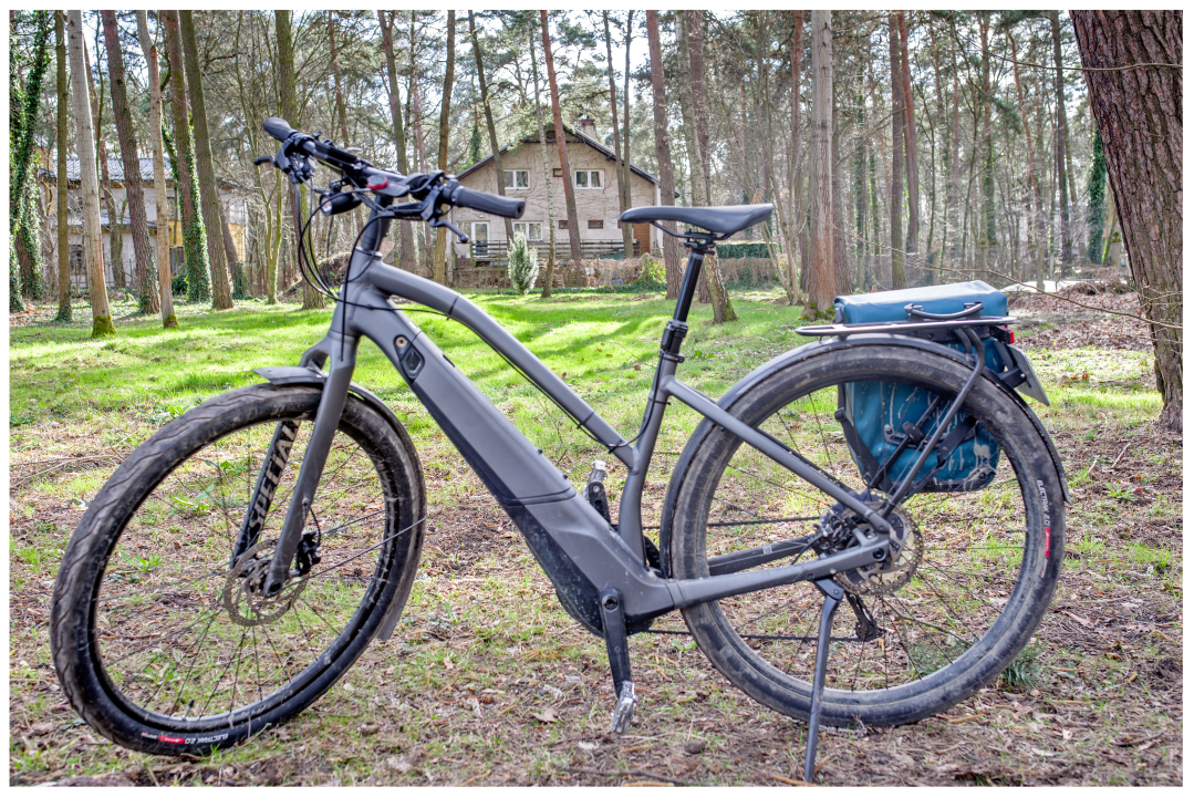

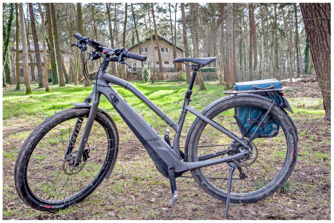

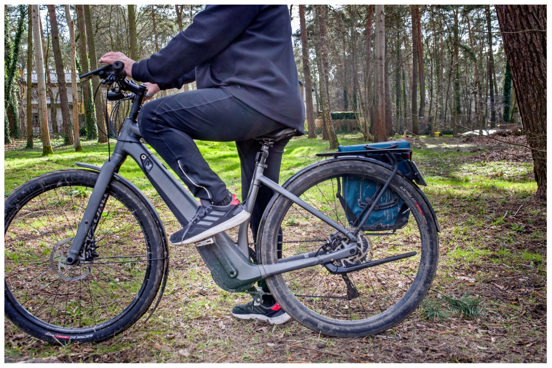

PNW Coast in the low position.

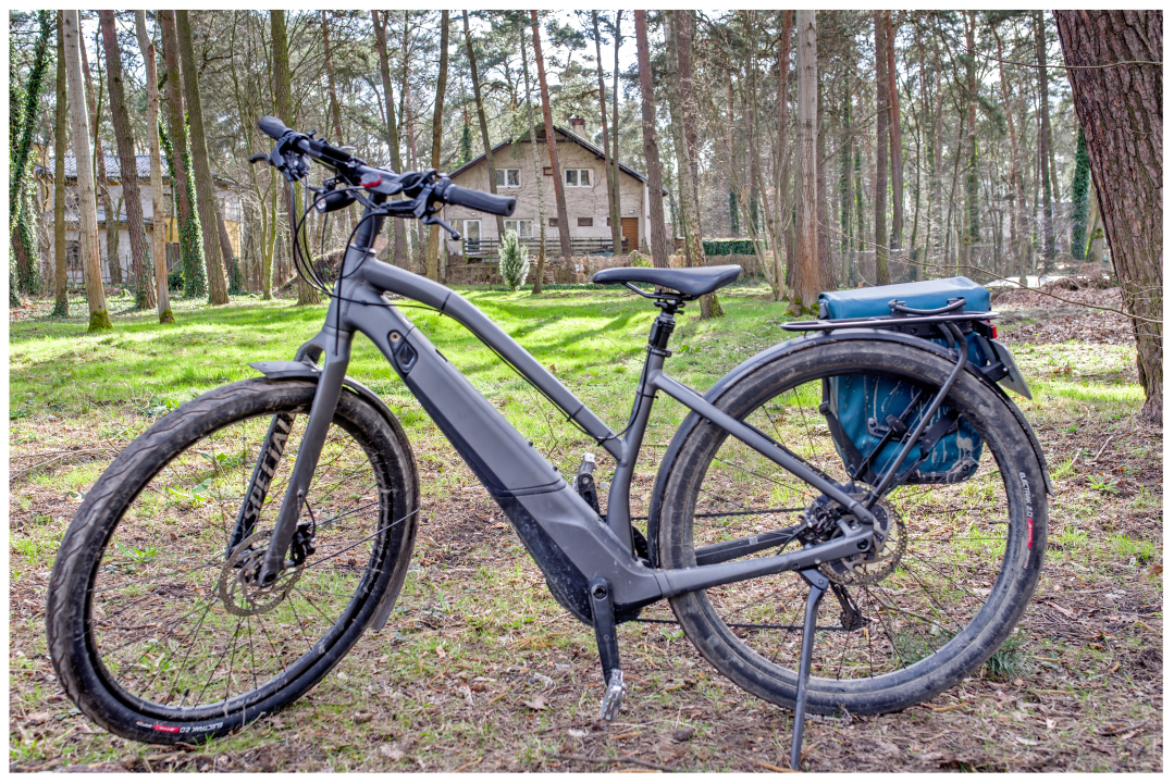

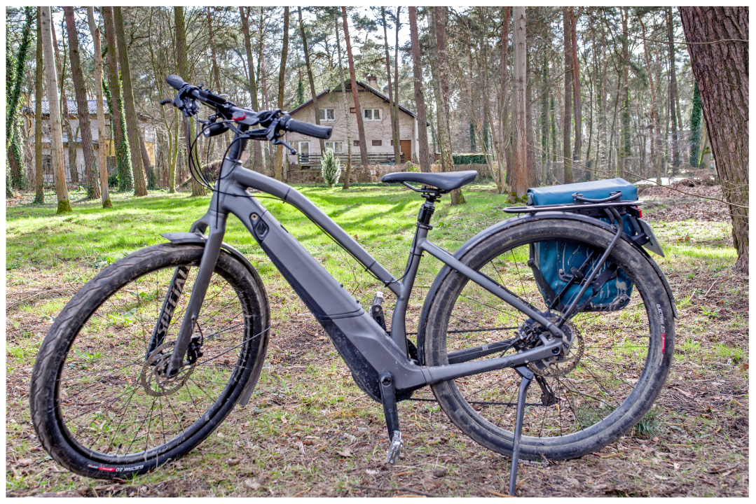

The PNW Coast in the riding position.

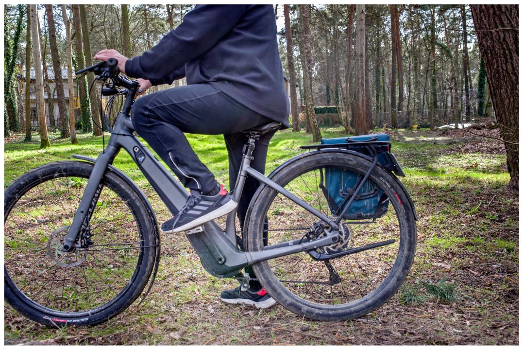

Standing in the "ready to ride" position, as if waiting for the signal change.

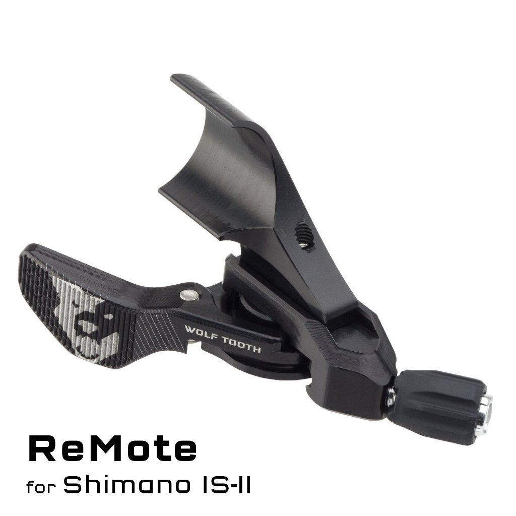

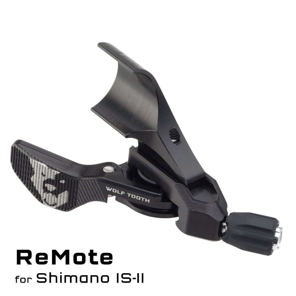

Stephan, With my PNW Coast dropper, I used the Wolftooth (Shimano IS II version) dropper lever that mounts under and is held in place by the clamp on my left side Shimano brake lever and hangs below the handlebar. It is just an easy thumb push away. Their mechanism has a small ball bearing for consistent, smooth operation of the lever.
