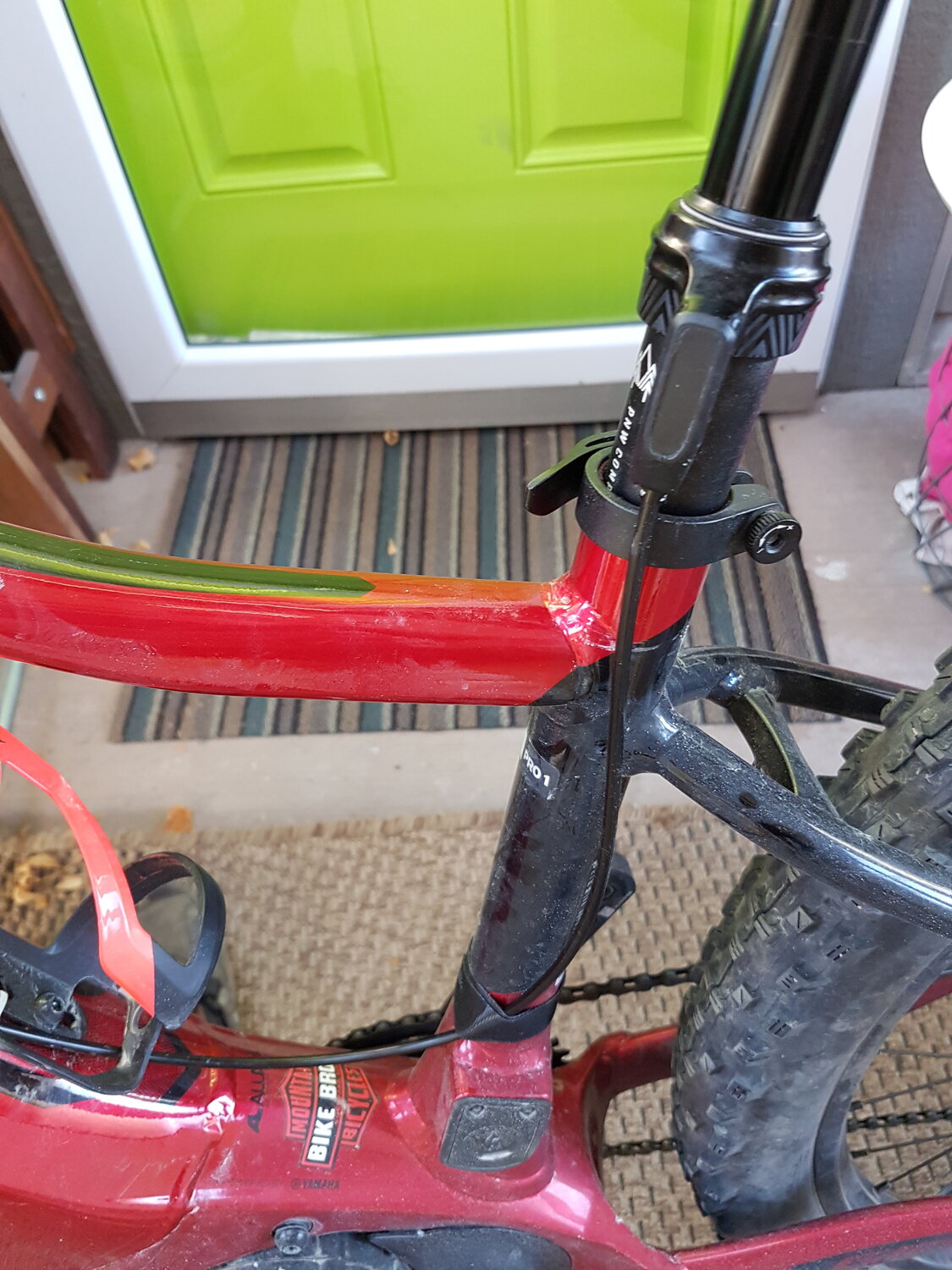

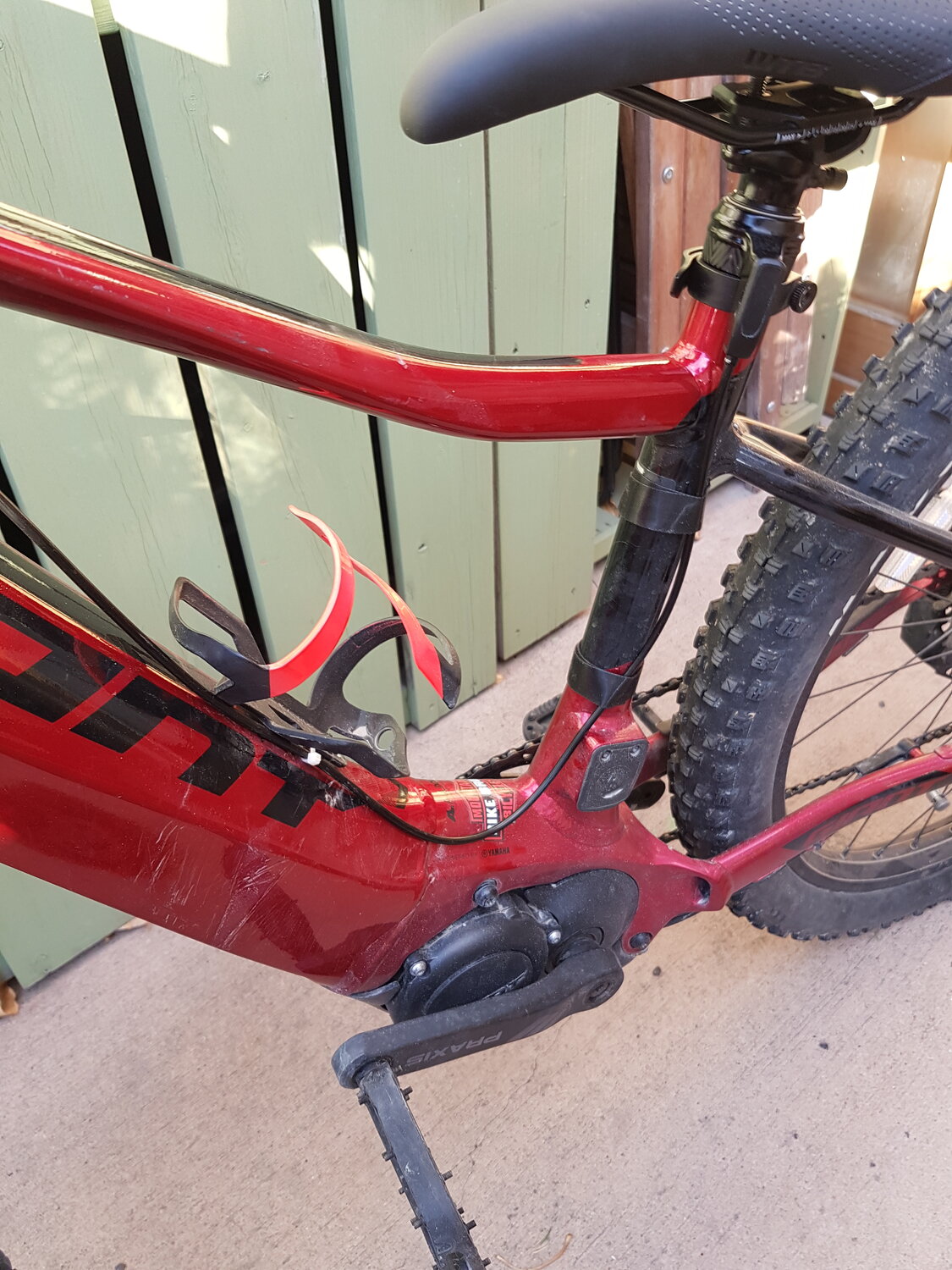

PNW Coast review and recommendations.
@Stefan Mikes graciously gave me his dropper as he wasn't using it (went with a different one).
For reference, I'm 5'7" with 30" inseam.
I installed it on my HT Fathom, and I will readily admit that for both urban rides and trail/MTB rides, it's a fantastic device.
The suspension is nowhere as good as my Suntour NCX, but it's passable and does help a little on the bigger bumps.
I'm still playing with air pressures to get the right amount of suspension, without the dreaded "bobbing" while pedaling.
But the convenience of dropping the seat at ANY stop, whether it be at a traffic light or road crossing, or halfway up a slope (for whatever reason) it's something that I don't think I will EVER ride without again.
Heck, I've ridden down some sketchy slopes lately, covered in snow and ice, with both feet down for stability, and not felt the least bit concerned about safety. With the photo below, the steepness doesn't show up, and I did a lovely skid turn at the switchback halfway down. :cool:

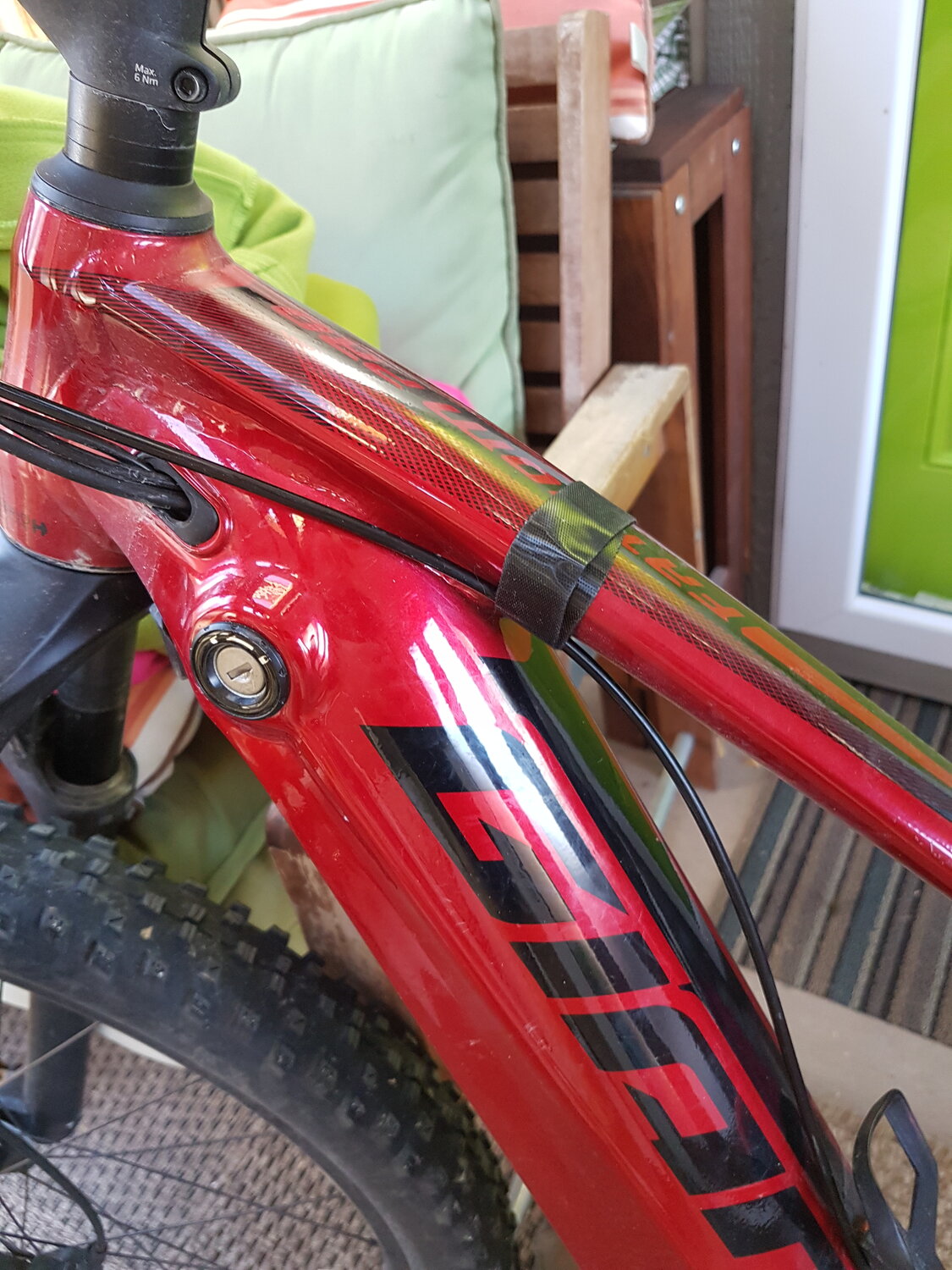

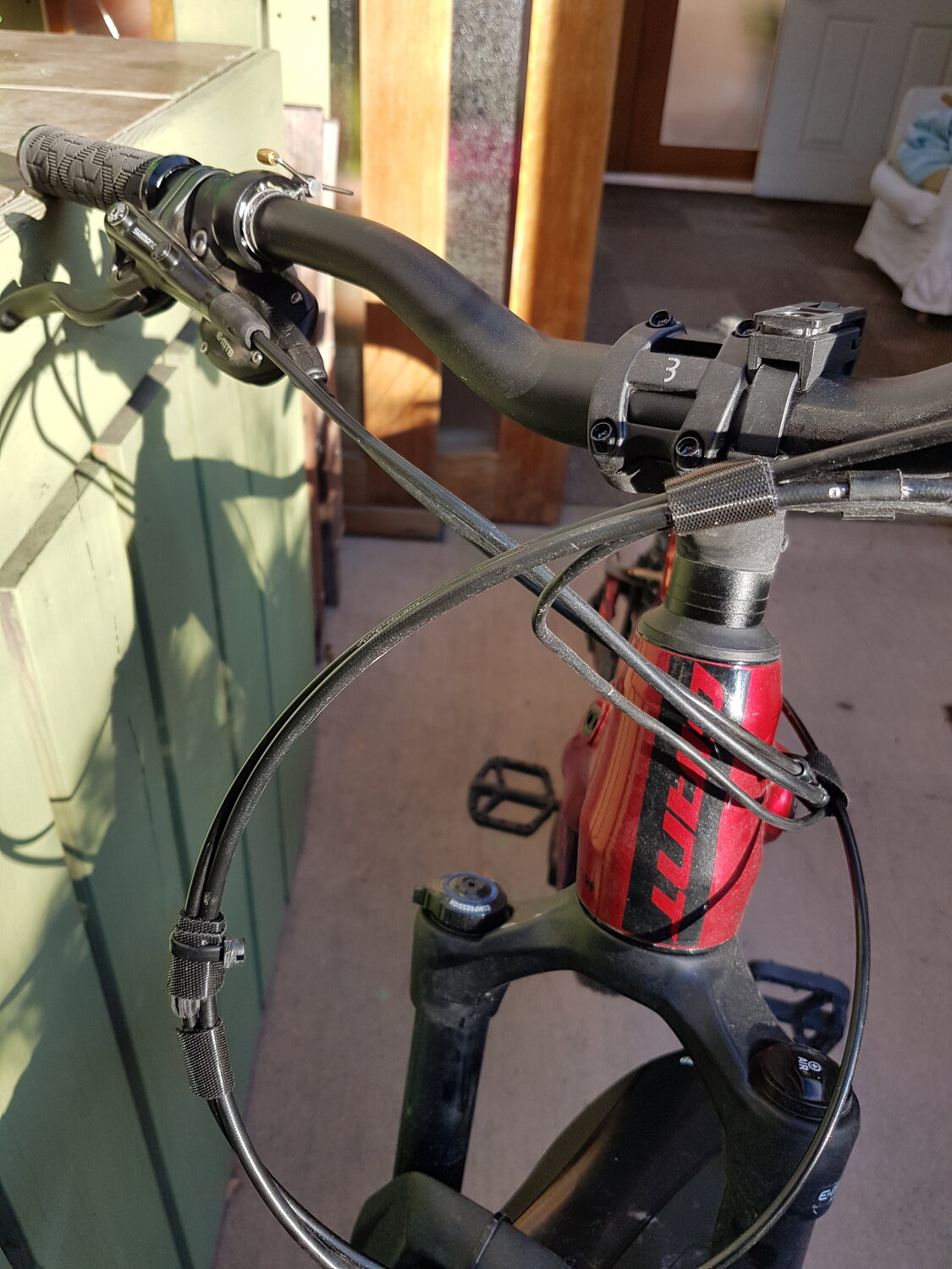

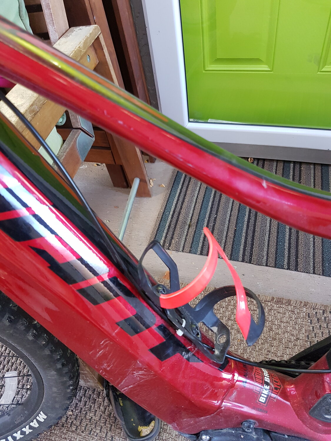

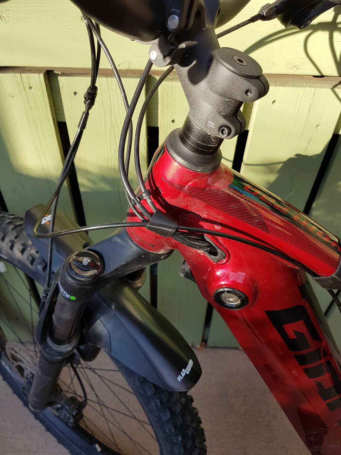

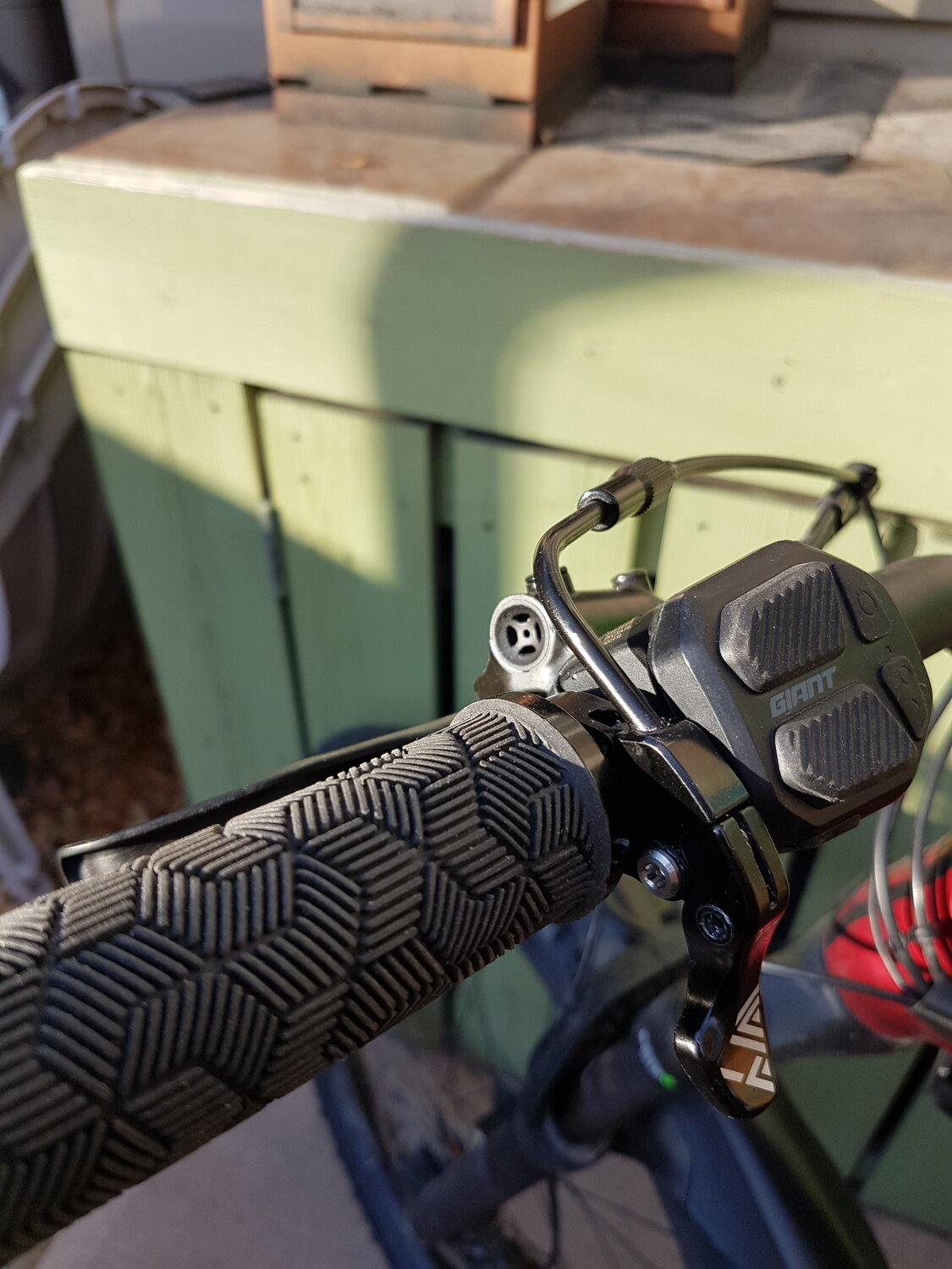

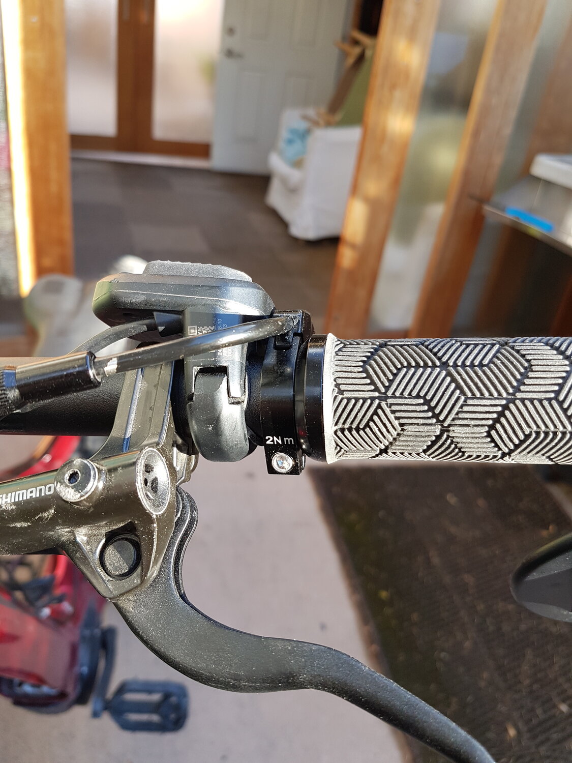

Installing the dropper was pretty easy, and I would strongly suggest you reconsider the actuator location.
Externally routed cable, and a switch on the handlebars will allow you to operate the seat without taking your hands of the handlebars and away from the brake..
I don't use cable ties (pictures may show a couple, but they've been removed) - I use hook and loop tape (Velcro) and it allows me to remove everything in a couple of minutes should I want to.
.View attachment 72519View attachment 72520View attachment 72521View attachment 72522View attachment 72523View attachment 72524View attachment 72525View attachment 72526
Good luck with whatever you decide - I am of the opinion that your desire for a dropper is absolutely spot on - but, in my opinion, I'd rethink the control method and move to a lever.

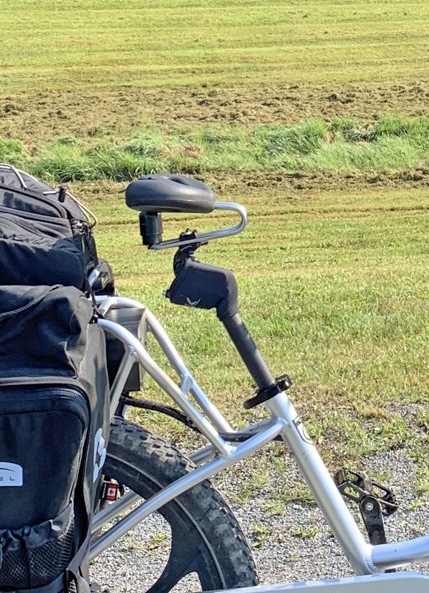

I use the PNW Coast on my Riese & Muller Delite Mountain. Given that the bike already has a very good Fox suspension, I am not looking to the post to provide a robust suspension effect. I have it pumped up to the point that it mostly remains solid and only engages, giving me an added 30mm of compliance when I impact a larger flaw in my path, helping the bike's suspension take the sting out of a big rut or pothole.

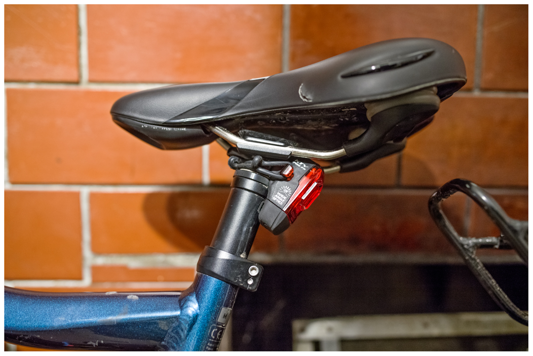

You may want to add an angled shim to position the rear light beam parallel to the road. ;)
That is a rather unfortunate situation I avoid. Normally, the rear light is positioned on the post tube and the beam points in the proper direction (yes, an additional rubber wedge has been provided if needed) but I slammed the seat to the very bottom (which I normally don't do) and the light slid up too much.
