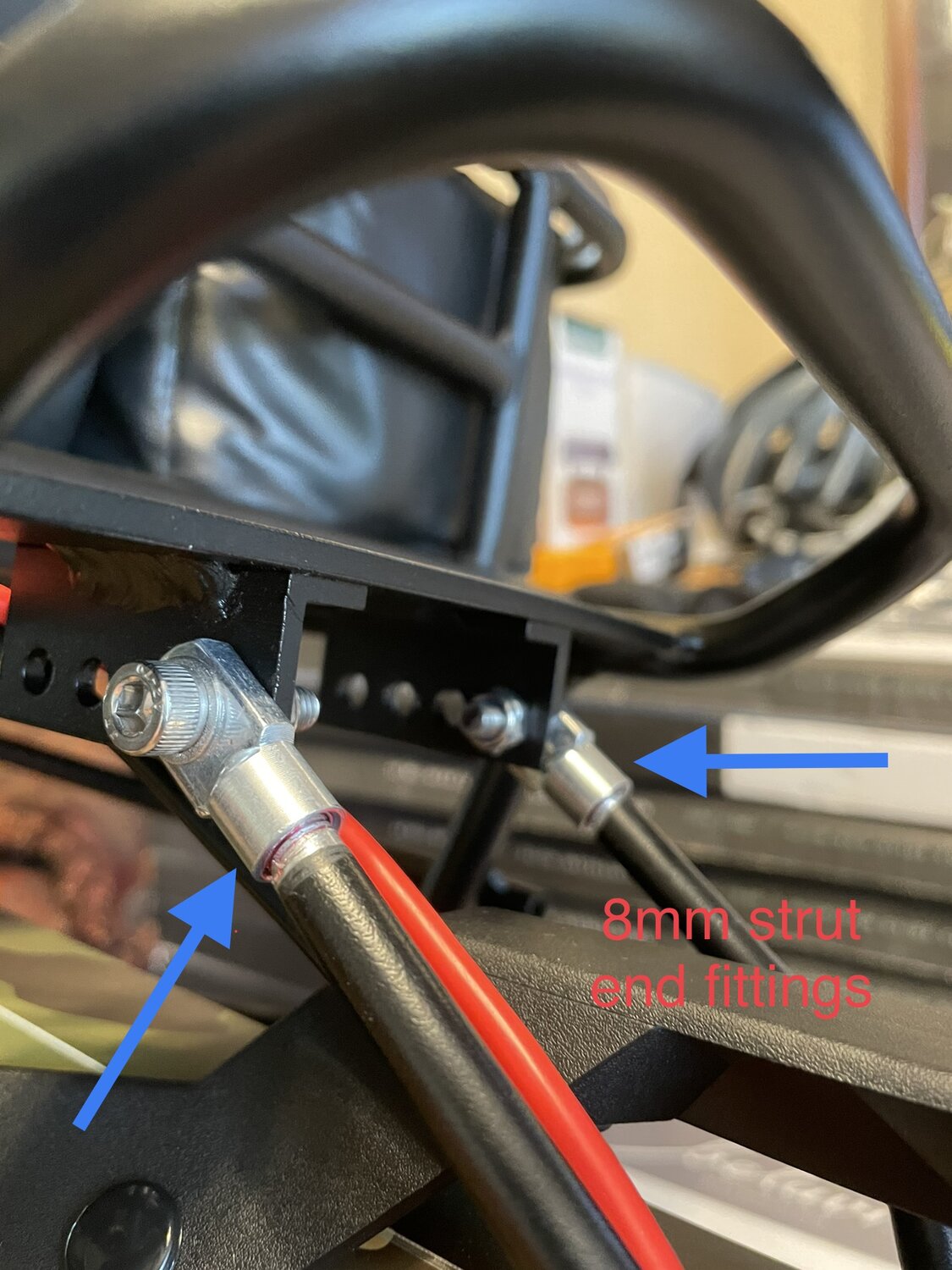

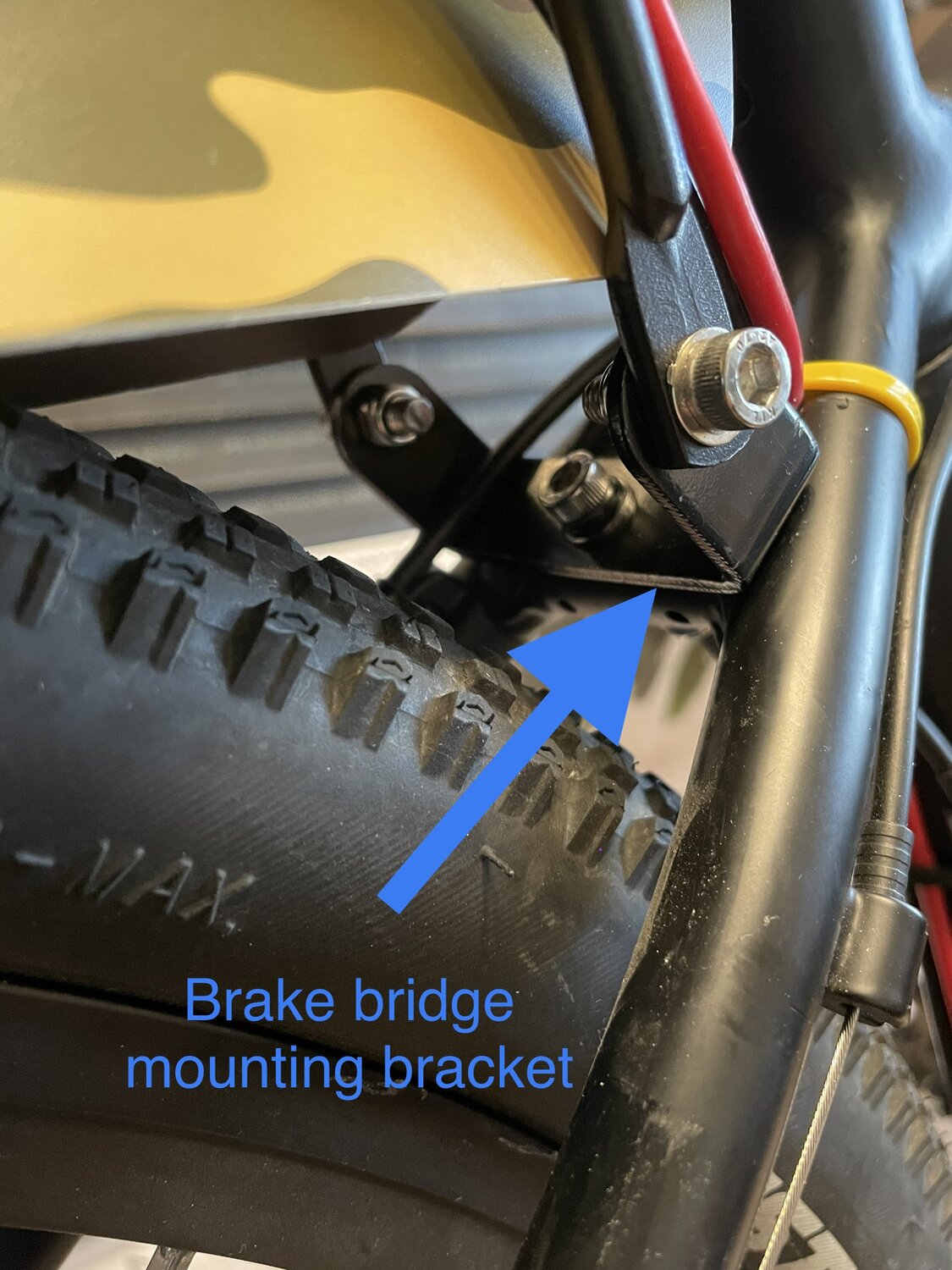

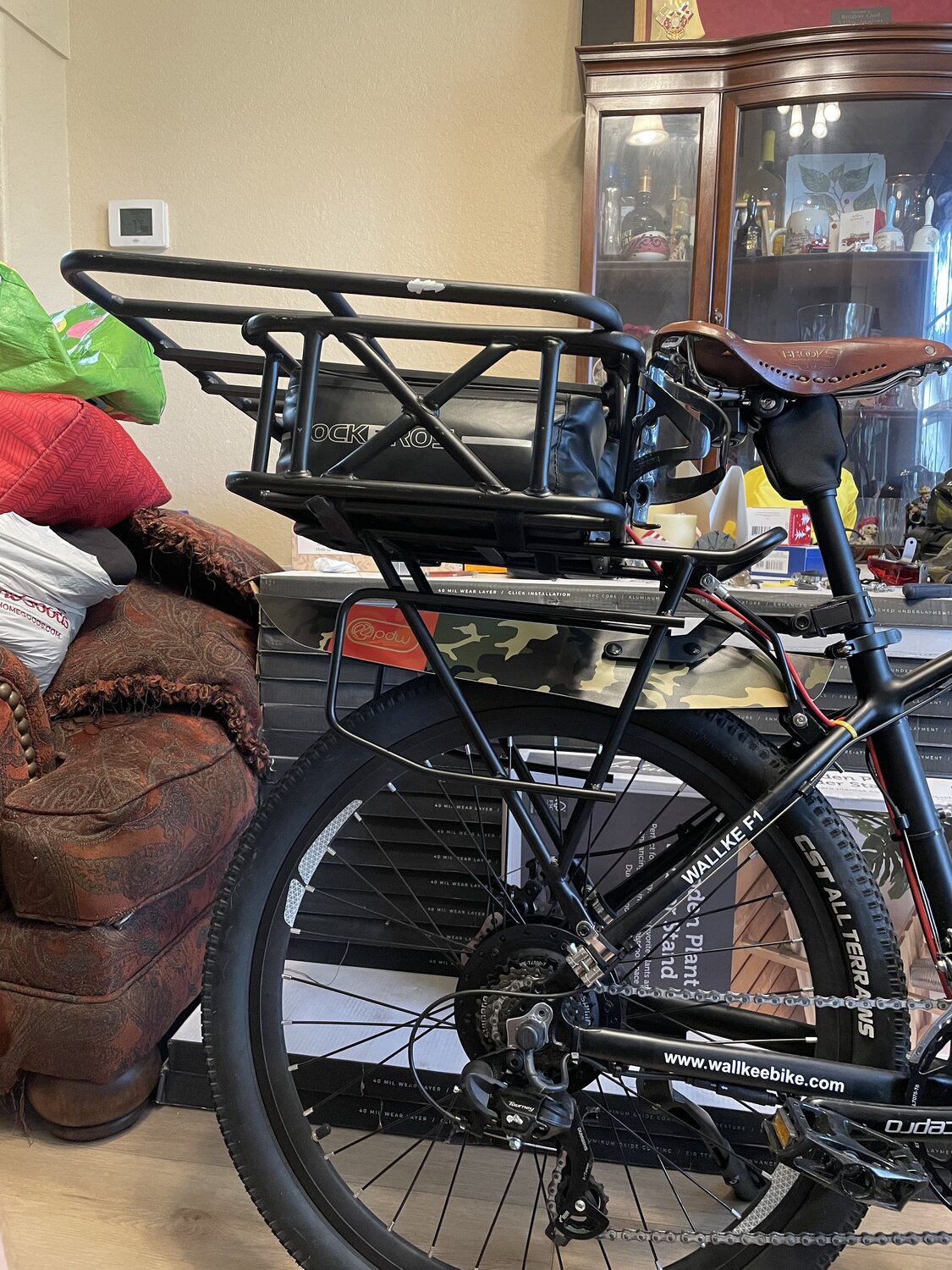

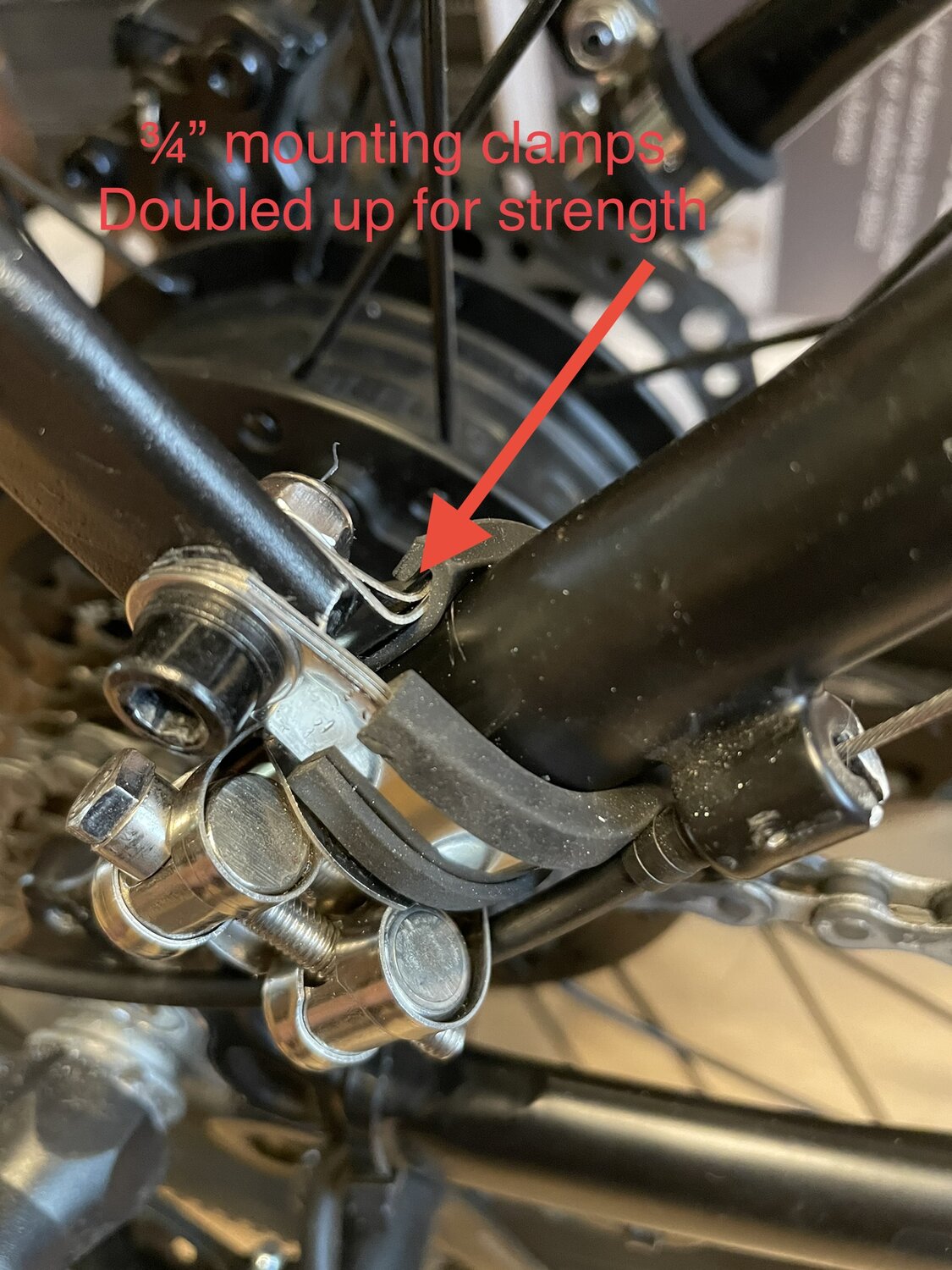

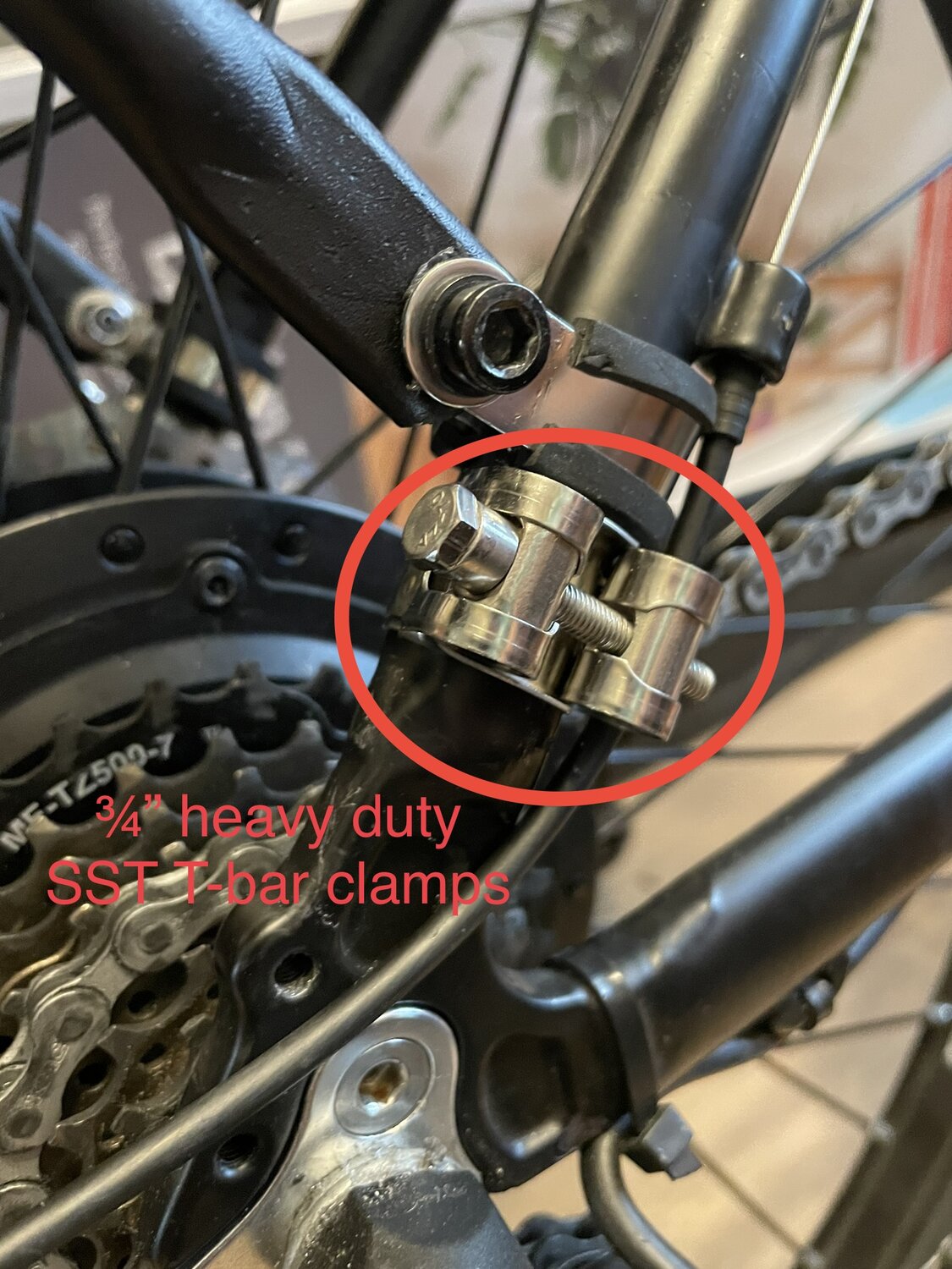

I have a Wallke F1 which has no braze-ons for a rear rack. I’ve tried a couple racks. I finally ended up with a Rambo Extra Large Luggage Rack. It fits extremely well and clears the rotor and cables. Just like with any bike without built-in rack mounts it requires coming up with attachment hardware. I carry a 13s8p 20ah battery and a bag with my tools, tubes, pump, lock and repair parts. I also strap a duffel bag on a platform over the battery and tool bag. I carry a fair amount of weight so the rack has to mount securely. I got all the hardware I needed from Amazon.
Rambo Rack
Upper rack mount to brake bridge bracket
Strut end fitting, 8mmx1.25 female thread and 6mm mounting hole. Strut was filed down to 7.87mm diameter and treaded with a Hanson M8x1.25mm Die from Ace Hardware.
¾” rubber insulated stainless steel clamps. Double stacked to increase strength/rigidity.
¾” stainless steel T-bolt HD hose clamps. used as a stop to prevent lower mounting clamps to creep down seat stays with heavy rack load.
See photos for visual aids for the install. I drilled where necessary to use the larger stainless bolts supplied with the Rambo rack.
