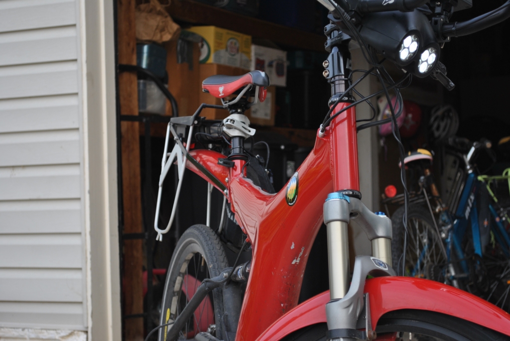

Also, about Opti being dated...it is an engineering feat and very stable. The power and battery capacity at 60lbs is amazing. The style is ok for me. They do need a removable battery, PAS, and an upgraded dispay, but the R series are a solid build.
I also designed a jig to allow a double bar bike rack support for my opti.

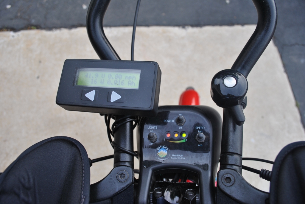

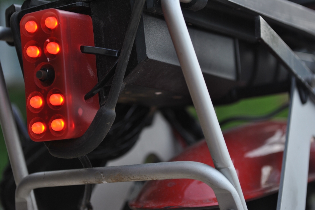

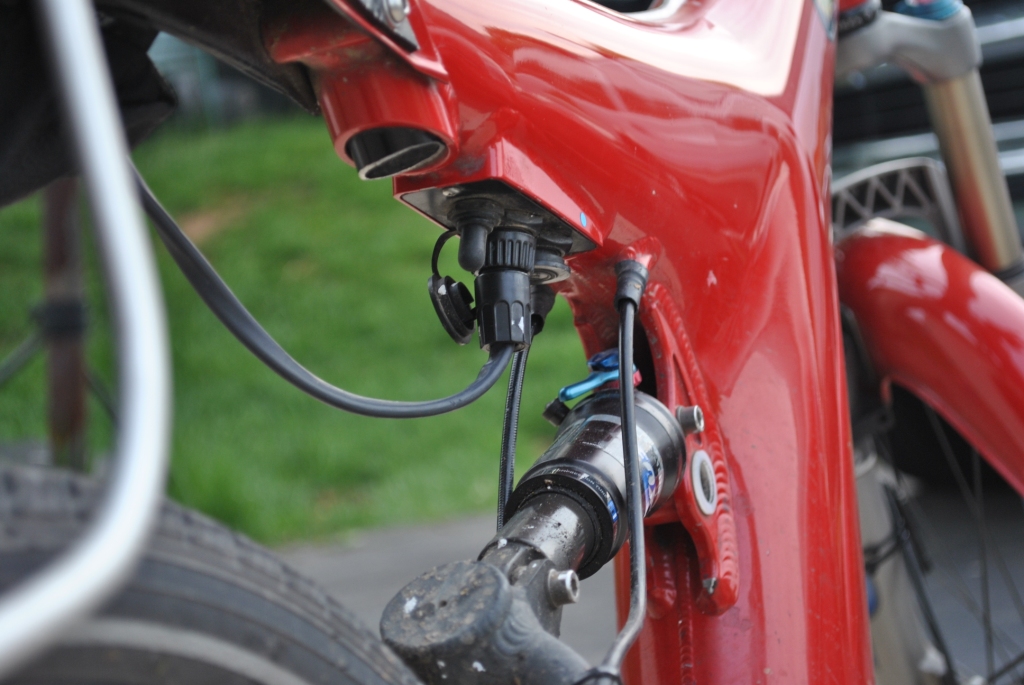

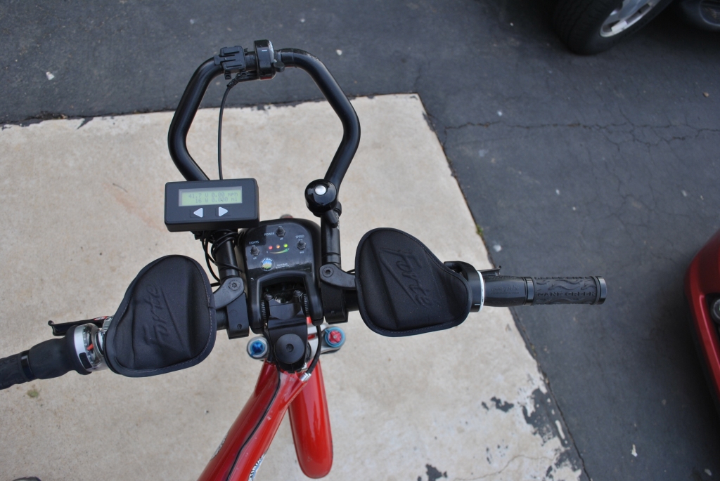

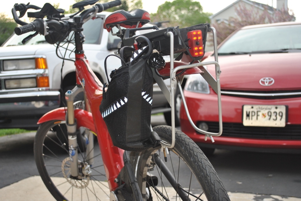

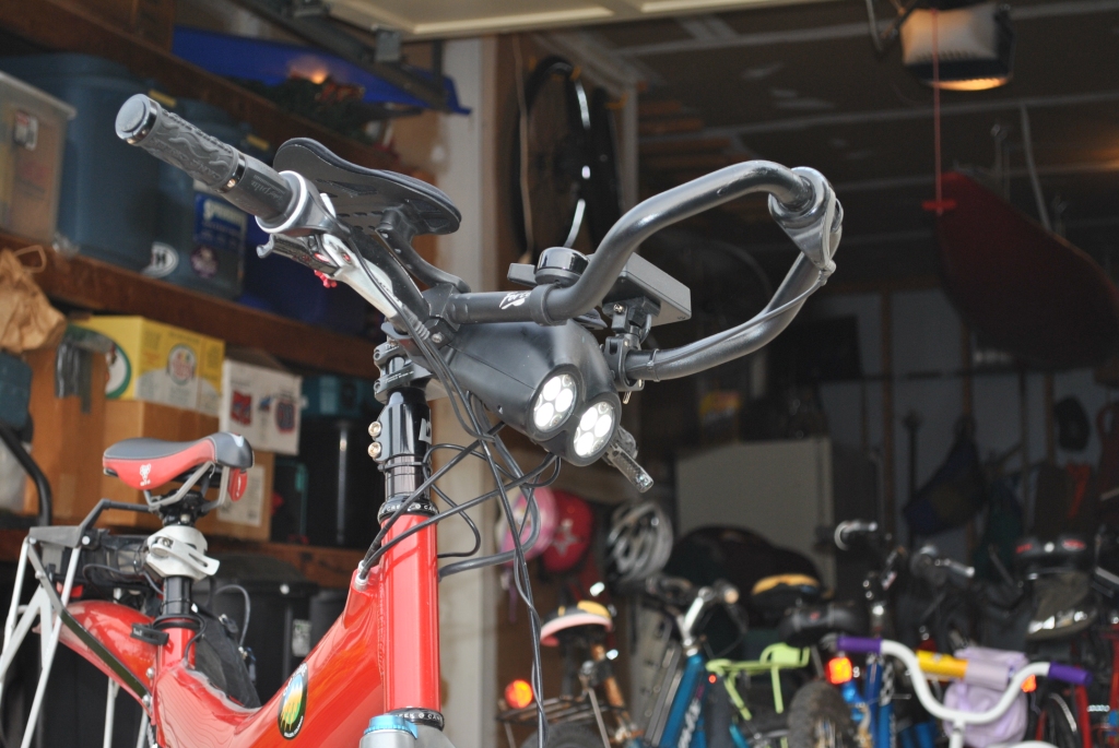

@Bike_On could you post details on how you wired a Cycle Analyst into this Optibike? We have no wiring diagram for the Optibike 600.
Also I see stabilizer bars for the Topeak seat rack, great idea! Did you add those or do those bars come with the Topeak pannier frame from Optibike?
Thanks, Mark
2008 Optibike 850Li with aero bars, throttle, spare battery, LED lights, wired tail light and cycle analyst. circa 2010.
