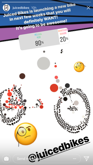

Was this posted publicly? Don't see it on FB or ig.
Assuming this is true... very cool. Funny how they can barely keep stuff in stock but that doesn't deter them from doing new models.
I'm guessing it will be a mountain bike. They don't have any in their range, so it would be an obvious hole to fill. Then again, that may require a mid drive and they haven't used one before.
