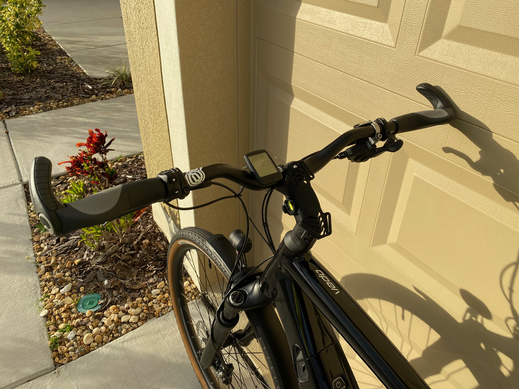

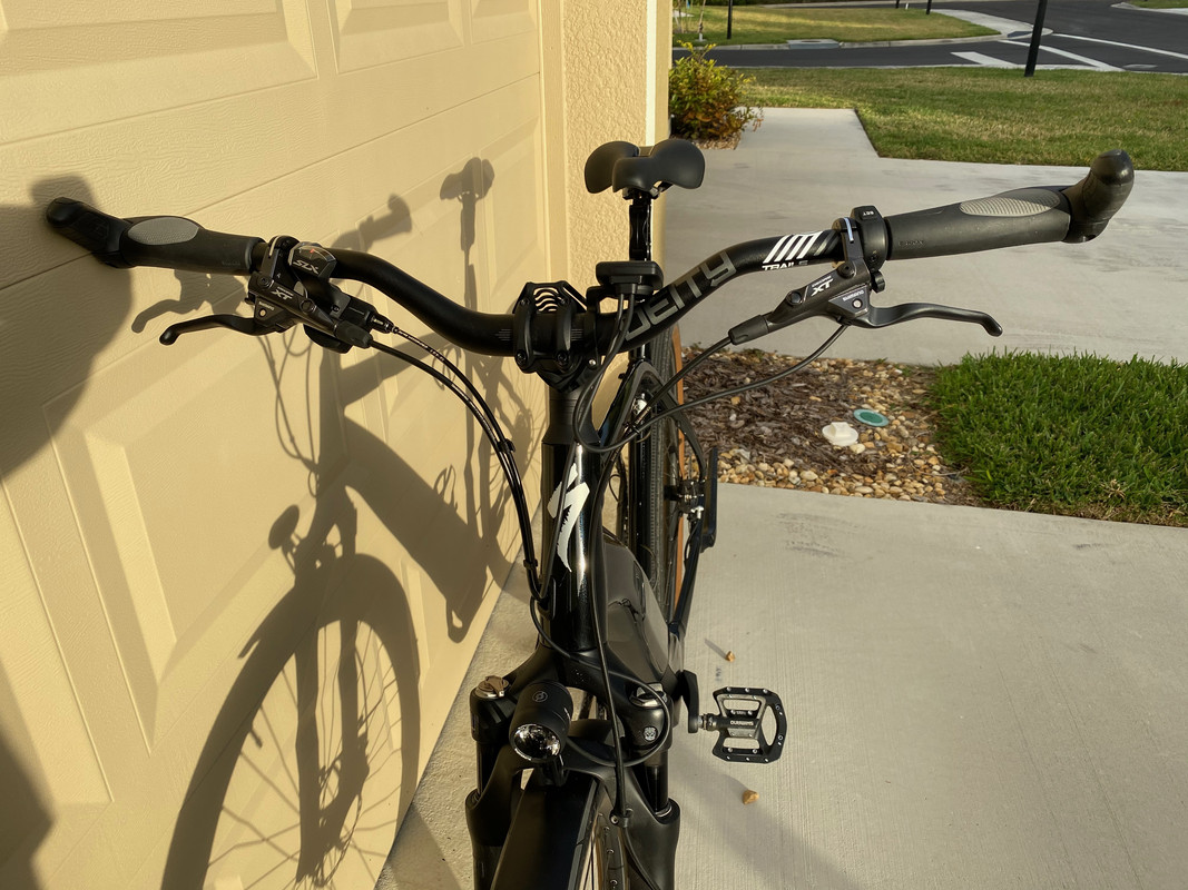

So I decided to put the Deity Highside 50mm riser bars on today. I cut 30mm off each side to make the width the same as the stock Vado bars.
The difference with that extra 35mm rise was immediately VERY noticeable, and it really took the strain off my palms and wrists.
The bike handles slightly differently now, not as quick in the turns, so that'll take a minute to get used too.
I missed your post, Dan. Did you get rid of the rear-view mirror? Although I personally feel strain on wrists and arms, I always ride with my fingers near to the brake levers, so that's not for me.
Stefan, I ride with two fingers on the brake levers most of the time. The sidebars of the Ergon grips give me another hand position I use occasionally on straights to give my palms a rest. The only thing the bars did was raise my hand position by 35mm, which eased the pressure on my palms and wrists.
I didn’t have a mirror, though I do have one from another bike I may put on.
