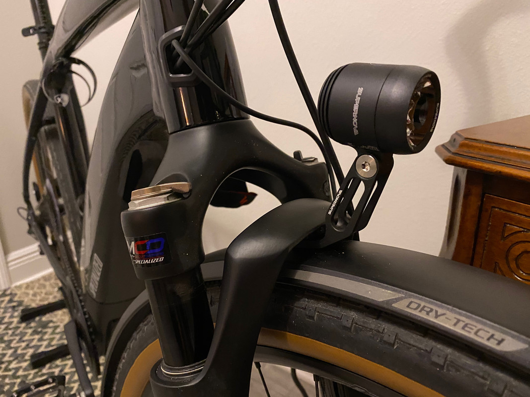

My light came mounted to the front fender. I thought it was fork mounted but on closer inspection, nope, it's the fender.

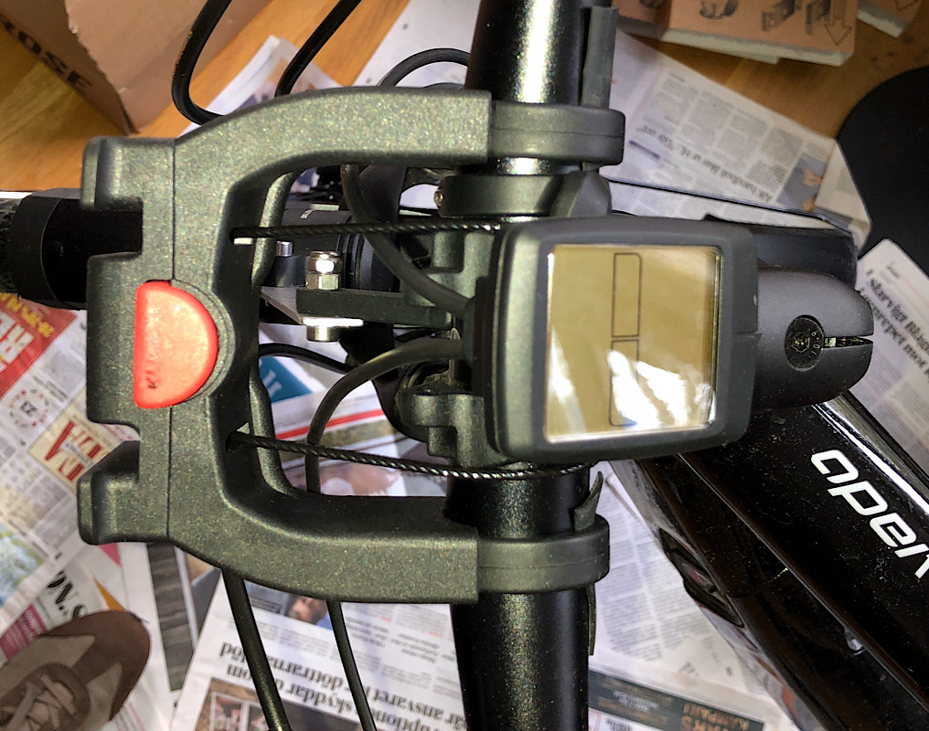

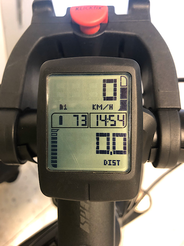

Great write up. I had similar issues as your wife with my Vado 5 during the first couple of months where the motor would stop assisting for split second. Was ok in the flats but sucked in climbs.
LBS changed the control unit monitor. Since then I had one error message when the motor stoped totally and I had to turn the bike off and then on and everything was Ok after that.
they also updated firmware. I have been trouble free since then and I have 1,500 miles on the bike riding average 5 times a week for about 20 miles.

Could the position of the front light depend on the amount of vibration from road on fork, fender, and handlebar?
to me handlebar would have least amount of vibration hence more stable light.
please correct me if wrong.
Nxkharra,
I would imagine that mounting a light to the fender would introduce more vibration. Perhaps that's why my early release 2020 Vado has the light mounted to the handlebar stem. They did change it to fender mount, regardless of vibration, sometime after our bikes were delivered. I'm guessing customer feedback played a role here.
Ebikes without front shocks end up mounting front lights to the frame, often on the fork; https://www.giant-bicycles.com/us/fastroad-eplus-ex-pro-2020. I'd guess the vibration here is similar to the fender-mounted position?

The Specialized site still shows the picture of Vado 5 with light mounted on handlebar.
is this the newer 2020 or older 2020?
i purchased mine in Oct 2019 and the light is on handlebar (assume this is early release of 2020)..
DanInStPete must have the newer version.
The Specialized info is confusing; their pics show a handlebar mounted light but the specs call out a fender mount.
Our Vados were delivered in early May 2019 just after they were available to our LBS. They both have the handlebar mounted light. My best guess is that you're right, DanInStPete probably got the new version. I'd suggest checking with your LBS to be sure.

Sierratim, thank you for this detail, much appreciated. I think I will make this upgrade soon.
My bike was ordered from Specialized just before Christmas so it appears the fender mount is the new standard issue.

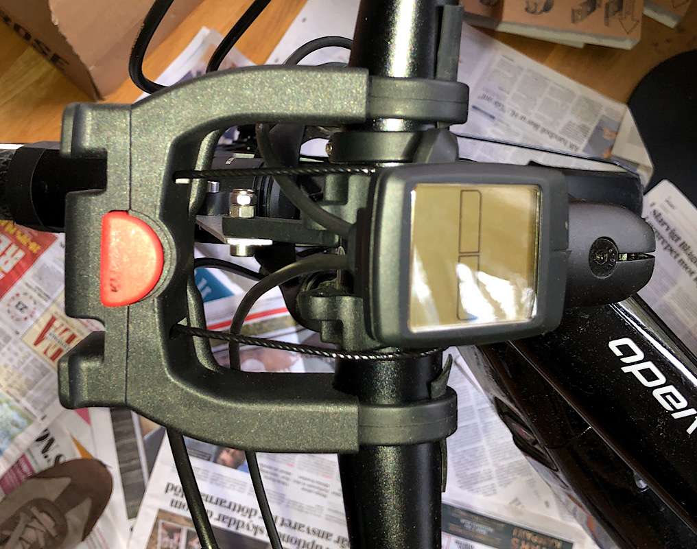

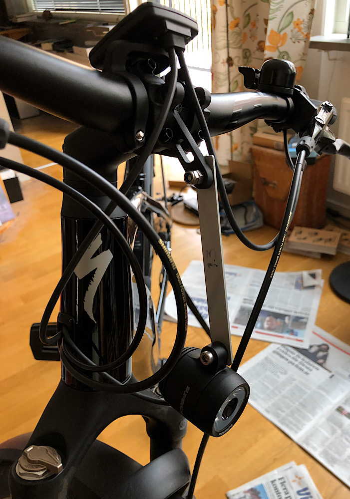

Our Vados have the headlamp mounted to an extension off the handlebar stem. This prevents using a handlebar bag. It would be preferable to mount the light on the fork crown as many competitors do. We're correcting this by mounting the light above the handlebar with extensions one of sons made for us.
I lowered the headlamp. My solution is perhaps a little bit to simple ( doesn’t even come up to MacGyver level:D) But it has worked for me. I can now use a standard lenght Klickfix/Ortlieb mount. It is the wider mount for e-bikes though.
The front of the headlamp can be unscrewed and then the lens can be rotated. The lens has some fixed positions.
43854 43855 43856
View attachment 43854 View attachment 43855 View attachment 43856

PaD,
We went the other direction. We attached an extension to a threaded tab on the stem clamp (used to attach the original Vado display/controller but now unused). This 3D printed extension provides good clearance over our handlebar bags. They're also quite rigid so there's no noticeable vibration in the light beam. This wouldn't work for your style of bags. Your solution looks to work well for you.
Your solution looks good and is more rigid than mine but surprisingly I don’t have much vobration. My starting point was the bag I had and was used to. Your handlebar bag sits lower than mine and that is probably an advantage however I don’t put much in mine even if can carry 10-11 lb.
