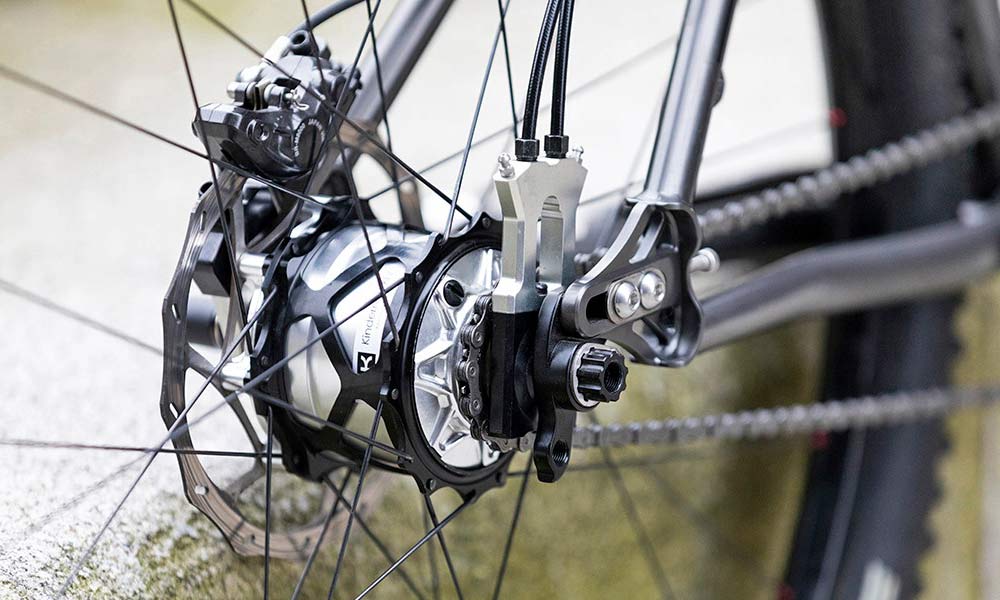

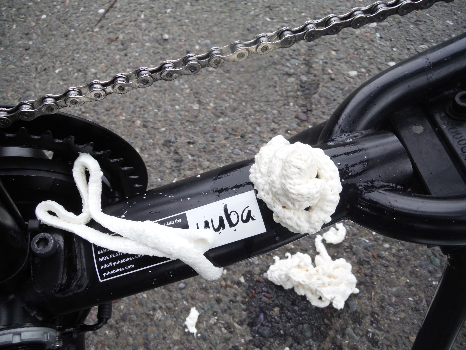

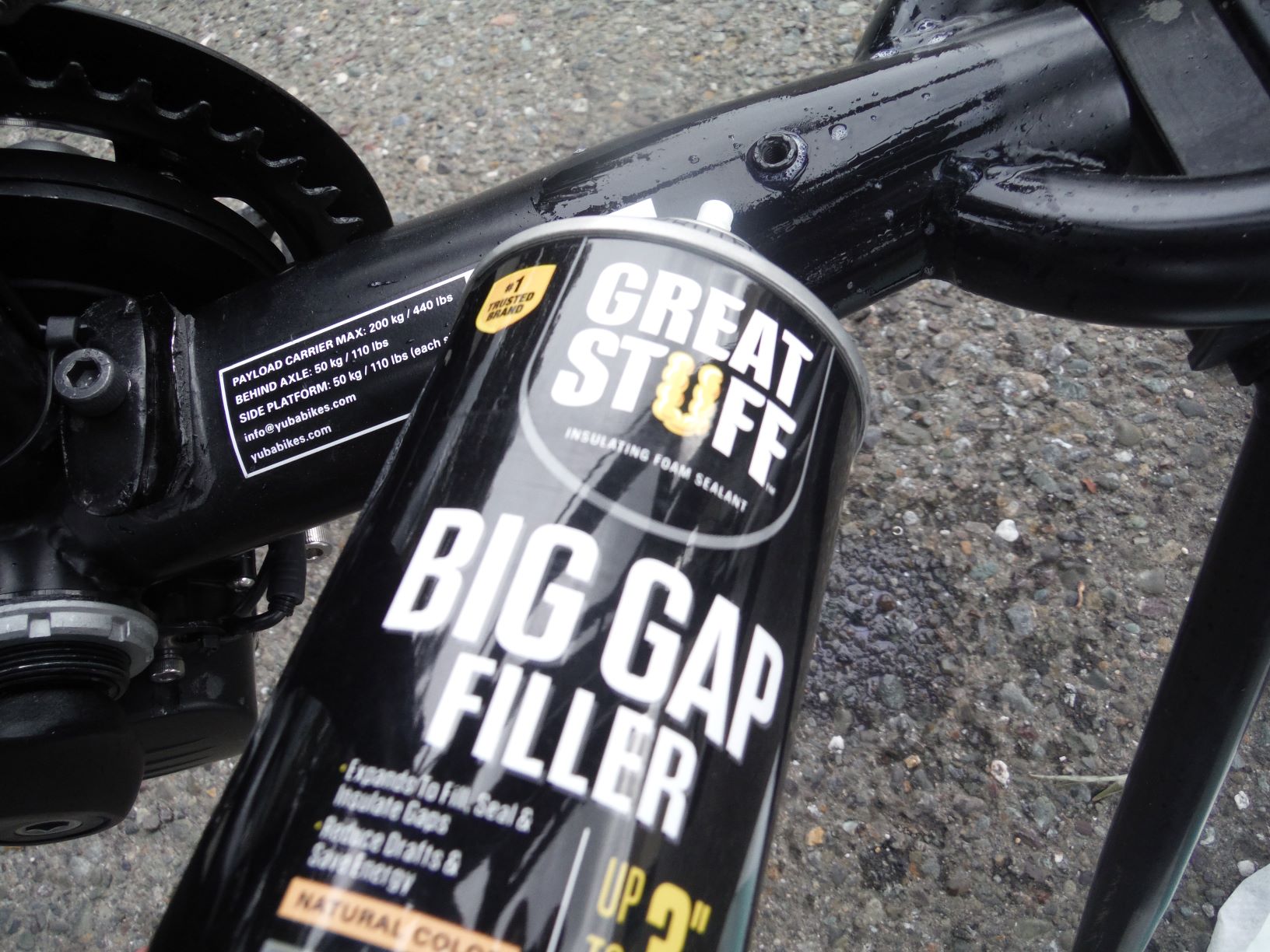

I have only read the first and last pages of this thread. I am looking forward for the 2-day Tuesday announcement on 22222. I can tell that there is a belt drive on the right. That would likely go to a hydraulically shifted Kindernay IGH, but those through axle hubs are 14 speeds, not 12. If it where Gates than the right seat stay would need a break. One problem is that the motor is illegal as tuned. The lawyers and insurers would shut that down by detuning it so that it could be marketed. Then you would be left with an overweight detuned system.
