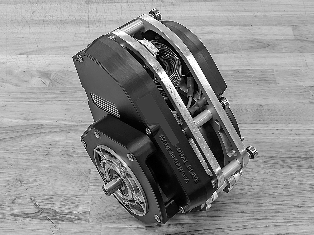

Here's the scoop, as much as I can share right now:
  • it's more powerful than a Bafang Ultra, and it sounds better.
  • it uses a high resolution torque+cadence PAS
  • it's made in Canada (mostly, including motor and electronics, power drivetrain)
  • 24 months engineering right here in Saskatoon, SK.
  • it does not rely on bicycle chain for assist power, but it still pedals like any bicycle, with up to 12 speeds
  • it's compatible with fat tires, 29+, all that jazz
  • Easily 40 MPH in testing without breaking a sweat, and can climb and tow like mad (over 2000lbs tested, on a popular bridge, I kid you not.)
  • it can do all of this with fairly conventional batteries (typically 52V 40A+ 900-1100Wh)
  • the drivetrain service interval is over 5,000km, with 10,000km service interval design goal
  • key design goals: low cost-per-km, severely reliable with redundancies, mountain-climbing machine, cross country endurance. Strong sporty, but agile af.
Launch for website is 2/22/2022, this coming Tuesday.
More info soon, more photos to come, Cheers!

No multiple gears on the electric motor, a single gear ratio. This is the beauty of a dual drivetrain.
Well sized electric motors with the proper fixed ratio don't need gears, they can deliver all their torque from zero to max on a single gear ratio, usually around 1:9 or 1:10
So the pedaling side is there to provide two things:
1- Additional power from the rider (using gears, because we are not as strong and efficient as an electric motor).
2- Input for the pedal assist.
Based on the pressure applied to the cranks and the pedaling speed, it can decide how much additional power to send through the separate drivetrain.
This also means that changing gears is way less necessary, because you can get the motor to deliver all the power you need regardless of the pedaling speed.
If you are in the middle of a hill in the fastest gear (smallest cog), when you apply pressure on the pedal, it will send power to the wheel through the separate drivetrain and get going just as well.
The slowest gears (large cogs) on the pedaling side become mostly necessary when using little motor assistance.

For the third time, your "concept" of how this works is just wrong. There is no magic. A motor with a single gear ratio is a motor with a single gear ratio. Forget about pedaling--people with Ultras usually have throttles and are well aware of what they are capable of doing (and what they are not) when pedaling is taken out of the equation entirely. A gear ratio that is "optimum" for a bike climbing a 50%+ grade at low speed will not be optimum for speeds many times as high on flatter ground. With enough power, certainly a motor can perform very well in both situations even with less than optimal gearing. Enough power fixes most things. But there is a 750W limit where many people will want to ride.
It's very possible this motor (the motor itself) has a much broader torque curve than the Ultra at the same power level (which would provide more area under the power curve) while fitting in the same space, which would be quite impressive. I hope this is the case.
But that's what it would take. Not some magic that comes from removing pedaling power from the same chain.
For size and/or weight limited systems with single speed you may go for top end then run hot at slower speeds or go for low end but speed limited. I don't see how this system gets over this problem.
Matching the torque input from the pedal side to the torque output of the drive side (motor side) would require precise tuning and it would be great to see someone doing this properly.
If the torque measurement is not available at the motor side then why not use rider's power output for computing the desired motor output given the amplification factor. That is probably why they mention a high resolution cadence sensor in addition to torque sensor. Still this may not be as good depending on the quality of the power measurement since precise and low delay power meters can be quite expensive.

We are speaking of 2000W to 3000W motor here, and these for a fact can do the job on a single gear ratio (especially if designed for it, which is the case here).
I know, I have one :)
