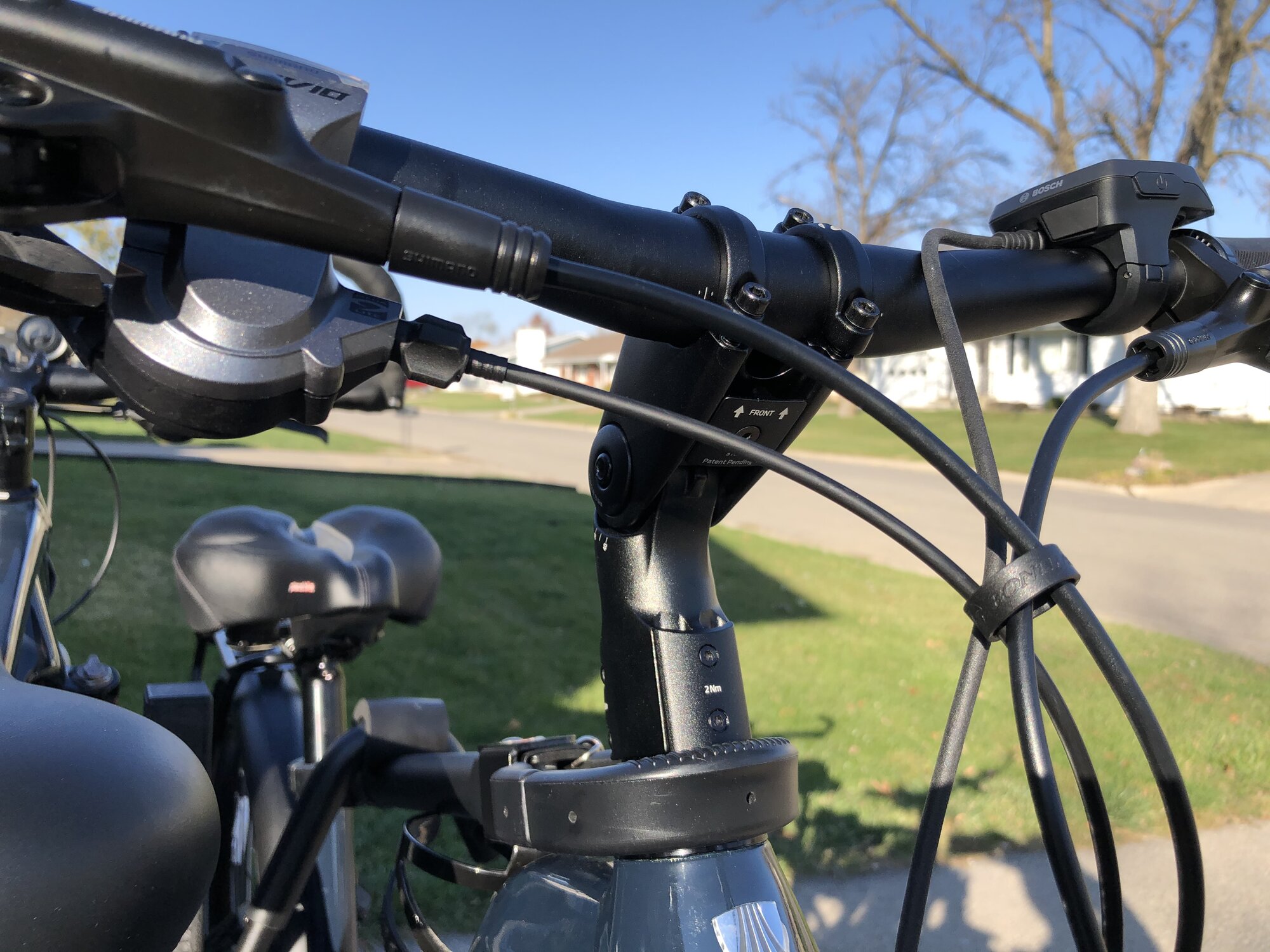

The +7 does not come with an adjustable stem but you can retrofit. My wife’s Lowstep version came with the normal stem and our LBS found a Bontrager adjustable that I could not see when I looked around online.
BTW, the +7 DOES come with Walk mode.
I sure wish that you could have been in Morgantown WV today. 65 degrees, not a cloud in the sky. I had my wife there to test ride the Allant 7. I mentioned walk mode. “ Bosch does not allow that on US models”! The owner,tech, and salespersons were sure until I showed them from your info. Never knew these 3 to be so speechless after knowing them for 40+ years. Then we went into the stem. Showed your pics and not a sound. I guess ever the pros have a lot of room to learn. It’s been fun learning from you and more fun teaching LBS pros.
Well, great! I learn so much here on this forum that I educate my Trek guy fairly often. Though he did show me how Walk worked on my Allant+7. In fact today I spoke with him about an update from the Purion controller to a new Nyon controller and he didn’t know hardly anything about it. Even the Bosch team guy here didn’t know specifics on cost or availability yet. Did your wife approve of the +7?
