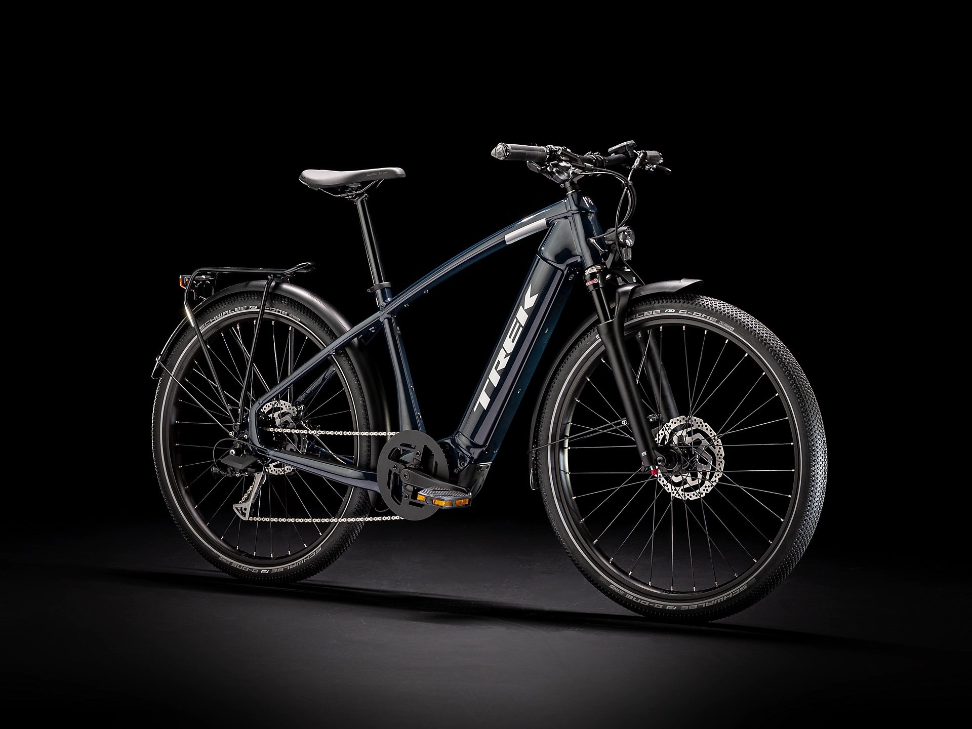

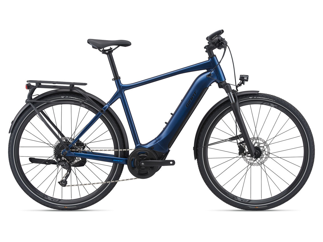

Links to Trek and Giant spec pages of these two bikes... https://www.trekbikes.com/us/en_US/...ectric-hybrid-bikes/allant/allant-7s/p/31929/ https://www.giant-bicycles.com/us/explore-eplus-2-gts-28mph-2021 (Thanks for the reply Alaskan !) hoping some feedback from the members of ebr... will help me make a decision... I have test rode both of these bikes this week and liked them both. The Giant (yamaha) motor was more quiet, but not a deal breaker, where the Trek has 85 Nm torque, and the Giant SyncDrive Life has 60 Nm, trying to decide how much weight should I be putting on this (torque) aspect? Both local bike shop have very good reputations and I talked to ownership/management at both (the Trek store was owned by Trek) and feel good about both. Feedback here I am hoping will help me make a final decision.

Either of these bikes should serve you well. The components are pretty similar, especially the drive train. The Trek has a slightly higher maximum assist level, 340% compared to 300%, but this would only matter if you were climbing steep hills or wanting to maximize speed into wind or uphill. On flat ground, the class three bike limit would set your max.

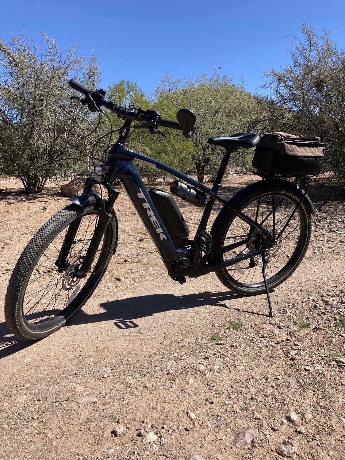

Good choices! I have ~4,500 miles on my 7s. Your riding schemes are similar. We also invested in a Kuat carrier — if you don’t have one, a carrier is something you may need to consider as to how to get your new bikes home.
Fantastic enquiry , you've researched well. Both are great bikes from established manufacturers, the question is can you justify the 20% premium for the trek?
If it was me, I'd be trying to justify the trek - especially if I was carrying extra weight / loads / higher speeds.
Little things, but the solid axle on the front wheel will make for more precise steering than a QR , and give you MUCH better options down the track if you decide to upgrade forks ( all the high quality forks use through axle) , the 4 pot shimano 520 brakes offer fantastic feel , slightly more power, and MUCH better pad life ( larger pads) .
Admittedly I despise the alex rims on that trek - so if you intend to run tubeless in the future be prepared for a difficult conversion ( not impossible, but you have to be extremely careful with the tape) . I do prefer the trek hubs compared with giant - they're easier to maintain / service ( again, just shed time or needing a more skilled mechanic at the lbs)
Trek has arguably better build quality than giant - probably not an issue on these bikes but they put a bit more thought into frame design - eg if you look at the rear axle / chainstays the trek has the welds / weak po8nts/ further apart / a n a lower stress area ( more difficult to manufacture but one less failure point) . It's highly unlikely that a normal person will brake either of these frames, but I find it reassuring to see that level of thought. Eg On their dual suspension mountain bikes they have bushes at the linkages rather than just alloy on alloy 4 years later this can result in some flex on a giant ( at least my extremely abused giant)
Both bosch and giant ( yamaha) are reasonably reliable motors, but be aware giant warranty is not a rolling warranty like yamaha offers on yamaha bikes - ie if the motor is replaced on the last day of warranty, you don't get an extra 2 years. Giant warranty is not transferable to new owners - so if you decide to upgrade there will be no warranty for the next buyer. You'll have to ask about trek, but know specialized warranty IS transferable ( and a rolling warranty on the motor)
I THINK trek warranty covers consumables like bearings - giant doesn't ( I had wheel bearings fail within 3 weeks on my giant ! )
I think giant parts are generally cheaper to replace than trek, so eg if the battery dies out of warranty it's generally cheaper for giant.
