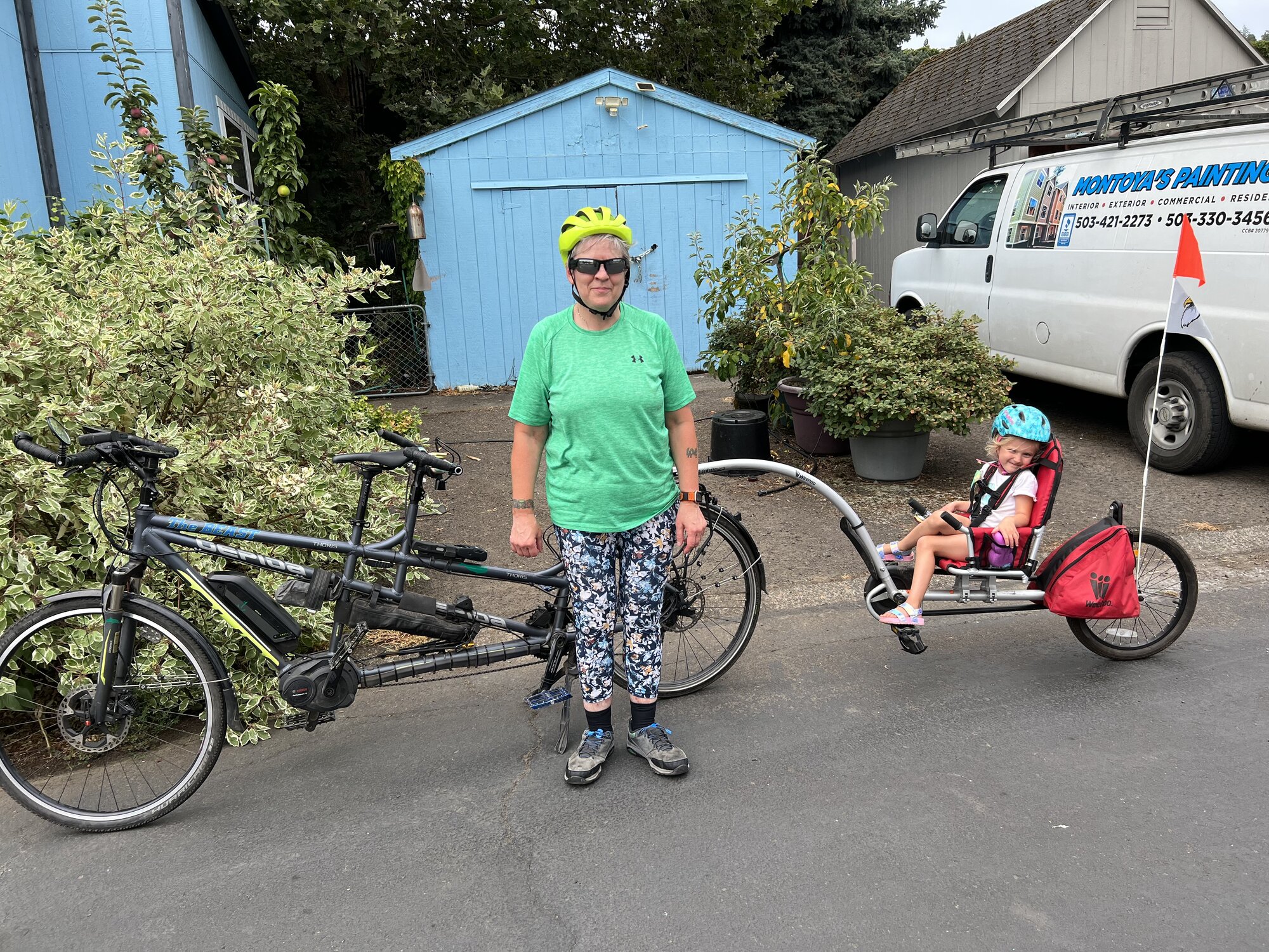

that should not be an issue really for a mid drive. wife and I tow our grandkid up some very steep hills. the problem with internal hubs is the gearing is not a huge spread unless you get a high end one then thats real serious money 8000.00 or more.

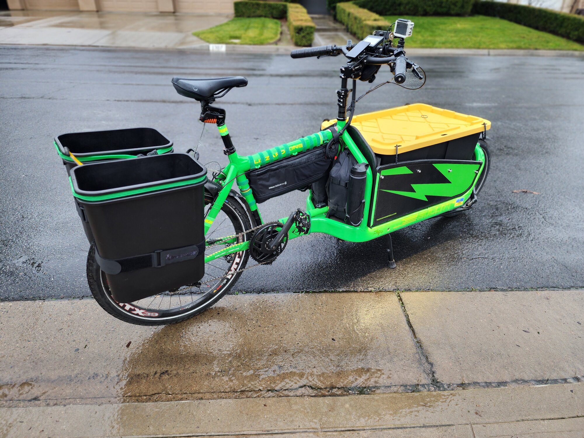

There's a bike that pretty much checks all of your boxes, but it is not going to be inexpensive and it is going to need a big shift in mindset. For one, you could likely set aside the trailer. I'm talking about a Bullitt e-cargo bike. Bullitts are regarded as sort of the cyclist's cargo bike. Agile and light weight (for the genre), analog builds can be stupid-light if using road race components. I'm waiting on a frame to arrive now for my 2nd build, and among other things I am using a c/f rear steering tube as well as a dibond cargo floor to shave off a LOT of weight (those things will not mean much to you if you're not familiar with the hardware)
Splendid Cycles in Portland OR is sending me mine, and I am sure there is a dealer north of the border (looks like there are five based on the map at their web site).
The configurator is at the link below. Me personally I build my own with a BBSHD and I would strongly recommend you do the same, although I know thats not everyone's forte. I tone down my BBSHD on this bike so on pedal assist its pumping out a max of about 450w. If I goose the throttle I can get the full 1500w :D
The frame has a break in it for a belt, and their complete bikes include multiple belt/IGH options.
This one is 11s and geared for flat ground. The one I am building will have a 9s pie plate in back and a 40T chainring. Thats a 30 gallon Costco bin in the cargo bay, and you can stack stuff on top and net it down (or remove the bin entirely). Same goes for the panniers. 2 displays on the bars because it also has a front hub motor but don't bother wrapping your brain around that; just look at the possibility of a relatively light and maneuverable cargo bike (mine is not one of those :D).

yes but its actually easier to climb on my regular bike with the same motor then it is on the tandem. but we can do it on the tandem no problem. we have done short 18% grades.
