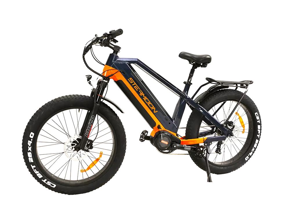

Please go easy on me, I just transitioned from a 500W hub motor to a 1,500W mid-drive Bafang Ultra (G510.1000 / M620), on a 85 pound a fat tire cruiser/hunting style ebike.
(For those curious, the bike I'm referring to goes by several names, including Bikonit Warthog (MD750 / HD750 / MD1000), Juggernaut Ultra Beast 2, Etek Hunter, Steamoon Spectre-X and other unbranded look-alikes from the Asia-based 'Leili' supplier.)

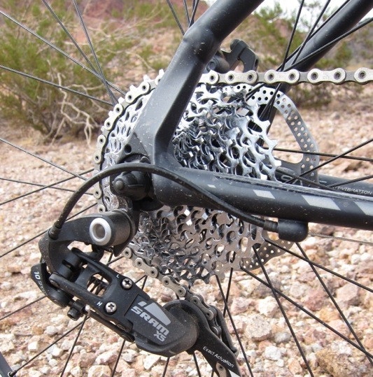

The manual transmission drivetrain on the bike is the SRAM X5 9-Speed 11x32 (11 tooth on ninth gear to 32 tooth on first gear) with the excellent trigger shifters.
I would like to understand, roughly, at what speeds (in MPH) I should be using which manual gears?
For example, most of us have initially made the rookie mistake of attempting to engage 9th gear from a complete stop, and experienced the chain slipping/cogs grinding on the smallest gear, which only has 11 teeth.
Since I am unfamiliar with which gears are best to use when, I feel like I'm often not running the motor effectively... even if it's not quite so bad as to be skipping/slipping on the cogs.
My understanding is that, unlike a gasoline motor which is most happy (and efficient) at low RPMs, a mid-drive Bafang motor is most happy at high RPMs. Is this an accurate assumption?
Thus, is the mid-drive Bafang motor most efficient when I'm spinning the cranks (in Pedal Assist) very fast going 25 MPH, in the mid mechanical gears (3-4-5-6), or when I'm spinning the cranks at a more moderate slower pace in the high mechanical gears (7-8-9), going to the same 25 MPH?
I realize these may be rudimentary questions, and that the PAS level (1-5) also plays a factor, but if anyone would be gracious enough to share their thoughts on what gears I should use when, my mechanical drivetrain would very much appreciate it! :)
cadence (how fast you peddle) is the key to mid drives. You shift to keep your cadence as high as is comfortable . like for me thats around 80 rpms. so I shift to keep my legs spinning. I start off in the largest cog and work my way to the smaller ones as I accelerate. I change back and forth as terrain changes so I can keep my cadance close to the same. youn eed to anticipate hills and shift before you need to stop or slow down. also ease up on peddling while shifting.
Just like a normal bike
I have found the Ultra to like a higher cadence and does not do well when lugged. Really hard to say at what mph what gear you should be in given terrain variations but in order to maintain your drivetrain it is best to anticipate your shifting so that you can let off on the power momentarily while doing so.

Something to consider and you will know what I am talking about if you have ridden dirtbikes.
Rear cogs wear out and can do so fast.
Chains stretch and end up needing replaced so as not to wear out those new replacement cogs you just put on. Front Cogs wear out too.
What is the point of this post? Don't get into the habit of staying in the same rear gear. Vary your peddle assist level and the used gear for routine terrain.

You've gotten some good advice here. Most of us experienced bike riders shift gears to maintain a comfortable pace, while cranking (peddling) in the range of 60-80 RPM. We vary gears and motor power levels depending on our personal goals - I bike for exercise, so I tend to use less power and lower gears than someone biking for speed, for example.
Experience has also taught most of us to downshift before coming to a stop, although those with throttles may use a different approach at the risk of poor control over their bikes.
As the calculator link says, it's for comparing different setups and to find optimal gearing, within the context of the rider's goals. It's not to tell you when or how to shift.
