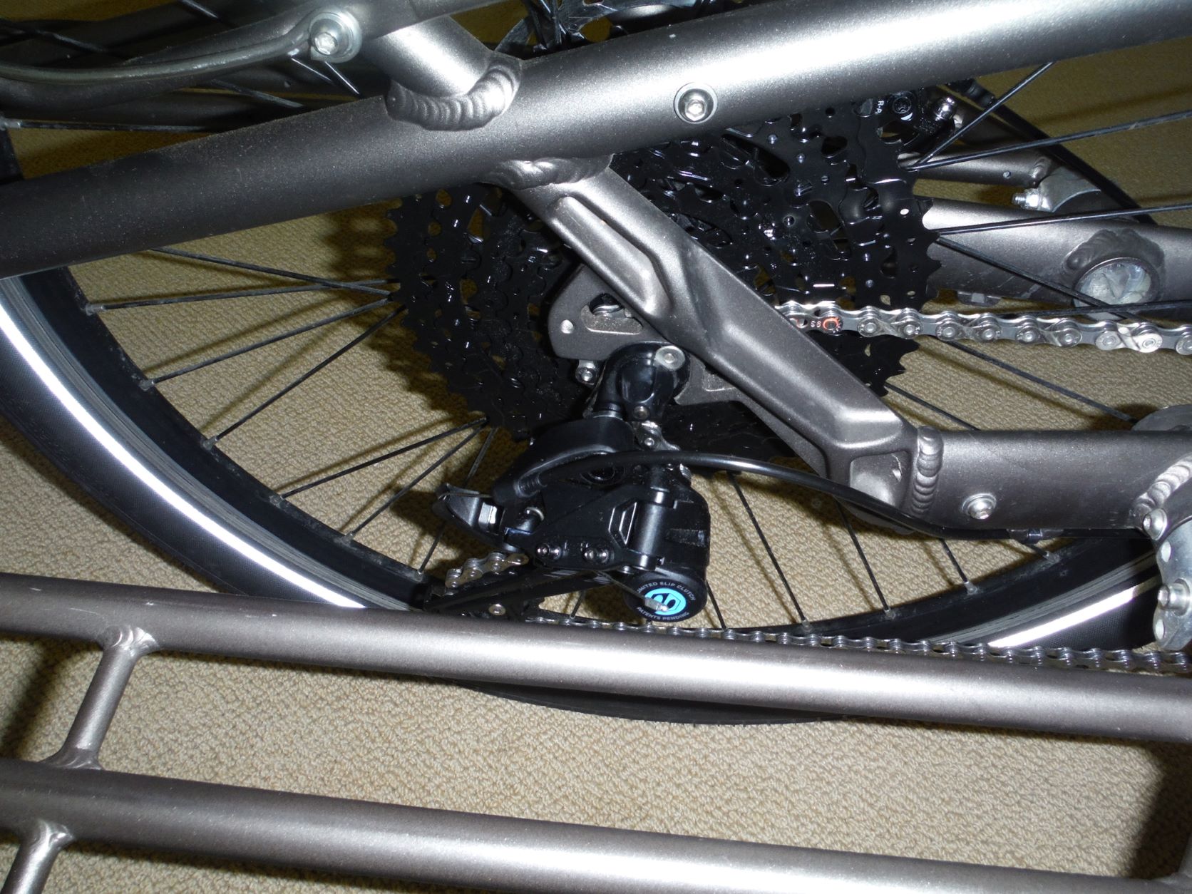

Spinning makes for overall health, nice legs and is good for the bike. That is an 11-50 cassette, 355%.

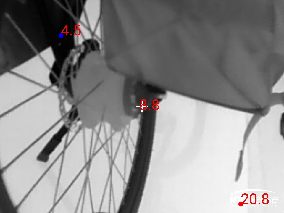

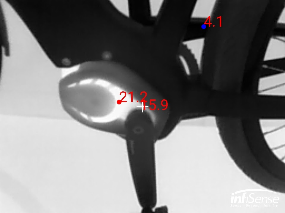

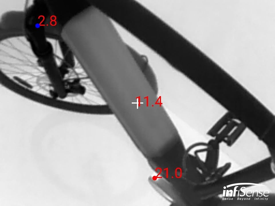

Just for fun I thought I would see where the hot spots are on my bike. I almost always ride in TURBO mode while commuting and I keep a medium/low cadence. It was about 0C this morning so nothing it getting too hot. The only real surprize was not seeing any heat transfer to the frame. I would have thought the aluminum would be great for transferring heat but most likely the motor is isolated for noise reasons. The battery only attaches at the top connector and the bottom latch. I thought the hub would be warmer.
