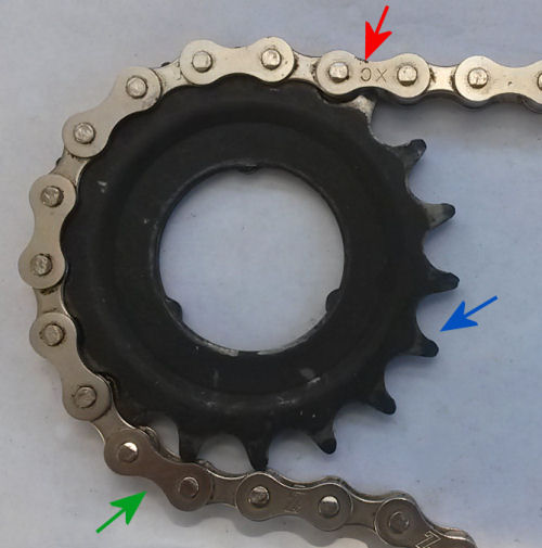

Not cable tension... Derailleur adjustment.I did fiddle with cable tension with no joy. Visually the derailleur lines up with 8th gear. The bike has never been dropped or abused. I doubt the hangar is bent. Again, with the original chain, the bike has spent most of it's 2,000+miles in 8th gear. Although the teeth look just like all the others, I can't help but think I simply wore out 8th gear. I avoid 9th since it has so few teeth but now I'll be using it most of the time. Curious to see how long it will last. I don't start out in 9th and I don't mash the pedals either. I actually prefer 9th to 8th but thought I was doing a good thing by not using 9th. My other option is to reinstall the old chain that's at .5 or slightly more and simply ride it until skipping starts, then replace chain and cassette.
And what do you mean by slipping?
Not staying in that gear?
Chain riding over the teeth?
