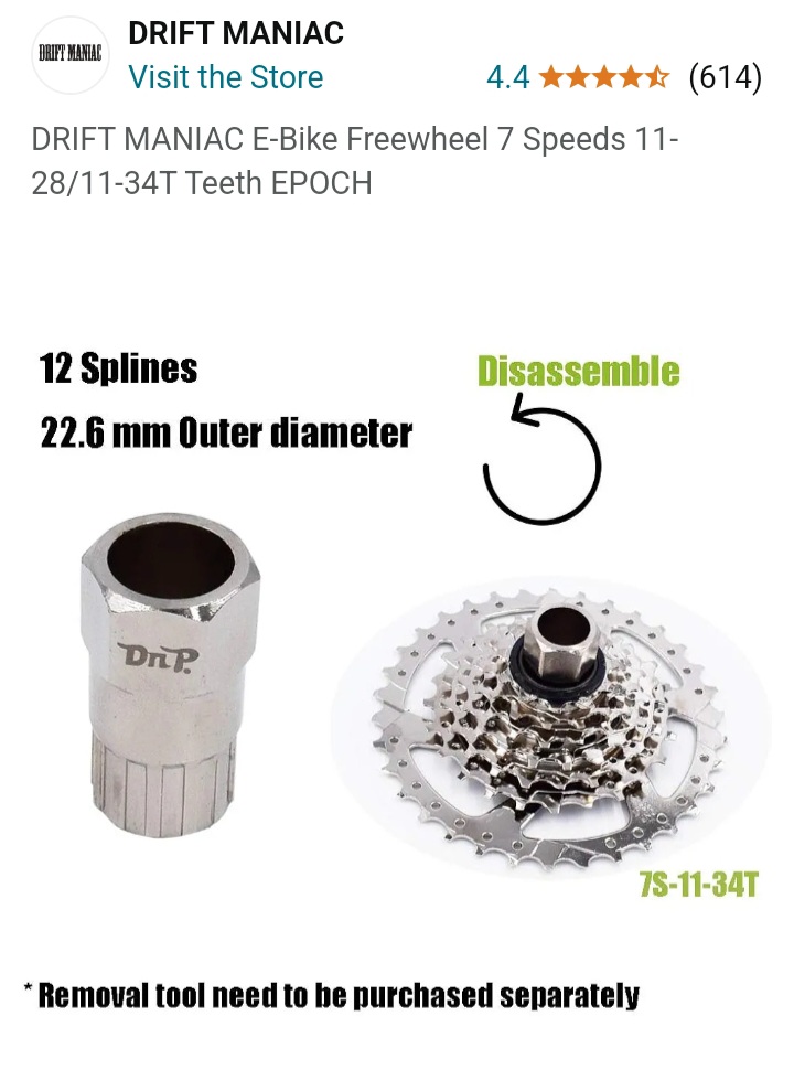

I have been riding a fast analog bike for about five days. It has been great to practice pedaling technique and spinning at high cadence. I needed to make a house call, that means tools so I packed up and took a torque sensor mid-drive. The pedaling practice really paid off. And at a cadence of 90-110 I was not at all lugging that bike. That one is very simple and inexpensive to maintain. An 11-34 freewheel is about $20. And it is as fast or faster than high-end eBikes.
,.. An 11-34 freewheel is about $20. And it is as fast or faster than high-end eBikes.

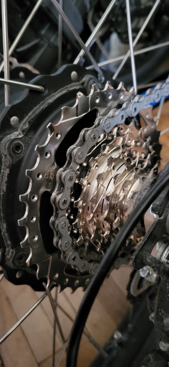

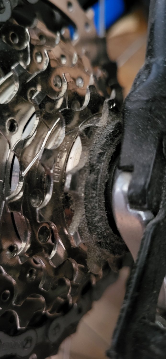

Looks like I'll be needing to replace the 11 tooth cog soon?
It looks pretty much worn out. 😁

It is badly misshapen. One looks like a shark fin.
You could keep it and just not use that cog.
I was referring to the dust on it.
I've never had it in 7th gear. 😄

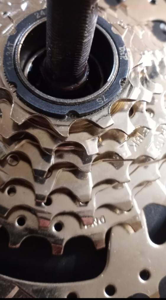

I did some math. Maybe I got it. The chain has one bad link. It is not bending right and the chain is 112 links long. So every time the chain goes around once the bad link hits that exact same cog.
Edit: Cassettes have odd teeth to allow for ramps shifting up and down.
Yeah,..
You can really see it on first gear,..
There's a ridge or lip to catch the side of the chain with a rounded tooth, so the chain can get a boost walking uphill.
