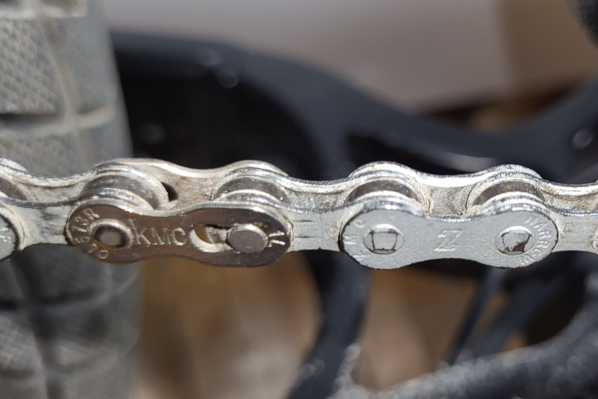

I rewax my chain once or twice a year.

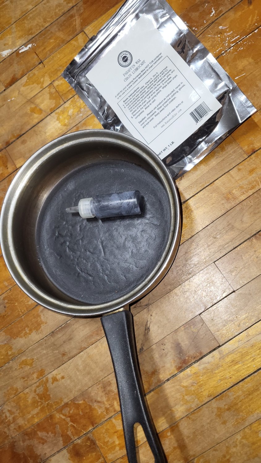

I have my designated pot for cooking chains,..
This said...
I'm still going to give paraffin a try as an initial treatment on a new chain,
This is the wax I use,..
It's got the Paraffin, the PTFE, and the Molybdenum disulfide all mixed in together.

I use the Hot Tub method,.. 😀
I've got over 3000 km on both my ebikes and the chains look brand new,..
The chains themselves might only have ten or twenty miles on them, but they're not rusty or all worn out at all !!😀
The advantage of a hub drive, and not pedaling, is that your chain and sprockets last Fer Fukin Ever !! 😀
And my ✋️'s and pant legs never get all full of greasy crap.

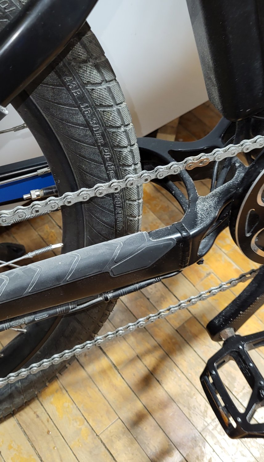

Make sure that your chain is ABSOLUTELY CLEAN before you do the 🔥 wax treatment.
A brand new chain is pre-lubed and needs to be cleaned.
I use Hot Soapy water, alcohol, brake cleaner, and acetone to clean the chain first.
The chain has to be Parched of all oils, or the wax won't penetrate the metal, and it will flake off.
I didn't bother with the ultrasonic cleaning process to get the extra 2-4% cleaner chain, but I'm not not competing in the Tour De France.
And if I was, I still wouldn't pedal. 😀
I use an old frying pan with hot Soapy water, submerge the chain, and slosh it around on both sides to wash the grit out from between the links.
New chains are easier to clean because there's just a light coat of oil to remove without all the grit.

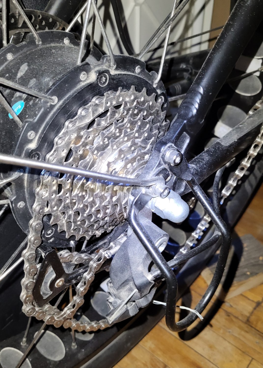

View attachment 195731View attachment 195732View attachment 195733

,.. My interest in waxing is to have it cleaner to work with.
I'm messing with my chain all the time and it's never grimmy.
It's just dusty from the gravel roads like the rest of my e-bike.
I can just wipe it down with a cloth or wash the dust off with plain water.
I don't like how gravel dust sticks to oiled chains and turns the oil into a grinding/polishing paste.
It churns its way into the links and grinds away from the inside.
Grit doesn't cling to wax and get absorbed in the same way as it does with oil or anything "wet".
