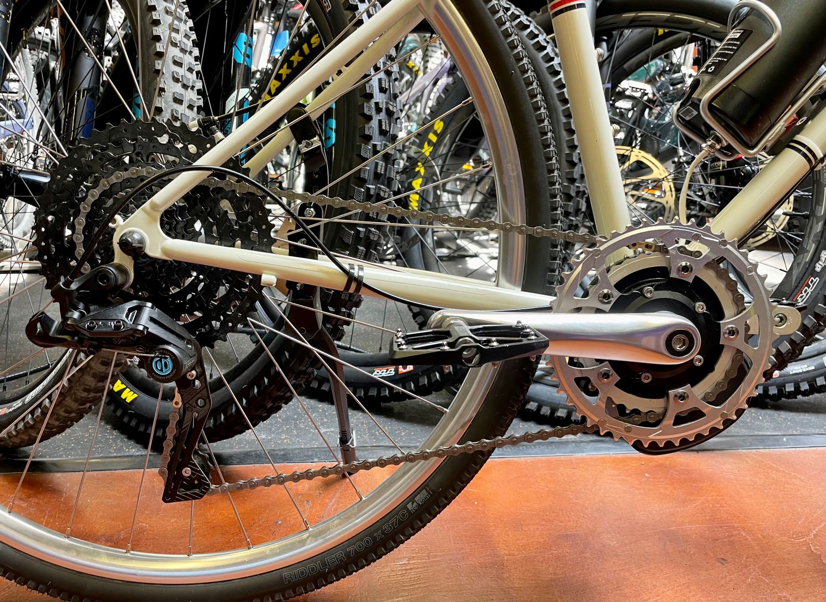

Rick recommended a handcrafted touring frame from Pashley, a storied English bicycle maker. We chose the Pashley Prospero, built from Reynolds 631 steel and hand-crafted from bare tubes in Stratford-upon-Avon, England.
This is it:
(Photo credit Pashley Cycles)
The frame crossed the Atlantic and arrived at Rick’s workshop in late July. That’s when the transformation began.
Rick equipped it with a fully programmable 500-watt ToSeven DM02 mid-drive motor, a robust external battery, Schwalbe Hurricane tires, an oversized brake rotor for steep descents, and a Deflopilator to tame the steering when rough terrain or uneven loads try to wrestle the handlebars from my hands, and an adjustable riser stem with more comfortable grips. He used a compact color display that I find intuitive with 5 power levels, over each of the three modes, for a total of 15. He added special pedals that give me amazing grip without the need for any kind of clips. He then added some bling, painting the motor and polishing the crank arms.
The ToSeven is a compact, high clearance torque sensing motor. It is about the size of a 1lb coffee can.
Rick programmed the motor for the maximum power for the very steepest climbs in a manner that only bike engineers understand but in simple terms, it gives me the power to get a quick speed-away when being chased by a pack of dogs. Ask me how I know. It carried me over Mullan Pass and across the Continental Divide. The motor is powered by a Samsung lithium battery. I have not yet found its outside range, as at the end of everyday thus far, I still have energy remaining in the battery.
He also installed the most comfortable saddle I have ever ridden. More than 400 miles into this journey, I have yet to experience a saddle sore.
And because every great bicycle deserves a touch of personality, he topped it all off with a brass bell.
The result is a Pashley Prospero transformed into a dream machine.
